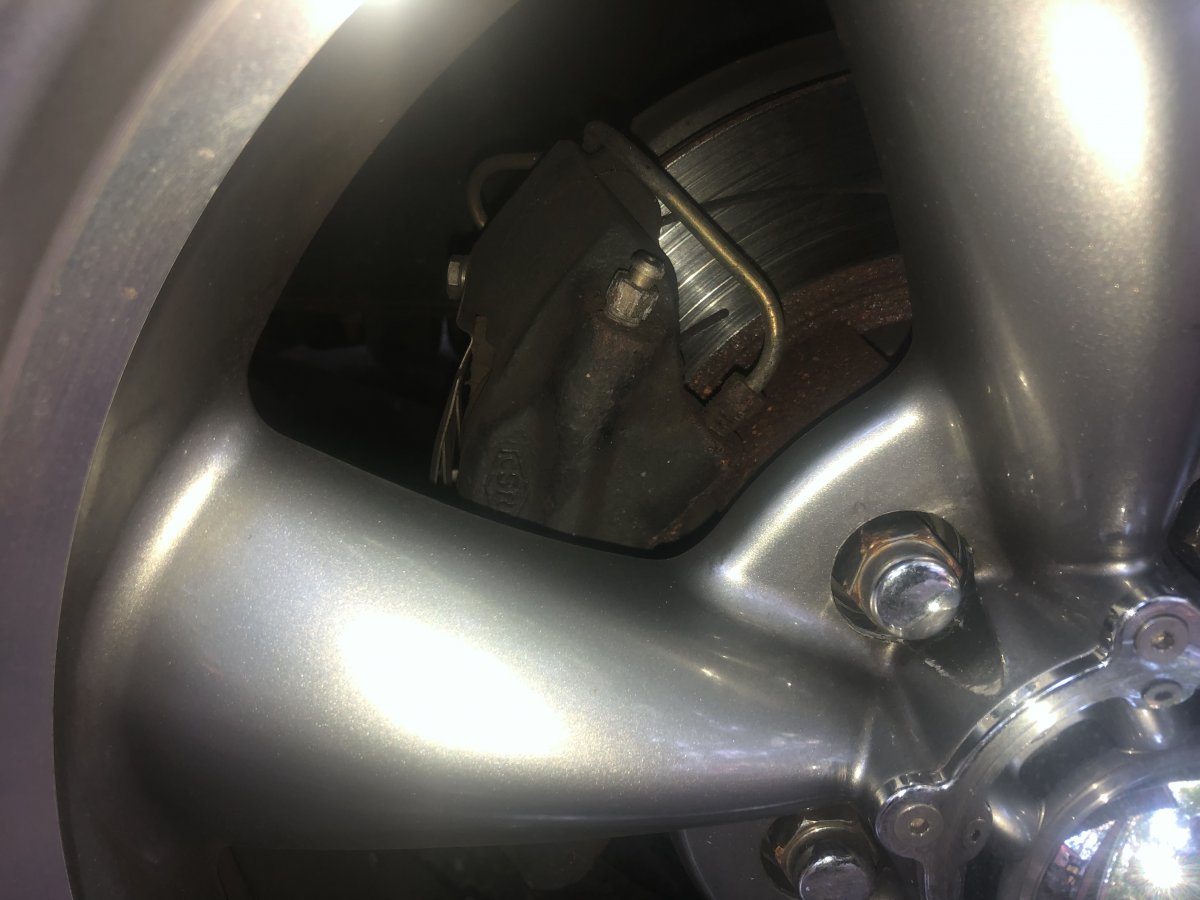

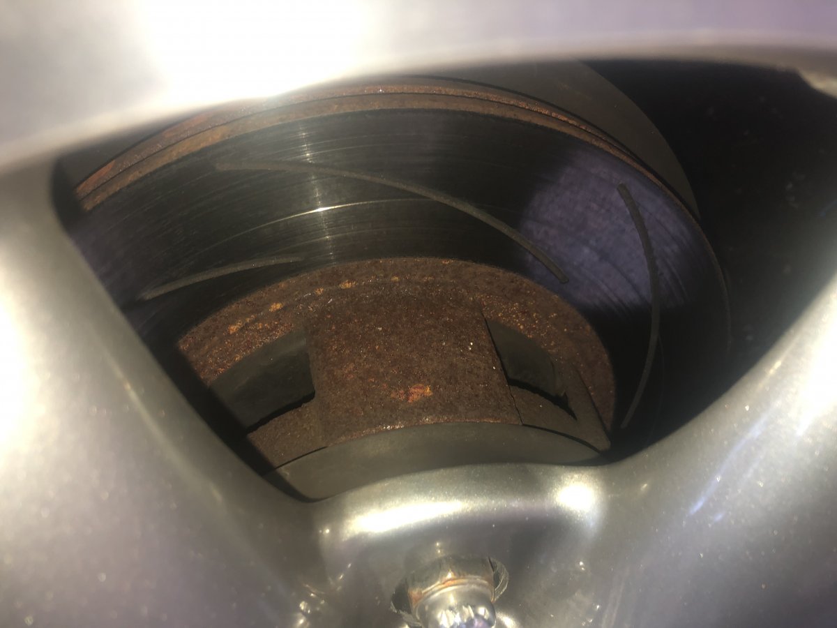

    A704BCB0-D81A-47CE-9E4E-2F7ED843D528.jpeg 2915729F-B345-4079-A061-152E8FDFF218.jpeg 1257F7EF-A56C-4756-A7E3-C19FFB37A4B7.jpeg 1D6B8139-993F-4784-8911-16B612AD8961.jpeg 21575411-5D76-47C2-A116-80A797282229.jpeg 0925F039-DA08-439A-A50A-34A11D378639.jpeg A704BCB0-D81A-47CE-9E4E-2F7ED843D528.jpeg Can anyone identify these spindles and discs on this 65 Falcon ?

    With that cross over tube I don't think Granada at all.

    Search has me here so far. 65-66 Mustang caliber.

    Definitely not Granada. Granada calipers are single piston. Try comparing them to some early 60s Galaxie calipers. The pre 67 Ford's were 4 piston calipers like that.

  8. Yep, and very likely aftermarket reproductions. Also used on '67 Cougars, '66-67 Fairlanes/Comets. Stainless Steel Brakes got their start repoing these, they're popular on late '50s/'60s Fords because they bolt to the OEM drum brake spindles.
    Good brakes, but sensitive to loose wheel bearings which is one reason Ford quit using them.

    Looks like early Mustang Kelsey Hayes 4 piston calipers.. Also, similar to Mopar disc brake options mid 60’s.. The rotors are new slotted units probably a newer replacement.

    Kelsey Hayes disc brake option for FoMoCo intermediate and sports compacts as described above.

    My '68 Bullitt Mustang GT had the same Kelsey Hays front brakes.
