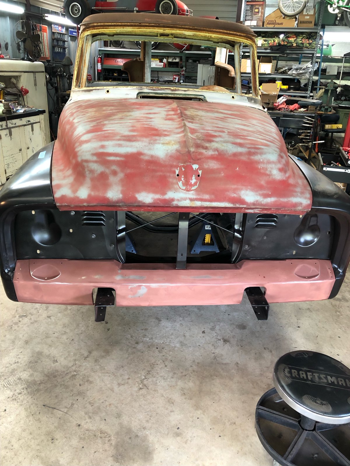

    I don’t think it will take much. Here’s a pic of the hood. I’m supposed to pick it up over the weekend.
    1D568F84-5D90-44DF-9367-64C7562D3DBE.jpeg D86C5EE2-B7F5-4725-9885-DC60FC384B65.jpeg

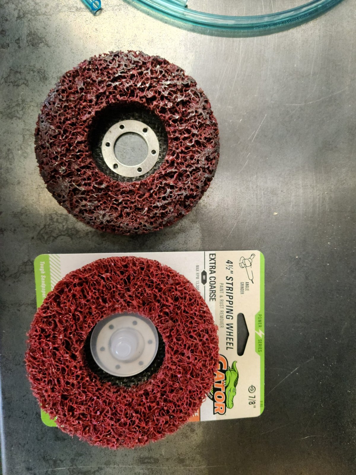

    I wouldn't recommend these that I bought from Lowes. They will plug up just trying image000000 (5).jpg to strip mill scale on 16ga sheet metal, same as you see on my workbench top in background.
    Roothawg likes this.
