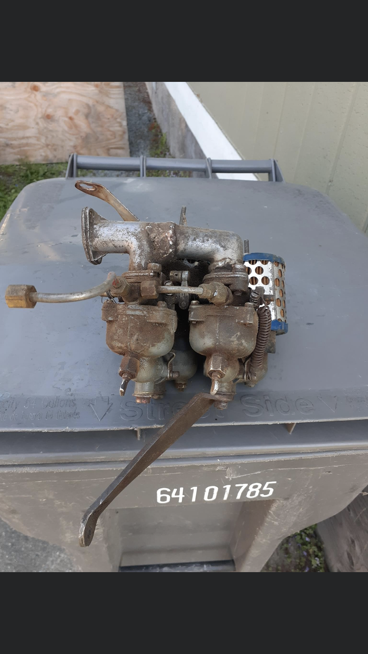

    Not only on cars. Even go carts and just stationary engines in general. 7549C1AB-4567-49D9-A7DD-35F4D809EFB5.png

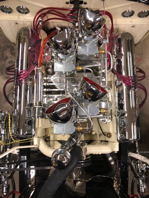

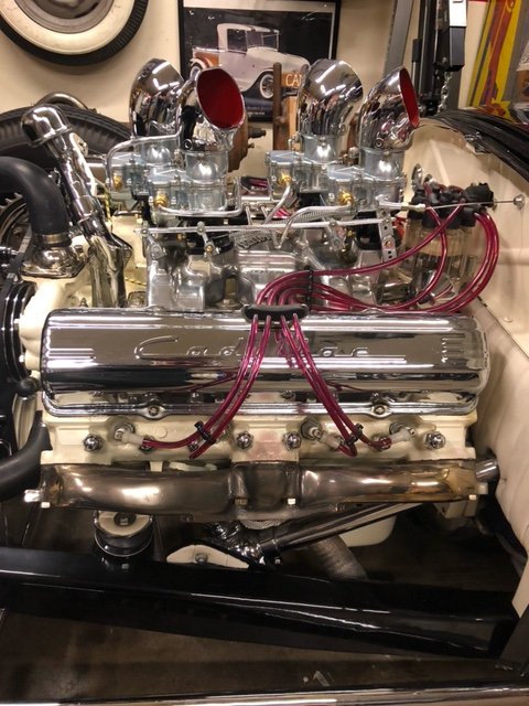

    Two Edelbrock 500 AVS carbs with straight linkage, Weiand WCA 408 manifold on the 390 Cad in my '40... Great throttle response! 20200704_143004.jpg

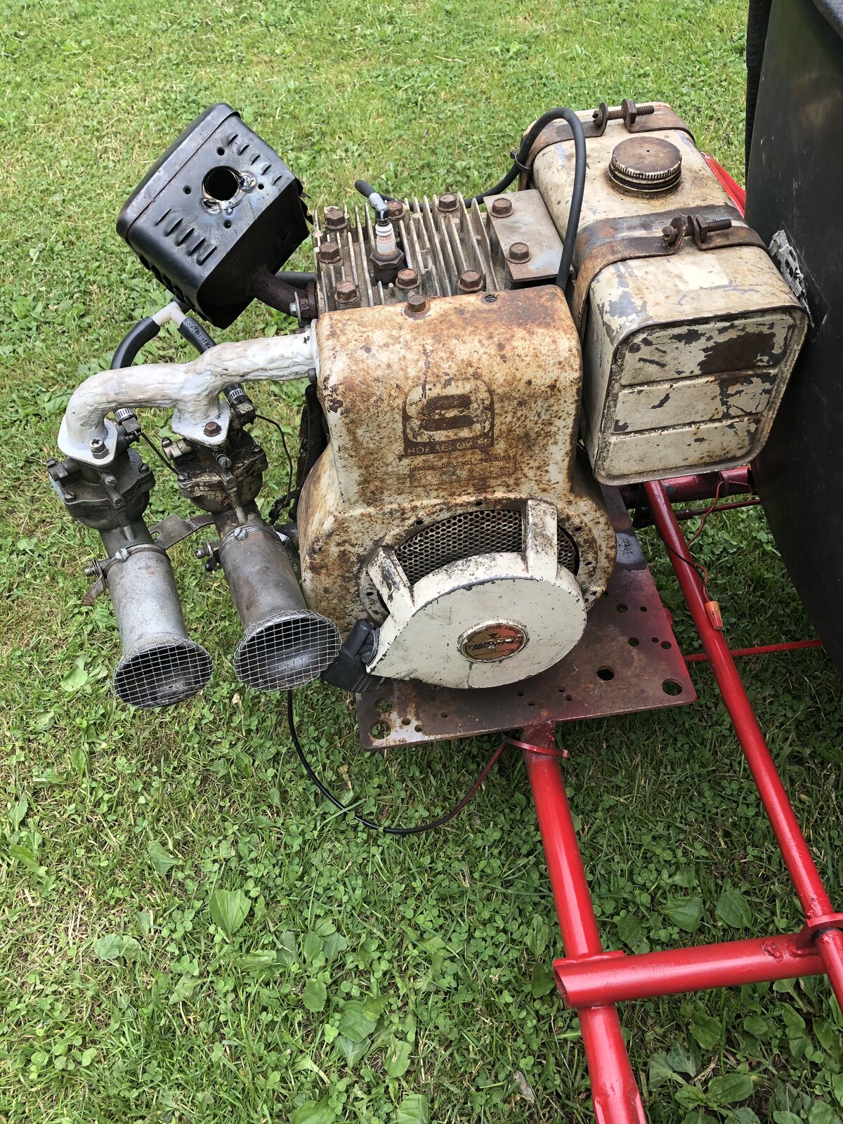

    Here is a pretty cool setup I just got done building for this 8hp. Runs smooth EA497B20-4600-4573-B4FD-CA3988085AFE.jpeg

    What’s it going in?

    It’s gonna stay on the ‘73 bird manufacturing go-cart for now. Fun little cart to destroy the yard with.

    What do you make for power with that setup? I have a 390 stashed for future use and am trying to figure out what multi carb set up I want. Right now I’m stuck on either the Weiand like you have or the Edelbrock like Dreddybear has.

    What does this set up make for power? I have a 390 stashed away for future use and am trying to figure out a multi carb set up. Right now I’m kind of stuck on either the Edelbrock like you have or the Weiand like warbird1 has.
