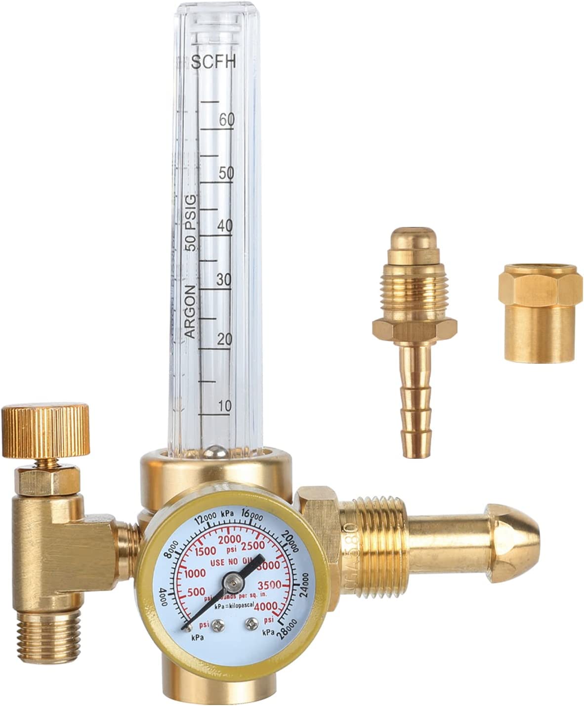

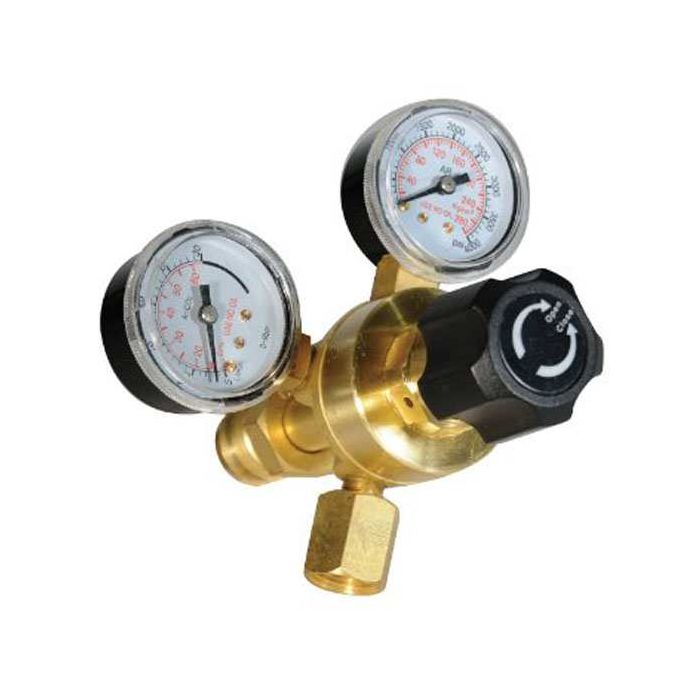

In my professional opinion and experience as a Tig welder and a welding instructor, using an argon regulator like this one is a bad idea. It’s been my experience that they aren’t accurate in the flow setting on the output and can waste gas as well as not lasting as long as the one below. This is the industrial standard Argon regulator with a proper and accurate flow meter which will save you gas over the life of a bottle filling. I use this type of flow meter for Argon exclusively and won’t use the first type for pure argon. I have the dual gauge version on my Mig machine which is fine for the mixed Argon/CO2.

Depends on your local supplier but I have had good luck with Weldmark brand. They are a much less priced copy of Victor. Airgas has their house brand named Radnor which work well also for a lesser price. Like Blue One said, Use a flow meter for Argon and TIG.
