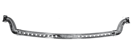

    One of these axles is a chrome drilled I-Beam, the other, a drilled Alum-I-Beam. Both are Superbell. You tell me which is which, without looking at the phototag

    Would the top one be the chrome one? Its a good looking jungle jim:D

    top i-beam is chrome and bottom is polished alum. noticed the symbol on the polished one.
