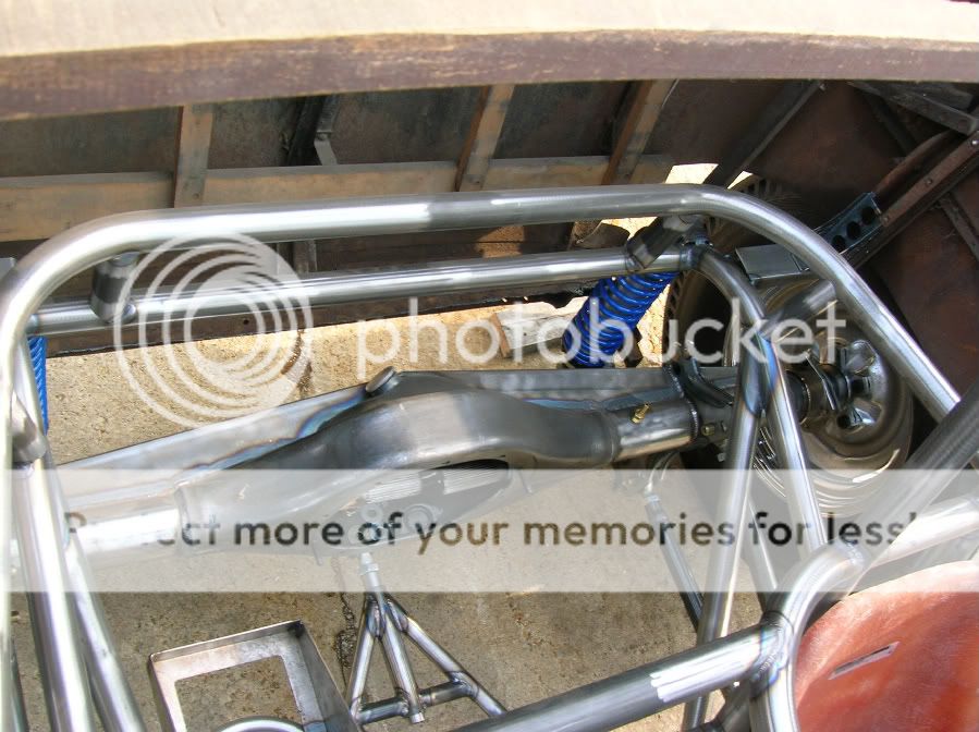

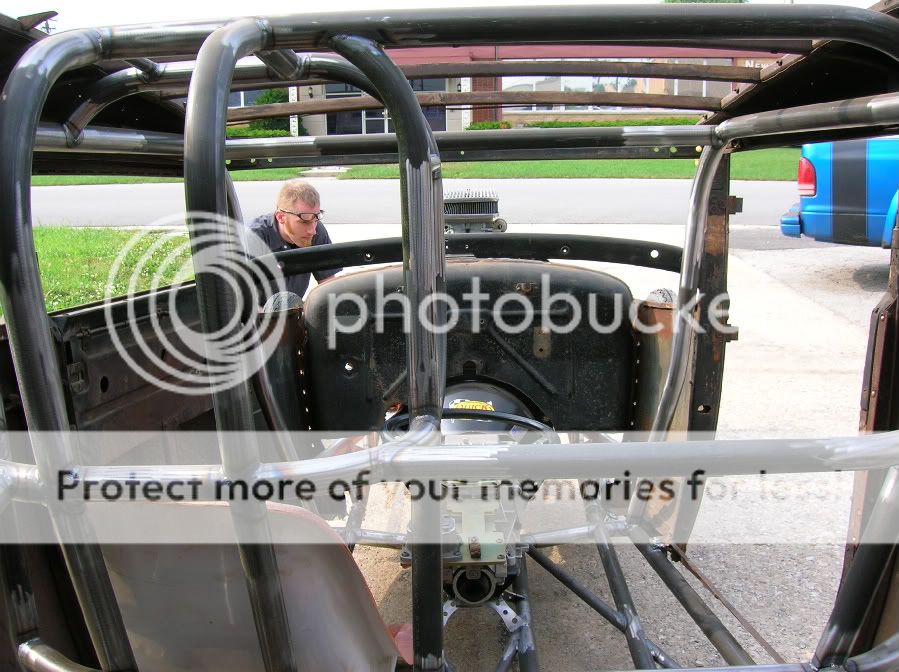

  4. HotRodChassis
    Joined: Jan 23, 2005
    Posts: 2,282
    HotRodChassis
    Alliance Vendor
    So here are the photographs I promised you guys, sorry so late.

  14. Looks *****in. So you are doing a funny car halo because it's required for a tube ch***is build or because the customer wants it? Reason I'm asking is I've got dibs on a tube ch***is setup based on a '50 Merc. I thought the cage for say a 9.50 car would just need to be a 10 point with a window net.
    Hey how many hours would you say you will have in the ch***is and cage?
  15. Django
    Joined: Nov 15, 2002
    Posts: 10,198
    Django
    from Chicago
    John, it has the halo because that is what is required to p*** tech for the times he plans to run at the drag strip.

  18. Funny car halo is needed for times faster than 8.50, I don't think a pump gas BB will run that build that fast. I had an OT car that had a 25.5 cert which was good for 8.50 and slower, and it was a 10 pt, window net, parachute (150mph and faster), and some other stuff. Just asking.

    It's a pro-mod. In reality. Your opinion, although valued, is outweighed by the NHRA Head Tech for Div. III, Rich Bowers, down at Div.III Headquarters in Indy. And the math says that the car should go mid to low 9's at 144 mph. Pump gas has nothing to do with it. Weight vs. hp and torque have everything to do with estimated times. And track conditions, weather and driver have everything to do with what it will really run. Also, the owner has talked about adding a supercharger at some point. Rather than build a car that won't p*** tech after he does that and potentially breaks the 150mph restriction on the cage, it's better to do it in the initial build. I'm not trying to impress anyone with the style of cage. Rather, adhere to NHRA/SFI standards.
    You are correct in thinking that the funny car portion is necessary after the 150mph barrier. In a FULL BODIED car. When building a full tube ch***is, the car is no longer FULL BODIED by definition. No rocker panels, no unibody frame or frame period. Essentially the cage IS the frame. When this is the plan, SFI mandates the 25.4 cage design for the drivers compartment. I don't think Rich Bowers would steer anyone wrong, that's not his job.
    Oh, and by the way, if you're ever at a local track around here, and still think of the pump gas as never going into the 8's, there is an ORANGE pro-mod 70 or so Dart running around. It runs a 273 with a 6:71 blower and an automatic. I think it weighs around 2300 lbs. Runs on pump gas, and they have been known to dip into the 7's on the right day. I've seen the time slips and watched it run.

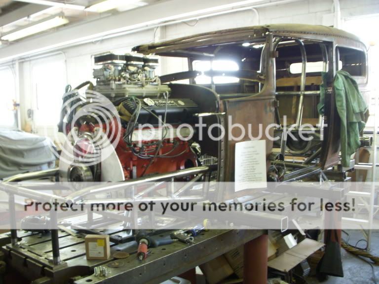

    I want to see more Kevin :)

    Ok guys, here are some update photographs. Sorry it wasn't sooner. Enjoy:
