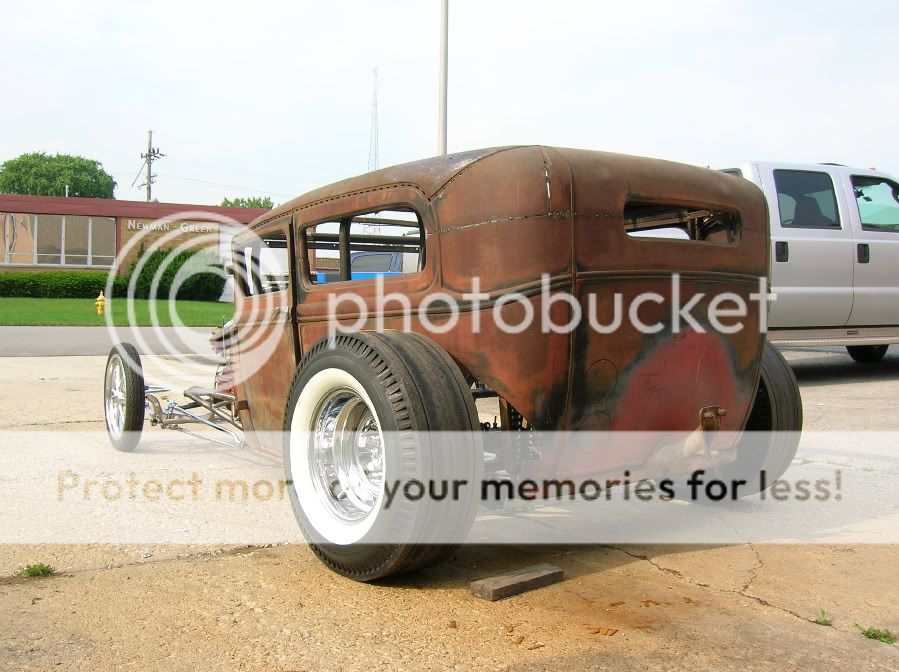

    Unfortunately, no. I had one of my employees go back to his old job (which wasn't over an hour one way to work like here), so I had to hang and work. We're just too swamped to be two guys short.
    I had to post this shot too. Just because:

    Well, there are tons of Fox Body Mustangs that run 9's on street tires, as well as a few running in the high 8's on MT Cheater slicks. So I think it'll do fine. Three of us can pick the back end of the car up right now (sans tires, wheels and axle shafts.) No one can really call what a car will run until it hits the track, and then is dialed in (suspension, driver, motor, etc.). So we all only have the math to go off of right now.

    Yes, cowl steering. Getting a new Schroeder steering kit for it soon. Got a really nice blue flake Challenger 500 wheel for it. And Tommy C brought over an NOS set of period SW 2 5/8's gauges yesterday too. Now all we need is the tach and speedo. Or.......maybe no speedo. :D

    Incredible design, incredible ch***is, and amazing work of making that rendering come to life. Only thing I would change is the rocker covers, I love the mopar covers on a 70's car, but like the 426 wedge covers in the concept for the overall period look. Just my opinion and its probably not worth $0.02 to you but regardless just keep up the quality work.

    Those aren't the final valve covers. It will be just as Zombie's rendering.
    I was floored to see it as a roller on the ground. It's going to be so rad...

    That looks stunning and frame looks very beautifully made.
    I am curious about the design of your frame. I can see that it must be very stiff laterally, but the top member of the front lattice beams that support the engine and front wheels presses into the span of the upright behind the “A” pillar without any support behind the upright in the direction of the forces. The frame at the rear appears far more triangulated but lands mid span on the uprights behind the doors. Does this work because the cabin frame is made out of such a large section tube, or does it not need to be particularly stiff vertically?
    Please don’t take this as a critical question – I am in awe - , I am just really interested in your car and am trying to understand how it works.

    You're question is a good one. The only thing you aren't aware of is that the ch***is isn't done. Far from it. In the front, there are X braces that will be in each door opening, as well as another brace that's a 90* elbow that will run from the top of the forward ch***is just behind the firewall up and then back to the door/window bar. Then a cross brace that will run perpendicular to the firewall (where the Schroeder steer box will be mounted). As well as most likely an X above that behind the dash. Then, out back, the rear upper braces have to be added, but only after the fuel cell is fabricated along with the chute pack mount and tether mount.
    Just an FYI for you guys that are getting into this type of ch***is, only a fool welds in the door X braces BEFORE you are done fabricating the ****pit area. Or a contortionist. :D

    Thanks a lot Glen. We're thinking 4.10 or 3.90:1. But I haven't gotten that far yet. I'd like to get the car farther along and be able to better gauge the weight of the completed project. I may even end up order the gear set last. The TKO600 has a shorter first gear ratio (2.87:1) than the TKO 500 (3.27:1), but can handle more torque. Yesterday, the owner was speculating about going with a 'Glide instead of a stick. And he'll have the power to push the 'Glide. Of course, we're all riding him about "hot rods having 3 pedals." :D
    But in the end, it's owners choice. The benefit of the 'Glide is that you only have two speeds, fast and faster. So less shifting. I'm rooting for the stick over the 'matic. But that's me.

    NICE work!!!! Fit up on all your tube work is first cl*** all the way. What do you do for planning the layout of your tube work??? I've been using BendTech Pro for a couple years now and it's worth every penny.
    What are you using for your notches?? I tend to go to the 4.5" grinder more often than not, though I have the good ol' hole saw notcher. Hoping to get a Baleigh notcher soon.
