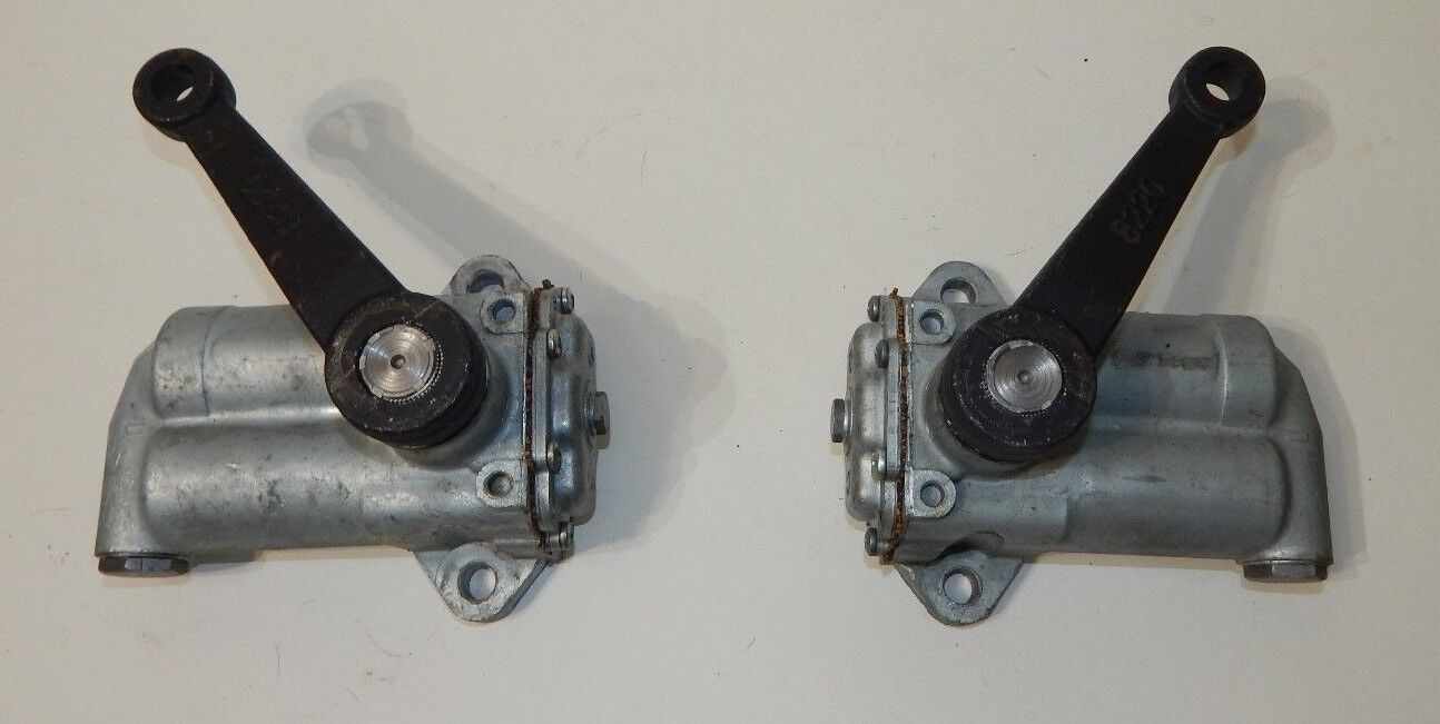

    Been doing a lot of reading as Im prone to do and there is plenty of info about some simple servicing but am yet to find information on pulling apart some rear MGB armstrong shocks. In particular getting the arm off it to see if it can be clocked 90 degrees.

    It's a press fit. You will need to make some tools to do the job.

    Spent a bit of time tonight coming up with plan B as want a shock that will lay horizontal on the frame and have the lever in the right position. Heres what I came up with, there are actually a few options. Will try and hunt up a pair of these.

    The shaft is staked. Knock this inwards with a chisel and use a puller [use mild heat on the lever]
    Replace the seal while in there, and use transmission fluid.
    Lever action shocks don't have an air cavity so they can run upside down .
