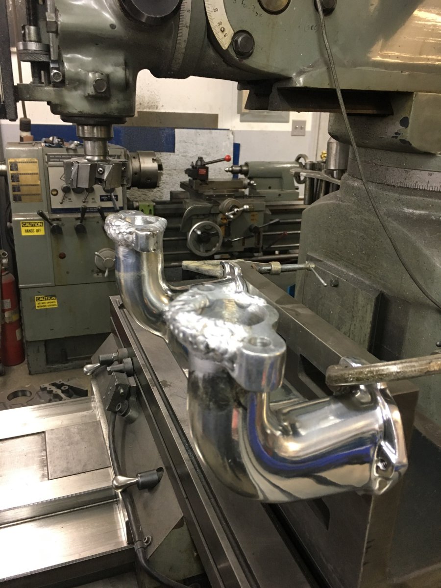

    Its a new miller set up.
    Valve cover was not machined to fit around head studs/nuts.
    Had to take .012 off head to get it flat. It was milled with a 2 1/2 bit when I received it.
    Intake didn't line up with the intake ports in the head, had to weld and mill it. IMG_5602.jpg IMG_5612.jpg IMG_5616.jpg IMG_5623.jpg 20171021_092754.jpg

    Nice save on the intake! Are you involved in the development of the OHV conversion (since you mentioned that it was new)?

    Negative, I was referring to a new Steve Serr (repo) vs an old setup.
