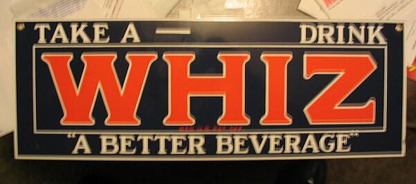

    whizzerick:
    If you're going to pilot a Whizzer, you need to take along the right drink!
