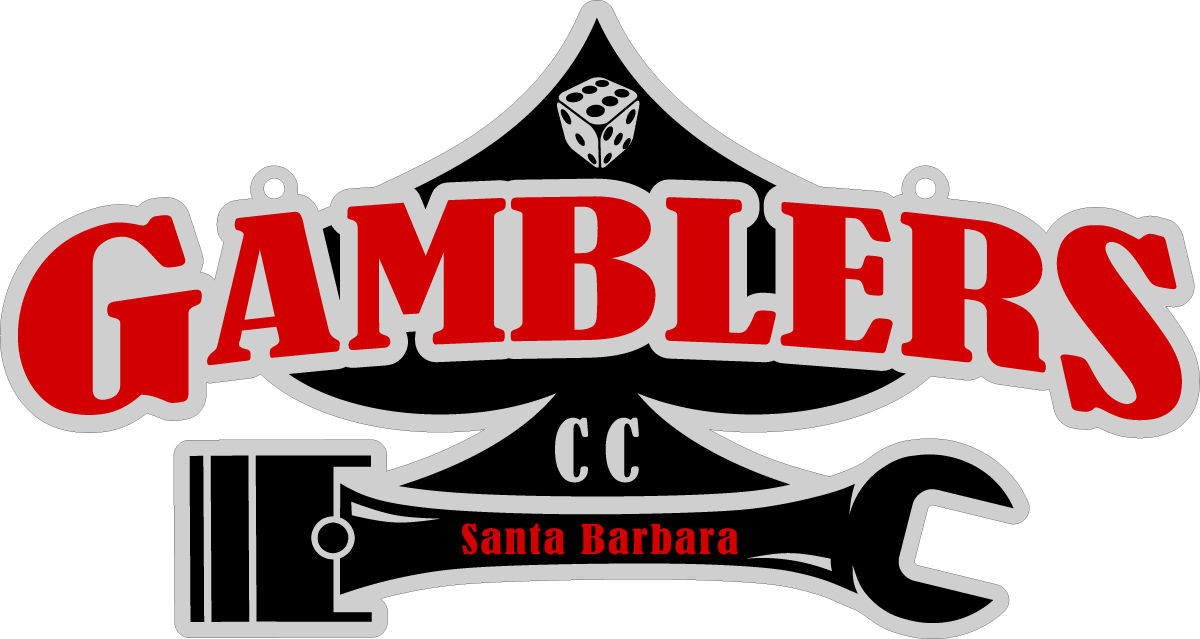

    Merry Xmas and my last offer 1:1 (5" x 10")
    Thanks to all who commented on it!
    The only thing left to do to get it ready for machining is to round up a few interior corners...

    37Nash,I don't think most plaque fabricators "machine" their plaques. They use some sort of sand process to make a mold so they can cast the plaques out of aluminum. So you would'nt need to worry about rounding the interior corners if they choose your design.

    Yep, cast. I'd also lose the little tabs on top and just drill holes up in the corners. Make it easy for the guys.

    i would ditch the 'cc' out of the plaque, makes it sound more like a lowrider club than anything i think. some good designs here. the cross pistons are cool, but look wierd without the crank journals.

  19. Piece of cake and we can get ALL of that detail in a sand casting w/o a problem. Everything White here would be raised (full 1/4" thick ) and everything Black would be recessed, correct?

    Great to know, thanks Dennis! You´ll use a pixeled image or the vectors? I can get you both, the original pixels for that one are at 3200 x 1600...
    Also thx to low. In the old school "dictionnary", i´m still at the table of contents page ... didnt know about the sand stuff
  21. Vector is better, I've been using Corel Draw for 25 years. But we can go with a high res .jpg too as long as it's all done and doesn't need any tweeking. .PDF's that are made up of objects are another good vehicle to send them.
