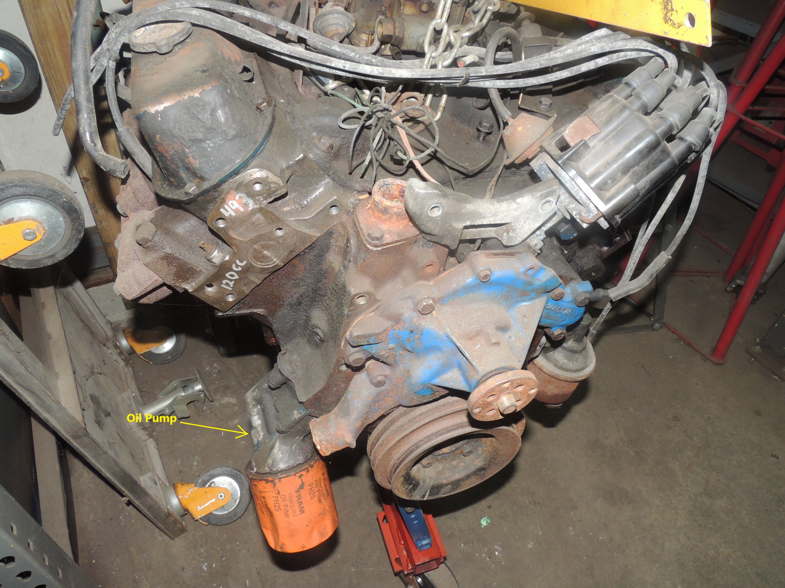

    Sorry Jim, but there have been a lot of engines produced over the years by GM and others where the oil pump does not reside down in the oil pan......its not a new only to LS or later model engines. Most if not all engines rely on a pick up thats submerged in the oil and a tube to transport the oil up to the pump. Some of those tubes are pretty long. The gerotor pump itself is a better setup because its run directly from the crankshaft and is a more efficient pump. Here is a picture of the oil pump on a 70s 500 Cad V8 like I'm putting in my 32.
    This engine is a front sump with a shorter pickup tube, but some engines were rear sump and had a much longer pickup tube. Since they are hard/impossible to get replacement tubes for, many people actualy buy LS pickup tubes and modify them to fit a Cadillac. Also the LS7 Corvette engines had a dry sump that used a 2 stage gerotor pump (inch longer crankshaft) right from the factory. It must work fine if they relied on it to oil a 505 (+) hp engine and warrantied it.
    On the other hand, I think some of the smallblocks had problems with getting oil to the lifter or rocker arms on one of the cylinders, but don't remember the details. I know that the distributor can also cause oiling problems if the groove in the distributor isn't positioned or machined correctly...again, something an LS doesn't contend with. Both are good engines in my opinion, but both can benefit from detailed ***embly.:)
    Edit Note. The LS7 505 hp is installed and also a crate engine. GM sells other crate versions of the LS that are rated at more than 505hp and use conventional gerotor/wet sump.

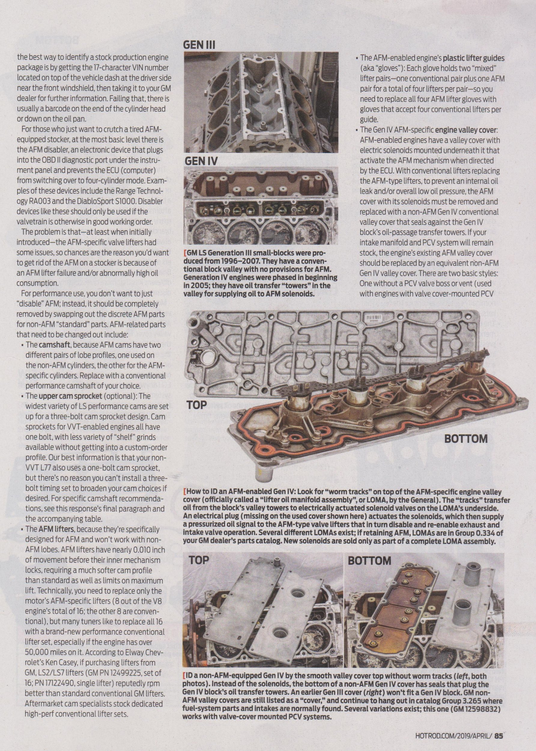

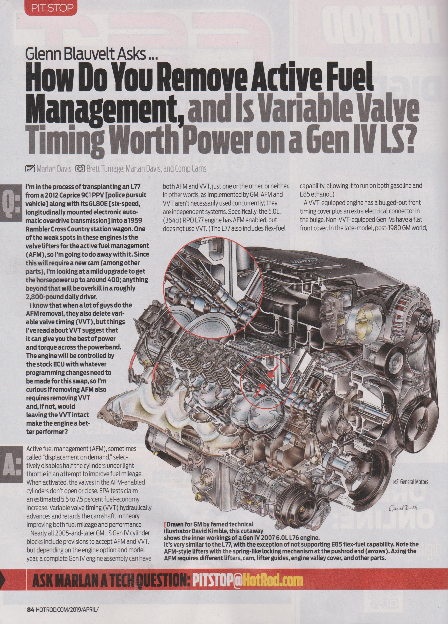

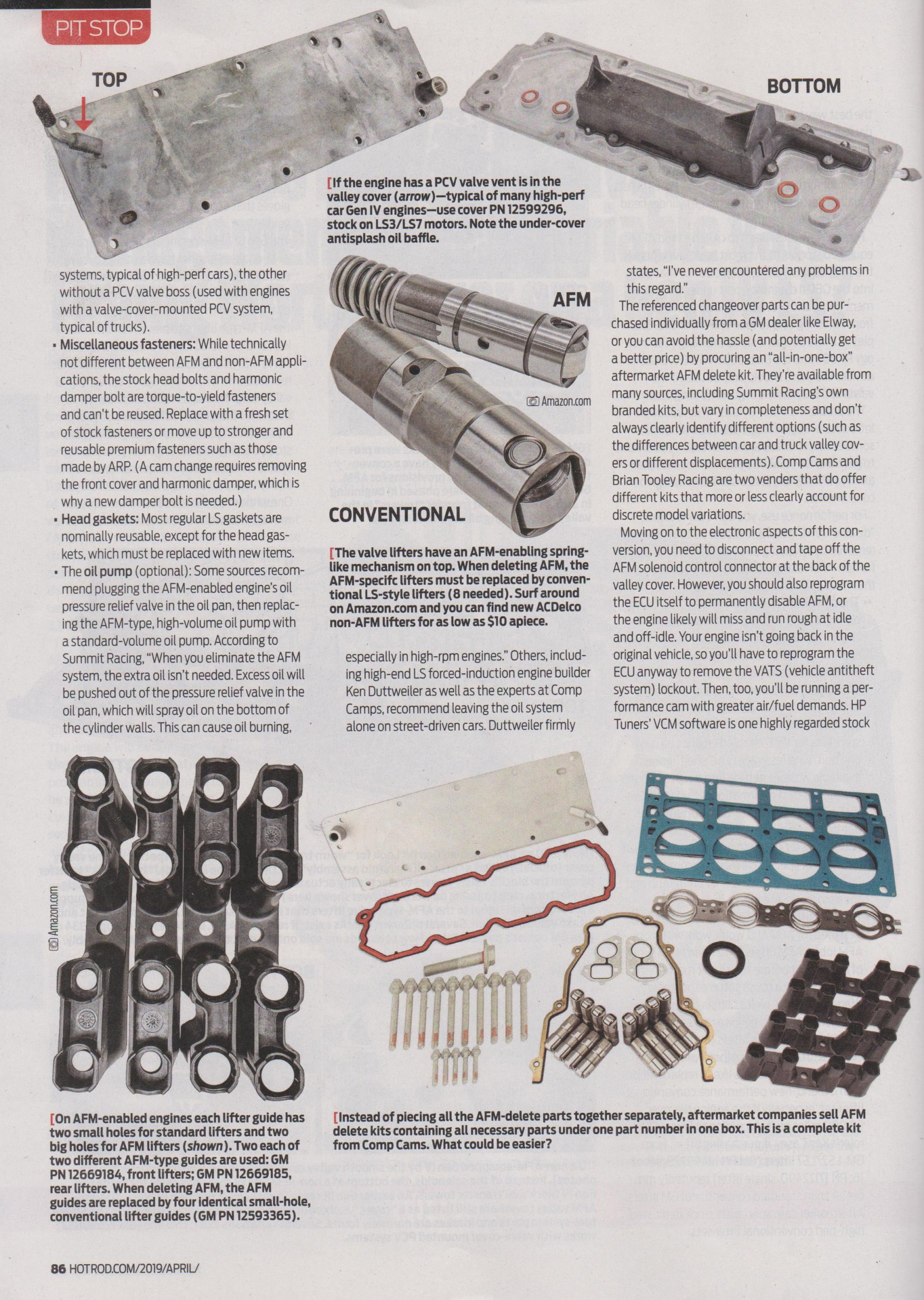

    Let me be the first to admit that the DOD (Displacement On Demand) by not operating some valves is responsible for Gen 4 LS problems. So while not an expert, let me try to make a little sense of this GM lineage.
    Gen1
    The original "smallblock" was referred to as Generation 1 That includes all the variations and displacements from 1955 up to around 2000+ when they quit installing them in vehicles. (Trucks)
    Gen2
    Came out about 1993 and lasted about 4 years. It had reverse coolant flow, fuel injection, and an optical spark (light) triggered ignition.
    Gen 3
    Came out about 1997 and was an all new engine referred to as an LS
    Gen4
    Don't remember what year it was introduced but it had "upgrades" (?) incorporated but is basically the same engine. One of those "upgrades" was to add some towers inside the block for some different lifters which could be deactivated to increase fuel mileage. That has proven to be a problem. My son's truck had to have them replaced.
    Anyone buying the Gen4 will most likely buy the components to get rid of the DOD, and when thats gone the engines become much more reliable. Some never give a problem, but some do when they have the DOD.
    Gen 4 blocks can be distinguished by towers within the valley of the block. Generally the cast iron blocks are more popular because they can be bored out. The aluminum blocks have minimal thickness on the sleeves and can only be honed slightly or new liners ($) installed.
    So this is a little info to tempt some of the ******** smallblock guys................
