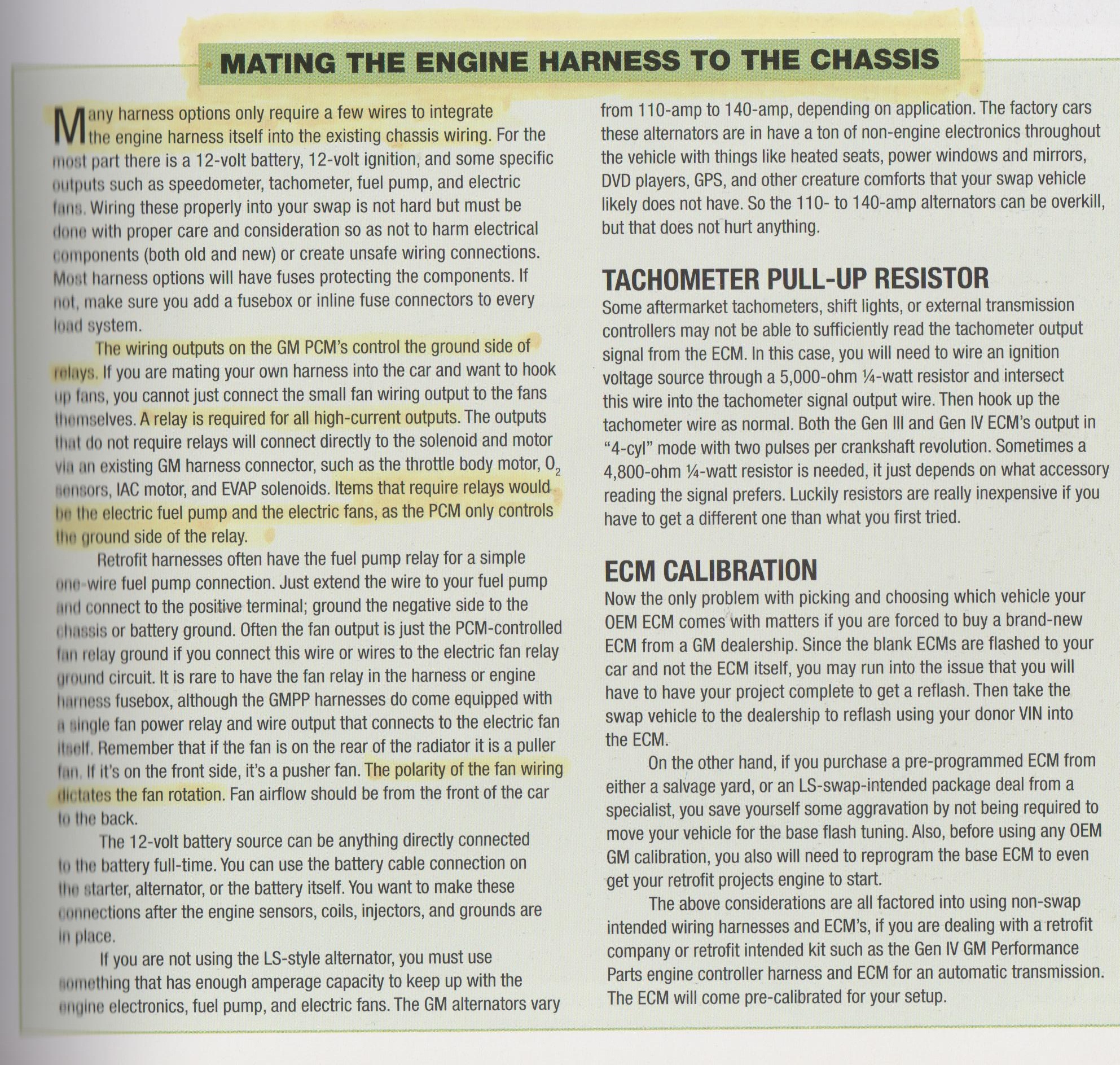

    There are other books available that explain this stuff, but this one is more gr***roots.
    Most aftermarket computer systems have very few wires to hook to the cars original wiring (4?). The rest of the wires are labeled to simply plug onto the sensor they go to on the engine. Best of luck to you on getting started with this stuff. If I can explain or help let me know. I'm not an expert, but I grasp the basics.:)

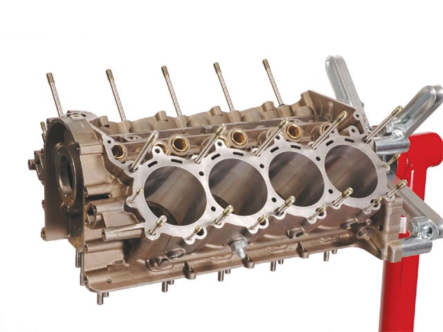

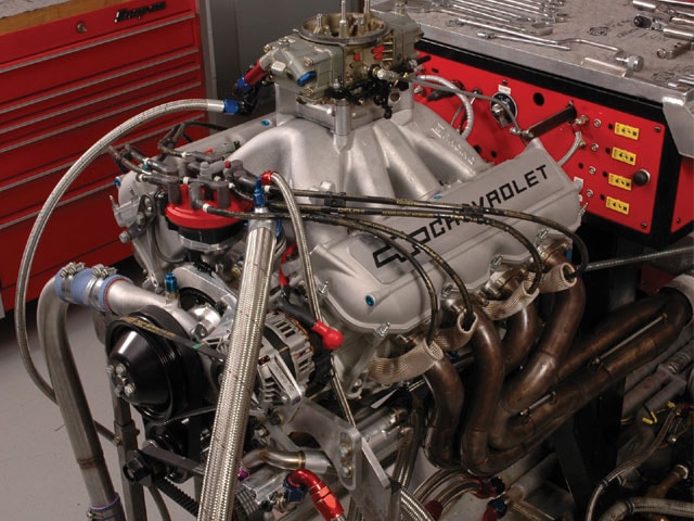

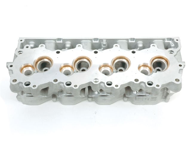

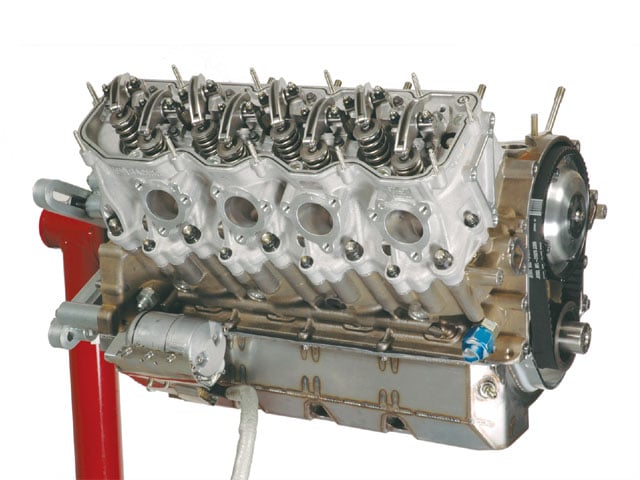

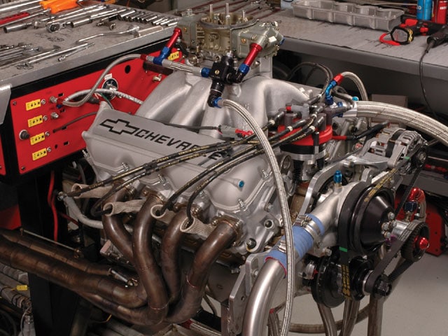

    Why not a chevy RO7 motor????..... hrdp_0803_02_z-chevy_nascar_engine-.jpg hrdp_0803_03_z-chevy_nascar_engine-.jpg hrdp_0803_05_z-chevy_nascar_engine-.jpg hrdp_0803_04_z-chevy_nascar_engine-.jpg hrdp_0803_06_z-chevy_nascar_engine-.jpg hrdp_0803_08_z-chevy_nascar_engine-.jpg turning-a-nascar-r07-engine-into-a-serious-streetstrip-package-2021-05-19_19-12-49_178675.jpg turning-a-nascar-r07-engine-into-a-serious-streetstrip-package-2021-05-19_19-08-14_193806.jpg

  13. SS327
    Joined: Sep 11, 2017
    Posts: 3,926
    SS327
    Never heard of it before. What is it?
  14. mohr hp
    Joined: Nov 18, 2009
    Posts: 1,586
    mohr hp
    from Georgia
    NASCAR stuff.
    Deuces likes this.
  15. Deuces
    Joined: Nov 3, 2009
    Posts: 26,744
    Deuces
    Yep! Chevy has been using those since '08 I believe.... 960 ponies from a 358 ci motor.. With 12.5:1 compression..
