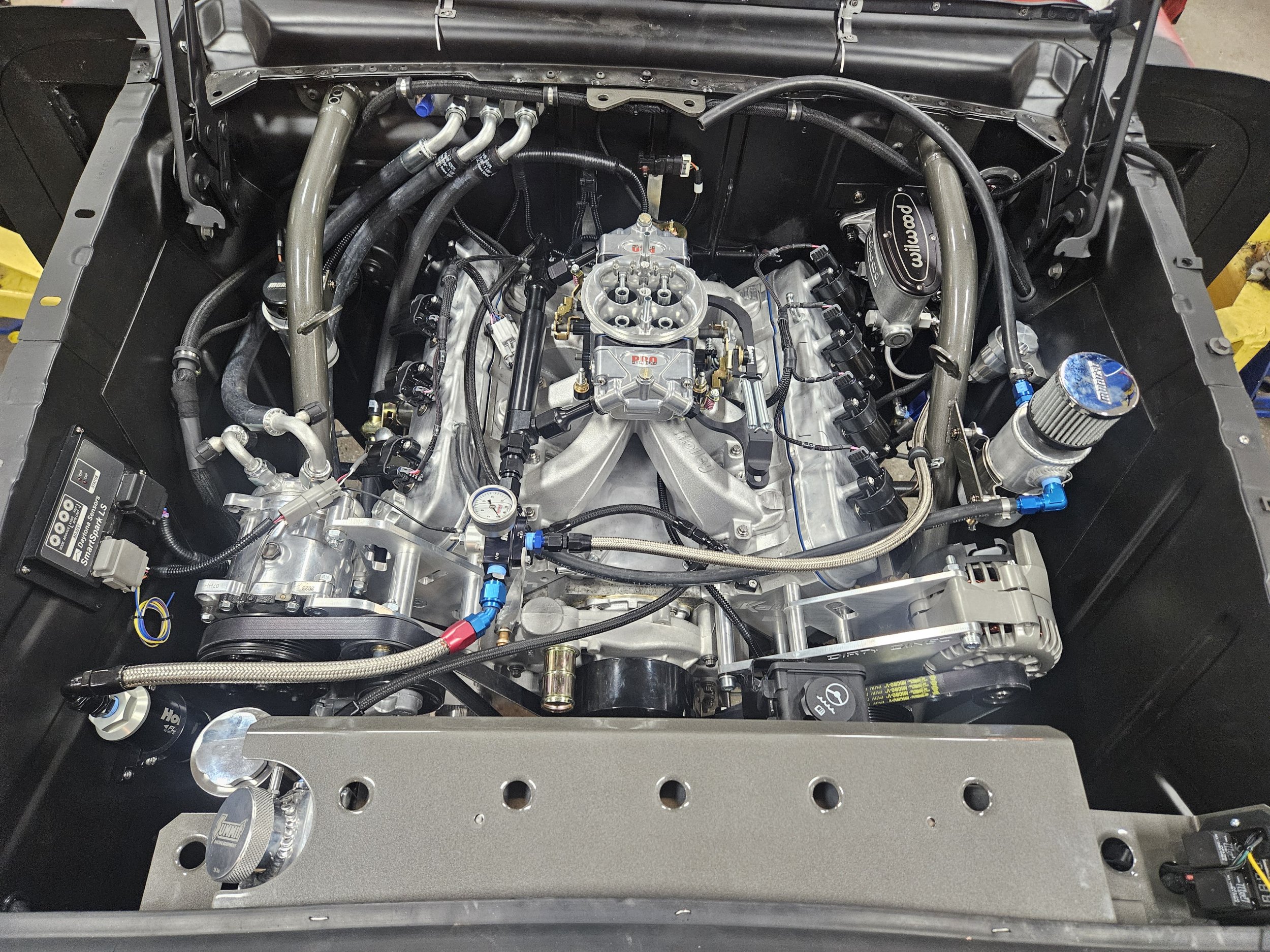

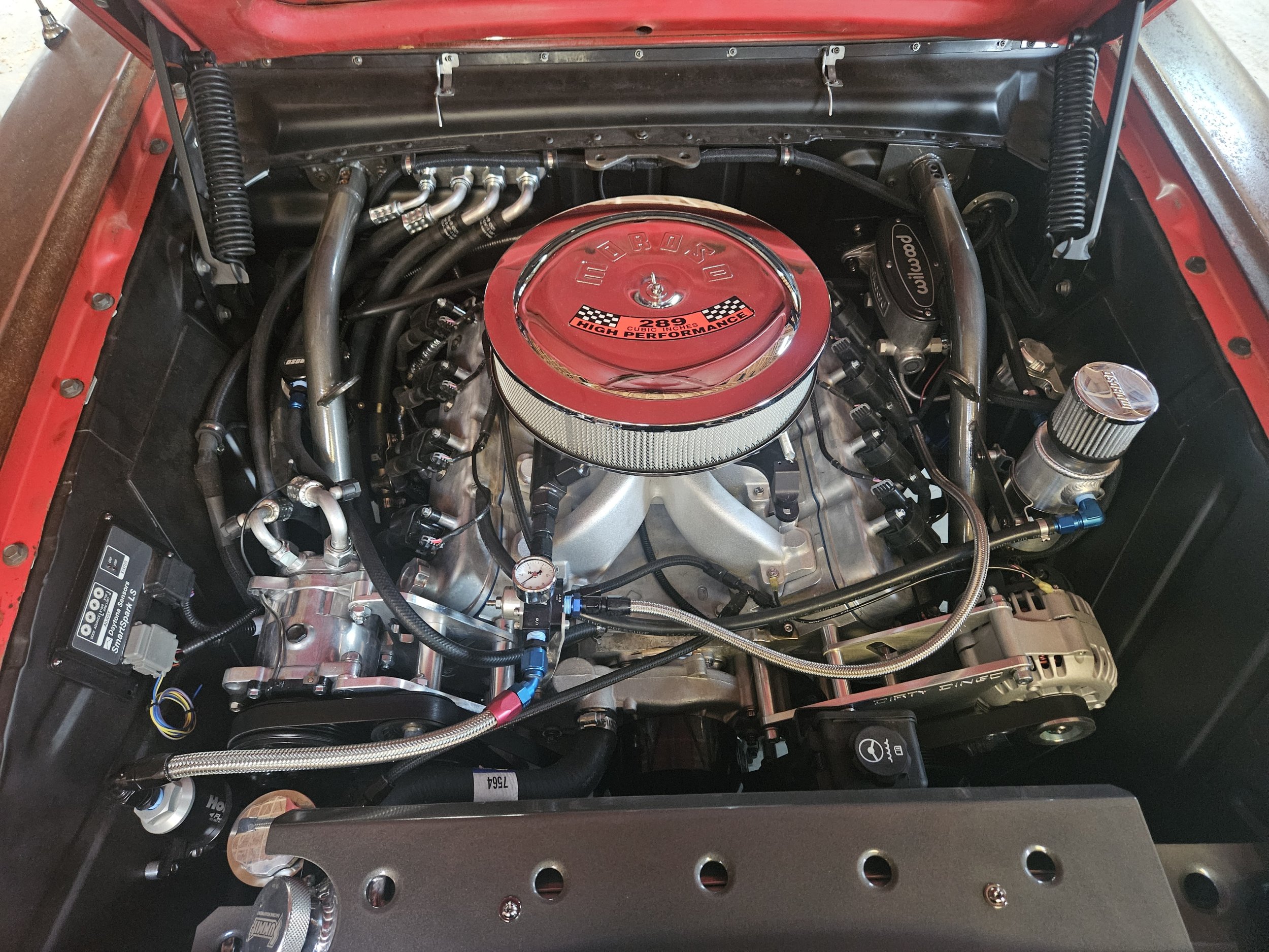

    Well my latest l.s project. Bone yard rescue of my uncles ranch. Built it to be my little parts chaser. Nice suspension. Good brakes txk 5 speed. 5.3 ls ac ps and through the muffers with zero tuning at this point into the 11s. Very mild motor.. labeled it a 289 and the vast majority think it really is. Lmao... the old guys are the worse always telling their buddies.... yep had one just like that back in the day... finished the car the night before( not a race car) and ran the 2024 redwood ralley. 5 days a track 1000 miles. Dead on reliable other then I hurt the ****** 1st day and was still able to run 11s. Fun little car.

    very clean, thanks for posting

    Partsguy57
    Lol it amazing what the sticker does. I posted in a couple of ford in a ford only forums nothing but thumbs up and postive comments. I only had one guy call me out. Most of the l.s haters have no idea what they are looking at, zero experience and their arguments are silly for hating on. I get it old school is cool. ( I have some of that also) but their arguments are based in emotion vs what is. The l.s is superior to any old gm ford mopar small block period if performance reliability and low cost is the goal. All the same reasons the 9inch ford became so popular. Inexpensive and it works. Its fun to open the hood and sit back and listen to the comments. The vast majority of comments by the " expert" are wrong and the buddy with him just agreeing with him. My other l.s ride.. It get down the road just fine.

    Seriously though that is one of the finest examples I've ever seen for an LS installation and I appreciate you sharing something with us where mechanical execution is fine enough to be "artwork" IMHO . I bet when you go chasin parts, ain't too many of them that get away! :)
