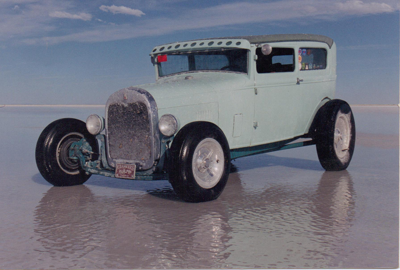

    This sedan has given 30 years of good, reliable service with a 3.8-litre (231 cu. in.) Buick V-6. It has a full firewall and stock gas tank with a Turbo 350 GM transmission. Block hugger headers that fit under the hood and the aftermarket 4-barrel aluminum manifold keep it peppy and the unique exhaust note is pleasant.

  10. @Stan Back I have always liked your car (from the first time I saw a pic of it) and the V6 just makes it better (I like them too). That said pics of your car always look like a model car. I don't know what causes that but it always reminds me of a model car.
    Please don't take this wrong. Not trying to insult a well built car.

    I've had mine up to 100 going to Bonneville. A little scary as the back wheels aren't balanced (and one's welded up). I just wanted to see what it would do (It shook a lot). Gas mileage is good -- got from Ely to Tonopah on less than the 10-gallon tank -- I thought there'd be a station at the major statewide intersection. No worry, there'd be another car along sometime that day.
