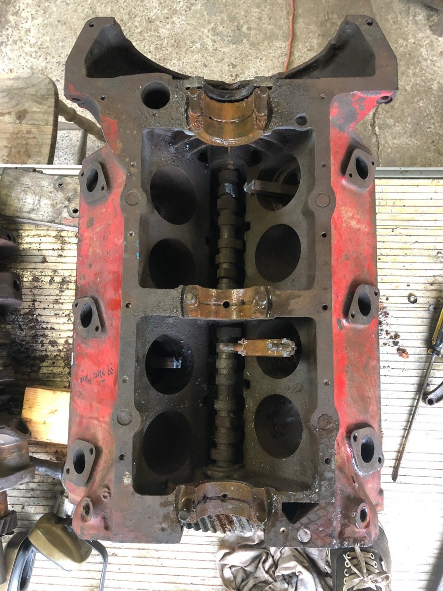

    Last week we dropped the 59a block off at the machine shop for bore, hone and what we thought was one sleeve. Thing took a turn south when the Guys phoned and let us know it was going to need 2 sleeves, Plus there were a few helicoils in where the head studs why I had purchased a 99a block from Good friend BiG TiDdAys not to long ago which had been nicely 'Seasoned', And was ceased pretty badly, Still there was a possibility it was going to be better than the 59a and had the added bonus of previously being ported, And factory relieved.
    A mid week conversation With John had us thinking that we should probably tear into it and see what we were working with. Which was fine by me because as nice as an 59a is the one i have inst the greatest, I feel like putting the effort into the 99 is just that little bit nicer. thumbnail_IMG_4956.jpg
    So monday morning seen some rain and i tore up to johns to get stuck into this motor with him, With only one real goal, get what was left of this motor torn apart. IMG_4954.jpg
    We tried a few different methods but in the end a near metre long punch and a sledge hammer was what free'd most of them off,You can see in the photo above the skirt broke off the pistons as they became free. IMG_4959.jpg End caps came off pretty nice, They cleaned up well and will be salvageable i think.. The pistons and rods on the other hand.... IMG_4963.jpg
    Most came free with a decent knock but there were a few that we couldnt gain access to because where the crank was stuck, Out came the Oxy.
    John with the honours, I dont think he trusted me with this job...Ha!
    Crank came out alright, This may still be usable. it looked like someone had cleaned the crank journals once before though, as the flatheaded screws had been replaced with hex head ones.
    So the blocks been at the engine shop for a week now so hopefully ill hear something over the next few days. Fingers crossed this one is useable!

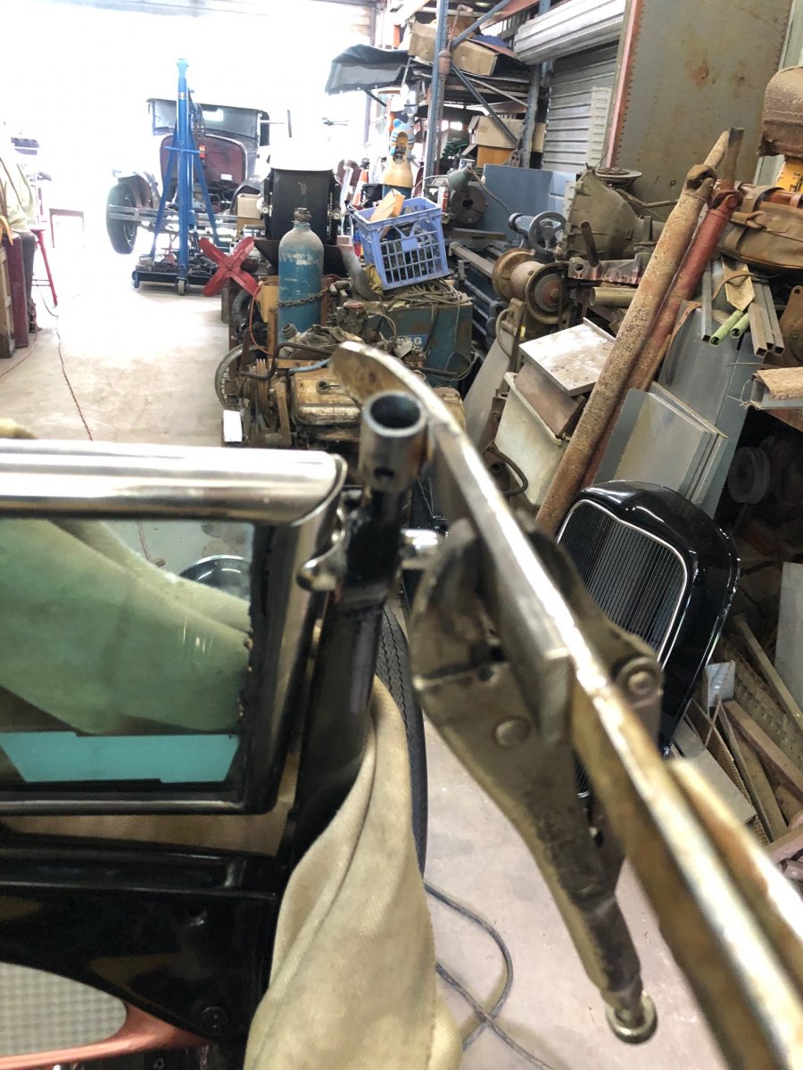

    we ended up cutting about 4" straight off the bottom, Slowly & in increments but this is where we ended up
    we cut the timbers down bit by bit and got them to sit where we thought was a good height. I didnt take any photos but we'd had the blankets on and off a couple of times trying to work profiles out. I think were pretty close, maybe we need to come down a little more but next time ill grab a heap of masking tape and take that up, and then we will be able to get a definitive profile happening.
    John here holding the front bowe,
    We may still need to do some height adjustments as it certainly looks tall from this angle. But were making headway none the less.

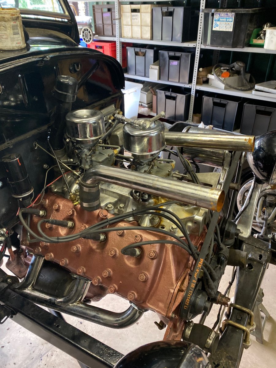

    A week or so later after organising freight it arrived at work and i was pretty stoked with what i saw..

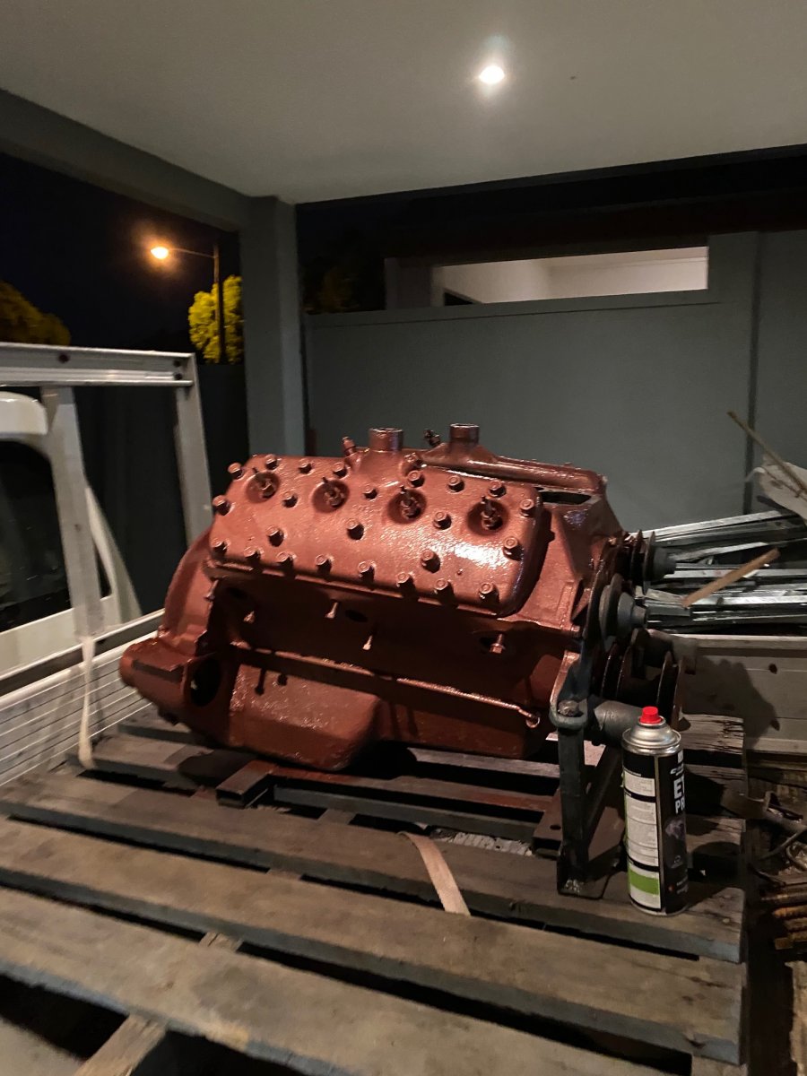

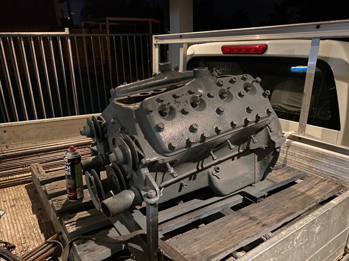

    The motor is an 81T, Which i didn't know a lot about, But after some research i believe these came out in Ford & Mercury trucks, It has keystone water p***ages, raised intake deck, big truck sump plug & removable section to remove the flywheel without having to take off the sump. IMG_0287.JPG IMG_0286.JPG
    I took it home that night & begun stripping it down to paint the same colour as my previous motor, Which matches the dash that's still in the car
    I painted the motor in the back of my ute under limited light but it turned out good enough. I wasn't going overboard on trying to make this motor pretty as theoretically its only temporary.
    I hit it with the pressure washer and rattle canned it right there. It stayed in my ute for a week or so before i could get up to Johns place to work on it.

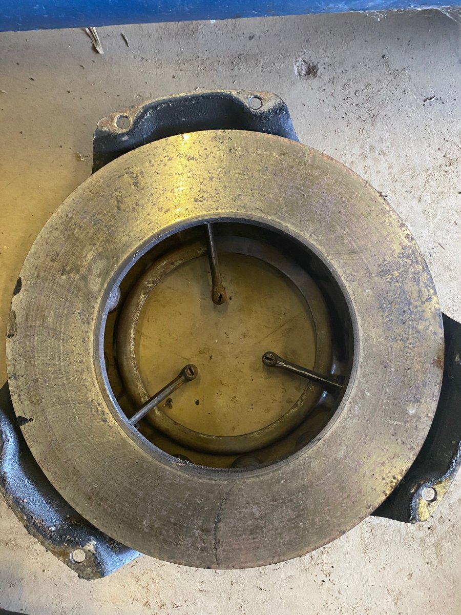

    It has a 10" clutch, IMG_0487.jpg I gave it a lite scuff and threw it back in, Everything looked really nice. IMG_0486.jpg

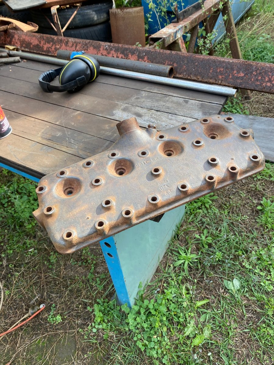

    Hours of drilling, Grinding, tapping and picking bits of bolt out of the original thread later we had it. The tick with removing snapped bolts is most certainly patience. I think if i ever did that again id have to leave it for a week before even looking at it, Otherwise it'd be screwed up before i knew it.
    Came up pretty damn good i reckon.
    We left the head off and decided best thing we could do to finish the day would be to drop the motor back into the car.
    I went home that night, And would head back first thing the next morning. I got up there for 6am start Tuesday morning and got straight into re installing all the bolt on parts i could whilst John was getting ready for the day. Intake manifold and carbs, Mechanical fuel pump, Header pipes, exhaust & starter back on. It was time to try find another head to replace the one id broke off thinking i was working in a junkyard ( Says John) IMG_0508.jpg Its funny cause i was a tiny bit bummed id ruined the head that came on the motor trying to remove it, Id nver heard anything about an 81t before, But the more i looked into it, The more i liked the idea of it..
    John goes to the stash and whips out a stack of heads, Some 21 stud, Or pilot. The best looking one kinda got pushed to the side the night before we had a proper look over it this time and it turned out to be the exact head we needed, Not that any of that really matters but its such a sweet little motor i felt bad about smashing the head up. So finding the exact same one made me feel a little better, I wire wheeled it, repainted and put it back on the car. IMG_0518.jpg

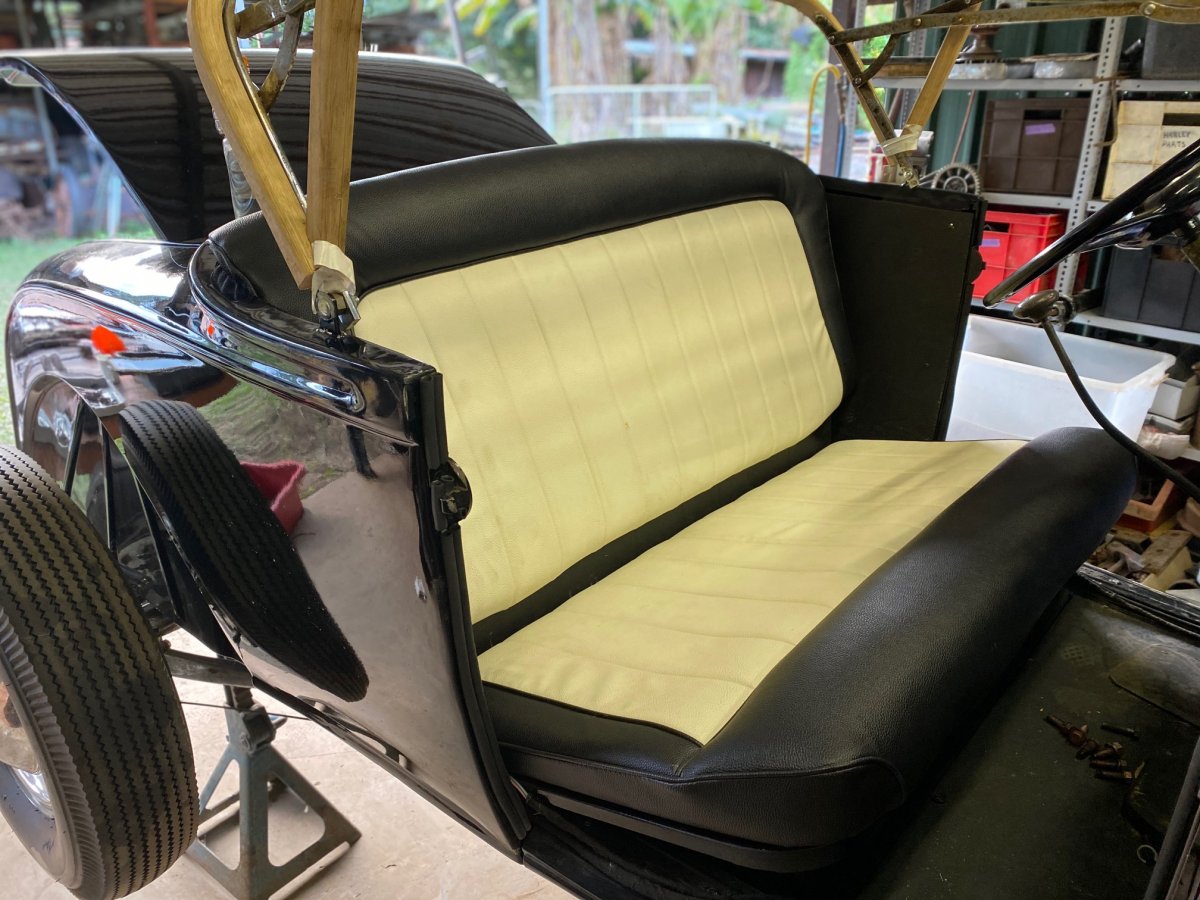

    About this time, Rowan the trimmer had shown up with my seat he had been working on.. We were in the midst of building the roof frame for the car before the current Pandemic so was a god chance to see how i was going to fit with the seat cut down.
    The bottom of the seat frame had to be dropped a little to get me in so thats the gap you can see. But we will sort that with a long cushion style of thing that sits between. Overall the seat is super comfortable and I'm stoked with the result.

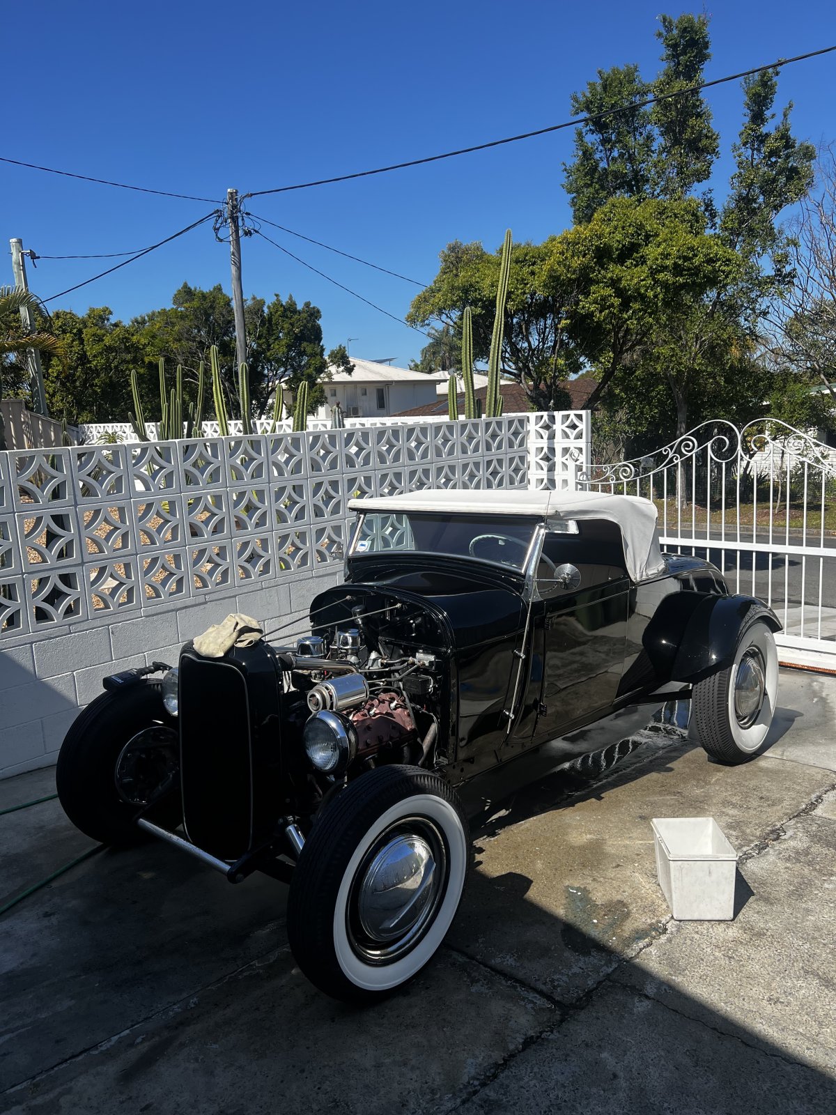

    Its been the better part of 5 months since I've posted any updates here, And a lot has happened.
    I ended up getting the engine back in and car on the road, And it was good for probably 4 weeks.
    thumbnail_IMG_2581.jpg Till one morning i got a little exuberant leaving a friends shop and dumped the clutch a little harder than i should have... The results were unsurprisingly obvious thumbnail_IMG_0855.jpg

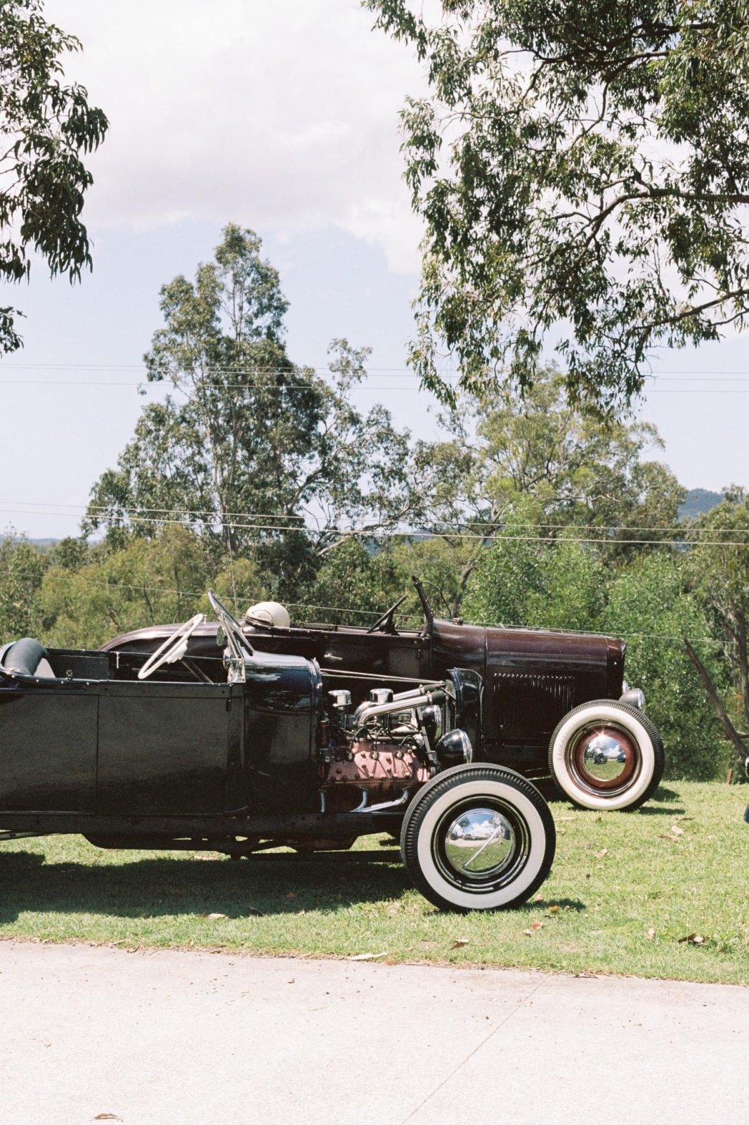

    Fast forward a few months the car had been back on the road and things were going just fine. Covid had hit here but despite this a bunch of friends were still able to get to gether down at the lake for a few nights of partying & BBQ!
    Josh's *****in 32 roadster ( The rock spider) & mine on the way out to the lake
    Getting setup next to Paulee's 32
    some good bbq!
    Fellas
    Good times had by all! thanks again for the Barons for having me along! It was fathers day so we made a quick stop on the way home to see John's fathers grave. Was a cool moment thumbnail_IMG_2207.jpg
    Back to reality and I scored some fenders locally one off a friend and one from a local parts dealer ( Thanks Bojangles) thumbnail_IMG_1523.jpg
    Got them home, cut them up and put them on the car, With the T spring and my frame having a small step I didn't really like the way the car sat.
    So I lifted the rear up a little by adding a few leaf's.
    I was much happier with how the car sat. thumbnail_25EDA010-E092-4F70-9B2C-83970885C003.jpg thumbnail_IMG_2901.jpg

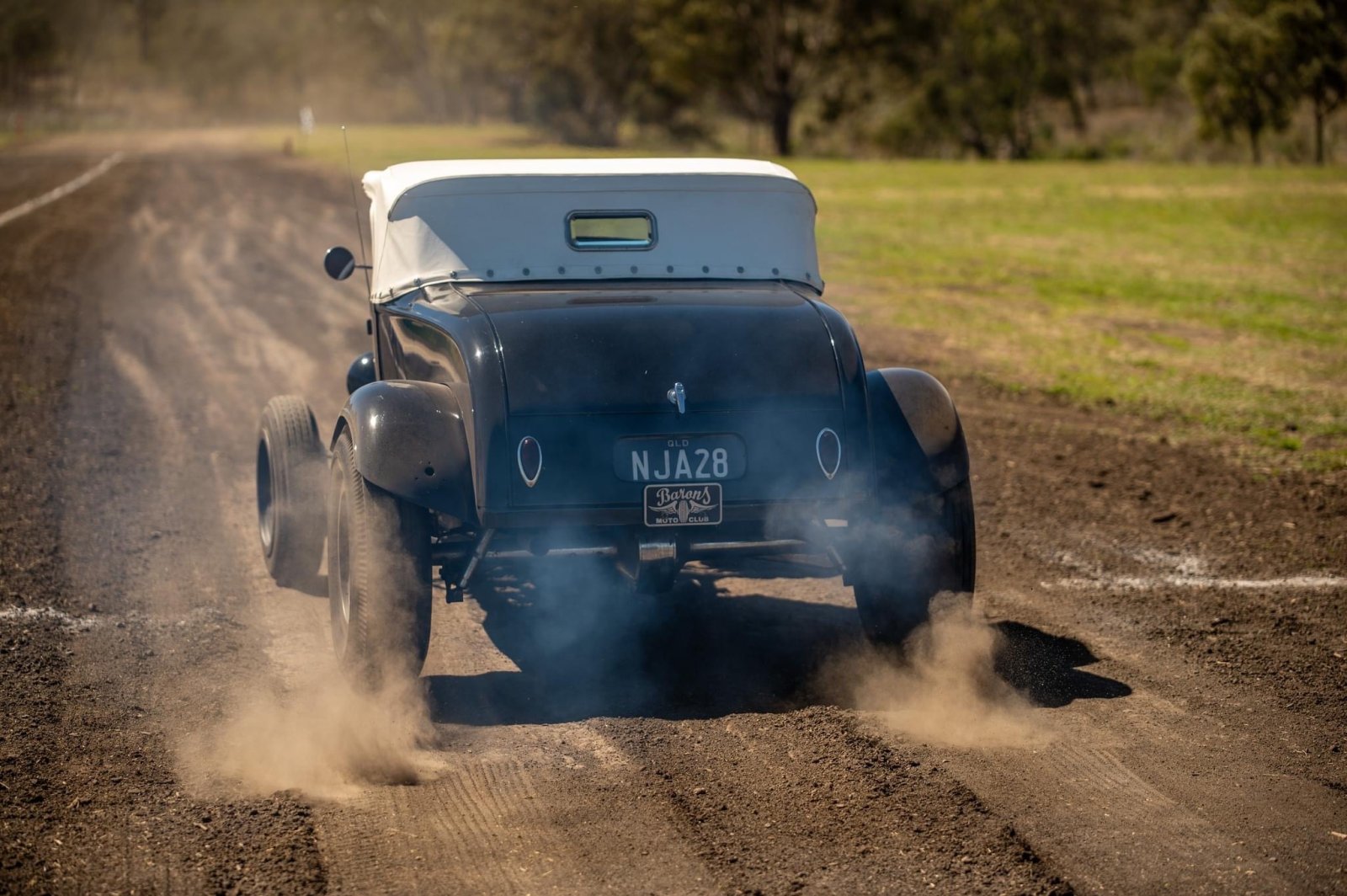

    It's been 4 years since I last posted on here, Wild.
    Tonight found me talking about a seat with a friend in his roadster, So I returned to the blog to try find a reference photo for him how I did mine, I kinda forgot how much work went into this car, So much has happened. But, if anyone is interested and still reads blogs, here's a little update.
    The car has been driven at least twice a week for the past four years. Ive changed it up a little again with a set of American racing Mags. I like this look on the car best.
    The old 81t I installed as a temporary motor is as tired as ever but keeps going, Ive also blown another 1st gear doing burnouts leaving the bowls club - Still haven't learnt. So for now it's just a 2 speed.
    Reading back through all of this made me realise how luck I was to have the people help me that did, I cant thank John Parker & Matt Teece enough.
    the 99a Engine is done and has been sitting on my workshop floor for the past two months, whilst a certain Porsche project takes up the room I need to switch the motor and trans out.
    This car has been driven up and down the east coast of Australia, had many good nights with lovely ladies and I think it's a bit of a testament to what these old cars are still capable of.
    Anyway, I'll try upload some photos of the car being used the past 4 years.
    Hope everyone is well, Take care.
