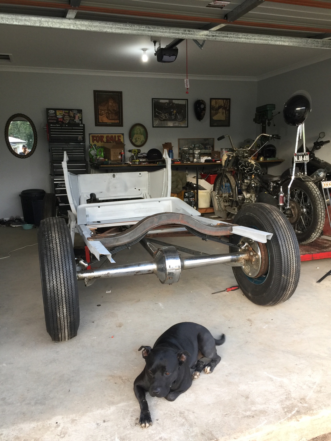

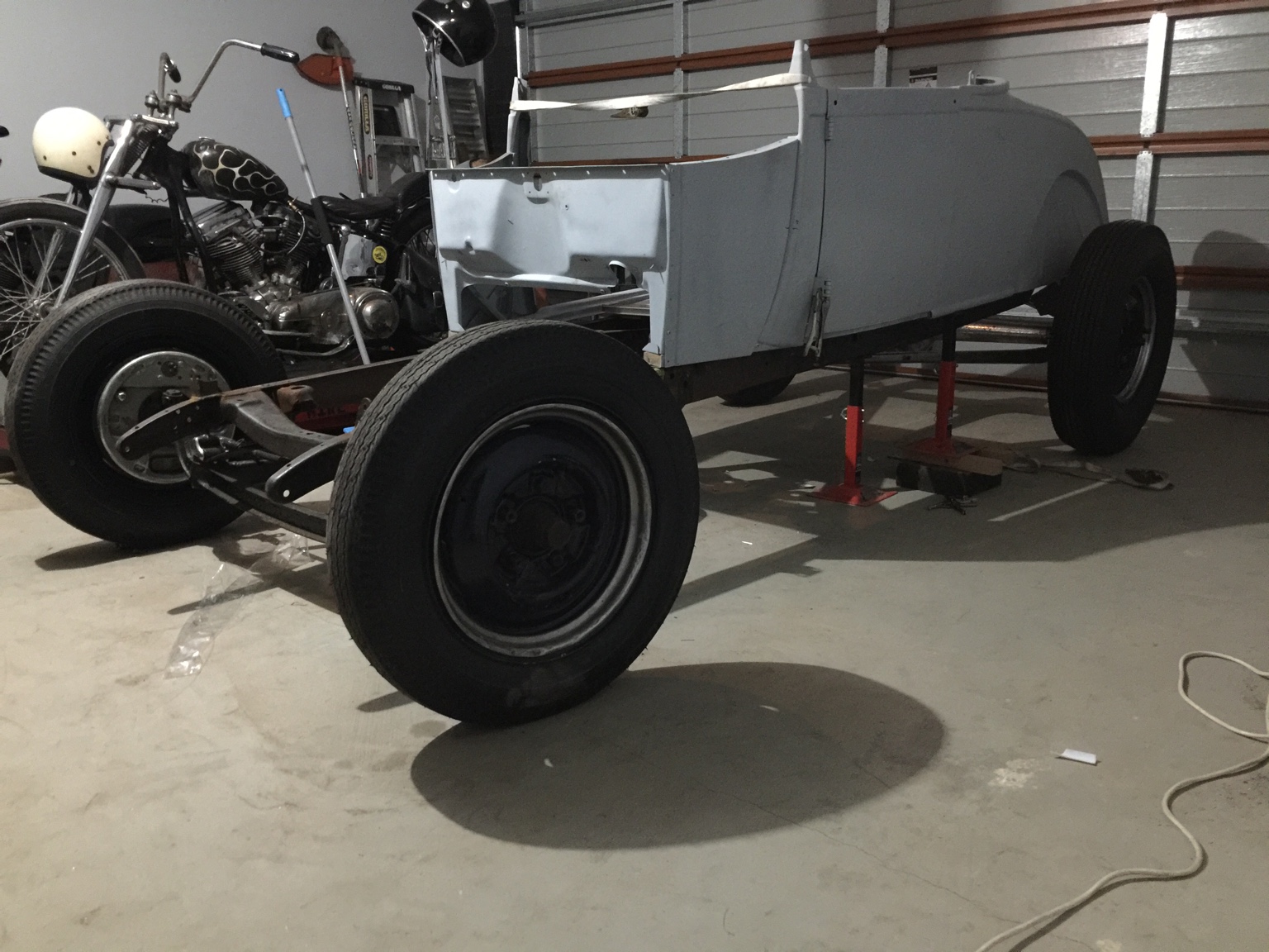

    Well today was a reasonably successful day, I was able to tap the body mount holes. Set up all the wood for the body mounts. Cut away the subframe to fit the step in the frame and started mounting the cowl.
    I was able to find a pretty good photo of a subframe with all the required measurements so I used that basically referred back to that the whole way through setting up mine,
    I took some advice from members previous comments, left the floors unbolted, and used sheet metal screws the whole way through, which was great for adjusting along the way.
    Here are some photos [​IMG][​IMG][​IMG][​IMG][​IMG][​IMG]

    I did not read every post so I may have missed something...
    At a glance it appears you are not channeling the cowl, but cut the rear subfloor at the rear crossmember, did you run the wooden mounting blocks? ... just my $.02 ...
  13. Nick Agius
    Joined: Jul 29, 2015
    Posts: 157
    Nick Agius
    The frame is stepped in the rear, had to cut back the subframe to clear that..
    wooden blocks are used throughout

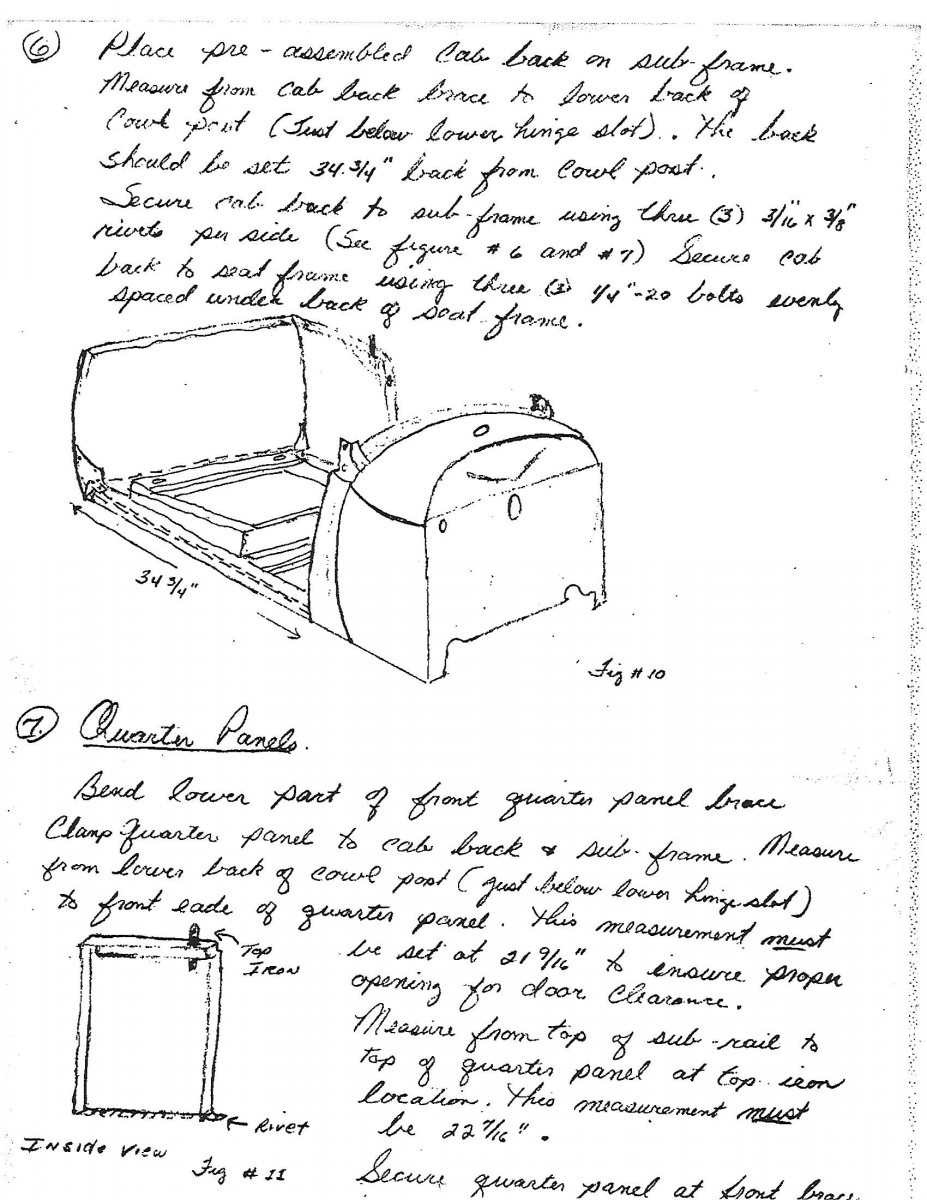

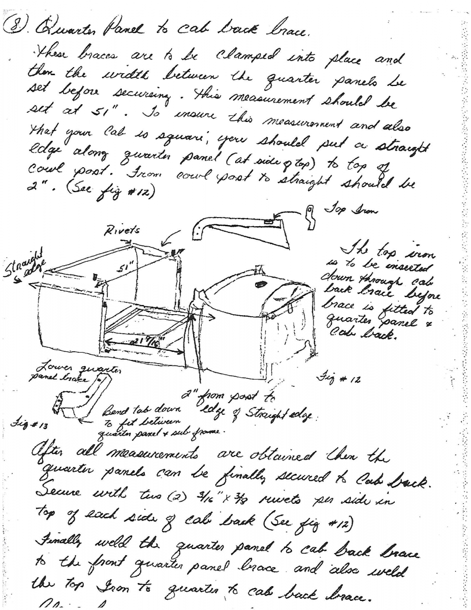

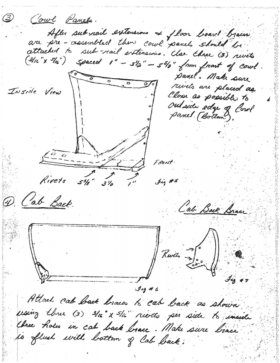

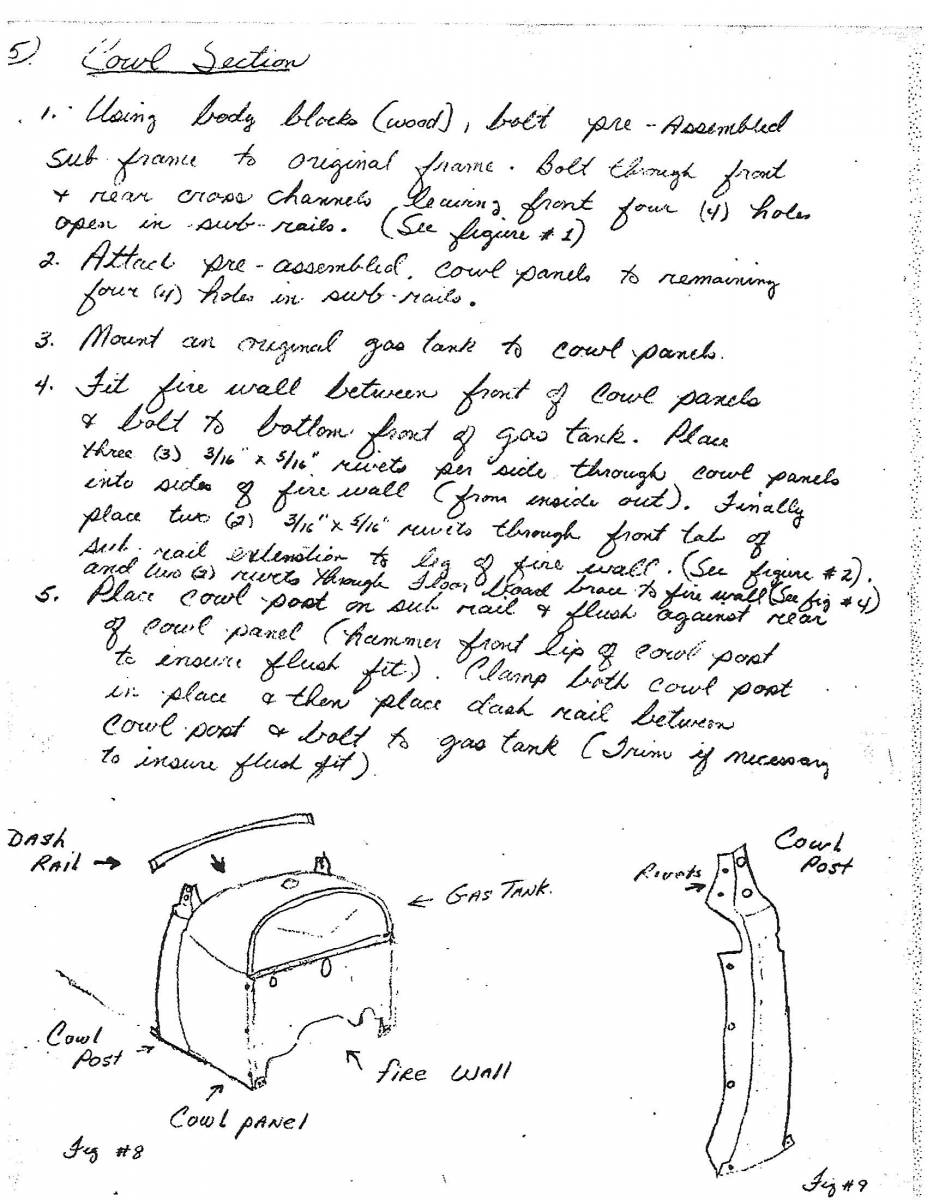

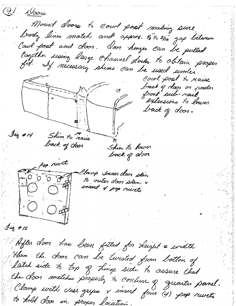

    Several years ago I bought an un***embled 28/29 B'ville Roadster body at a swap meet. What a mistake. Some parts were 28/29 some were 30/31. What a deal??? I tried to find any info I could to put this together to no avail. Finally I called Brookville looking for any drawings, dimensions, anything helpful... Nothing! I kept asking questions and they finally sent my call to Rick in the shop. It turns out Rick and his crew are the guys that ***emble the 28/29's in the shop. Rick was GREAT. After picking his brain for a while he said "How about if I drew some sketches"... BINGO!!!
    Attached is a PDF of the sketches Rick did for me. Enjoy...

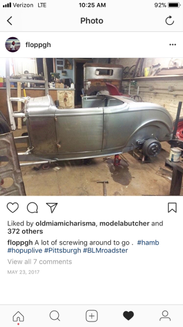

    Still this was not enough. I spoke with Flop and he filled me in on the areas where I had to cut and weld to make things fit. Thanks again Flop. You would do well to search out Flops build threads.
    Best of luck. I'll be following this thread so if I can help, let me know and I'll do what I can.

  23. Nick Agius
    Posts: 157
    Nick Agius
    Woah, those drawings are awesome! Thanks so much!!!

    information like this is hard to find.probabally because most guys are just barely getting by and most cant draw like flop and even less can understand them.good luck with the build

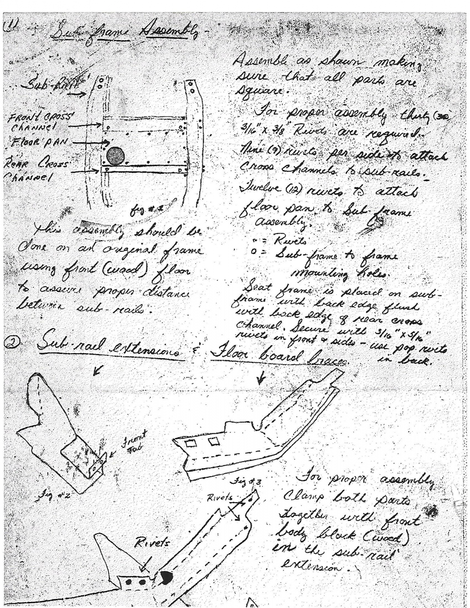

    I've received an email from another member including more sketches in regards image (1).png image (2).png image (3).png image (4).png image (5).png on how to ***emble, Thought id put them up here for anyone doing this in future.

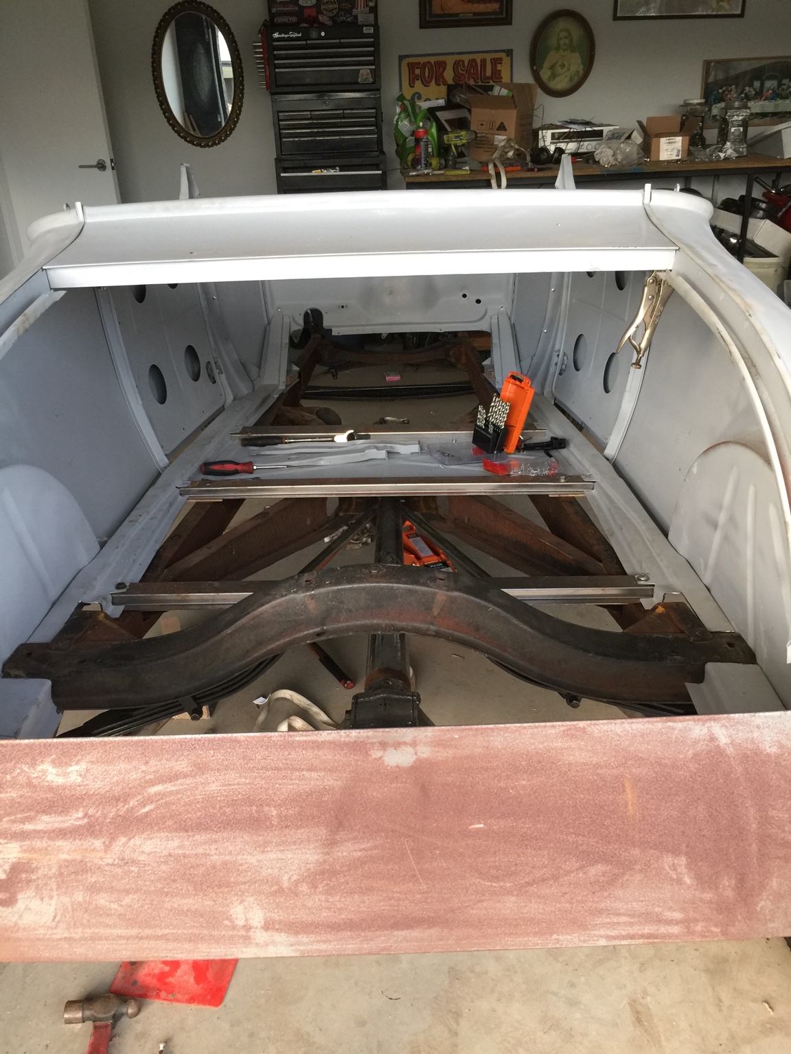

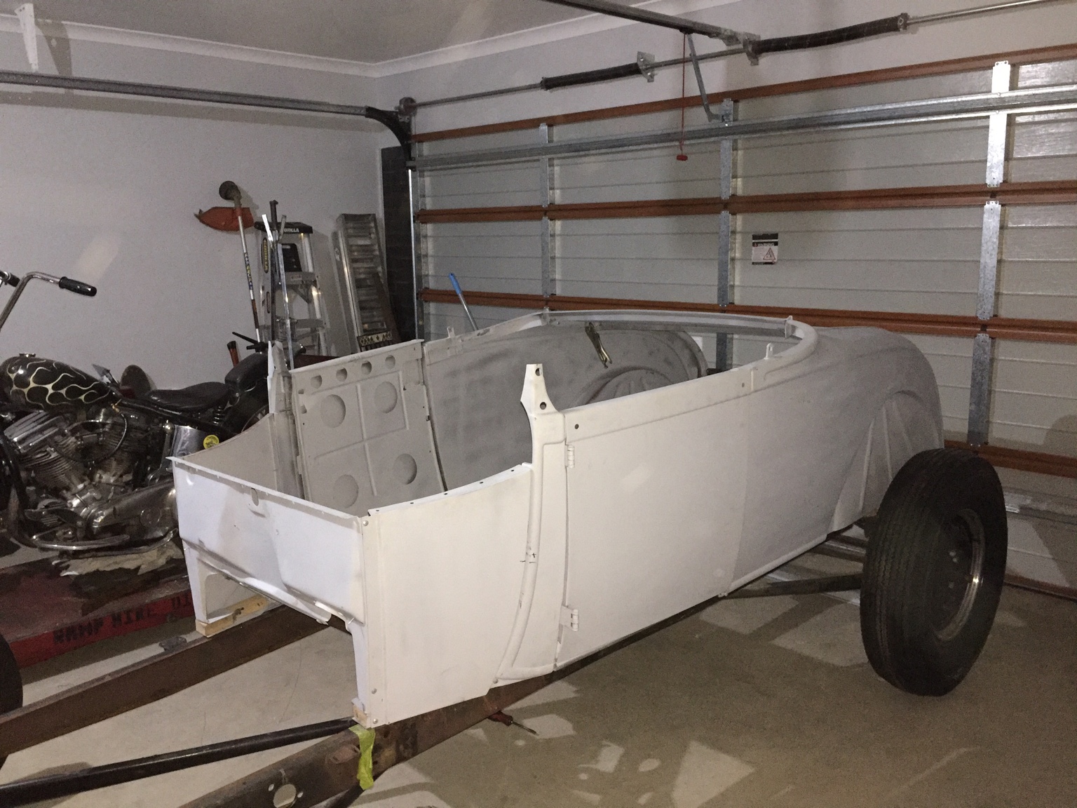

    Made some more progress this Sunday. Cowl tank gets picked up tomorrow so once I’ve got that in it’ll be a true tell tale as to how far in/out it really is.
    I haven’t taken a lot of measurements doing this, in fact I haven’t taken any since ***embling the subframe. Not the most correct way I know but the only way I could really do it was to just get it done.
    Here’s some pics
    Please note I had the below boot panel in too low and have since adjusted it
    [​IMG][​IMG][​IMG][​IMG][​IMG][​IMG] [​IMG]

  30. I just saw you're in Brisbane too, and looked on your profile and only two years younger than me! Coming along awesome so far dude! What side of Brissy are you on? You're welcome to come look at my roadster if you need to. My cowl and doors were original and the whole back is Brookville as well. I have some photos of how i got mine going but in short.. build the subrails first, didn't realise i'd then have an issue getting the cowl in so split the first cross piece to get it stuffed in there.. then i had some measurements that i took from Burleigh Roadsters when i was there and hung the quarter panels with the gaps i measured and then got the doors hung and so forth..
    I had an issue with the boot area and the drip rails and stuff. Maybe ***embled a little wrong but i had to section out 5mm from the top rain gutter piece because it just would not fit at all.
