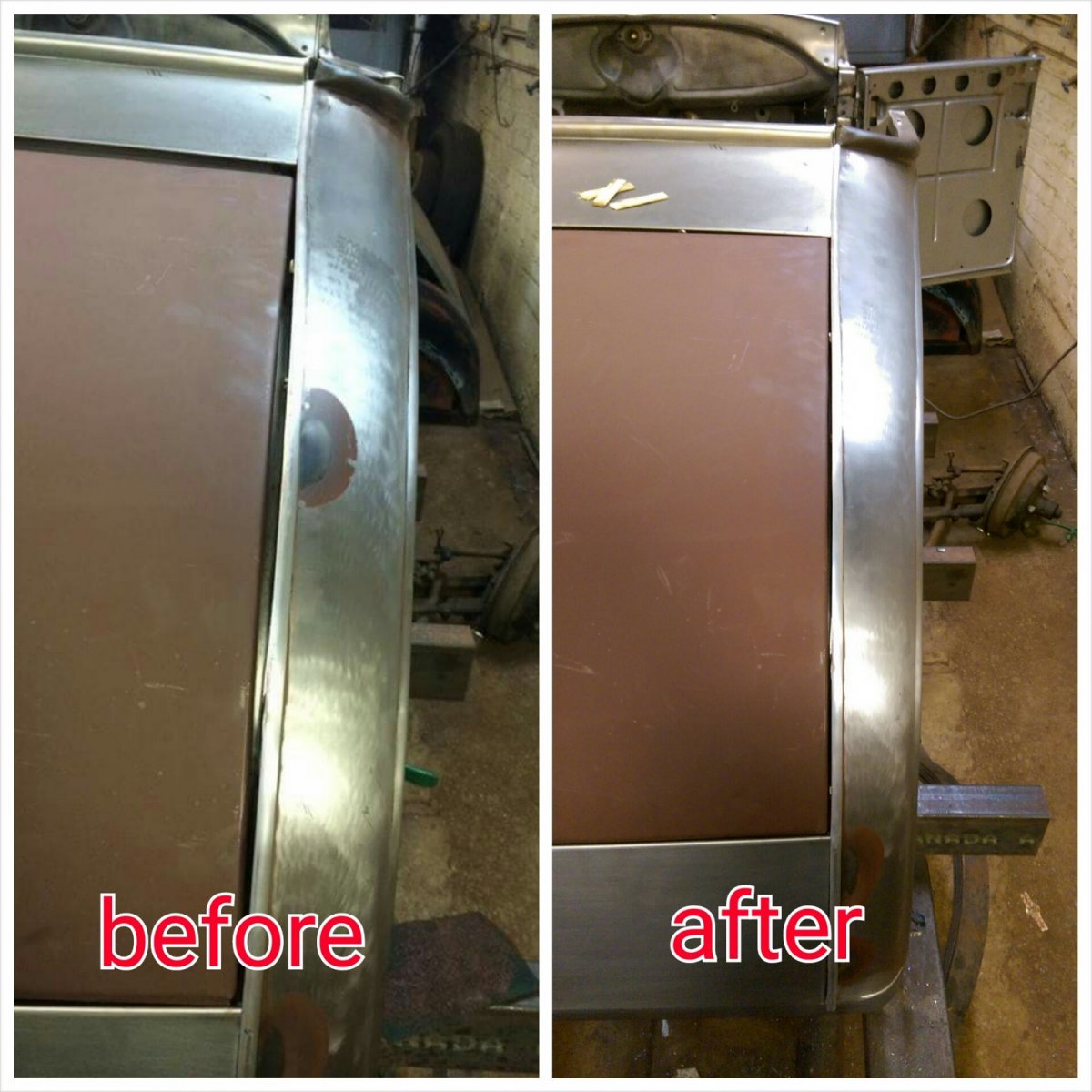

    I bought my 28 roadster in pieces from Brookville and put it together myself.
    This to save money in ***embly and mostly to save on shipping, since I'm is Sweden.
    Let my first say that I'm very greatful for the existance of Brookville and their products.
    Starting from scratch would be much, much worse.
    The quality of the model a bodies is much worse that the 32s.
    There is not a single panel that doesn't have a curvature issue.
    These things don't fall together by themselves.
    You will be a more skilled sheet metal man once you're done.

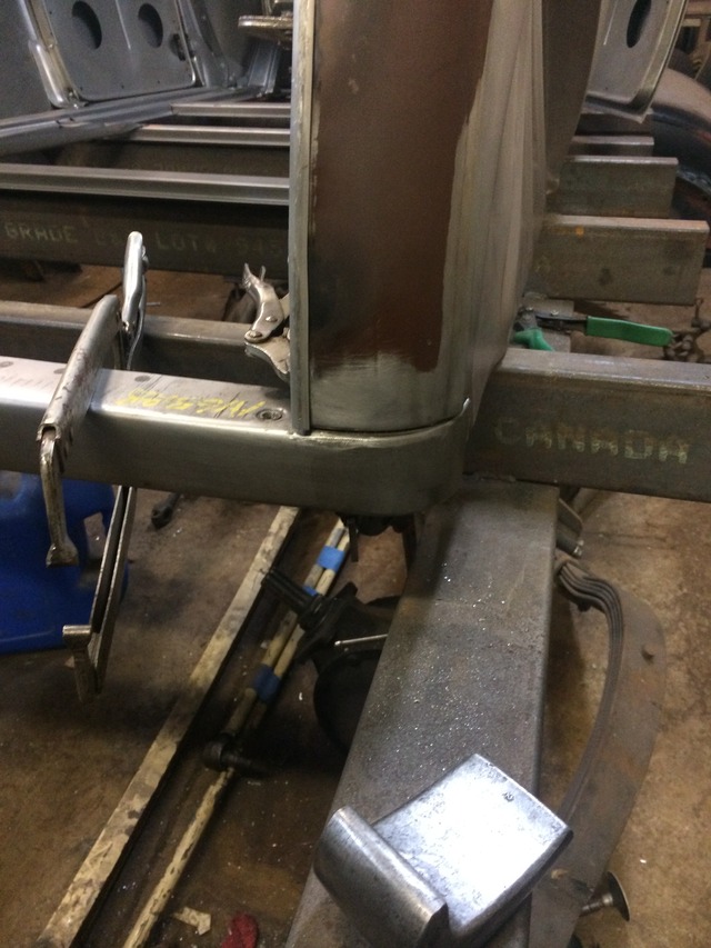

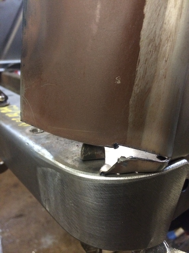

    Haven’t made any real progress of late, been trying to get my shed setup, and a few things done around the house. I’m awaiting my new welder to arrive in the next week,then things will start coming to fruition.
    I am however a little puzzled with how to pin the rear quarters with what I think may be called the top hat sections?
    I’ve attached a photo for reference. Rear quarters are just kind of sitting there..
    Here’s how it sits to date... [​IMG][​IMG]

    Your "top hat" sections are called subrails. The lower lip of the quarters should roll under like you have, then weld the flange to the inside of the subrail. But as you probably know, don't weld anything solid until you have everything fitting properly.
    From your pics, it looks like your cowl side skins are sticking out too far. Or maybe the cowl band is pinched in too far at the bottom?

    The cowl side skins are unbolted in that photo, as when I installed the cowl tank it changed everything. Leaving the welding till last,
