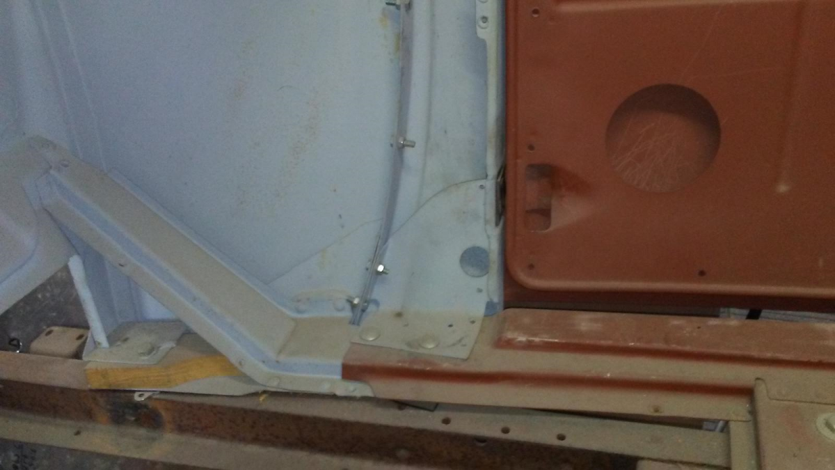

  15. 42˚18'N 83˚09'W
    Joined: Jul 29, 2008
    Posts: 168
    42˚18'N 83˚09'W
    Here you go Nick. I cannot make out the other part. Maybe if you take a different photo.

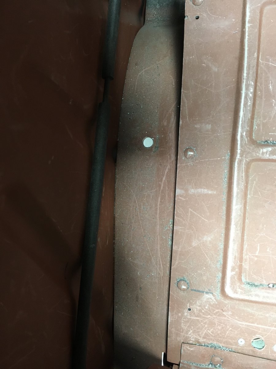

    Does it reinforce the curved panel behind the seat riser?

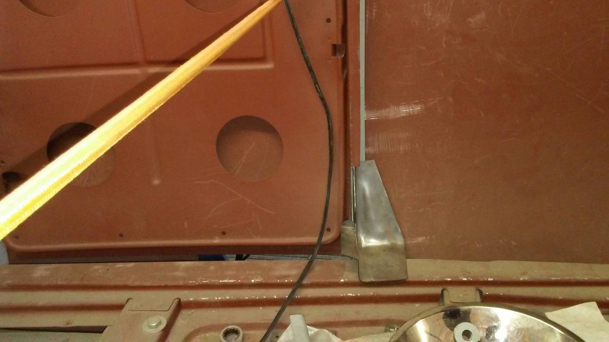

    The part in the last picture, one goes on each side of the rumble seat platform, to clear the kick up hump of a 32 ford frame

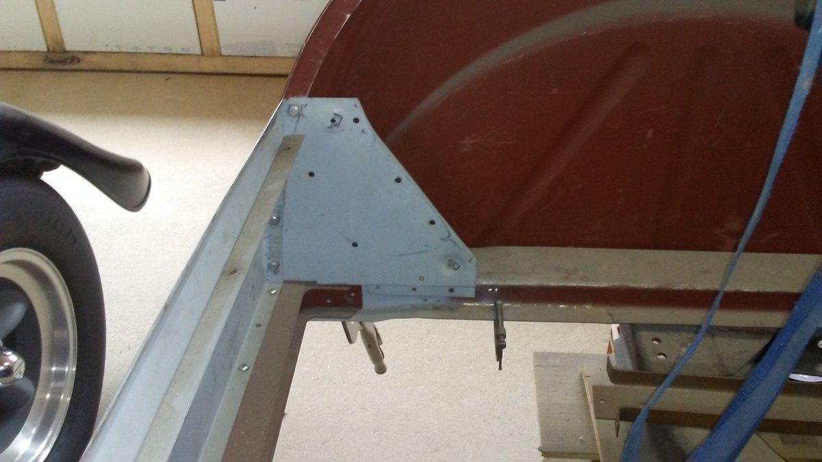

  23. 1-SHOT
    Joined: Sep 23, 2014
    Posts: 2,901
    1-SHOT
    from Denton
    kidcampbell71 and loudbang like this.

    That actually makes sense. I’m guessing I’ve been sent the wrong bits then, my rumble seat platform has no sides, which I have always thought to be strange....

    They suit a 32 Brookville frame for a Model A, they don't suit a stock 32 frame.
  27. Nick Agius
    Joined: Jul 29, 2015
    Posts: 157
    Nick Agius
    I’m running A on an A frame so they don’t suit mine!

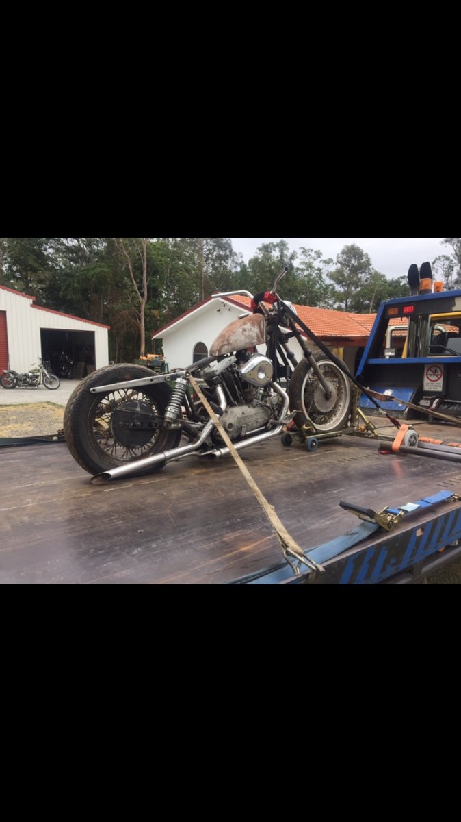

    Not much has been going on. I ended up working a deal with a panel beater friend to do the final alignment & paint for me to do some work on an old Harley of his.
    Here’s some photos of the day the roadster left. And the before/current on the old sportster. Looking forward to getting the roadster back and starting the ***embly! IMG_4850.JPG IMG_5245.JPG IMG_6223.JPG IMG_5132.JPG
  29. loudbang
    Posts: 40,346
    Nice looks like a 69 or so the last with drum front brakes.
    kidcampbell71 likes this.
