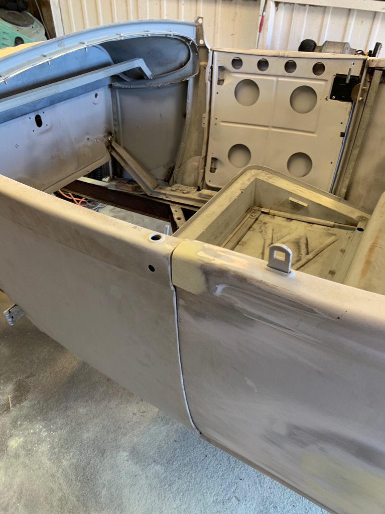

    Well,

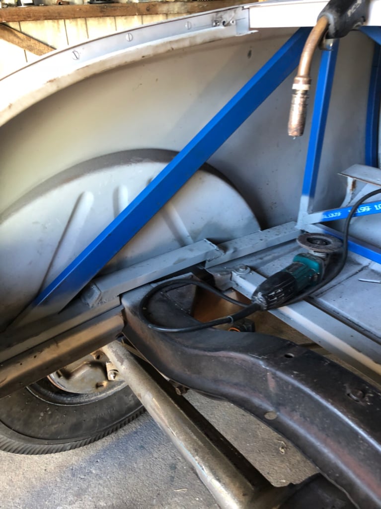

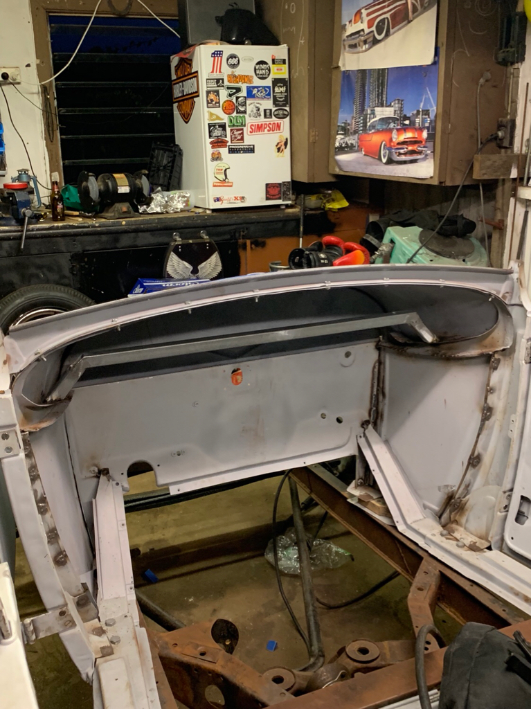

    It’s been a few months since I last posted on here. Progress has been slow, but it would seem as if we are nearing the end on trying to make this all fit..
    Honestly, if I had the choice again I would recommend buying a pre built body from brookville or if your in the us have someone like flop ***emble for you..
    It hasn’t been easy.

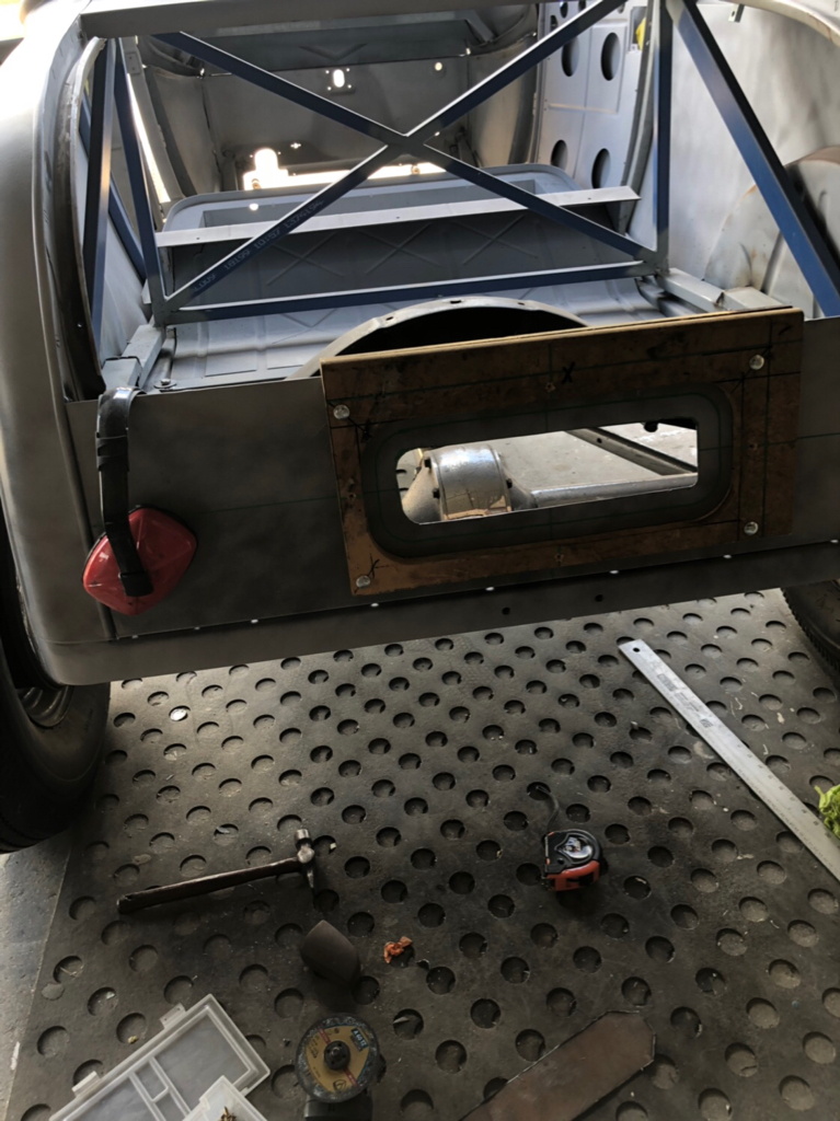

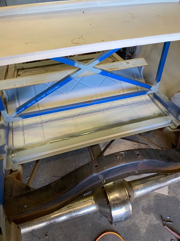

    Here’s where it’s at, quarters are pinned, floors are spot welded. Some extra bracing to compensate where the frame step through the subrails has been installed & a seat frame brace has been done,Doors are opening & closing nicely now and a little cowl tank brace has been installed.
    Here’s some pics, really looking forward to having this thing painted and home for final ***embly [​IMG][​IMG][​IMG][​IMG][​IMG][​IMG][​IMG][​IMG][​IMG]

    The second pic above shows the flange you left when you cut out the tank...
    IMO... drill 1/8" holes every 8", you can anchor your wiring harness to them...
    they may help support a heater, the back side of a glovebox, mount a dome light...etc.

    These pics help.
    I copied Missiesdad1 on his cowl braces. Plan on using the wall of the tank for mounting places like the wire panel.

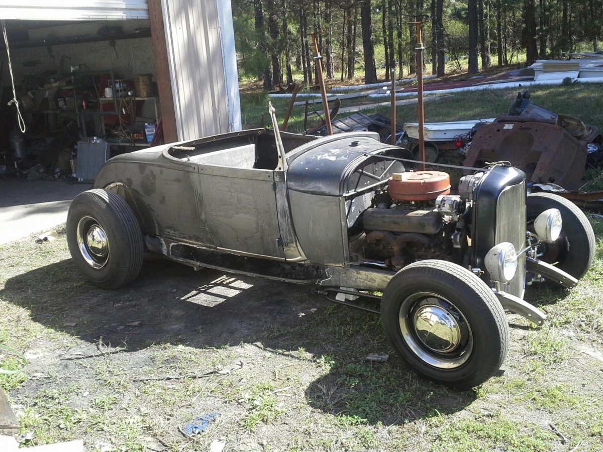

    IMG_0996.JPG IMG_1575.JPG I have been following and see the skills you have developed during the process, this is how we learn to fix **** that others can't. I have a 29 on 32 rails now, but I have had several before this and have a 29 tub, I have traded a few things with Missiesdady1 he lives about 40 miles south of me . Attached is a pic of my tub and roadster both on 32 frames. Keep up the good work. Frank

    Yep! That’s the idea.
    Fuse panel will be mounted behind there, I also plan on putting a full stereo in this car so speakers under the cowl panel also..
    I’ve also heard ( may have even been posted in this thread) people welding washers on there end to route wiring and easily hang stuff from
    Hopefully not to long before all the fun stuff begins

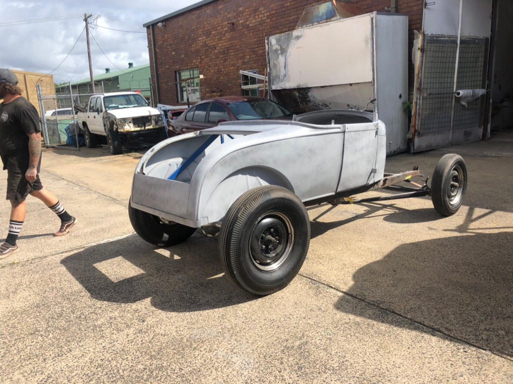

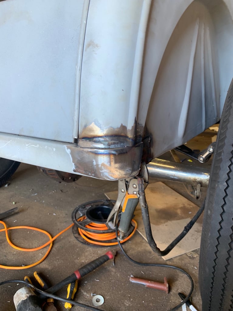

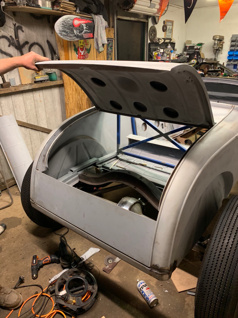

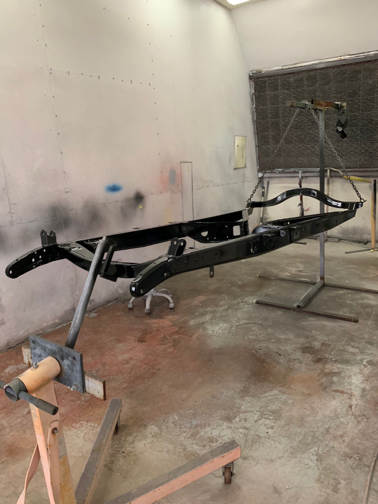

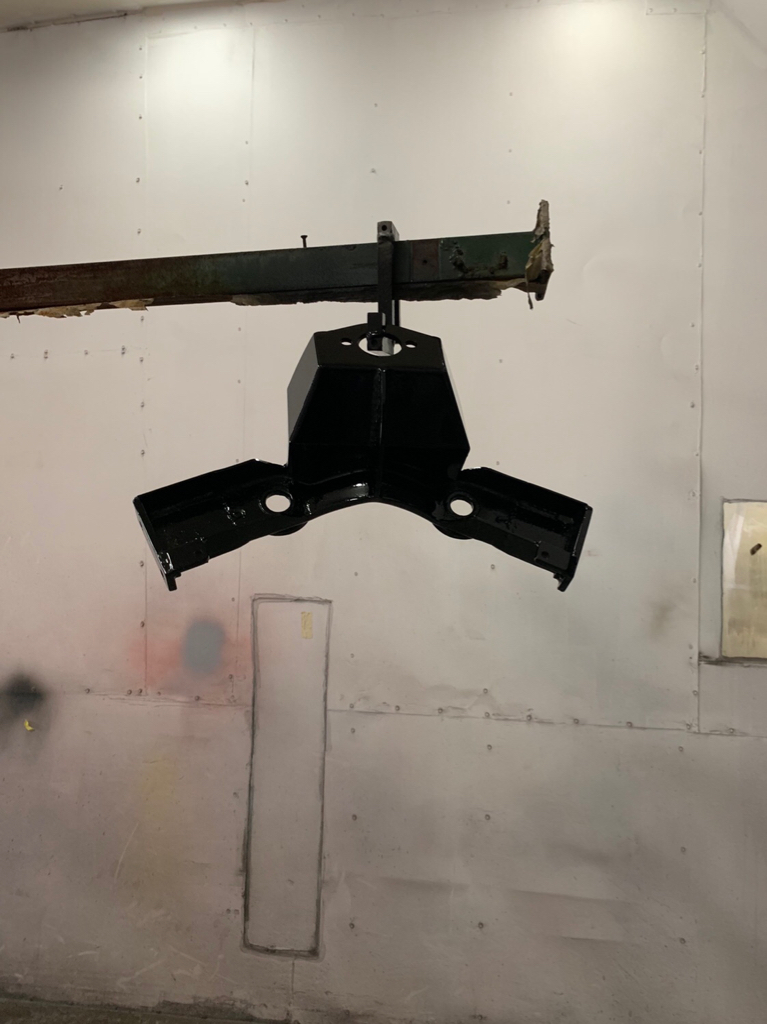

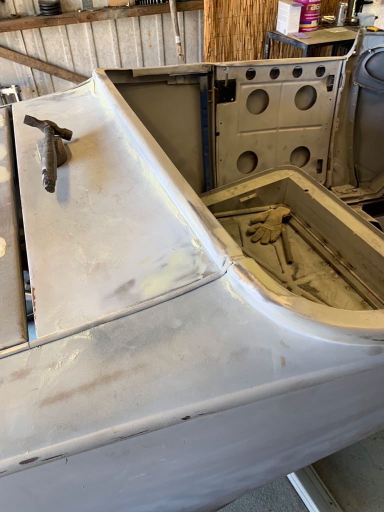

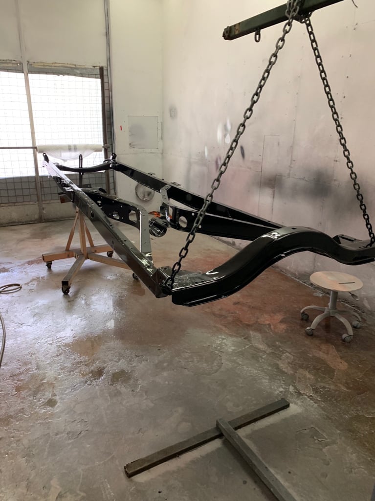

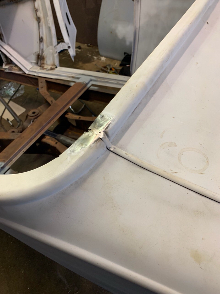

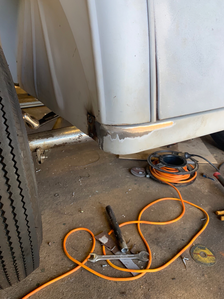

    Well a little more progress, I spent my Saturday with my panel beater friend and we got the majority of the panel work required finished on the roadster, over the next few weeks it’ll be prepped for paint and hopefully have it back home mid February.
    Managed to finish up a lot of welds, weld up a lot of holes, fill the gap on the rear quarters where the doors were supposed to sit into originally, finish that frame right up and get the cowl tank shaved.
    I’m getting really excited to have it home
    Here’s some photos of the weekends progress

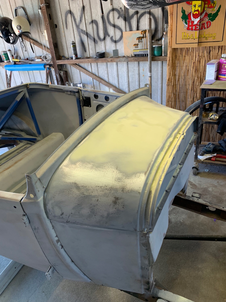

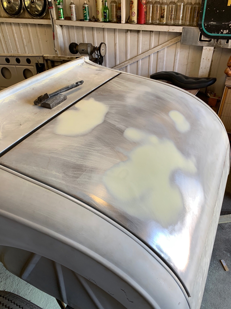

    Little bit of fill work, recessed license plate to come then it’ll be ready for paint [​IMG][​IMG][​IMG][​IMG][​IMG][​IMG]

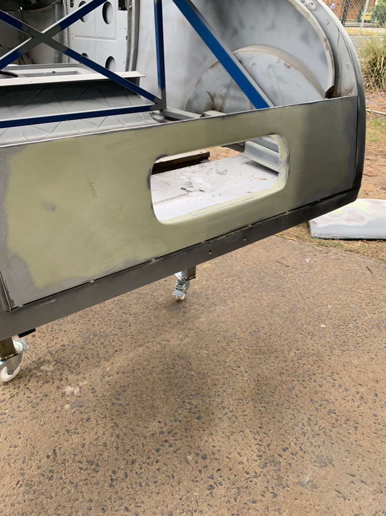

    Car is now primed & recessed licence plate just about done!! [​IMG][​IMG][​IMG][​IMG][​IMG][​IMG][​IMG][​IMG][​IMG][​IMG]

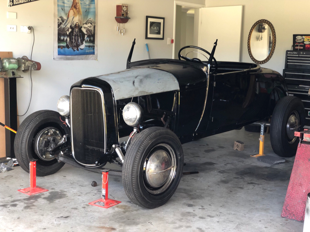

    Been a minute. But finally looking like something, makes me so happy to have it sitting like this.
    Engine & diff rebuild still to come,
    Here’s some pics [​IMG][​IMG]

    Nick, you have came along way, your A is looking really good. You have increased your skill level a lot, you have something you can be proud of and best of all you can say I built it with the help of a few friends. The cowl brace that you built will keep your cowl in alignment and your doors fitting good, because when you cut the tank out the cowl it looses all it's strength. I know Missiedaddy and he lives about 40 miles from me and he is a great person
    Beside saving on the freight you earned a (I Can Do It ) at***ude. That will get you further in life than anything else.
    Nick you did it. I can't wait to see pictures of you driving it.
