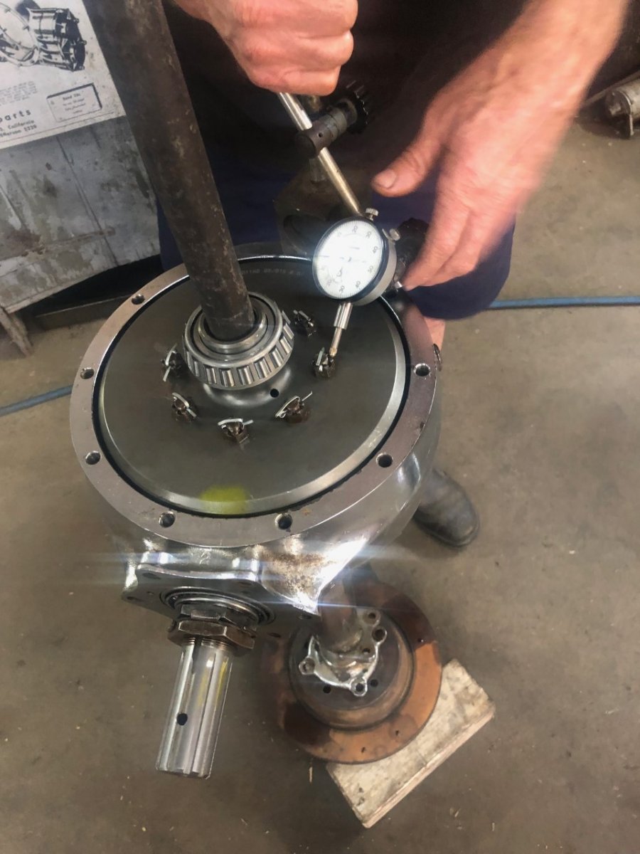

    John and i managed to get my old chrome 32 diff back together yesterday,
    The diff had spent a good few years outside. When i found it it was facing up in the rain and everything was rotten inside.
    New bearings & 3.54 gears, These things quickly become more expensive than a quick change!

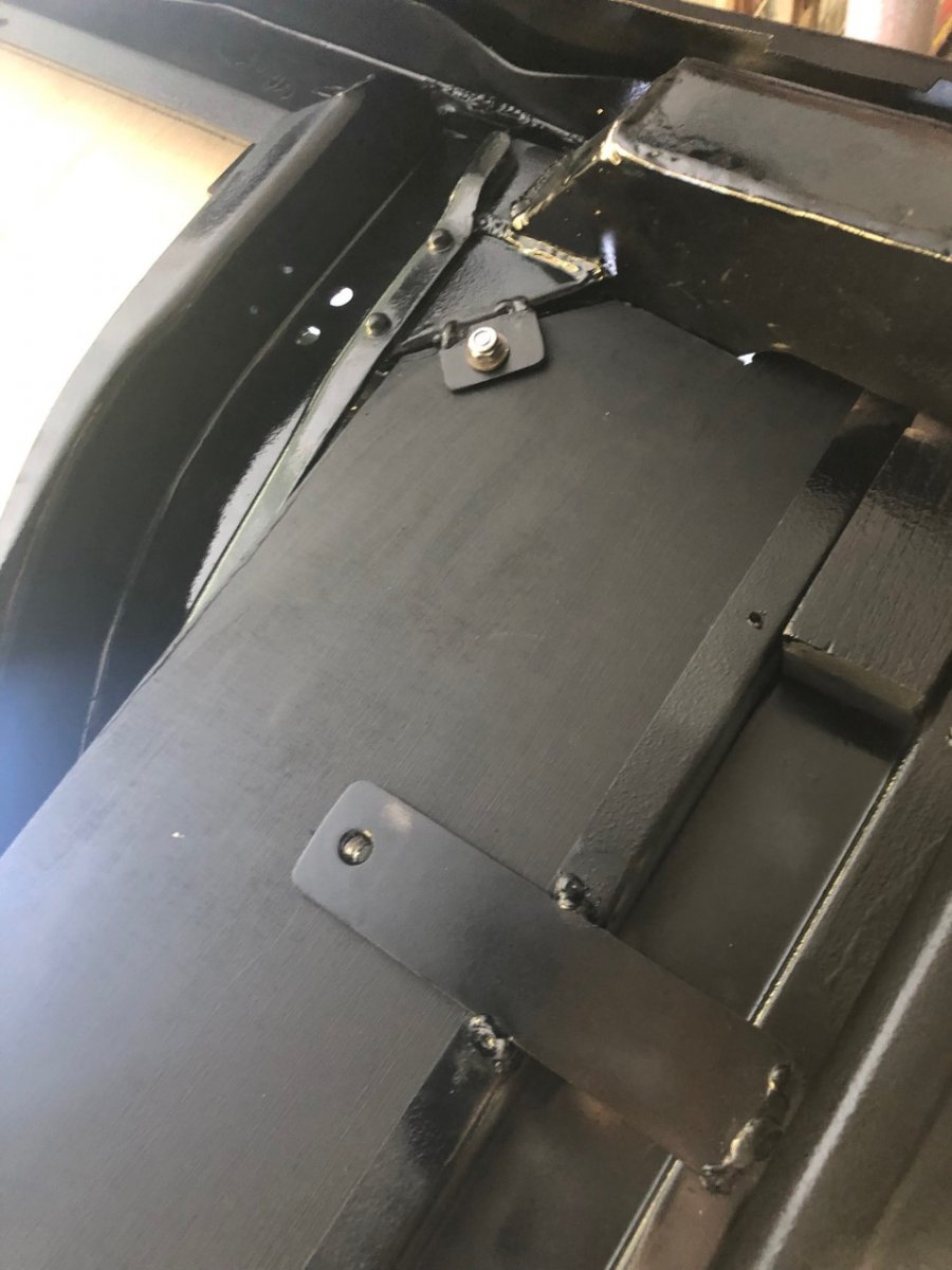

    John was nice enough to spend the day with a friend getting my boot floor finished up whilst I was at work yesterday,
    Here’s some pics he sent me..
