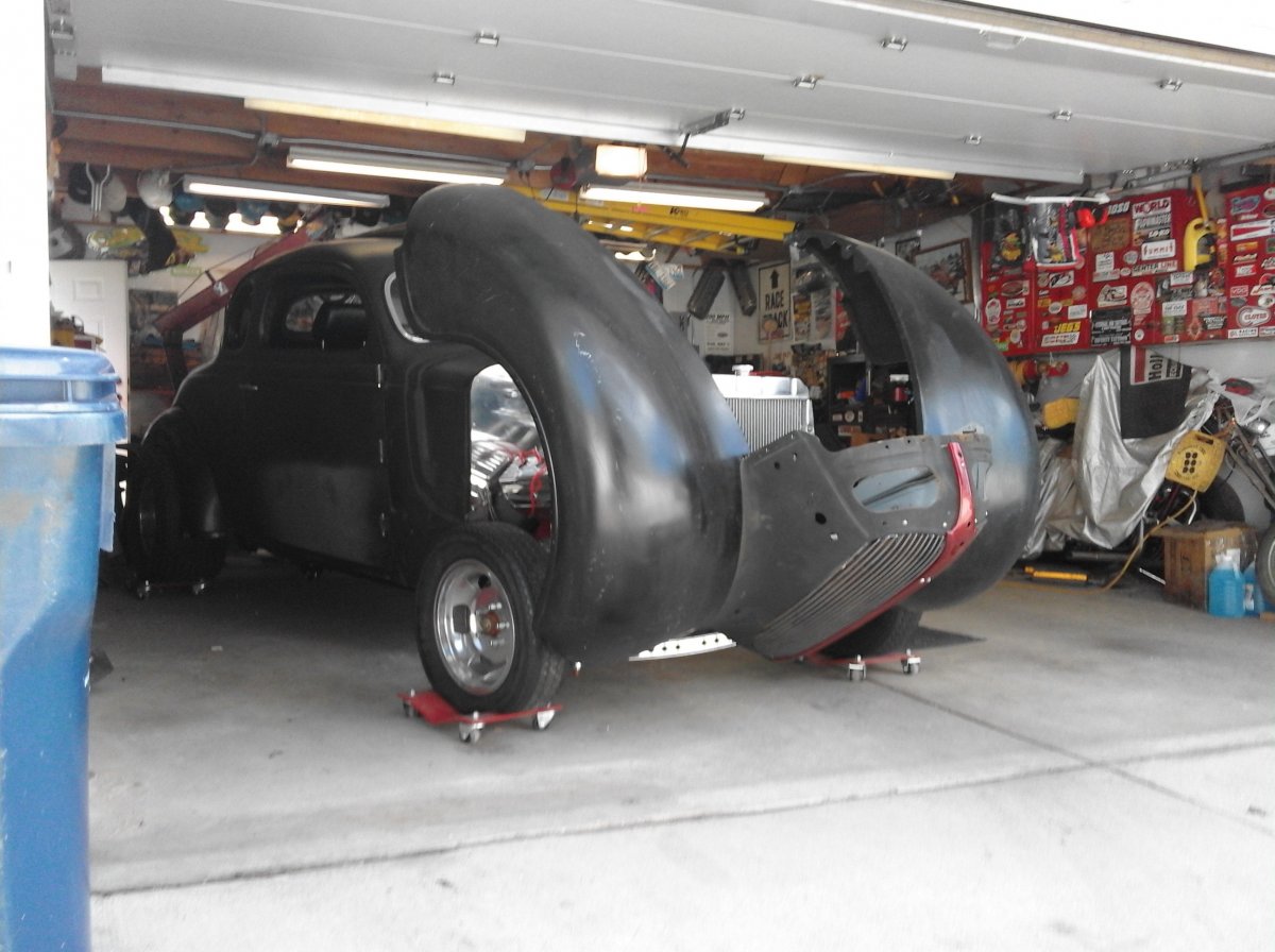

  4. Nice combination of rides you have there. I have a 66 Valiant that I built with my dad, and we are currently building a 1937 dodge coupe gasser. Starting out with a rust free car is a good start. We made the mistake of starting with a rusty parted out shell. For the Valiant most of the work was done at home. We farmed out the chassis fab work for the Dodge, but still have done quite a bit of fabrication in our garage. I think that starting off with basic hand and power tools will be fine, buying additional tools as you need them.
    Here are a few pictures of what we started with and some progress. We hope to have the dodge running in June. 1937 dodge delivered.JPG Dodge @ HHRC IV.jpg Dodge 12-11-2015 II.jpg IMG_20160714_1819441_rewind.jpg

  21. Yes it is a 392 and 727 torqueflite. We did recess the firewall around the distributor, and the toe board needed to be cut for transmission clearance. The front fenders do clear the heads, but if we had inner fenders, they would need to be cut. The front end is set up to tilt for easy access. The core support and grill shell is gutted to make space for an aluminum radiator, but I think you could use the stock radiator.
    The only reason the body was braced is the floor was non existent after media blasting. We replaced the floor from the firewall to the rear roll pan. 0826161442.jpg 0826161444.jpg IMG_20160709_1718569_rewind.jpg
