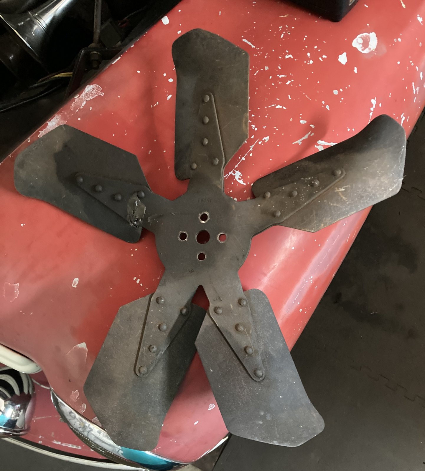

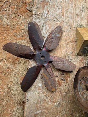

    Long story short...I recently traded a 5 blade fan for a 6 blade fan that fit the arbor of my water pump. Both are asymmetrical. I was always curious as to why this was so. I finally had a "Hey, I can look that up on the internet!" I found this:
    "Unevenly spaced fan is developed to reduce the tones. The fan blades are spaced such that the center of m*** is placed exactly on the fan axis to minimize fan vibration. The resulting fan noise is 11 dBA quieter in discrete noise level than the even bladed fan system."
    And:
    "The oddity is there to lessen fan noise. The uneven spaces creates air pulses that cancels out some of the noise, without lessening the ability of the fan to move air."

    Is it the asymmetrical type, or evenly spaced?

    Sometimes...a picture is worth a 1000 words...........like Now!!!
    6sally6

  8. Cosmo49
    Joined: Jan 15, 2007
    Posts: 1,611
    Cosmo49
    upload_2022-7-20_12-7-58.jpeg upload_2022-7-20_12-7-27.jpeg ]

  19. Mr48chev
    Joined: Dec 28, 2007
    Posts: 36,042
    Mr48chev
    I've got one of those out hanging in the shed. It will pull a cat though the radiator but that thing makes so damned much noise that you could hear it when the truck went down the road. My buddy could tell when I pulled in the driveway while he was in his shop with the radio playing because it was so loud.
