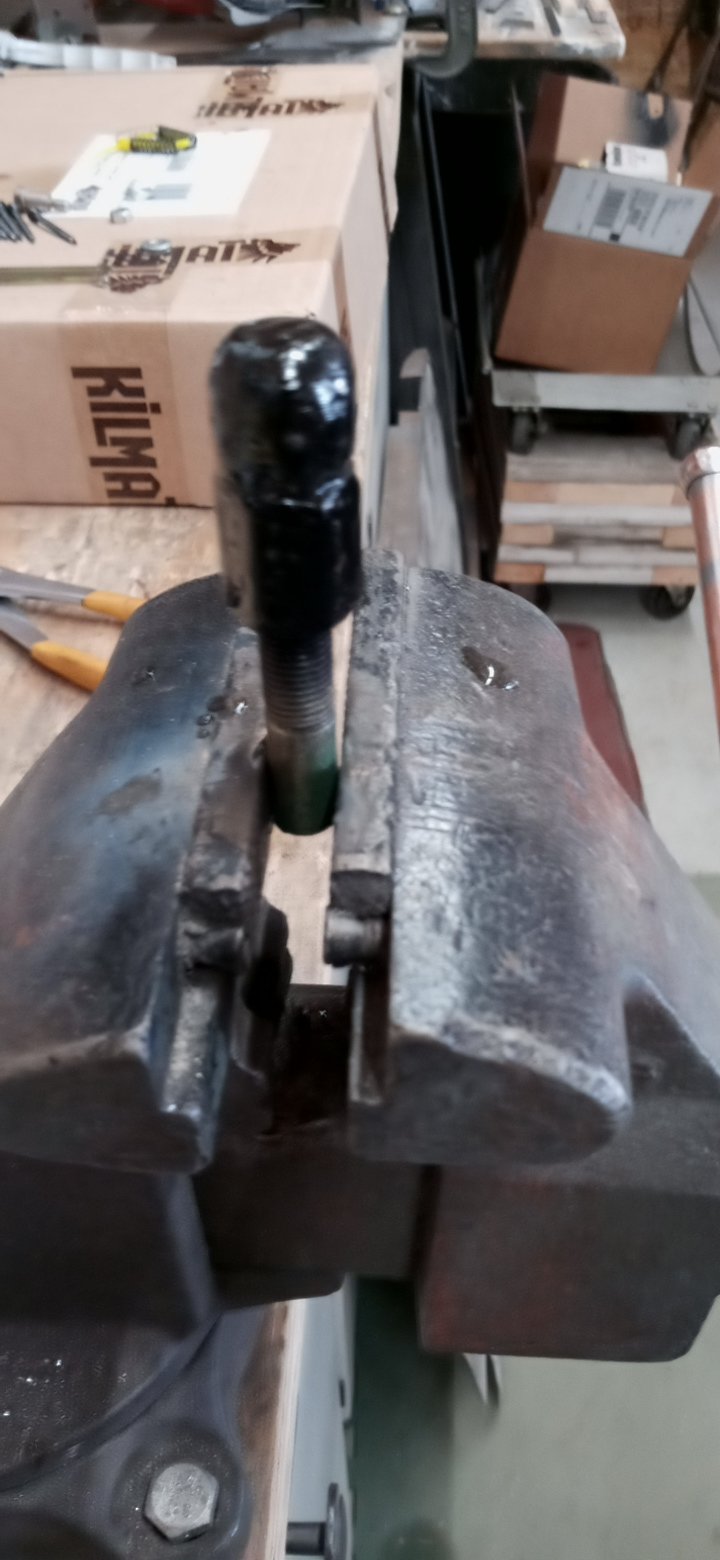

    As these will be held in with Velcro strips, I had to make some small brackets to attach the front side next to the tank. Actually, these will be inserted from the driving compartment since the tank will have to be installed first making it impossible to get around the side of the tank.
    Cut up some small gauge pieces and bent them on the vice. Tacked them in, now I need to pick up some Velcro and some material to cover these in.

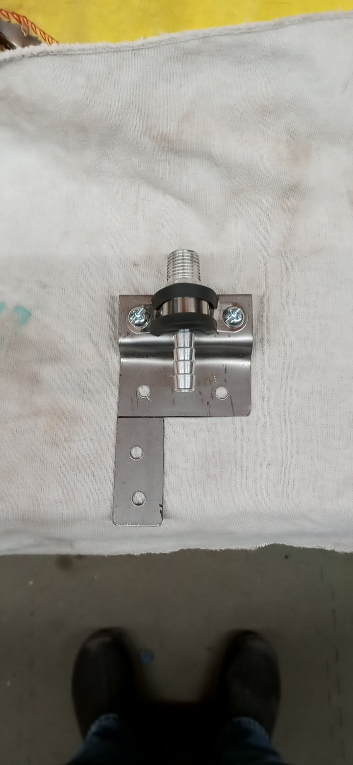

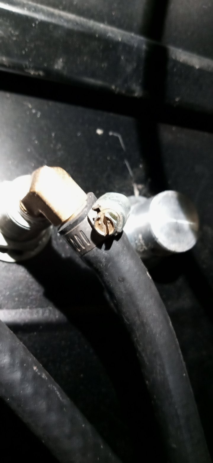

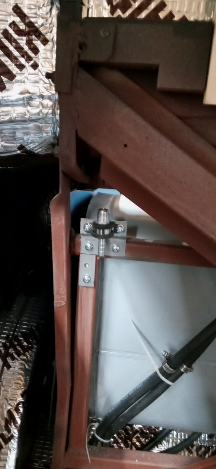

    Slow progress today. Trying to round up some br*** fittings to handle the installation of the gas tank vent. Rather tight for space but the check valve must be above the fuel level in the tank. After looking into the possible locations I decided to move the valve to the front of the tank area on a bracket that elevates the valve above the fuel line. Then I will run a 5/16 hose down and exit out of the trunk floor where I can mount the vent on the outside under the trunk.
    I picked up some of the br*** late this afternoon but am waiting for a 1/4 npt female hose barb.
    Here is the bracket that will hold the check valve.
    And mounted on the gas tank frame.
    Tomorrow I will finish the lower part but the top will be next week. Always waiting for parts!!

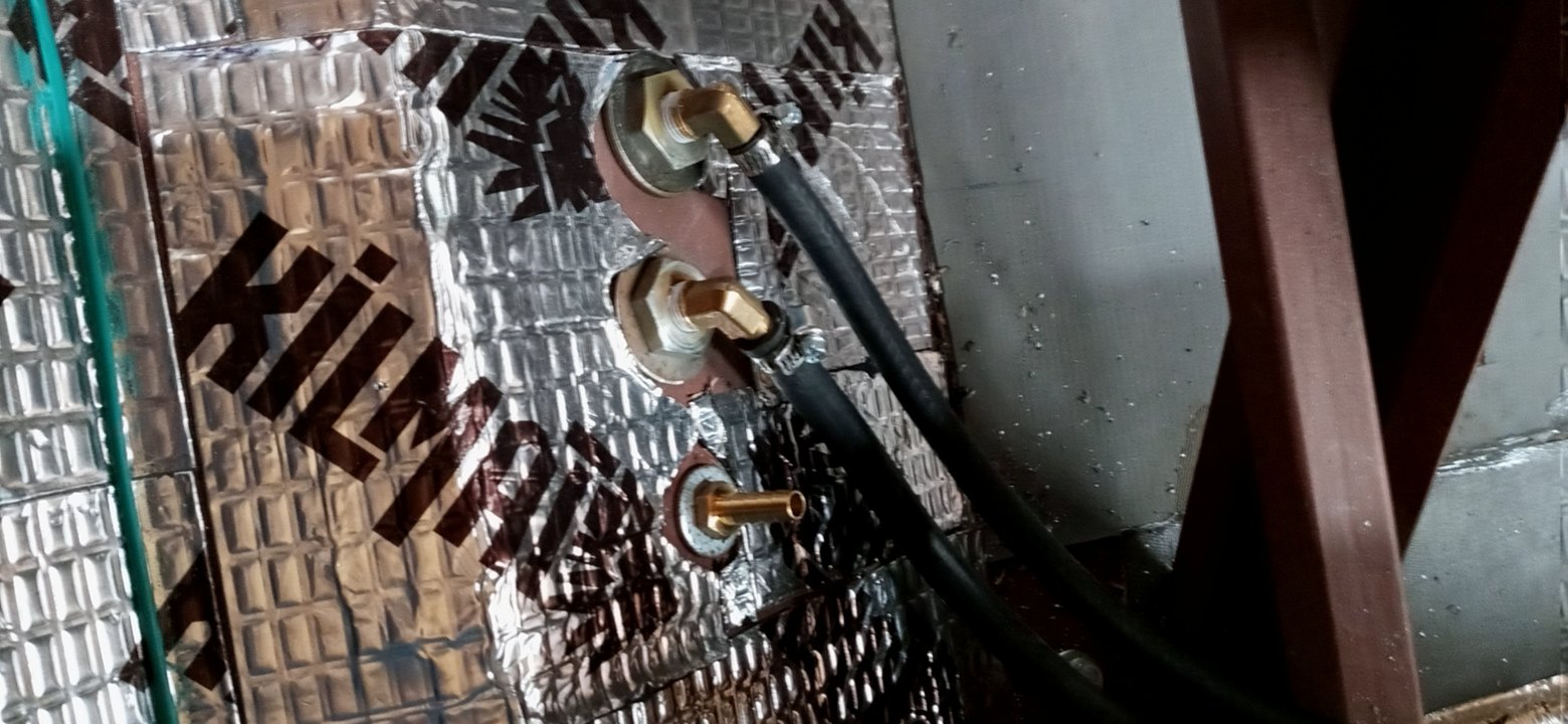

    Today I finished the gas tank vent. Drilled a 9/16 hole in the floor below the tank and inserted a 5/16 hose barb fitting then attached the breather from below, ran a 5/16 fuel line up to check valve and then into the tank. Should work out well.
    Here is the vent tucked up under the tank.
    And the barb fitting under the tank

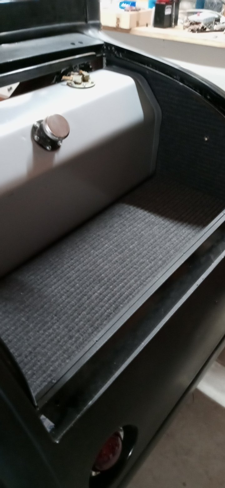

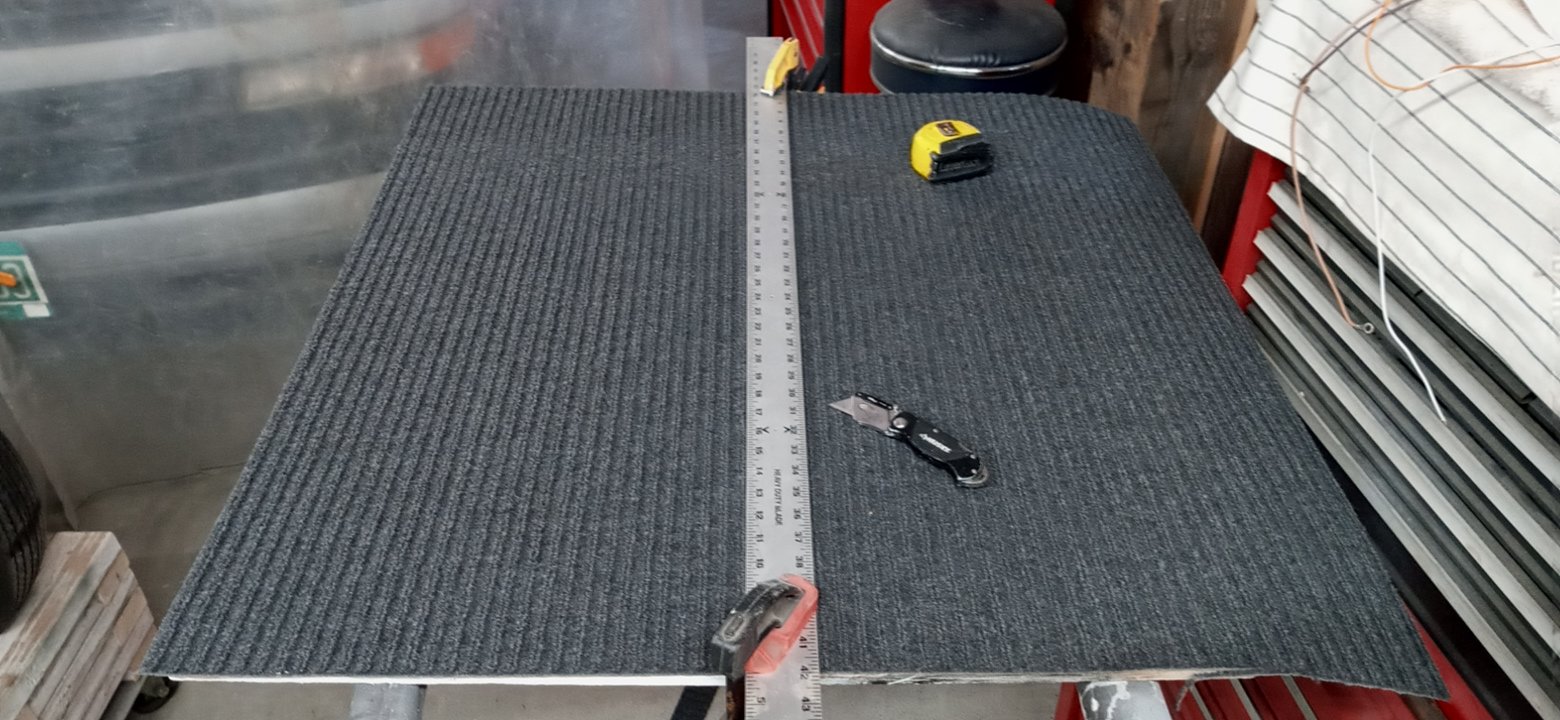

    Now that this out of the way I cut the carpet for the floor and installed that, then put the tank in place and attached the fuel line and the return line. Then I glued up the side panels which I had made earlier in the week. Attached the material and put them in place. All that was left was mounting the battery box and attaching the cables. So that should be a wrap for the trunk area for now.
    The finished trunk

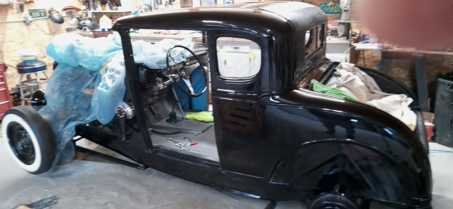

    Couple weeks ago we received a healthy amount of snow so in my infinite wisdom I decided that I had better shovel my 100 foot driveway and the entrance to the road. That was the beginning of a 2 week convalescent period, Ha!. Seems I did something to the old back and it put me down for quite a bit. After a few days of self help I gave it up and saw a doctor. He managed to get me standing straight but it took another week before I could do any work in the garage. Since then we received another dose of snow but I am letting mother nature take care of it now. 60 degrees tomorrow so it will all be gone soon.
    I chopped my window moldings, mocked up the head light conduits and have aligned the front hubs with the rear end using my laser. Got all the small pieces prepped yesterday and ran them up to the paint booth. Shot most of the new stuff with etch and then high build. Today I will start sanding them and hope to paint them all this Friday.

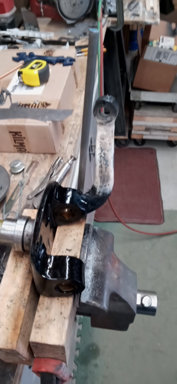

    I removed the right spindle as the drag link was rubbing on the bottom of the bone. Bent that down a bit for proper clearance and then touched up the paint and reinstalled it.

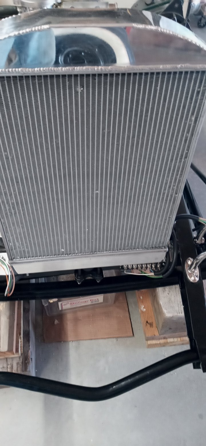

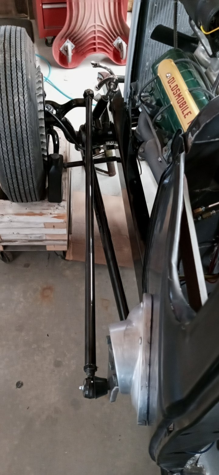

    Pulled some 3/8 round rod off the shelf and made the radiator rods. Simple enough to do and gets one more thing off the list.

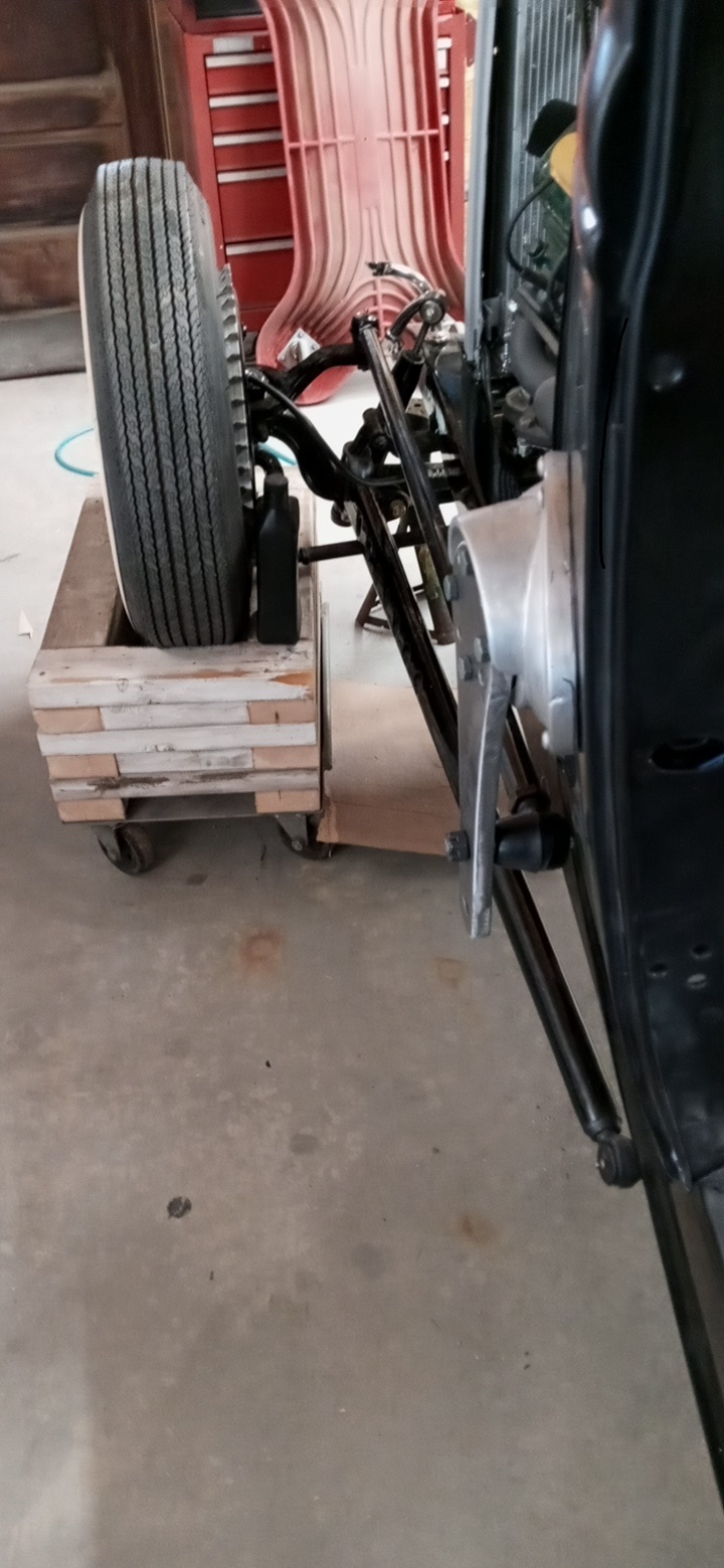

    Since my axle apparently is the short version ( for fender cars) my tires rub on the bones before hitting the spindle stops. I am told there are longer pin stops but in an effort to finish one more item I took 7/16 nuts and welded them to the end of the pin nut. Then ground off the wrench flats and tapered the end. Put it on a 7/16 stud, inserted in my drill press and smoothed it out with a file. Touched up the paint and put them on. That keeps the tire about 3/8 inch from the bones.

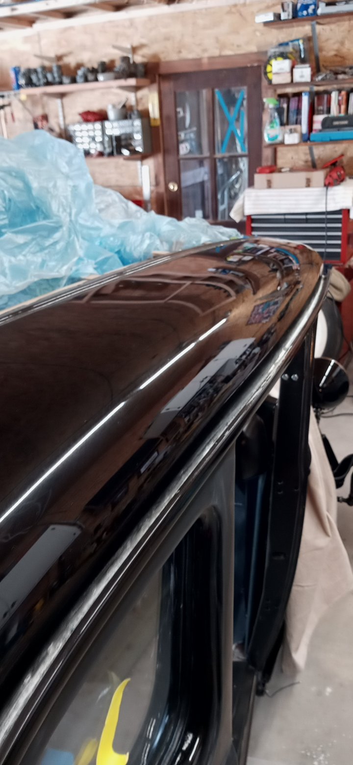

    One of my younger friends who runs a very successful body shop gave me some suggestions for buffing out the paint and gave me a bottle of Farcella compound. I used a yellow sponge pad for the initial cut followed by a lighter blue pad at speeds of 1100-1200 followed by 800- 1000 rpm. I had cut the clear coat down to 2000 although it was recommended to go to 3000 but no one carries 3000 in town. Go figure.
    I did the grill shell first and had another friend inspect it. He thought it turned out well, so I did the head light buckets next. This is definitely a learning process. I have watched way too many tutorials on the tube, enough to make me probably a little dangerous.:):) Is it perfect? Probably not, but I am not trying to get a show car look. Here is the grill:
    And the PS roof top
    Long ways to go if my shoulder holds out! Will do a little each day. Fingers crossed that I don't make a real mess out of this. Going to keep focused and be patient, can't rush this stuff it appears.
