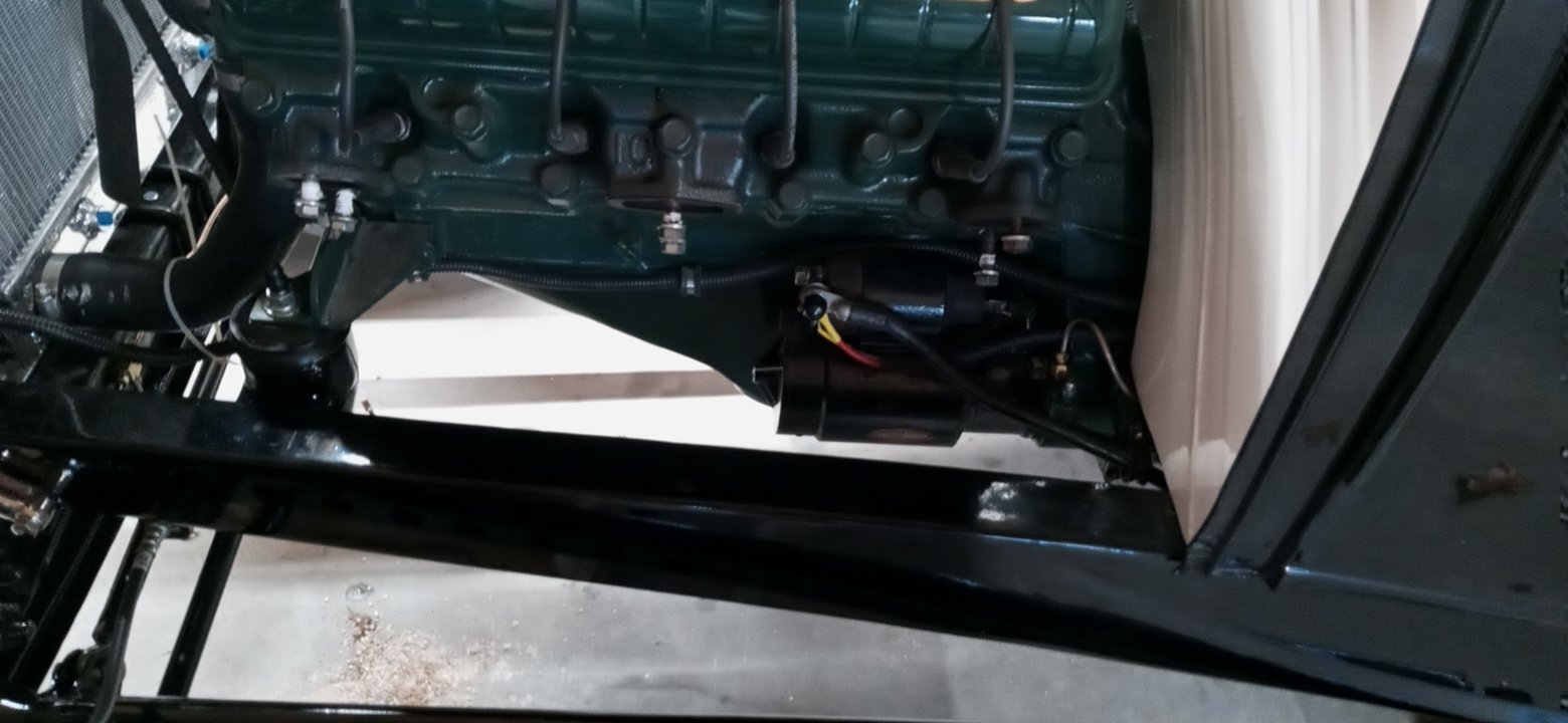

    Been a while since I have had much to add. My machinist was down with Covid for over a week. He said he would try to get to small stuff over the Christmas holiday. Then with my luck I picked up an intestinal virus that kept me close to the facilities for almost a week. Actually had to go to the Dr. which is a rare situation for me. She put me on a liquid diet which did not include my usual beverages:). Anyhow, got thru the holiday and am back working on the project.
    Put the engine back in so that I could work around the DS exhaust pipe now that the steering box is right in the way. I did not want to mess with the headers so I picked up a 2 inch mandrel bent U and started making a new exhaust header pipe. It is tight but after a lot of m***aging I managed to build a new pipe that fits around the box but leaves enough room for the new steering shaft. Smoothed off the welds and will hit it with high temp ceramic black.
    Built the steering shaft and set that in place.
    Tomorrow I will pull the engine back out, then prep the area and parts for some fresh paint. Machinist has my steering shaft done so I will pick that up and finish building out the column. So, we are making headway although it seems like it has been very slow.
