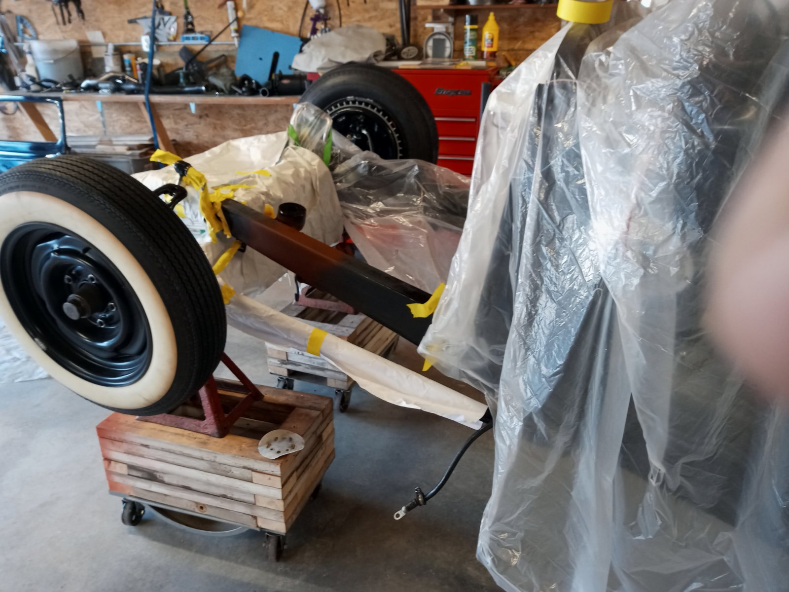

    Yesterday I started to prep to spot paint the frame. Sanded with 600 and wiped with prep sol then mixed up some primer and spotted in the areas that I had previously worked on. I lifted the front up as high as I could with the use of my cherry picker and some jack stands that are mounted on my skids. Makes it easy to position the car wherever I need it and the height makes it so much easier to work on.
    Went over to my buddy's shop and retrieved enough materials to spot this in. This is single stage urethane, not easy to blend I am told but what the hell do I know:rolleyes: about that. He gave me a rattle can of SEM Blendz which when applied correctly over the fresh paint will blend the edges together. Sounds like science fiction to me but what the hell can go wrong that sand paper can't fix, right?:D Suppose to be 50 today and with the heat cranked up It should be toasty enough to lay down a little paint......guess we will see.

    Got out to the shop yesterday late. Temps are going to 50 which is what we call the "January thaw" around here. Snow is gone, rain coming in today. Good day to get the shop up to 70 to paint! First, I revisited that flare deal on the mast. Wasn't feeling it, looked too much like an afterthought, so I remeasured the mast and determined that I had enough length to allow putting a slight flare on the mast itself. Pulled it apart, heated the end and put a slight flare in the end. ***embled it and feel better about how it looks.
    Sprayed some black paint on the small pieces and then blew some urethane on the frame. Wouldn't you know I ended up with a run right where it is clearly visible. Will deal with that after it dries enough to be fixed. All in all, not a bad day for a year end task. Now that I have a garage that smells like a paint booth :rolleyes: I am going to relax for a few days and watch the rest of this year p*** by.
