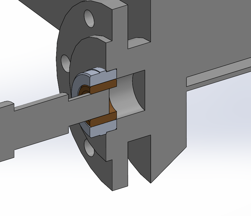

    Mock up revealed just how short the input is compared to where it should be.
    measurements would indicate an extension of 1 inch with 3/4 of an inch inserted into the pilot bearing. Lot of conversations on the web regarding pilot bearing wobble when over extended. I don't know what the alternative is to that in this case. I am certain that there are many vehicles running extended pilots out there. I talked to Brad at SpeedGems yesterday and sent him pics and dimensions so he can do a little work up on the extension. Might hear from him today.
    There is enough space for a shoulder if an extension could be machined that way which would help to reinforce the extension. I have seen a few like that in older catalogs. Guess we will see what Brad has in mind.

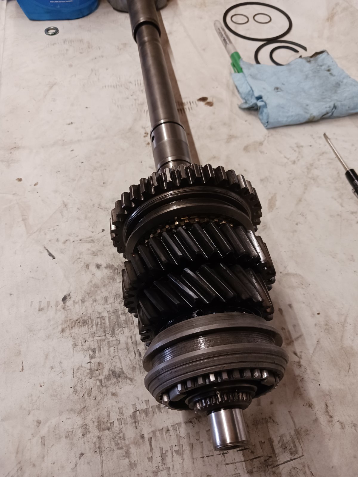

    managed to get the main shaft back together. I ended up using the old shoe retainers. Just could not wait another day for the customer service folks to respond to my 2 emails. If I get time today I will ***emble all the new needle bearings in the cluster and get that installed.
    Notice the 2 grooves on the front of the synchro drum. Not sure yet what that indicates but I will be looking closely at it when i get further into the ***embly.

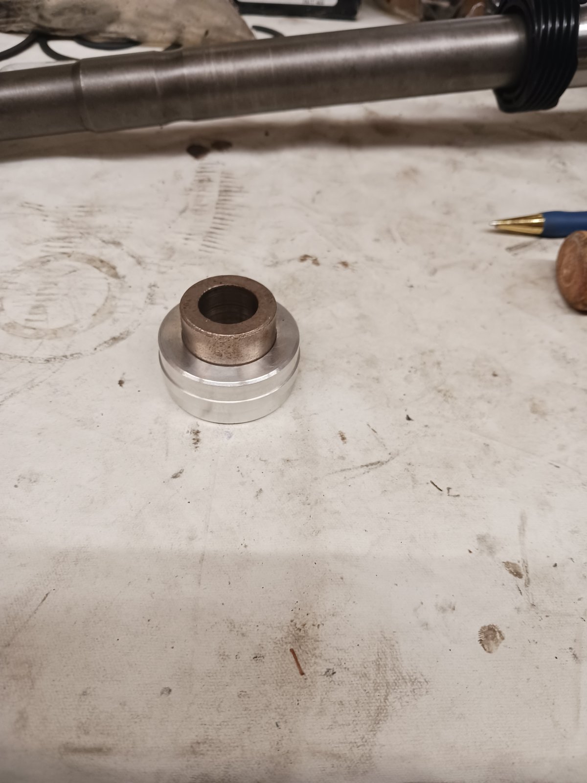

    The adapter came from SpeedGems right on cue. Looks like it is going to be the right fix.

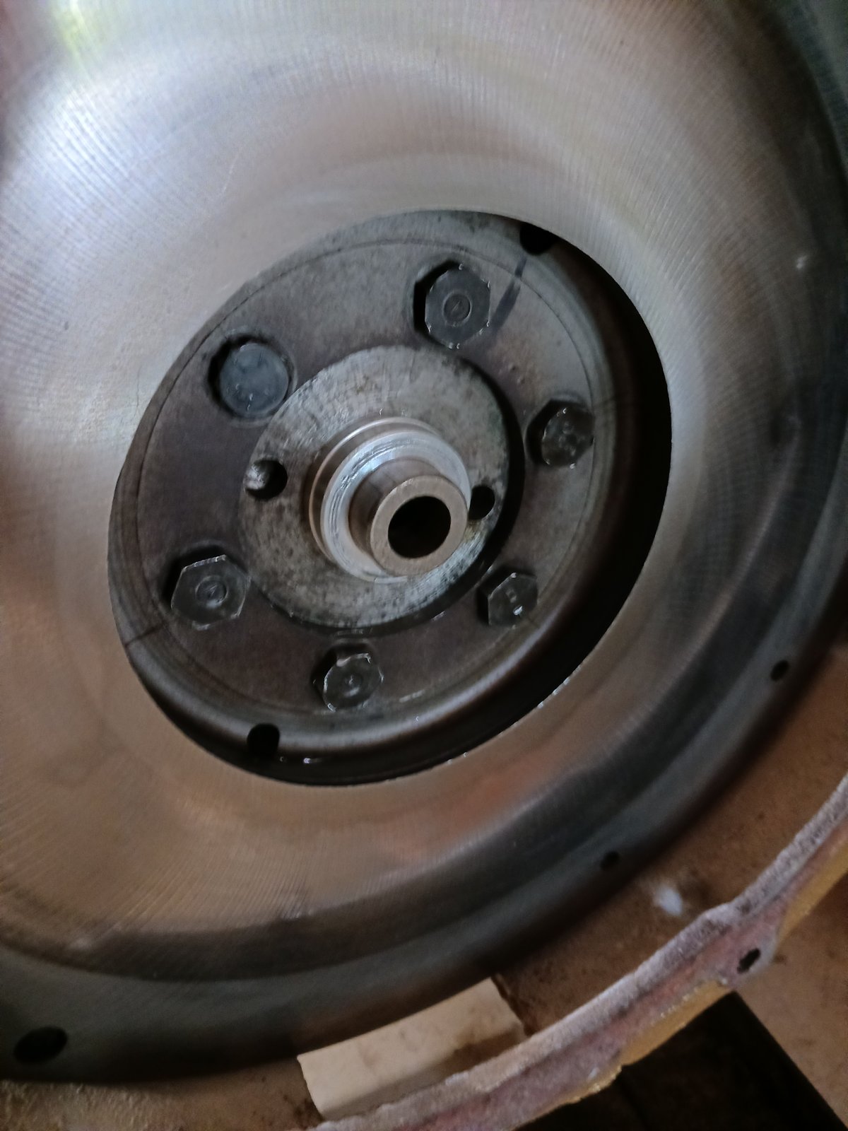

    I installed the new pilot and mocked up the adapter housing with the input shaft set in the case to ensure that we were getting a good interface with the pilot tip into the pilot bushing. Fits perfectly so that part is now history.

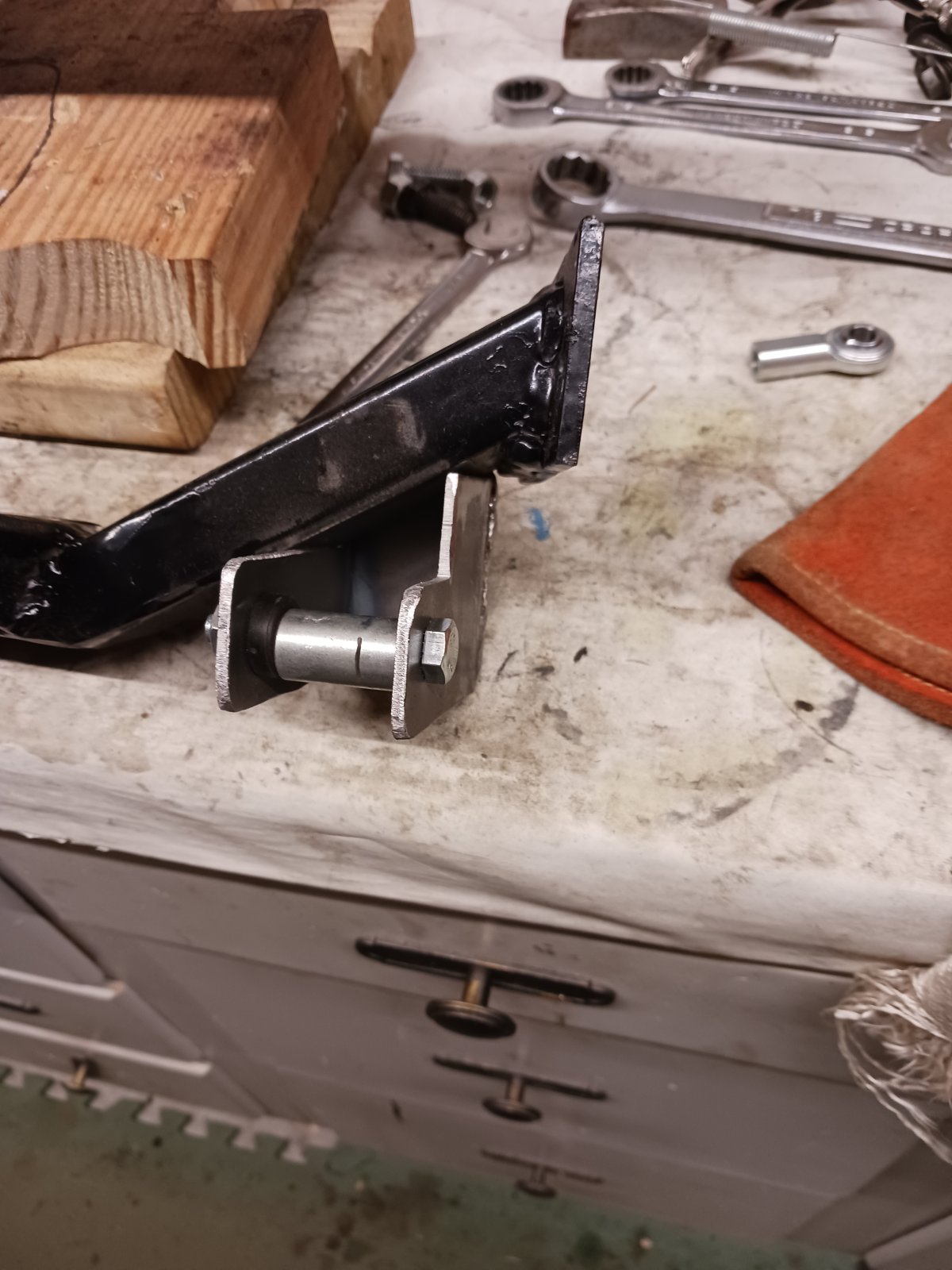

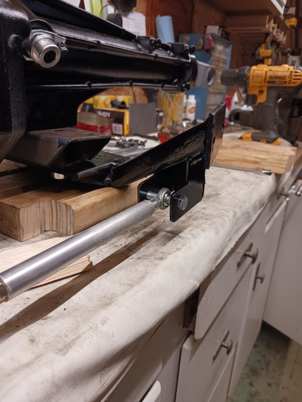

    Got a little bit done in between family sessions. Been going back and forth on what to use for the clutch linkage. The Ford clutch arm is at such a lower position in the bell housing that I had to s**** my previous hydraulic slave set up. Really leaned hard on having a McCleod (sp) release bearing but unfortunately in this build the engine must come out to pull the transmission ( an error i will not make again) so if there was an issue with the release bearing it wuld require a lot of work. In the end it appeared a puller slave would be the logical answer so I ordered one from Wilwood which surprisingly came in one day. After some thought it looked like a add on bracket welded to the crossmember would allow the correct angle while taking the least amount of room.
    built that out of 1/8 inch plate and welded it to the cross member this morning while the kids were shopping up at the discount mall. Looks like I am out of the woods on this now. My speedo gear is in so I am actually going to be able to put this all back together later this week.
    here is the new slave with an aluminum extension
    And the bracket
    And how it looks almost done. just need a couple spacers and final adjustment which will wait now until the engine is back in the frame.

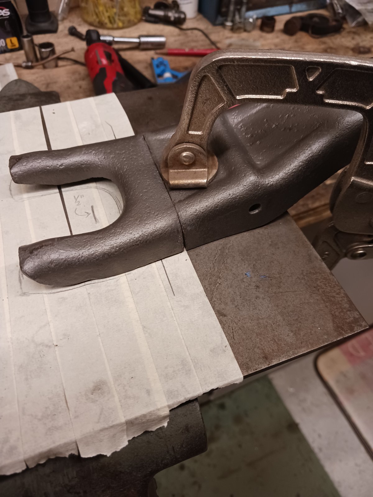

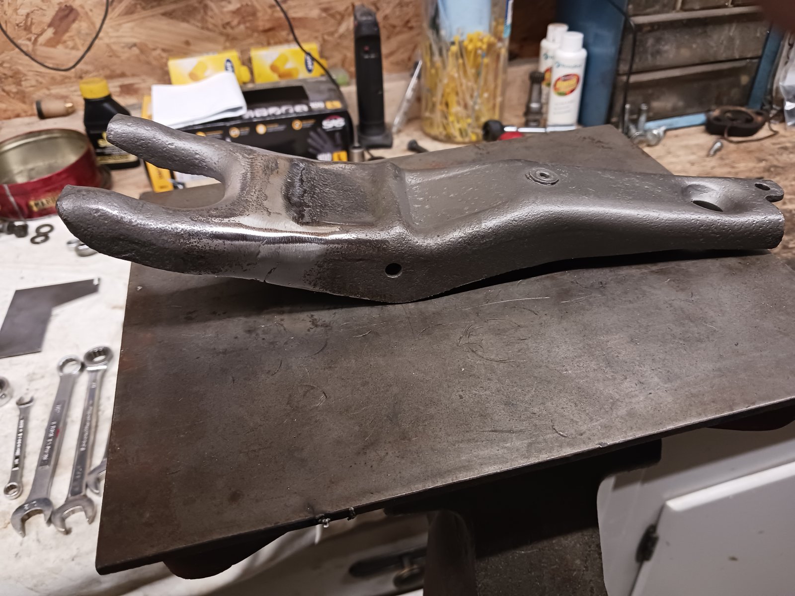

    Got out to the shop while it was cool although humidity was 92 % and finished the clutch arm.
    Blasted some black paint on it and let it dry. Will revisit this again tomorrow. Now trying to locate my clutch alignment tool which I have misplaced. Common issue around here lately it seems. Guess I will go up to my friends shop as he is more organized than I am.:)

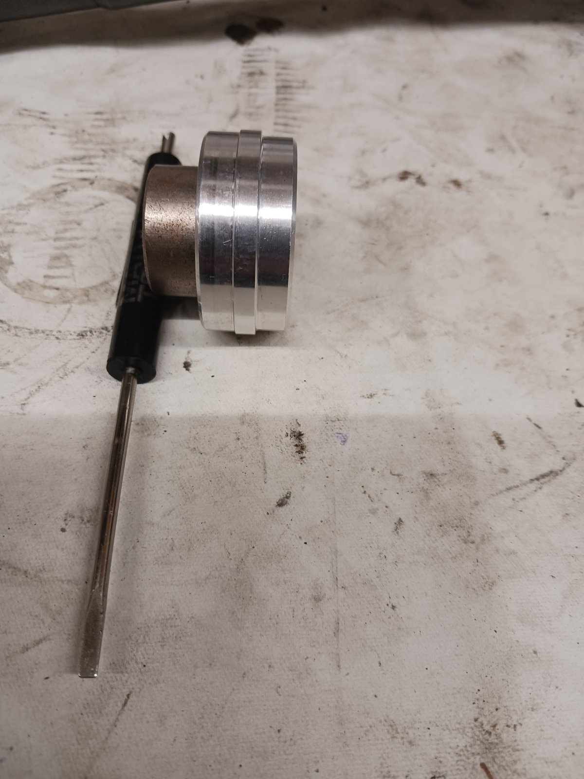

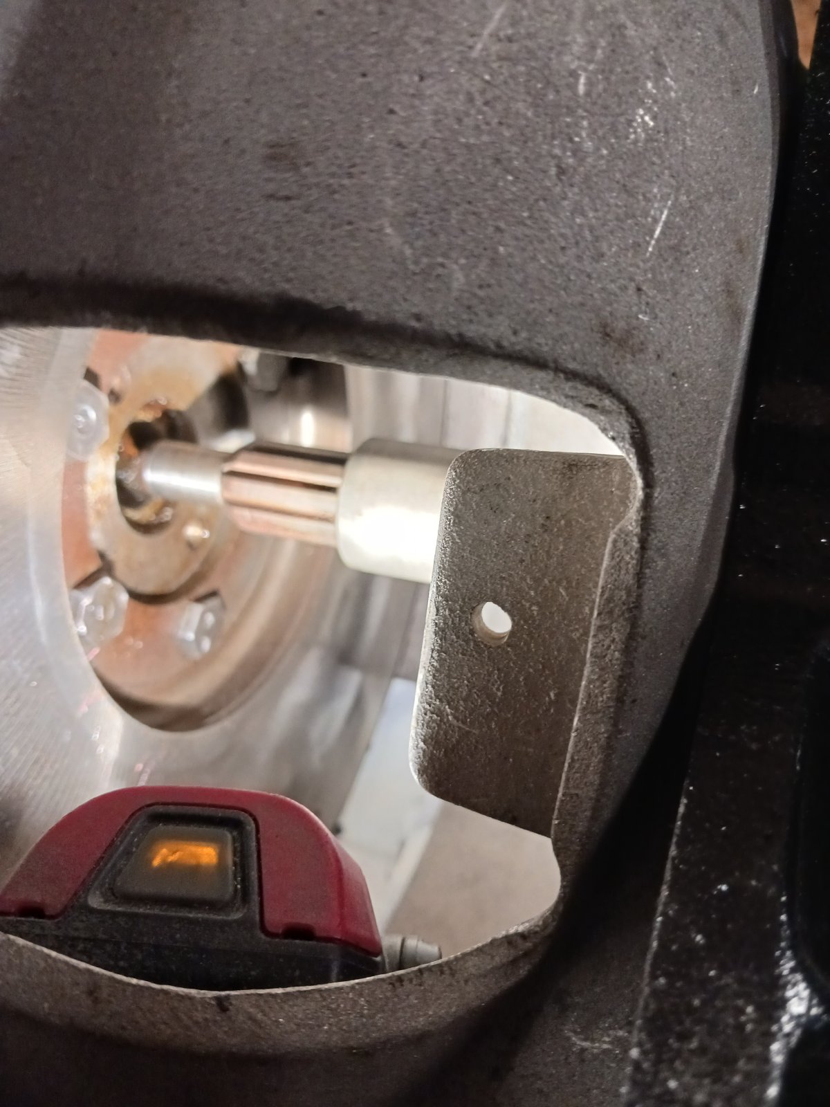

    Minor interruption yesterday. Seems the throw out bearing is a tad bit narrow and does not ride on the fingers of the clutch properly. I am using my new Ram clutch designed for the Olds. Been researching this to find a larger bearing that is compatible with the 1 1/16 input shaft and that fits the fork that I have just extended. The new bearing that I have is the 614038 unit with a face diameter of 2.550 whereas the Olds was 2.90. Looks like the 614034 is larger by spec and might fit. Mike at Ram clutch is going to look today when he gets into the shop. We will wait to see what he finds.

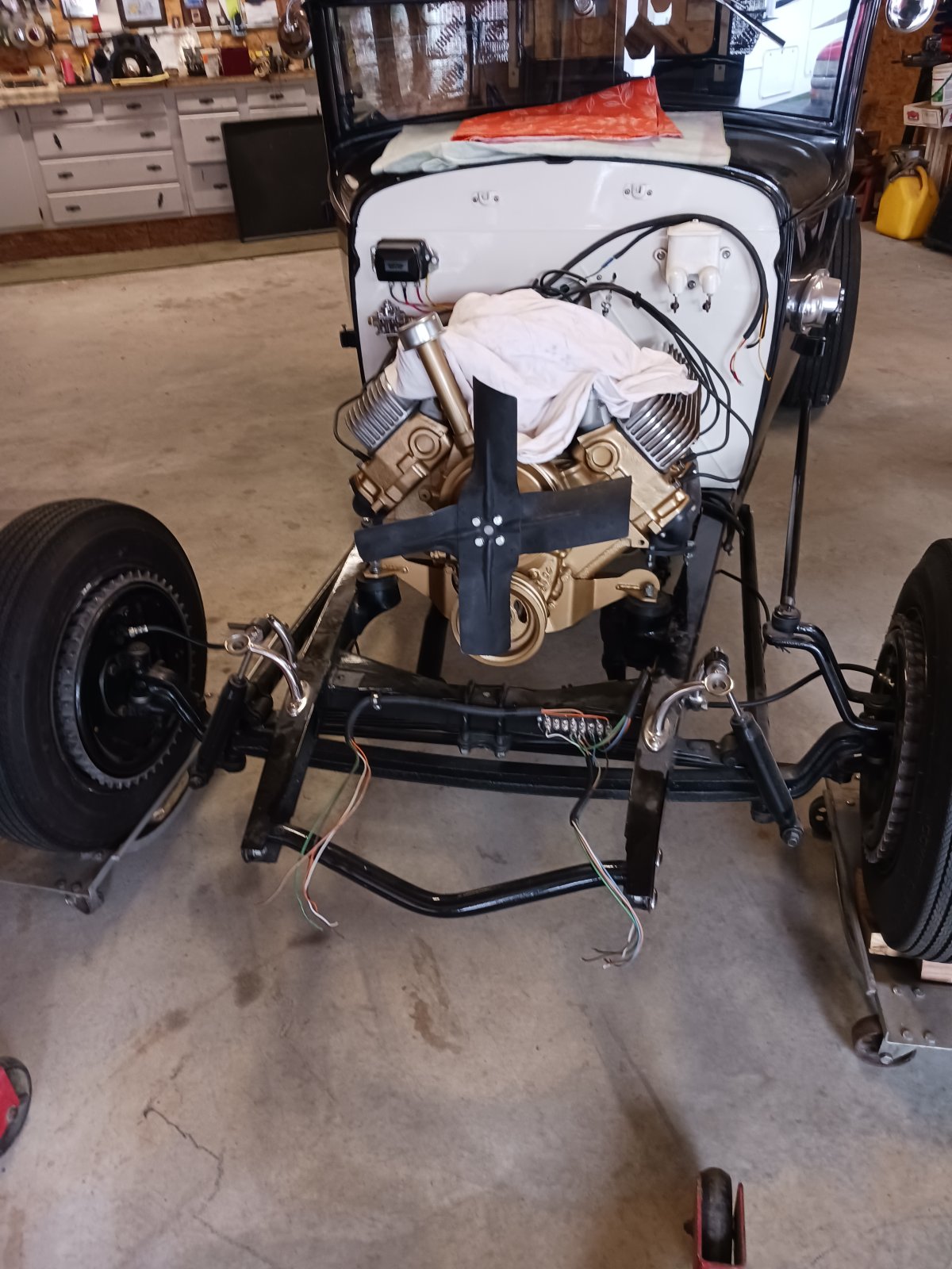

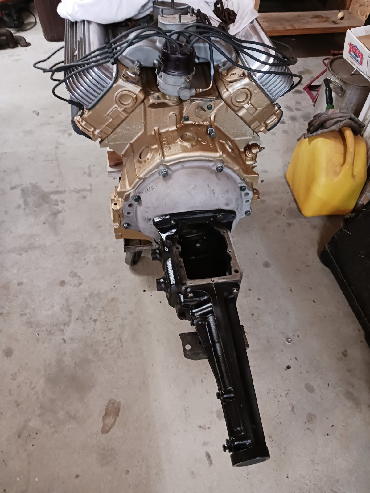

    Shortly after my last post I injured my lower back trying to be a 20 yr old:rolleyes:. Trying to lift a flywheel on to the end of the crank in an older Chevy 235 in liner while laying on the floor in 90 degree heat. It didn't end well, and I did not complete the job. Since then I have been unable to function, had many visits with the dr's, xrays, mri's etc etc. The short side of this story is that I apparently injured a ligament that is attached to the L4 and was informed that it will take up to 12 weeks to repair itself. They were not lying.
    So, I have been absent from the scene for some time now. Feel like a "couch potatoe" as I rarely get further than my bed or the couch. On the mend now and feeling much better but am being overly cautious. I managed to get out into the shop yesterday and indexed the bellhousing with some offset dowel pins (.014), installed the clutch and used the engine hoist to lift the ****** so I could get that attached to the engine as I am not to lift more than 20 lbs.

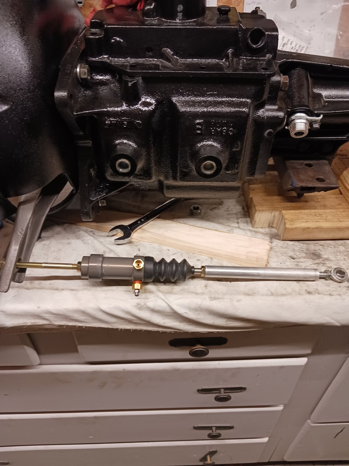

    I then attached the Wilwood hydraulic slave to the clutch fork and decided that I had done enough for the day. Maybe today I will attach a temporary line from the master cylinder to the slave to check out the clutch operation prior to putting the engine back in the car. P***ing that test I will enlist the help of some friends to get the engine back into the car where I can slowly pick away at all the little stuff. Still have to make a drive shaft but I have all the parts to do that.

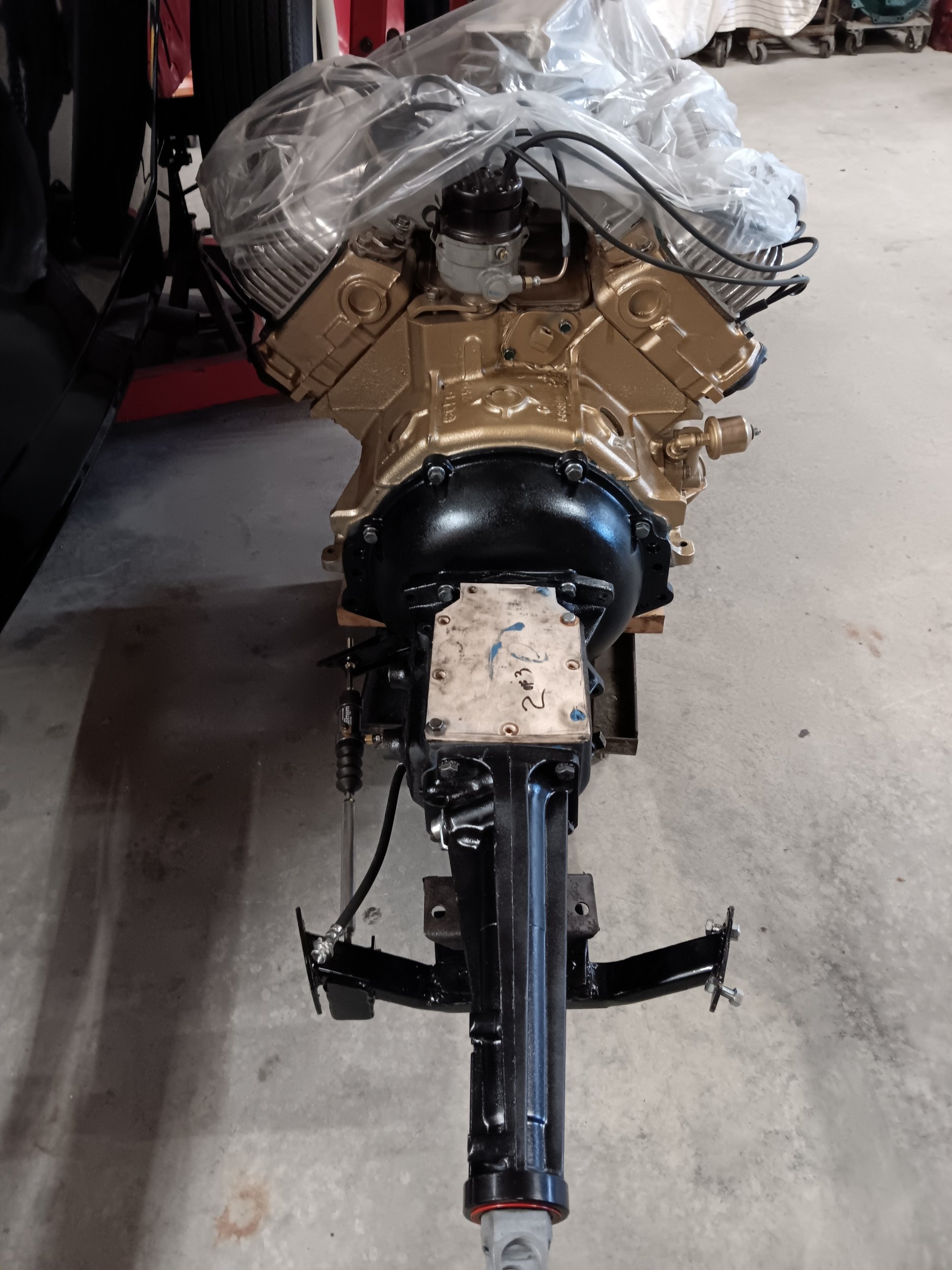

    Here are some pics of the engine with the ****** attached and the new puller slave. Fingers crossed that all goes well in the next week or so. I might get this done in time for some late fall runs!
