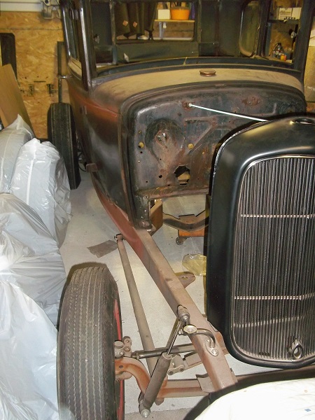

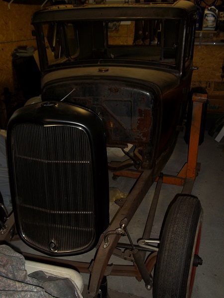

    went out to the shop. Just too cold to get anything done. 24 degrees inside today. -15 yesterday and 6 this morning with lots of wind. Just too hard to heat the old place up with the wind like that. Took a pic of the firewall cut that I made. Don't know how others do it but I figured I would cut it out with a 4 inch cut off disc. Left a small hump behind so that I can set the new panel against it then I can weld it from behind. Suppose to get back to regular winter weather on Sunday so I may get back out there next week.
    here is the panel I cut and fitted. Now have to build the distributor pocket and attach the brackets for the radiator supports.

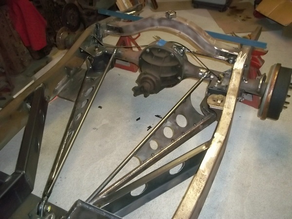

    After much aggravation with the frame it seemed easier to cut the X out and fab a new one as well as removing the rear cross member. That being said I had a friend bend me up some channel and got after the new cross member. Along the way the original plan for the Lasalle ****** got replaced with a 37 Buick ****** that I put a 57 Olds gut into. Very happy with the way that turned out. Parts are easier to come by for this set up as compared to the lasalle. Built a ****** support for that that bolts into the new crossmember.
    Got rid of the old trailing arms as they were not long enough to go up to the center of the ****** rear yoke. they were also attached to the sides of the frame (an application that I do not agree with) Replaced them with units that I traded for with my mentor , Bruce.
    Picked up a used A rear spring to play with and set the A crossmember in place. Had an idea that I would play with adding some 800 lb bags to the rear suspension to see if I could get a softer ride that may save my aging chronic back problem from becoming an issue when driving. Fabbed up some brackets and added those. Will reduce the numbers of leaves to compensate for having the bags. We will see how that goes. Worse case I will cut them out and go with the std. spring. Have to experiment now and then I suppose.
    Added some additional supports to the trailing arms to handle the torque of the Olds and installed some plates to make them a bit more rigid. Whipped out a pan hard bar and then back onto the design of the brakes.

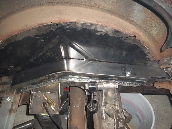

    Had to cut out the previous rear sub rails as they did not fit to my way of thinking. then fabbed up my own and proceeded to install them.
    the old:
    the new:
    and mounted in the car:

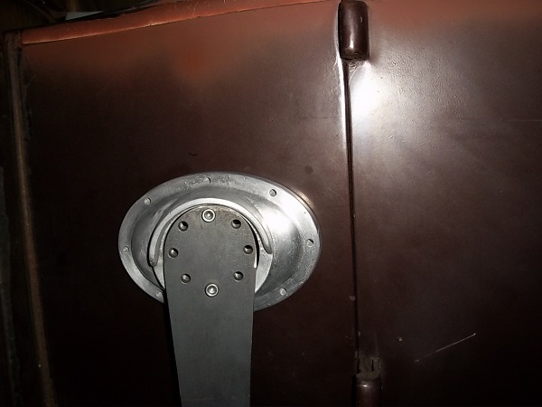

    Took a breather from the trunk and worked on the steering. Made a pitman arm up and attached it to the sector shaft. Built a drag link and attached the steering arm to the front backing plate. Decided to cover the pitman hole in the cowl with a slick cast unit from another member that casts these(fourspd2quad). Sweet deal for sure.

    Hi, Thanks for posting pictures of your project. It looks very nice. I am considering changing the steering on my roadster to cowl steering. I'm wondering where you got your steering box. New or ? Thanks.

    That box is a Mopar unit that was used in early 70 cars. All aluminum and easy to work on. you can get rebuilds from Rock Auto or other parts houses. I got this one from a race car that was retired.
    There are a couple of build threads in the archives showing what is all involved to do a Mopar box.
