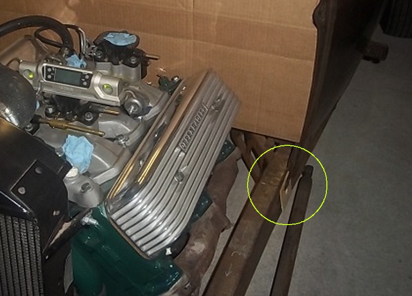

    So glad I clicked on this thread. Working on channeling my 37, and forgot that I'll have to drop the grille shell and doghouse too. Now I can start brainstorming a little earlier!
    Thanks flthd31!

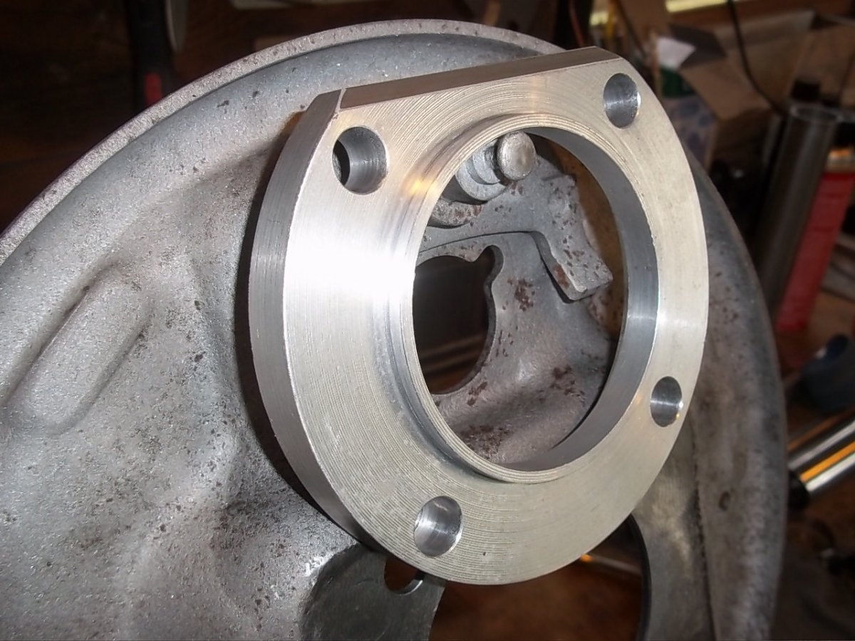

    Bolt pattern is too large so weld the holes up and redrill for the ford spindle. I used round back units.
    A machined hub adapter is required. I got lucky and found these with another member along with the backing plates and hubs.

    And in the backing plate looks like this:
    Now for the trial fit of the spindle:
    Break out the grinder and trim the top of the spindle to make it fit tight like this:
    Spindle adapters are required. These came from another member that I believe had purchased them from sanfordandson who is a member on here. This is the inside piece:
    tomcat11, bchctybob and Vic Walter like this.

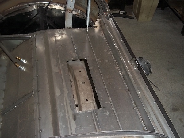

    Finally got the correct hinges for the trunk lid and with a little help from Smitty up in neighboring ME made up some hardware to bolt them down.
    Moving on I fabbed up some 1x1 for a frame to support the new Tanks 20 gal gas tank. had to shorten up the filler neck by an inch so that it would clear the deck lid and then installed the bulk head fittings for the gas line, the return line and soon the vent pipe.

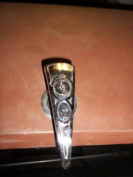

    At this point I turned my attention to finishing the floors and figuring out the deck lid latch. I had an old 37 latch that has the V8 on it so I m***aged that a bit and installed that in the deck lid. Then fought with the rear panel to get everything to align and allow the deck latch to work correctly. Didn't have a clue how the original set up handled rain water so I m***aged everything to allow the water to run behind and out to the ground.??? Looks like it will work ok.

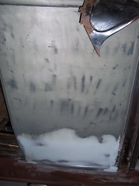

    Got all the patch panels in and started to skim coat those.

    Pulled the doors off and blasted them on both sides, then added the lower patches. Set them aside for the time being as I was beginning to run out of time this fall and I still wanted to look at a chop before heading south. After taping off the roof and messing with different chops I settled on 3 3/4. Got the 4 1/2 inch cutoff out and had at it. So here is the "required pic" of the roof off:
    And back on:
    While I had the top off I blasted both sides and fixed some pin holes. Much easier off than when back on for sure.

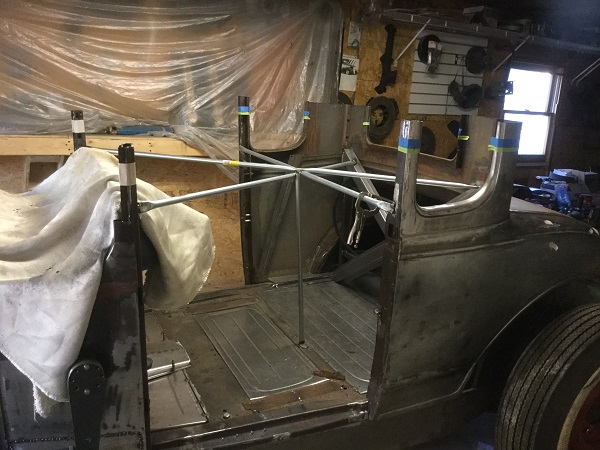

    Winter is almost over! Back in the garage now but still need the heat.....snow predicted for tomorrow again:rolleyes::rolleyes:
    Over the winter I have been rounding up wood pieces for the roof and yesterday I had my opportunity to see how all those pieces fit into an A coupe! Lots of measuring and fitting, cutting, fitting etc but in the end I am fairly happy with the initial install. Now I am going to take it all apart and poly all the wood and set it aside. Here is the end result so far
    Picked up bulk head fittings for the gas tank and have them in place
    Then decided to make a par***ion for the back of the seat to separate the trunk from the forward compartment
    I will glue Kool Mat to this as well as the floor to hold the heat and some noise back. I figure I will attach the panel to the X frame with sheet metal screws so it can be removed easily. Might seam seal the edges. Was going to put some bead rolls in it but it is pretty sound when attached to the X so I changed my mind on that.
    Today I bought some of that Loc***e rust inhibitor and brushed it on all the interior panels that were rusted. Two coats twenty minutes apart and then it turns black when dried. I will top coat it with a rattle can product in a couple days. Never used it before, always used Por15 but this is easier and less money.....we will see how it works out.
