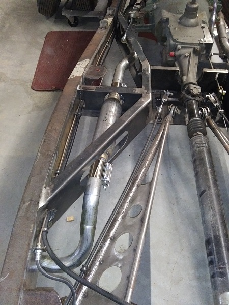

    In the meantime I had a good friend take the frame and build or bend up some 2 inch exhaust. He has a tubing bender from a shop that closed that makes it much easier so long as you are good with angles:rolleyes:.
    We managed to keep all of it hidden up in the frame rails but took the easy way out and turned the tips out in front of the rear wheels. Waiting on hangar bushings at the moment then I can finish hanging the pipes.

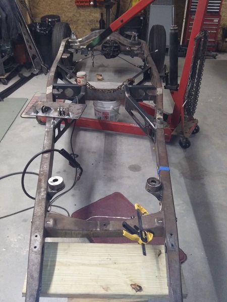

    Made a couple of hose brackets for the front brake hoses and welded them to the frame. Went down to my local Napa store and picked up two hoses that fit the Buick wheel cylinders. They are 15 inches long which is near perfect for this application. Grabbed some Nicop 3/16 line....$42 for a 25 foot roll! Man prices have just gotten out of hand in the last 2 years. Only need 5 feet so I sourced a premade 6 footer at another store which will do fine. Will start bending some line now.

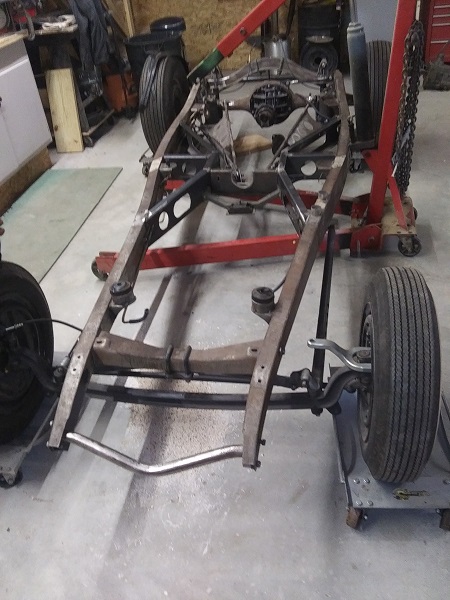

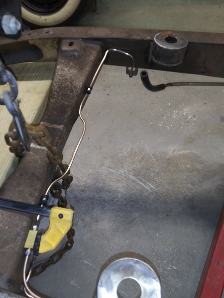

    finished bending some tube, made a few mistakes... too many ups and downs and corners:rolleyes: would help if I had a really good bender. I have probably five but none that will make those real close bends so I improvise which is where I get into trouble. Regardless of the issues it is done for the moment. Still have to tie the MC in but have to wait for the body as it is mounted on the firewall.

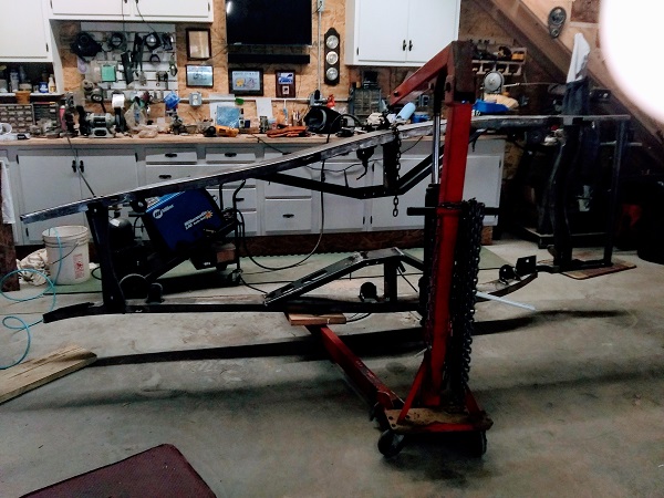

    Now that the front lines are in I can break down the frame. Been at that most of the day but it is apart so I will now start all the finish welding as most everything is just tacked at the moment.

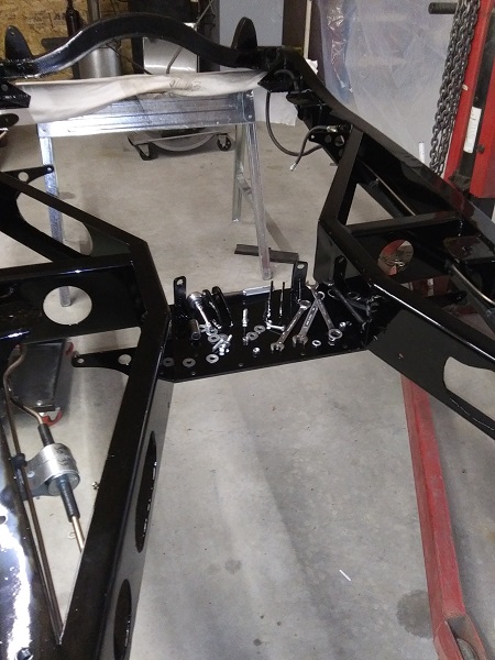

    For the last two days I have been stripping the frame, doing some small repairs and sanding a little bondo. This afternoon I picked the frame up and set it in the truck. I will take it up to the paint booth tomorrow weather permitting. Hope to get it in paint this week and back home.

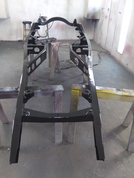

    And now in paint! Will pick it up tomorrow weather permitting.....
  26. vtwhead
    Joined: Oct 20, 2008
    Posts: 5,305
    vtwhead

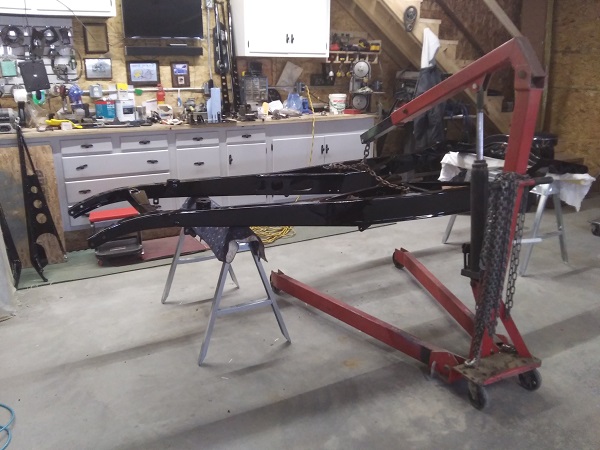

    Brought the fresh frame back to the shop and set it on some saw horses. Will start with the easy stuff first, remounting the fuel and brake lines. Then I will install the center cross member. Tore the rear end apart and finished welding the larger trailing arm supports on. Then some general clean up. Really needed to be blasted but that is not going to happen with the winter weather outside and the fact that it will not fit in my blast cabinet so I scuffed it off, degreased it and put on some Por15 on the rusty areas. Tomorrow after it is dry I will take it up to the paint booth and will shoot it and the rest of the small parts. That should finish the painting for the moment.

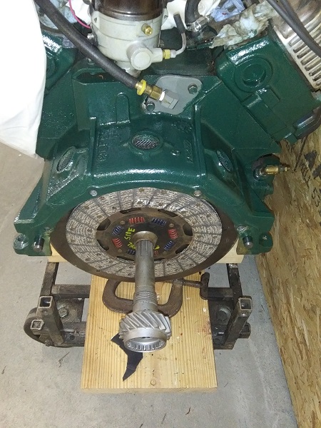

    Meanwhile I worked on pulling some of the parts out for the clutch etc. Put the throw out bearing and clutch fork together and detailed the bellhousing.
    The clutch fork boot was non existent so I rummaged thru some unused stash and found a later GM piece, made a new bracket to hold it in place (top right in pic), drilled and tapped 2 new holes in the housing to hold it in place. Does a much better job than the open hole:rolleyes:.
    Pulled my rebuilt clutch out of storage and the 176 tooth flywheel. Searched around for the MIA bolts that were here 2 years ago! Then realized that I am also missing the pilot bushing that I had purchased probably 5 years ago. Amazing the amount of time I spend looking for things I know I have.
    Cleaned up the elusive pilot and drove it home, test fitted the bell and ******. All looks like it was meant to go together but then realized the block was missing the alignment pins. fortunately, I have several later 51+ bells in stock and one had the two pins in place. Got lucky on that one. Got them out, cleaned them up and installed them in the block. Now we are good, I hope.
    Then the furnace in the shop tried to start but the motor bound up. So put my furnace tech hat on and began to look into that. Hmmm, motor is shot.....called my fellow hot rodder furnace guy in. Back and forth for the rest of the day and half of the day yesterday. Now down to 17 degrees and 40 in the shop. Had an issue with mating the squirrel cage with the right motor but after a lot of reengineering we got 'er done and had the heat back. End of the delay for now.
    Mounted the flywheel and torqued it down to 85 foot pounds. Now I need some hardware to bolt everything else together so today I will be out in public (rare excursion lately) finding said hardware.
