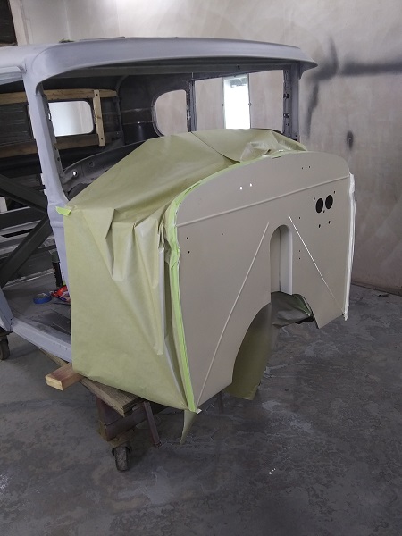

    Got some color on the firewall, finally. Went with Wimbledon white instead of Polar white. Not a big difference really but it still feels good to have some color on the project. May get to put the black on next week. Some hurdles to jump first though, always lots of hurdles!
    Had one spot the size of a nickle lift a bit. Will let it dry and scuff the firewall and reshoot it in the hope that it will lay down. If not I will mount my HAMB tag over it!:rolleyes:

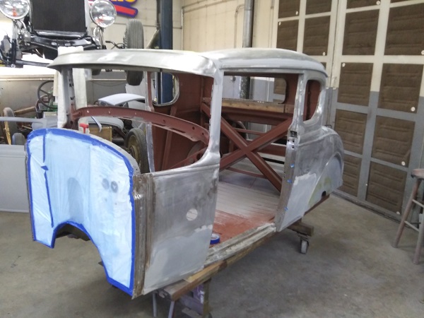

    spent two days stripping all the primer off the coupe except that covering patch areas. Sanded all of it with 180 and then blew it off followed by a wipe down with prepsol. Laid down two wet coats of etching primer as per specs from the manufacturer. Let it flash off and then followed with 2 coats High Teck Hi build. So far so good. The high build layed down perfect and looks very smooth. Today we will block it off with 600 and may get to paint early next week I hope. Will post a pic of the high build later today. Here is where we ended up prior to the etching.

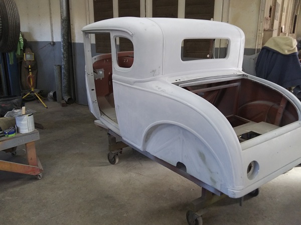

    Spent the day or most of it blocking the first two coats of hi build. Looks clear that we will need a couple more which we will shoot tomorrow. Hoping that will be enough. At the end of the day it looks like this.

    got our booster shots and of course that kicked my but for a bit but I did get back to the shop yesterday pm. We shot 2 more coats of high build on. Will go up tomorrow and start blocking it out again, hopefully for the last time. We will know after i get the guide coat on and off:rolleyes:

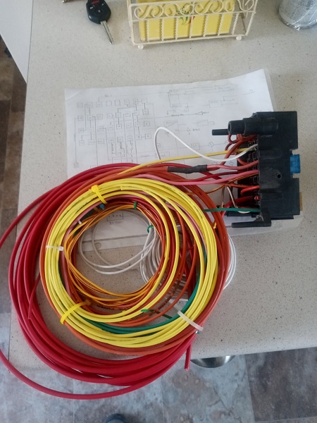

    Meanwhile, thought I would work on my wiring. Pulled a fuse panel from a Nova wiring harness I had and designed my own panel. This panel is small enough that I am going to be able to mount it in my glove box for easy access. Won't be a lot of wiring as there isn't a need for a lot of accessories. I am using wiring that is labeled that I purchased a while back. This should make it easy to keep track of all the wires now and in the future. Now I need to locate a Ford truck instrument panel and rob one of the movements as I need to convert from Amp to voltmeter in the existing instrument panel. Add a couple relays for the horn and lights and I should be on my way to roughing in the wiring.

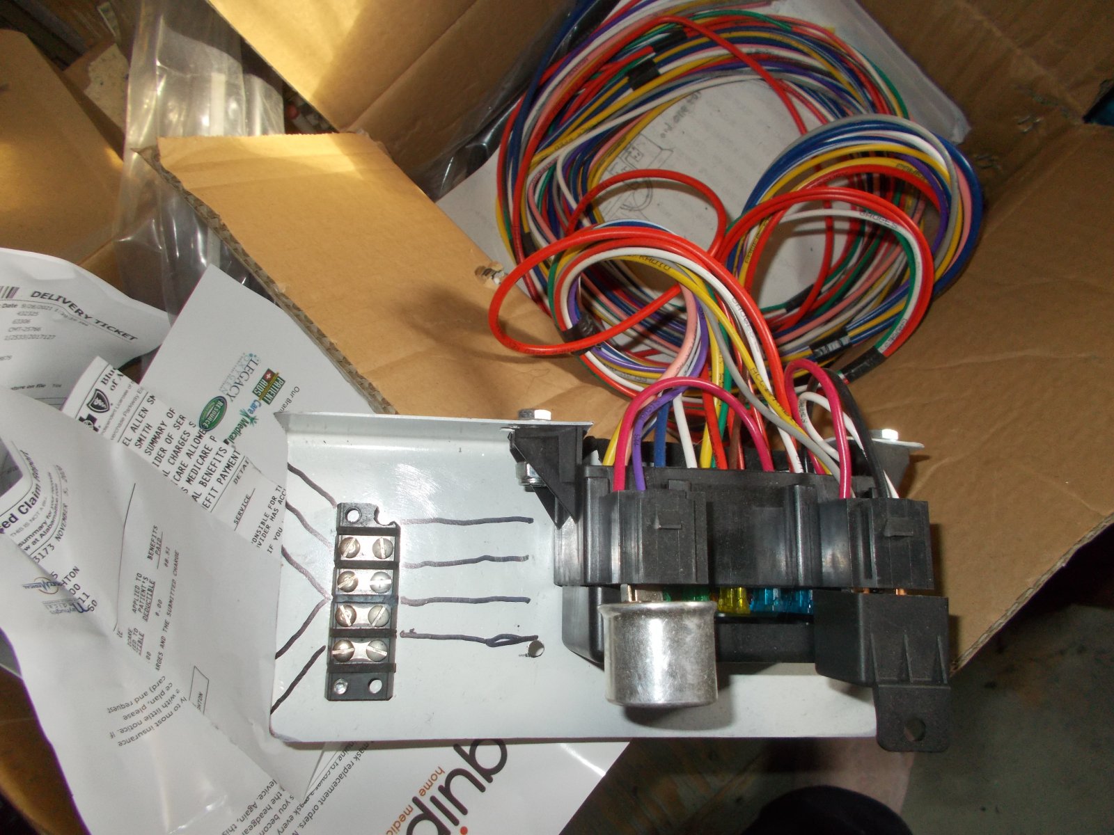

    Ditto on electrics shock... i was good at it 30 years ago...
    i am having a pro re-wire my coupe this winter,
    everything works great now but is pieced and patched and very ugly...
    he sent me the #s for the thing he uses... ebay, $39.00 ...
    looks just like what you have in the box...
    i fabbed up an offset bracket to bolt it to the A pillar to cowl support channel...
    screwed [4 each] hook-up ACC. and HOT neutral block on it for easy addition later... painted it white and made some rows to mark the new additions...
    this lets the wire run up the cowl side and across the cowl top...
    wire are also labeled every foot... 12 or less circuits ... a heater as an only accessory...

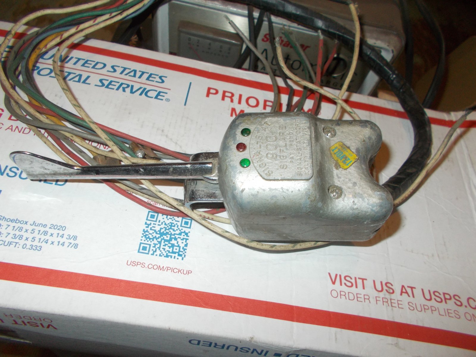

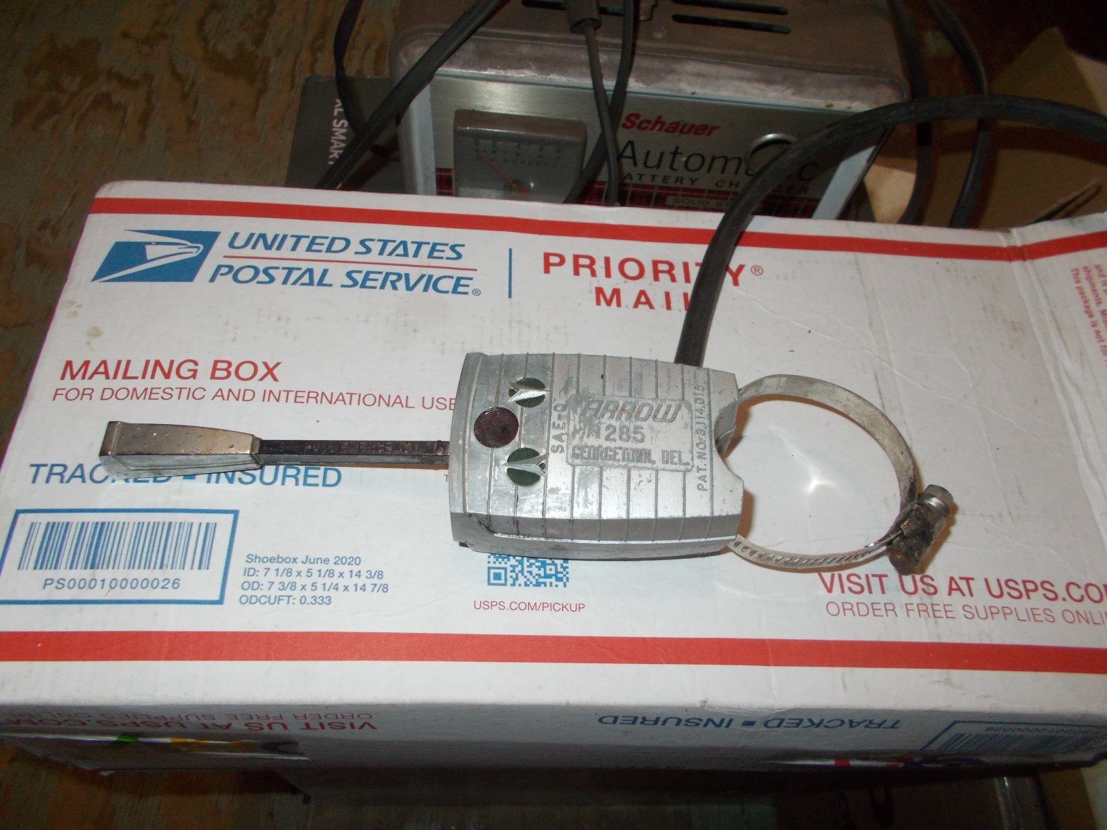

    have and will use the new signal stat [7 wire]...
    a couple older signal-stats [4+7 wire],
    and an arrow [4 wire] top pic... may use this one as it is thinner F-B... DSCN7926.JPG DSCN7927.JPG

    What is the red jewel in the center for? I don't think mine has that.

    4 way, pull the chrome tab forward activates both lights, red ind.

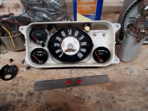

    In the mean time I worked on the instruments for the 50 dash cluster. The speedo would work but the odometer was not moving. Appears it's drive mechanism is just wore out. I picked up a 69 Ford truck instrument cluster last week in the hope that I can convert the gauges and perhaps the speedo to fit into the 50 housing. This is what I came home with from the yard
    The ammeter from the top right will be replaced with a new volt meter but the other gauges appear to be in good condition and I should be able to use them with some modification. Both speedos are driven by a king-seeley unit that is identical so my intent is to steal the gear drives (nylon pieces) from the 69 to work in the 50. I will roll that odometer back to zero for a fresh start. The newer gauges will require brackets to attach them to the back of the 50 housing. Started laying out one with the insulated grommets. Will bend that into a U shape and attach it to the back of the housing with small screws. This is the 50 housing with the old gauges that I am working with.
    I had originally thought that the gauges were in good shape and they may be but the 69 pieces are much nicer and the sending units are less money compared to the vintage ones I would need so I feel I am ahead of the game so to speak.
