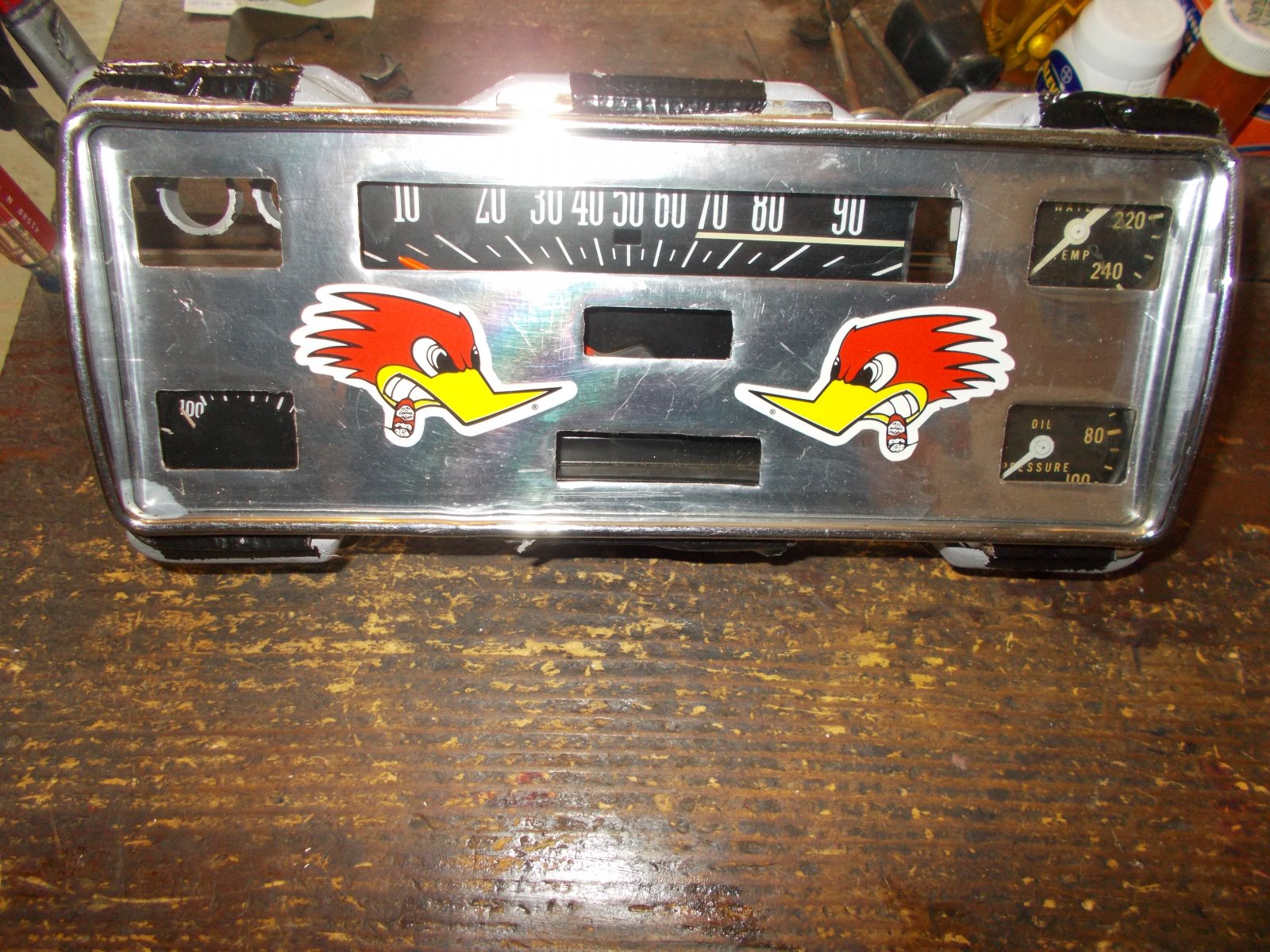

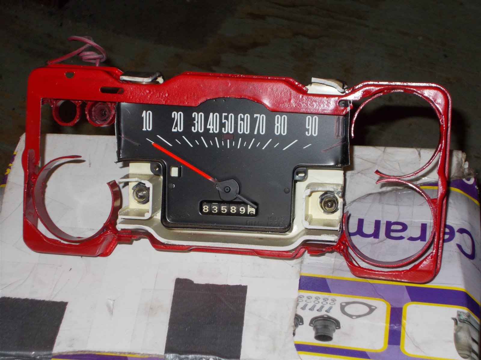

    Got all the gauges retro'd. The newer units are almost identical in size to the '50 pieces. All that was required was a little t******* of the gauge aprons so that the apron did not interfere with the face of the cluster. Here are side by side shots.
    The newer unit is on the left. I removed the bracket and it fit perfectly over the new gauge. Hardware is all the same. A little ******* around the housing hole and they dropped right in. First one was the fuel. Here is what it looks like installed compared to the old 50 units.
    And with all three installed.
    When it warms up a bit I am going back to the yard and rob the senders off of that truck.
    The speedometer was a bit of a challenge. The newer odometers are made so that you cannot easily take them apart to roll the mileage back. I pulled it out of the unit but determined that it was a bit risky trying to remove the pressed-on ferrule that retains all of the cylinders. Didn't want to break it and then have to look for a replacement so it is what it is and we will leave it alone. Put it all back together and tested it with my drill. All appears to be working now.

    i took an old cable, cut off about 4", put it in my fastest drill and ran the odometer forward to 000 000
    held it wide open watching tv...

    Smitty I don't think I could watch that much tv! My speedo is at 14000 something. Might be easier to go in reverse LOL

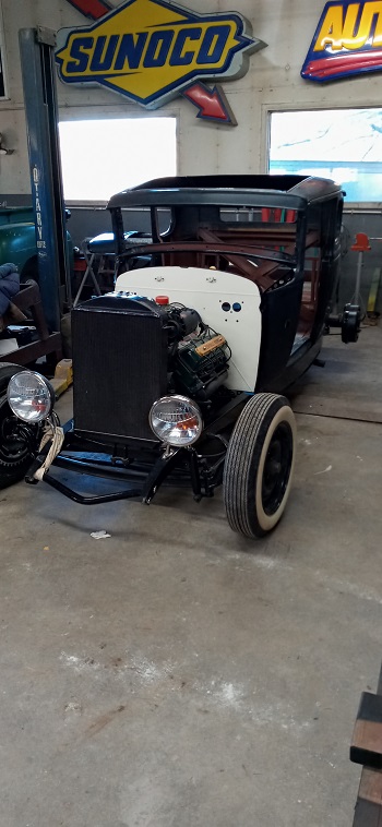

    Thanks, fellas, for the input. Got the A home yesterday afternoon and staged in the shop. Painted the master cylinder white and it is holding this time around. Had issues with contamination first time around but I soaked it in Windex and it seemed to clean it to the point that it would hold paint. Next on the list is hooking up the brake and clutch slave and routing the lines. That will make room for putting the hoop in that the steering attaches to. Lots to do now. Feel like I just got out of (paint)jail and am free to get moving on.

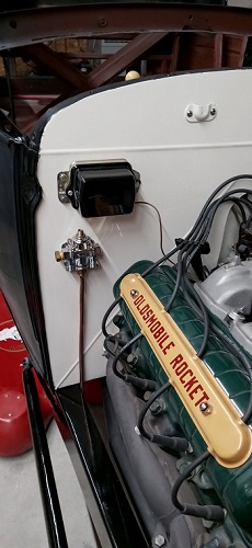

    Got the hoop reinstalled and tied down, mounted the brake/clutch ***embly and moved the Mallory coil to its mount on the hoop. Anxious to see how the clutch is going to work with the hydraulic slave cylinder. I rechecked the ratio on the clutch pedal, and it appeared to be a bit short, so I moved the yoke closer to the fulcrum and if my math is correct, I am now close to 7:1.
    Ran the battery cable to the trunk where it will terminate in a master switch. Need to make a bracket for that which is on the list tomorrow along with fabbing up a couple 3 inch brake/clutch pedals. Pulled the gas tank out of storage. Need to order a sending unit for that.

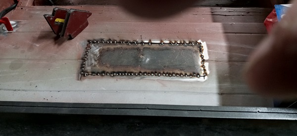

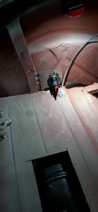

    I needed to fab up a plate to mount the battery cut off switch in the trunk. I drilled a 2 1/8 hole in some plate, welded a couple tabs on the rear for the bolts and then tacked it in place at the end of my "too short" battery cable:rolleyes:. Now I just need to make up the feed end which will necessitate buying a little bit more cable.
    Guess it was time to fill in the hole over that cross member so I s***ched in a new plate with a small relief for the spring bolt head.

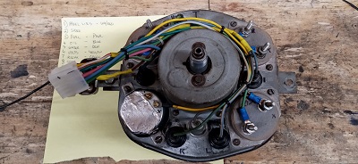

    The Molex connectors came today so I finished the rewire of the gauges and finished the upgrade to a voltmeter. Tested all the gauges with a 9 volt battery and they all seem to work. These were the gauges I removed from a low mileage '68 F500 truck over in the local yard. Happy that it all worked out and it was not very expensive even with new sending units.

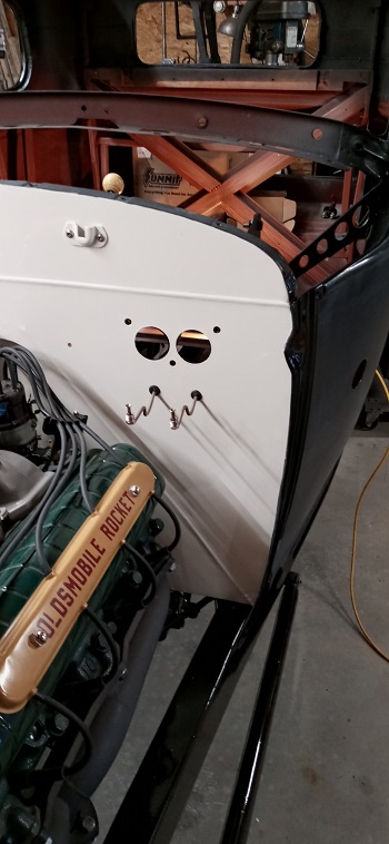

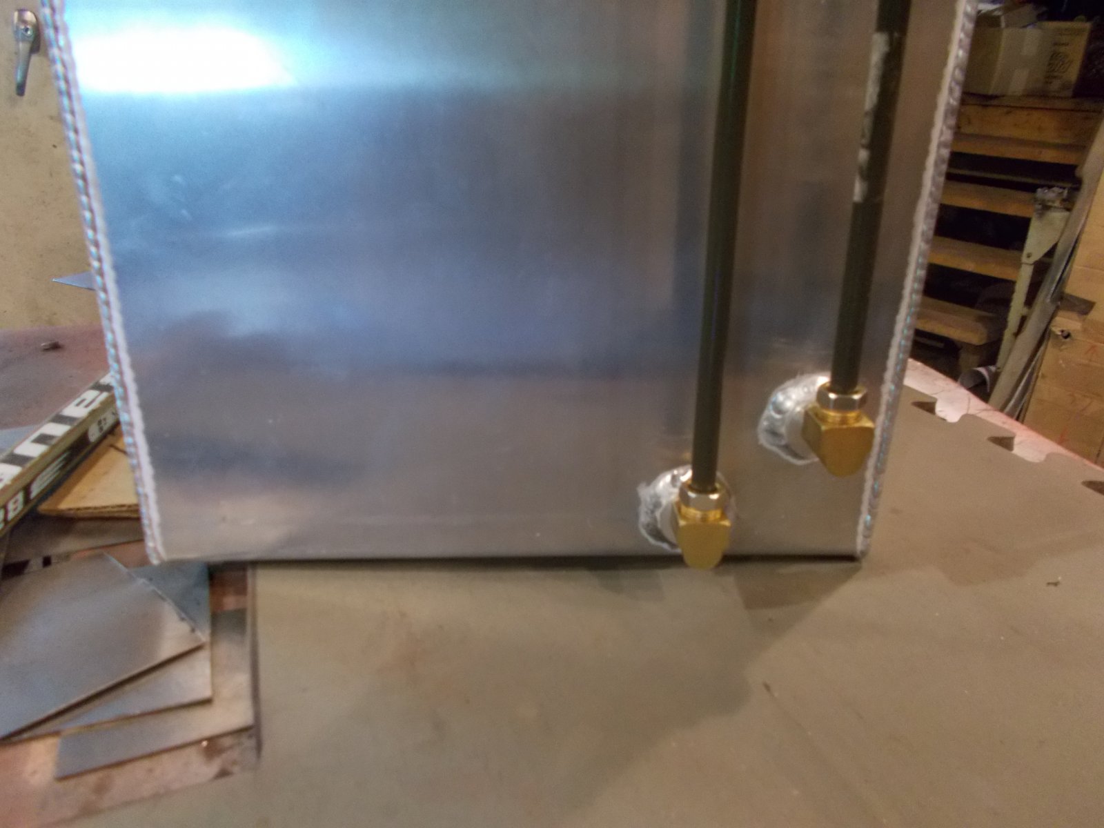

    Managed to get the fuel pump installed down on the rail under the tank. The sender came also so I adjusted it for the tank depth and installed that in the tank. The tank has a vent fitting and comes with a nice vent/roll over valve. However, the instructions clearly state that it needs to be above the filler height which in a Model A coupe with trunk mounted 18-gallon tank is nearly impossible.
    Wonder what others have done to remedy this situation?
    Here is the pic of that pump. Small unit, saves space, hope it works out.
    And that tank. Takes up most of the room in the trunk but at least it gives me 18 gallons of petro which that Olds may need. It bolts to a 1x1 frame that it sets on

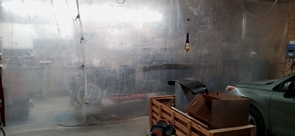

    It has been cold this week with a lot of wind. Time to pull the screen across the shop. Makes a world of difference in keeping warm as the furnace is on the work side of the plastic.

    Snuck in a little time during the holiday. Been m***aging the fuel delivery system, particularly the fuel delivery to the tri-power. Tried all the set ups with fuel blocks etc and in the end was not enthused with all the fuel lines crowding the engine space. Have a nice Moon old fuel block I wanted to use but it just did not look right on the firewall where space is getting limited. I mounted the voltage regulator and positioned the fuel pressure regulator, installed the 3/8 fuel line and have pretty much decided to use Stromberg's banjo fittings which solve several issues.
    Pricey little ****ers but it is what it is.
    Today I am going to pick up a byp*** filter (Napa 3040) that will give me a 1/4 inch return line to the tank. That will be mounted on the frame and plumbed from there back. The return line is recommended by Stromberg to alleviate back pressure when this new fuel we use expands due to heat soak and tries to puke out of the 97's. Additionally I am told that the return line keeps cooler fuel in the delivery system since it is recirculating all the time. Sounds good anyway.:rolleyes:

    those ford 2 bar. carb filters only work one way... couldn't tell which way the pump was pushing...
    i mounted my electric fuel pump beside the tank on the floor... works...
    my fuel pick ups are mounted 1" and 2" above the floor... gravity works for me...
    2" = regular... 1" = reserve... buys me about 1 gallon of reserve... DSCN0915.JPG
