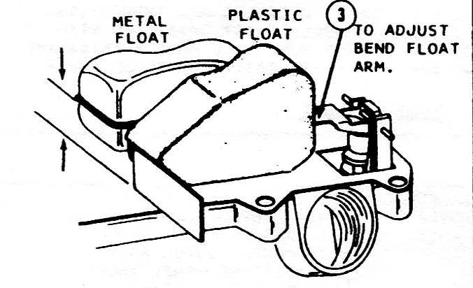

    The float pivot rod should be long enough that it won't walk out. It should hit on the main body before it clears the top axle support, when ***embled.
    See how far it sticks out on each end?
    Floats are adjusted for proper shutoff height and drop or droop, as mentioned. Important. This is normally roughly when the top is flipped upside down the float is pushing against the needle, seating it. The top of the float (bottom when flipped) and the gasket surface of the top are pretty level, but this is measured in 1/16s or 1/32s. The rebuild kit will have all the measurements laid out.
    Fuel pressure is a big part of this. A float acting on the small area of the needle exerts enough pressure to overcome the expected fuel pressure plus a bit. Too much pressure will overcome the float. Just like pushing a ball underwater. The cheap m*** market gauges and regulators are not to be trusted.
