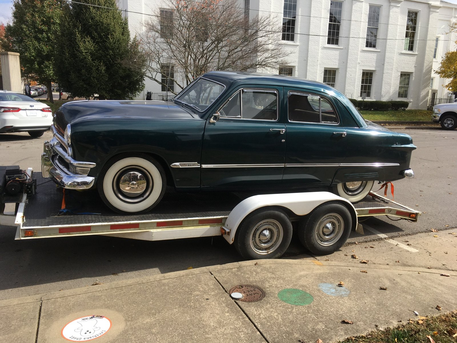

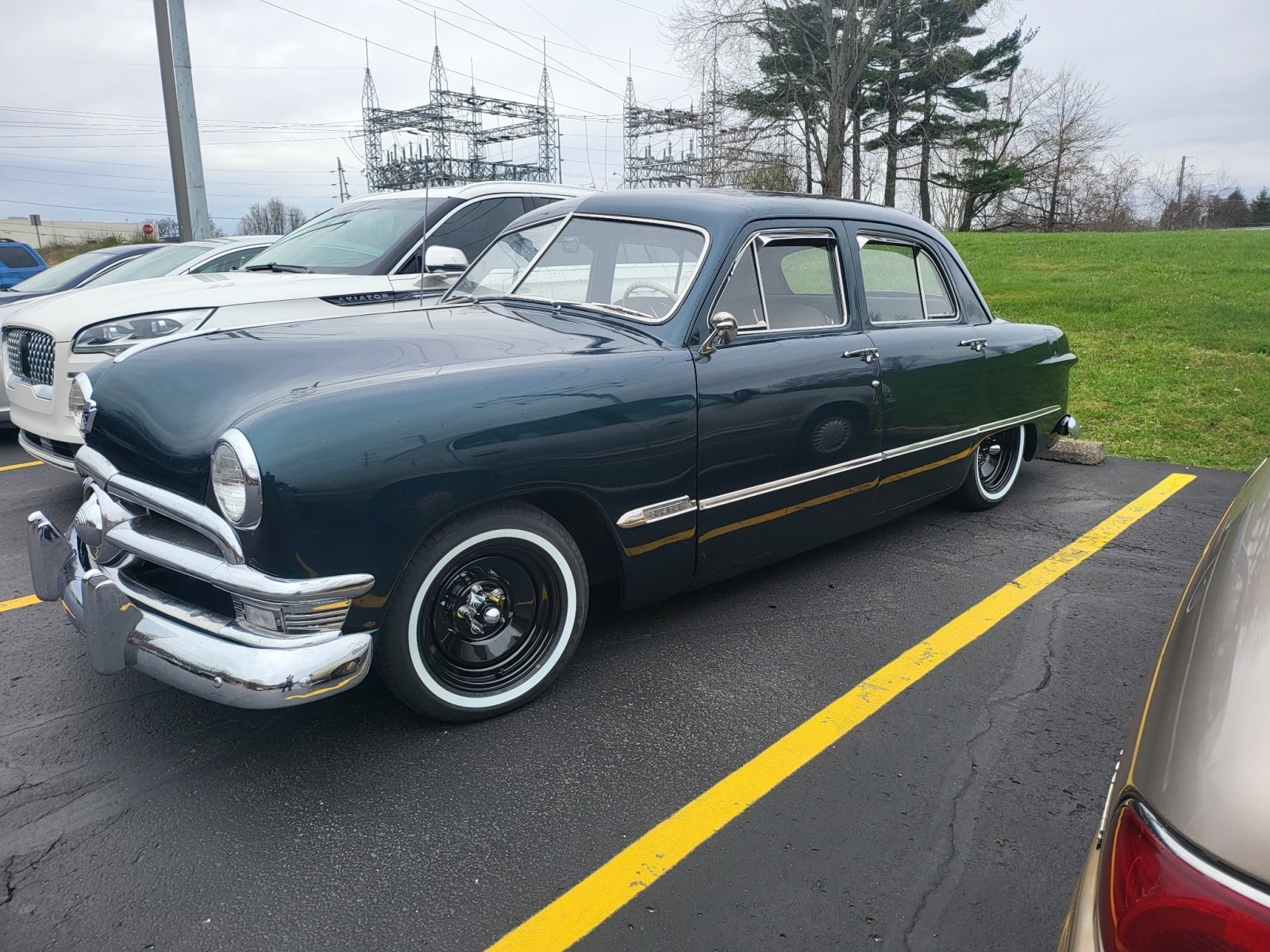

  10. Wow that one looks brand new. I bet that cost a lot. If that's dark green, than that's the same color that my car was originally. You can still see it in the trunk lid. Sometime in the 70's it was painted red (fender skirts are left over from that) and all the windows were given red tint. Owner who had it before the guy I bought it from put custom door cards (literal cardboard with vinyl over it, unfortunately very water damaged, a lot of the window rubber is dried out) and custom upholstery, as well as spray painting the car matte black. Previous owner peeled the side window tint off but left the back one. I put the skirts back on. The entire rear wheel arches are Bondo, but they did a good job, except for a huge crack right under the fuel filler. Radio's a dummy also, heater core is missing as well,
