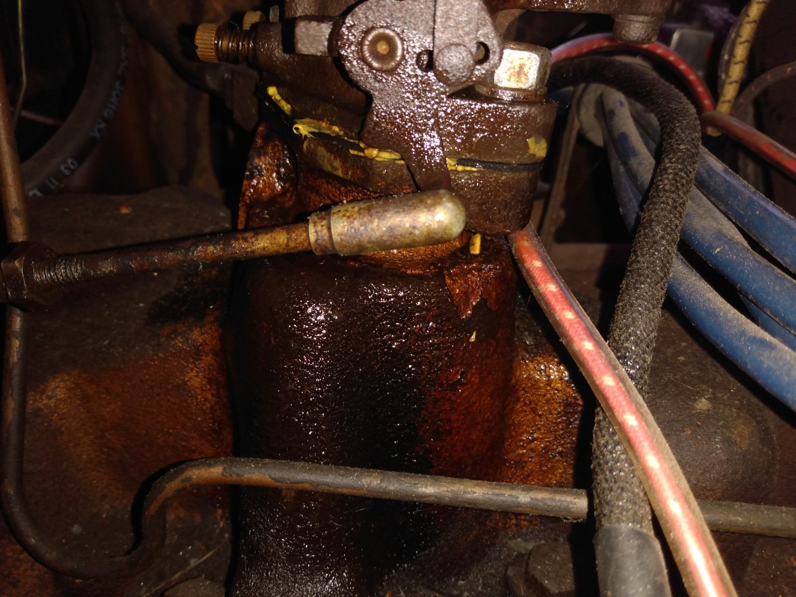

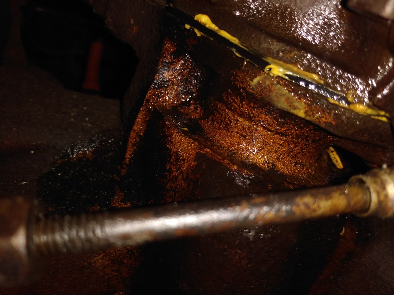

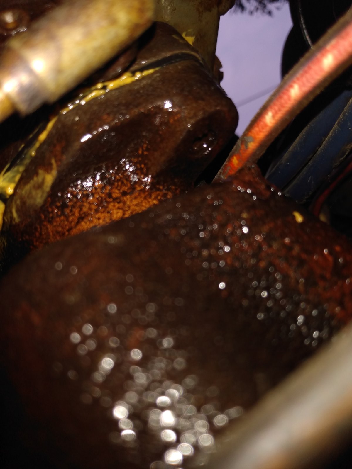

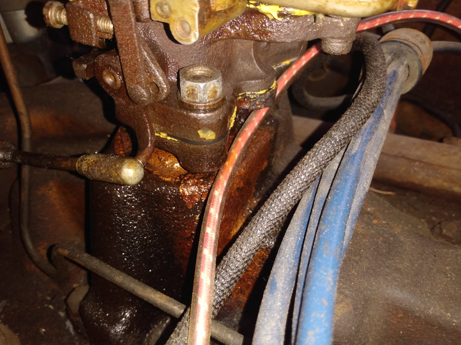

  9. The carb fuel leak persists. No idea what it can be at this point. New gasket, tightened properly, even put gasket sealant on there and it still leaks. It always has but i don't know what else it could be. IMG_20230608_194618774.jpg IMG_20230608_194558524.jpg IMG_20230608_194553669.jpg IMG_20230608_194602538.jpg
    Pictures make it look drier than it is. No dripping of any kind, the base of the carb always just leeches fuel out like that.
    Didn't run today so I'll try on Saturday. It usually takes about a day to "reset" from when you try to start it. I'm sure it's just weak spark at this point, because it tries to start and it'll occasionally hit
  10. clem
    Joined: Dec 20, 2006
    Posts: 4,683
    clem
    The pictures below suggest otherwise.
    Is the power valve okay, as in did you test that it’s not leaking, or float setting too high, ? Both will cause the leaking as showing in the photos below.
    All mating surfaces flat ?
    I have never use a sealant or gasket out of a tube for a carb, as there shouldn’t be a need to.

  11. The power valve looks fine to me but I don't know how to test it. Yes they're all flat. I only used the sealant because I thought it would take care of the problem. It helped a little bit but evidently it didn't fix it
  12. BJR
    Joined: Mar 11, 2005
    Posts: 11,286
    BJR
    Bad Needle and seat, or float level too high.

  13. clem
    Posts: 4,683
    clem
    With power valve in place, and bottom third (throttle plate portion/***embly), of carb removed, fill fuel bowl and leave overnight - any change to fuel level (other than evaporation), or moisture around bottom of Power Valve (economizer valve) will indicate leaking

  14. simplestone
    Joined: Aug 18, 2010
    Posts: 953
    simplestone
    Could the carb possibly be leaking around the throttle shaft?
    I don't know much about these carbs, but the Rochester carb on my 235 has this problem.
  15. I can't take it apart right now, because the gasket sealant will rip the gasket apart if I do, and I don't have a spare. I will do this though, eventually.
  16. Driver50x
    Joined: May 5, 2014
    Posts: 565
    Driver50x
    In the future, don’t use any sealant on carburetor gaskets. It is not necessary, and will generally cause more problems than it solves. I went through the same learning curve many years ago.
