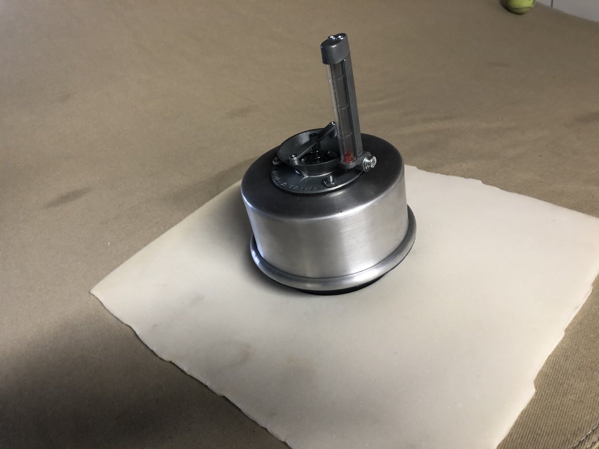

    jj94tt, you never said straight or progressive linkage. I run dual WCFB’s as progressive (they are not on a Mopar or GM) and idle on both. I do not and never had a hesitation. I set them at idle with a UniSyn both in neutral and in gear. Since the aluminum carb cover I use is a larger diameter I siliconed an adapter to it and then the UniSyn to it. (See photo) At idle both red balls are exactly the same and near center. My idle in gear is just under 600 and my engine is bone stock. My accelerator pumps are on the stock location and the slightest movement allows a dribble of fuel in.
    To me it sounds like a fuel problem or an added air problem. I have never heard of the over rich puddles carb king described unless it was on an old Smokey Ram manifold but he knows way more than me. I recently changed my intake gaskets and was able to lean out both my carbs by the UniSyn.
    I have my vacuum advance usesVenturi vacuum at idle. Good luck. 18A9BDFF-5537-4497-94EF-269E2DB037C1.jpeg D884A808-524F-4590-BE93-48F3D2473124.jpeg

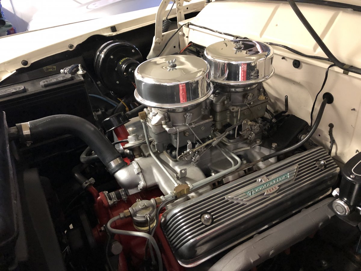

    JJ .... how about some good engine pictures and even a video to help us out?
    Based on what you have wrote, my money is on what @carbking Jon says, he knows.

    I will have to get some pics and a video.
