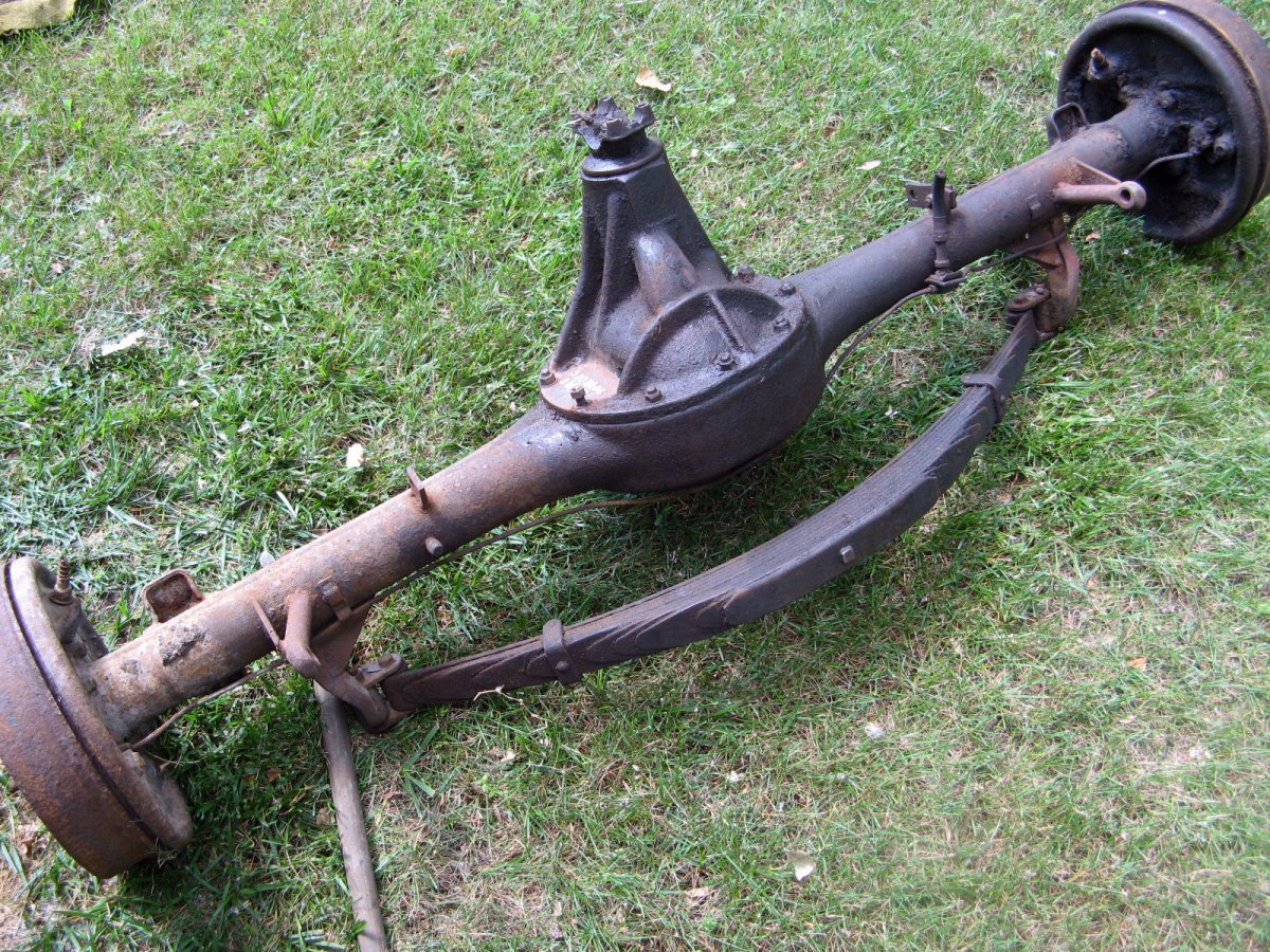

    rear chev 01.jpg rear chev 02.jpg rear chev 03.jpg rear chev 04.jpg The rear axle is a GM product, 4.11 ratio, non-positraction, three-inch axle housing - I think it is a '55 - '64. Can anybody enlighten me as to what specifically came out of? There was a two inch metal tag bolted over the pig casting number, but I was unable to recover any markings from it. Somebody added a ten-leaf buggy spring off the rear and crude leading / trailing link mounting points.
    I will be using a narrowed 9-inch, so this one will find a new home.

    Very cool project, love those Anglias. If your rear end has 9 bolts around the center section it is a 55-64 Chevy, and from those numbers I believe it is a 1956. Is there a fill plug on the back of the housing, if so it could be a 57.
    Don

    Leaf spring pads make it 55- 57, 58's had coils. I think Don's right about the plug making it a 57. If it's a 4.11 ring and pinion, that's a rare carrier.
    chryslerfan55 and els like this.

    Don, Yes there is a fill plug on the backside of this carrier. It has a square nut and a sealing flange about 1.5 inches in diameter. The center section looks to be OEM as the ten fastening nuts still have the copper seals on them. I remember doing a posi 4.11 for one of these units and I had to grind away an internal rib to get the posi case to clear it.

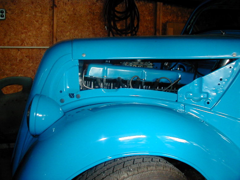

    Mike Britton, I am thinking a 240 / 300 big six, like my son has in his Anglia. He stores it at my place so it will be an extremely useful visual aid in resurrecting this one.
    'Cept his is a two-holer - this one is a three-holer.
