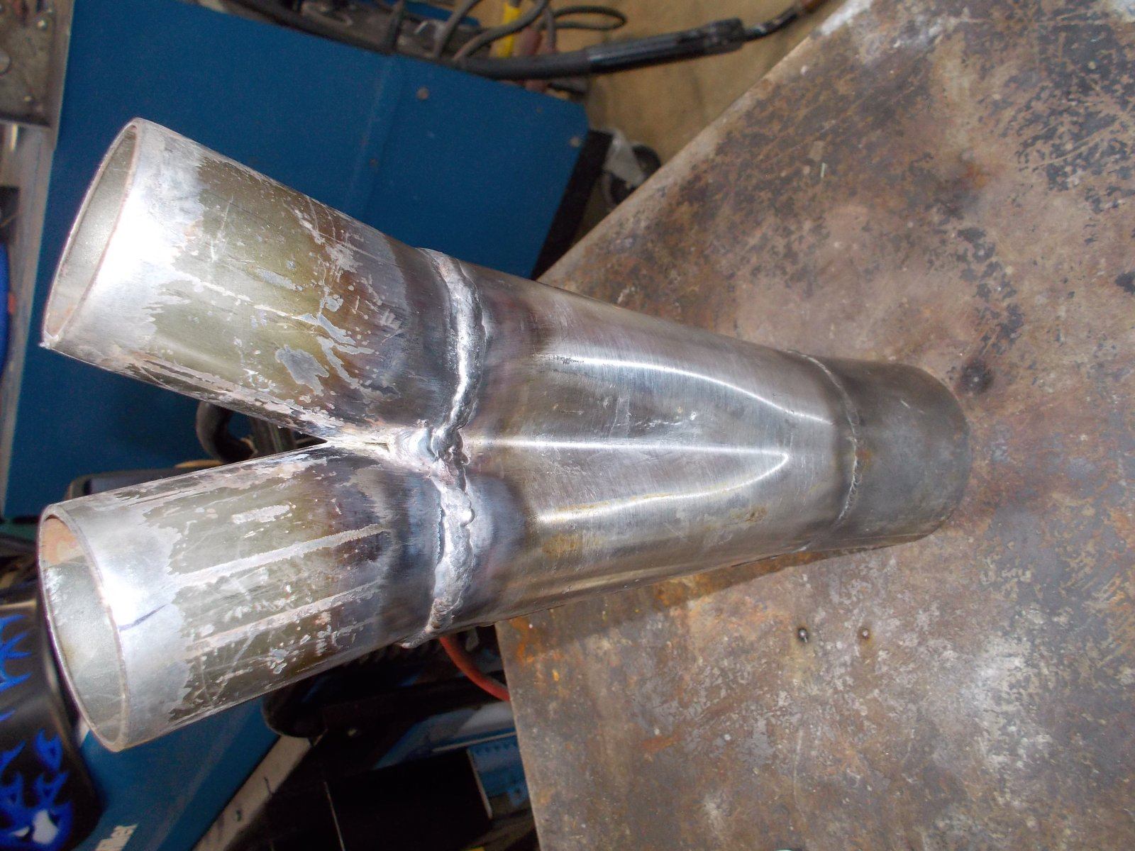

    I was feeling good enough to get back in the shop. I pieced together the collector with a piece of 2.5" OD tube. When I started welding I noticed a puddle of TIG coolant on the floor.
    Bummer.
    I'm not ready to get back down on my hands and knees to fix it so I put the collector on hold 'til the leak gets fixed.

    Thank you Pat - every day a little bit better. My welder is fixed. I completed the collector and since yesterday was Amazon Prime day I ordered a muffler for the car. It is a 2.5" in, 2.5" out, 4 " diameter round stainless steel muffler 18 inches long which is about as big as will tuck up under my frame. I want it to be pleasantly mellow and hopefully it will be adequate. If not I could add a resonator downstream.

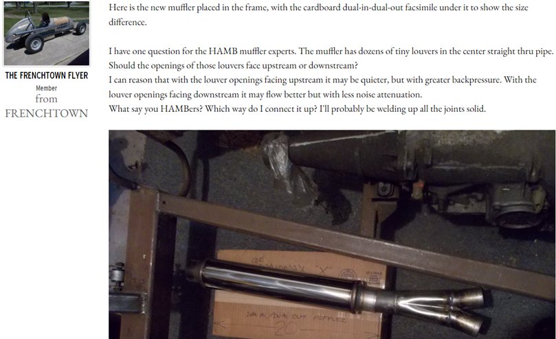

    Here is the new muffler placed in the frame, with the cardboard dual-in-dual-out facsimile under it to show the size difference.
    I have one question for the HAMB muffler experts. The muffler has dozens of tiny louvers in the center straight thru pipe. Should the openings of those louvers face upstream or downstream?
    I can reason that with the louver openings facing upstream it may be quieter, but with greater backpressure. With the louver openings facing downstream it may flow better but with less noise attenuation.
    What say you HAMBers? Which way do I connect it up? I'll probably be welding up all the joints solid.
    chryslerfan55 and Mike Lawless like this.
  10. Mike Lawless
    Joined: Sep 20, 2021
    Posts: 867
    Mike Lawless
    Faced with the same dilemma when I built the exhaust for my Harley, I pointed the louvers back, for the ***umption there would be less back pressure. As far as Harley's go, the tone is kinda mellow.
    Maybe clamp the muffler temporarily instead of welding it, so you can reverse it to see for yourself?

    Thanks Mike. I may try that. Another thing I'm considering is a header dump, for open exhaust trips down the drag strips.

    Those mini bumps are there for a purpose. If they are facing to the rear, then that is how it should be. Any restriction impedes flow in any design. No one would put louvers on the hood facing forward to catch air for the hood/motor compartment. The smooth flow of air goes over the smooth curve and possible some of it swirls into the rear openings.
    So, in essence, the smoother flow of the exhaust going back to the bumper is the way it is built and should be used. But, people do weird things in mods to their cars.
    Jnaki
    It seems a moot question, since the photo shows it already welded in place. So, which way did you put the openings, facing the front for some restrictions or backwards like it should be for smooth flow of the exhaust g***es…? YRMV

    Thanks jnaki, I agree.
    The muffler is not welded on yet - just slip fit on.

    I'd like to see back to back dyno tests with decibel meter readings. I bet we'd be surprised at how little difference in H.P. would be, and amazed at how much the sound levels changed.

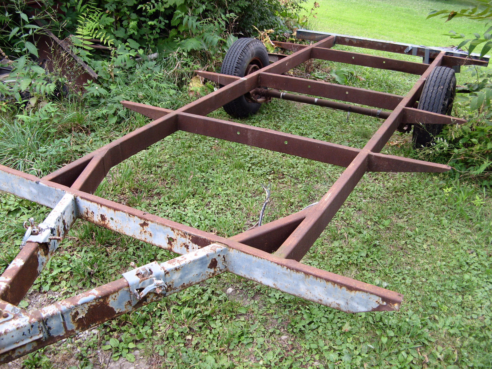

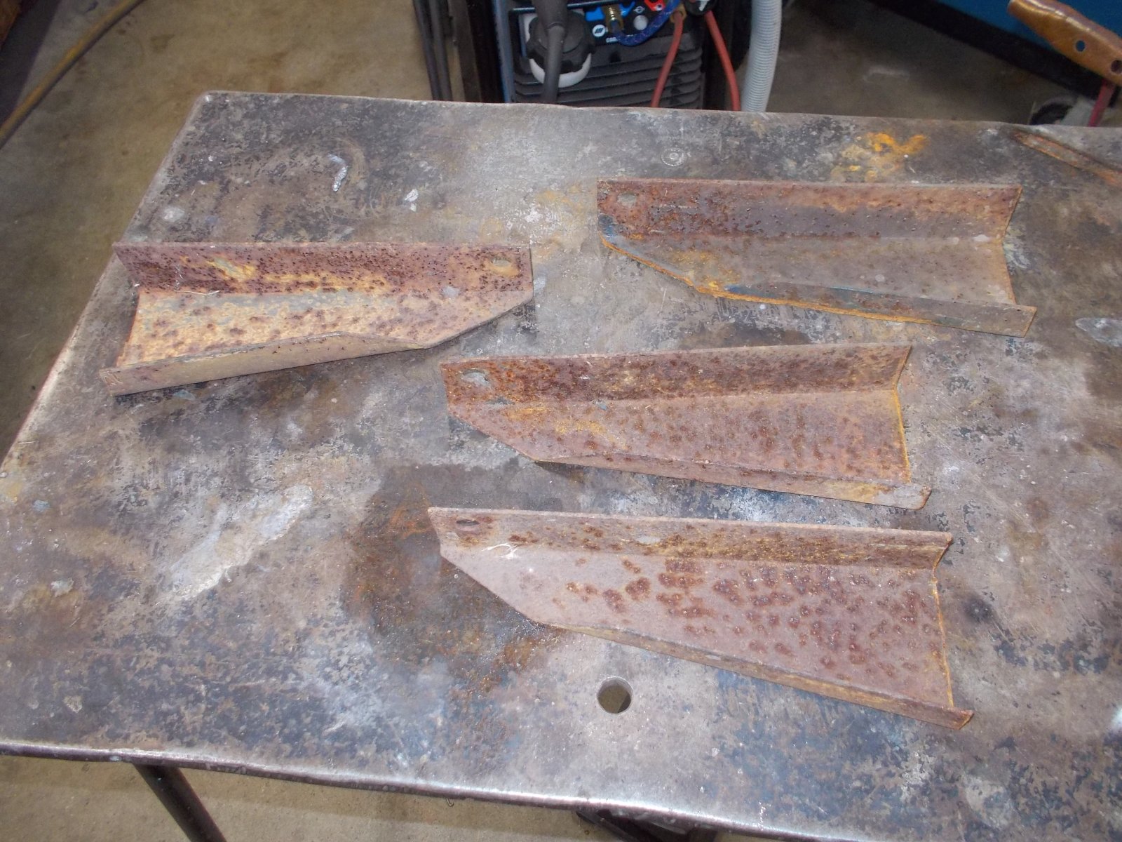

    I needed hanger brackets for the exhaust, and remembered when I built the Anglia trailer out of a derilect house trailer frame I clipped the outriggers off the frame to narrow it. It occurred to me that they would make good hanger brackets so I dredged them out of my s**** pile. I will shorten and de-rustify as many as needed, probably four, and weld them to the frame.
    I cut-and-welded a portion of the exhaust pipes from the muffler out the back over the rear end. Surprisingly little chopping was needed. But my plan for a one-piece system won't work because I'm going over the rear end and it will not be possible to remove in one piece. Work continues...

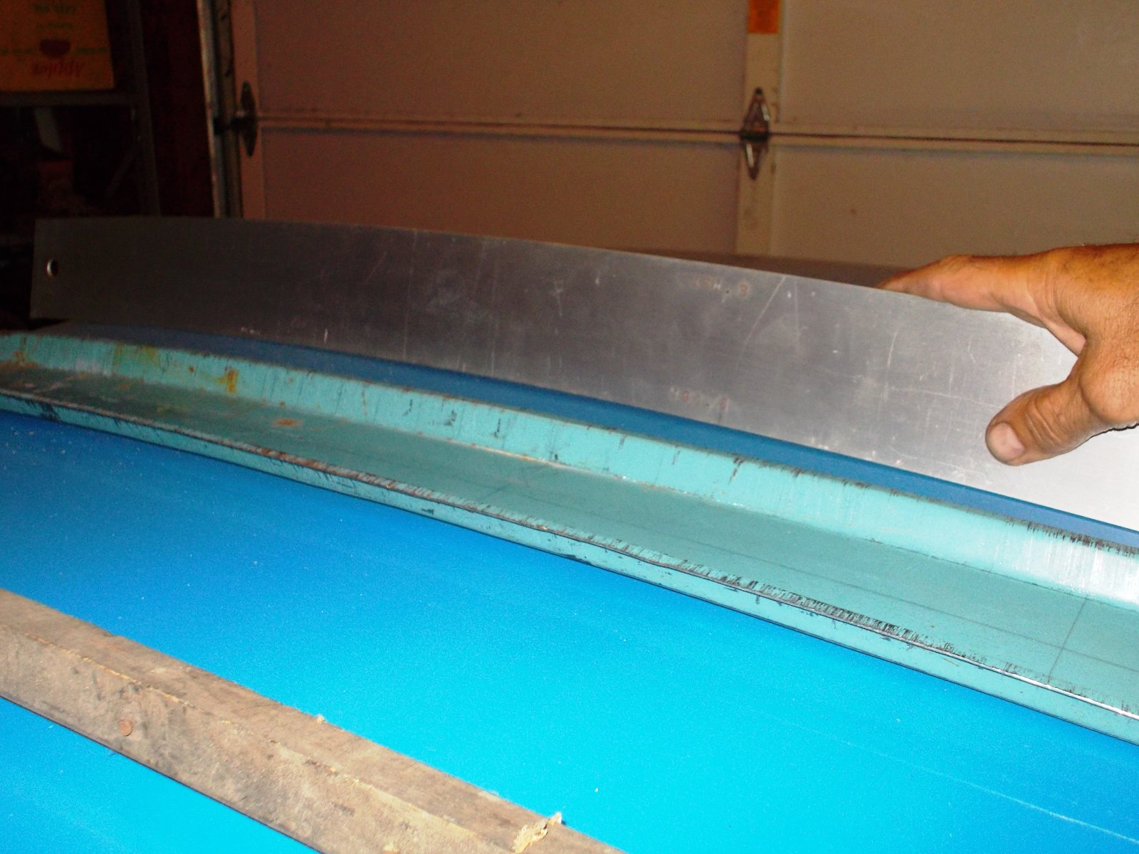

    Thanks mrquickwhip. Full disclosure, I made a roof panel from flat stock and rolled a crown in it with the English wheel. But I got carried away and put too much crown in it. That is why I have not posted pics of it. Now I have to decide if I want to try to shrink some of the crown out - or start over. Two steps forward, one step back...

    I think I'll work on my first attempt to get the crown right. I made a steel roof bow to help.

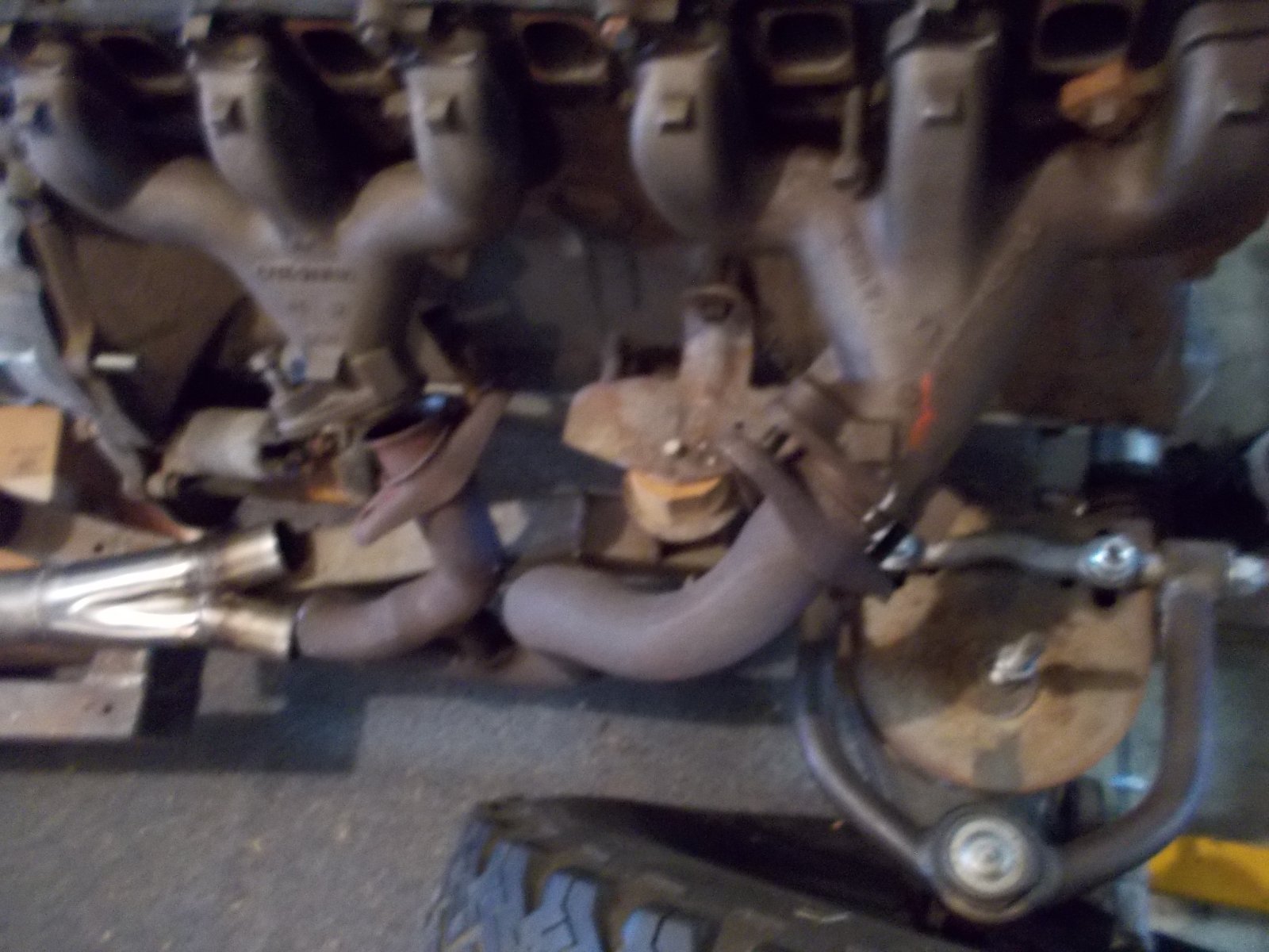

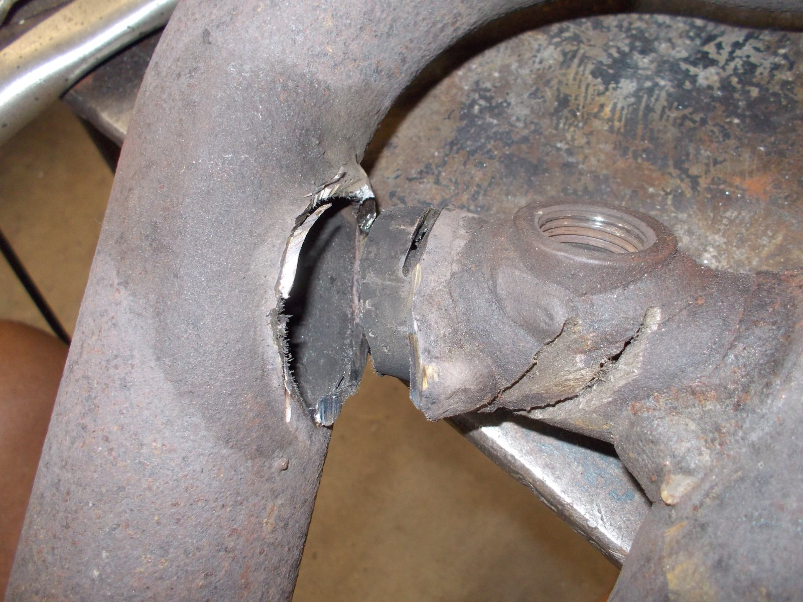

    More fab work was done on the exhaust. If I installed as produced, the over/under design of the primary outlets interferes with the torque box of the frame. It has to move. So I cut the two tubes apart by removing the EGO sensor connection, which was a restriction anyway. Then I choped up the rear pipe so it would lay next to the front one. I made a couple of pipe spacer templates to align the primary pipes with the inlet into the muffler.
