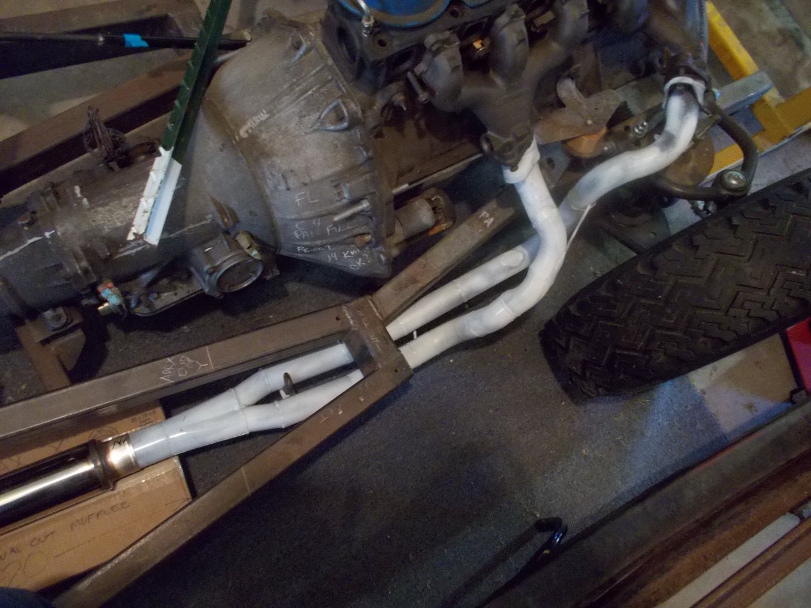

    Gradually, I have inched my way down to the collector from the engine. After adding in the second primary connection to the collector I will be welding in flanges to both sides of the muffler so that the system can be installed/removed in three major chunks - the primaries, the muffler, and the tail pipe. A fourth piece - a header dump, can then be inserted in lieu of the muffler to enable running with open exhaust on the track.
    One major piece of the puzzle is missing. Can you figure out what it is? That's right - THE CAR!
    Because of space limitations the Attic Anglia is stored at a storage building off site. That has meant I have had to mark each piece of pipe on the ch***is, bring it home to tack weld on, return the pipes back to the storage building for final fit, return back home to finish weld it, go back to the storage building for an additional fit-up to insure nothing moved from warping, and then proceed downstream to the next segment. Tedious. I do not recommend this method as an efficient use of time.

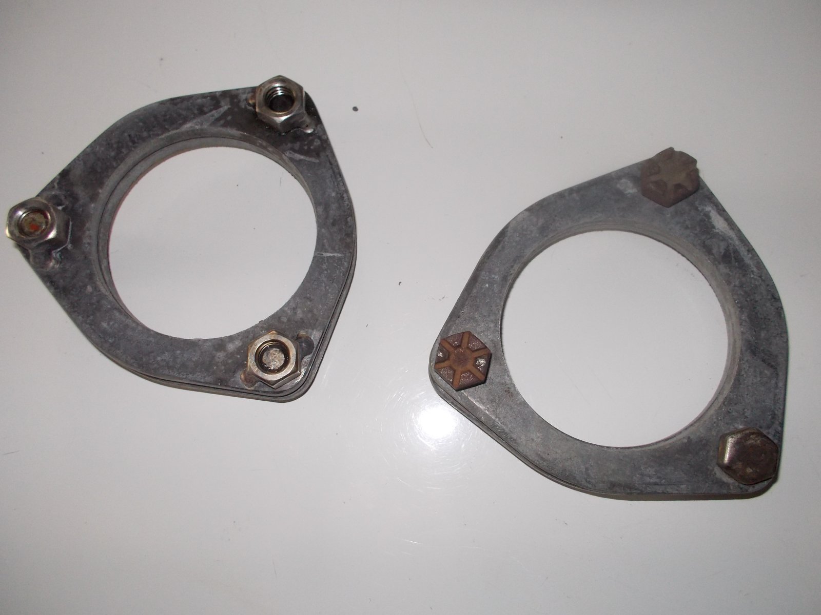

    The basic pipe shapes are finish welded and test fit on the ch***is. Also, I received a couple sets of 3-bolt exhaust flanges - one for attaching each end of the muffler - and an additional set of 2-bolt flanges to attach the rear stinger to the pipe running over the rear axle. But to make the exhaust system easy to ***emble / dis-***emble I welded nuts to the flanges so that two hands and two wrenches are not needed for ***embly. I'll probably make up some piloted bolts for further ease of ***embly.

    You know, I have always tried to weld the nuts on the flats. Makes much more sense to hit the points.
    Just a dumb thing that I really never thought about until I saw your pic. Head Slap!!!!

    My theory on that is if I weld on the corners there wll be less likelyhood of the threads distorting. Another thing I do is wrap tape around the bolts to insure that the threads are centered in the holes. Welding on the nuts will often "pull" the nut and bolt ***embly up against the flange, making bolt removal difficult. Taping up the bolt to center it up in its hole will minimize that problem.
    Also, I am not a fan of excessive clearance in bolt holes. I often drill the holes close to the bolt diameter and open them up only after all the fit-up and welding is complete. Call me OCD.
