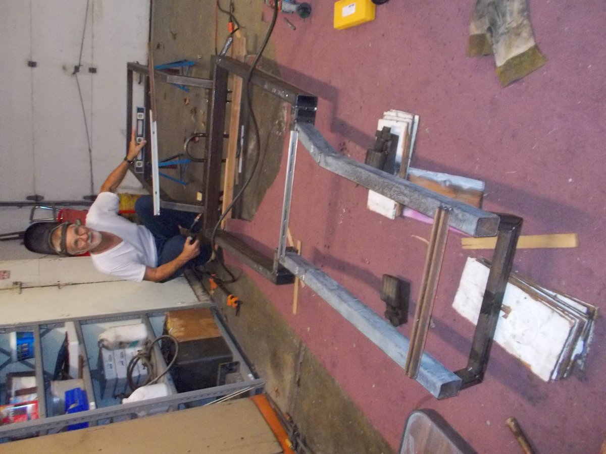

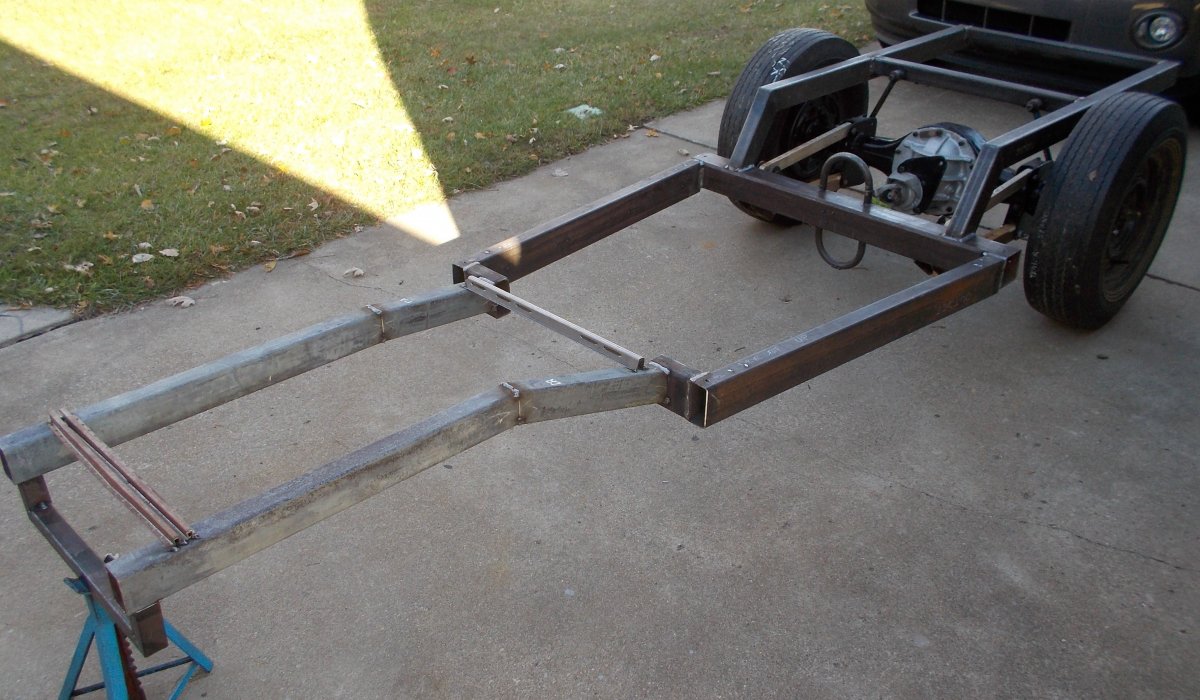

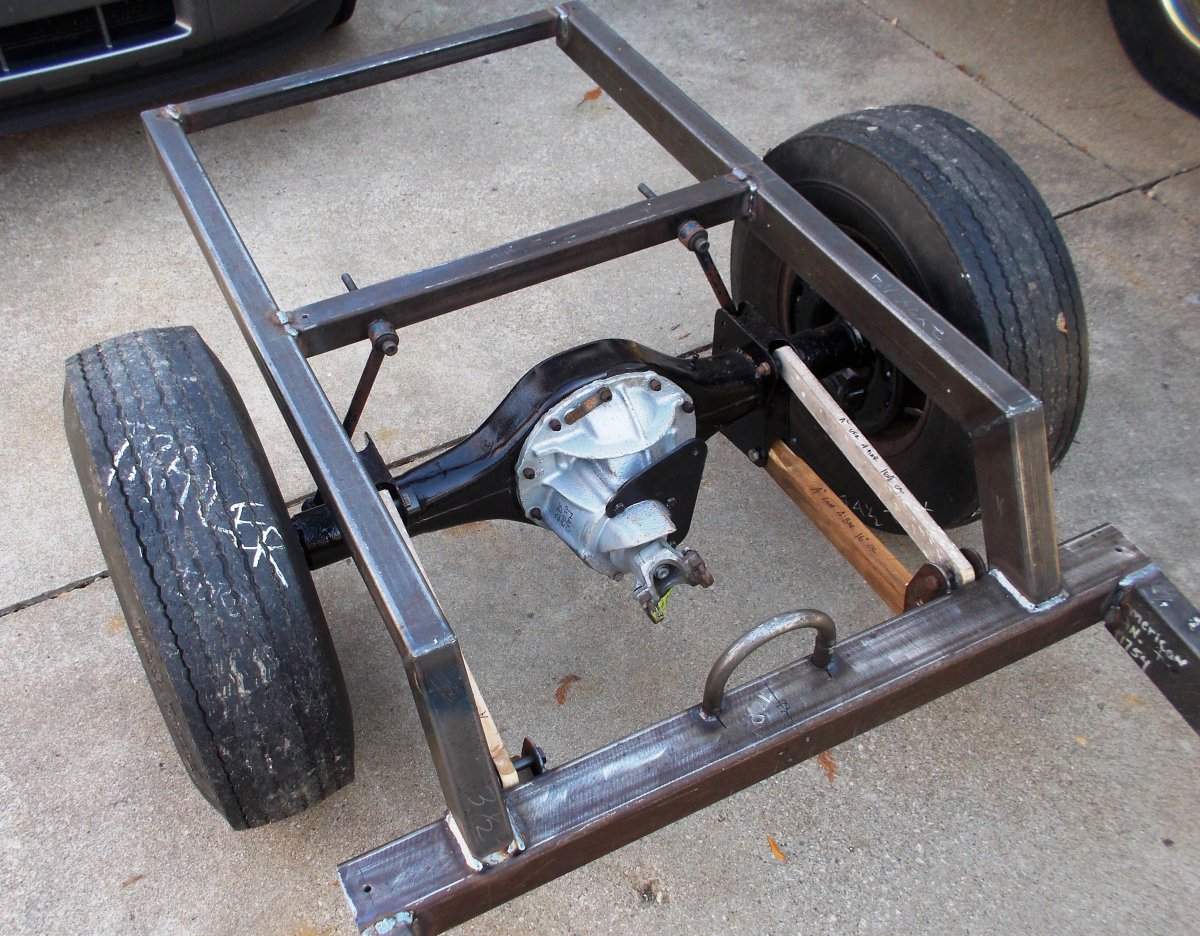

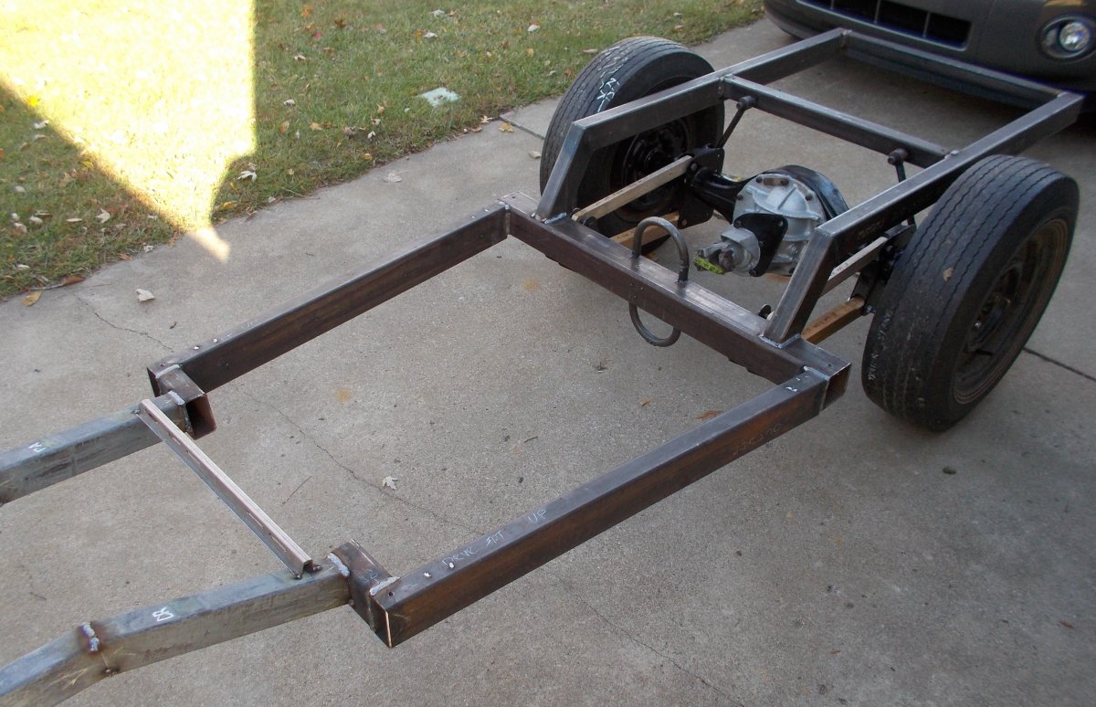

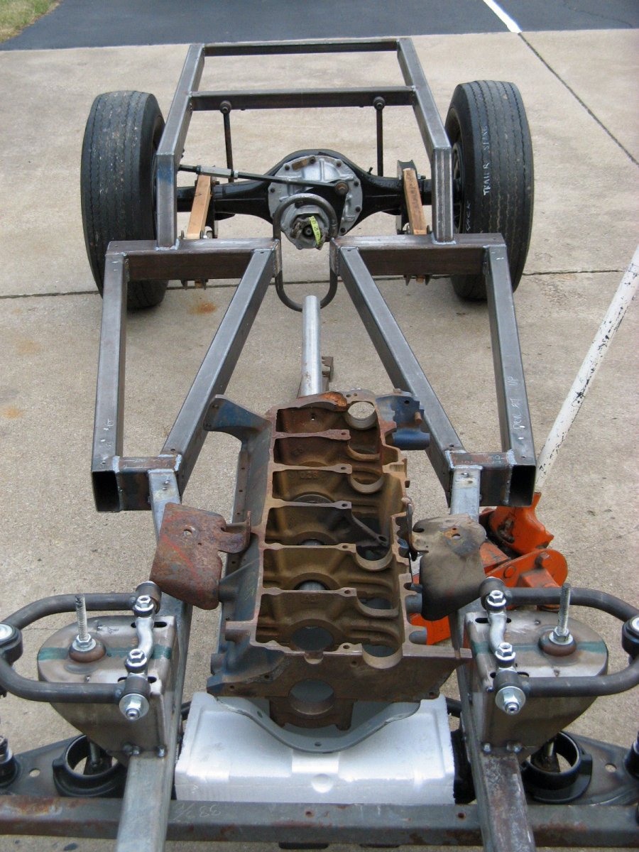

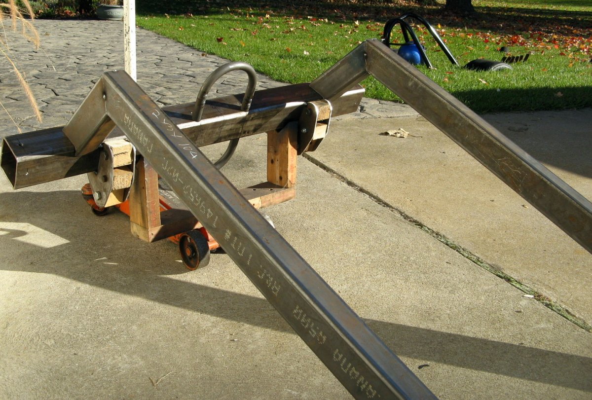

    frame buildup 02.jpg I started with the rear section of the frame, since the rear axle is complete and the front IFS is still TBD.
    The area in the middle of the driveshaft loop will eventually be cut away - after everything else is welded together.

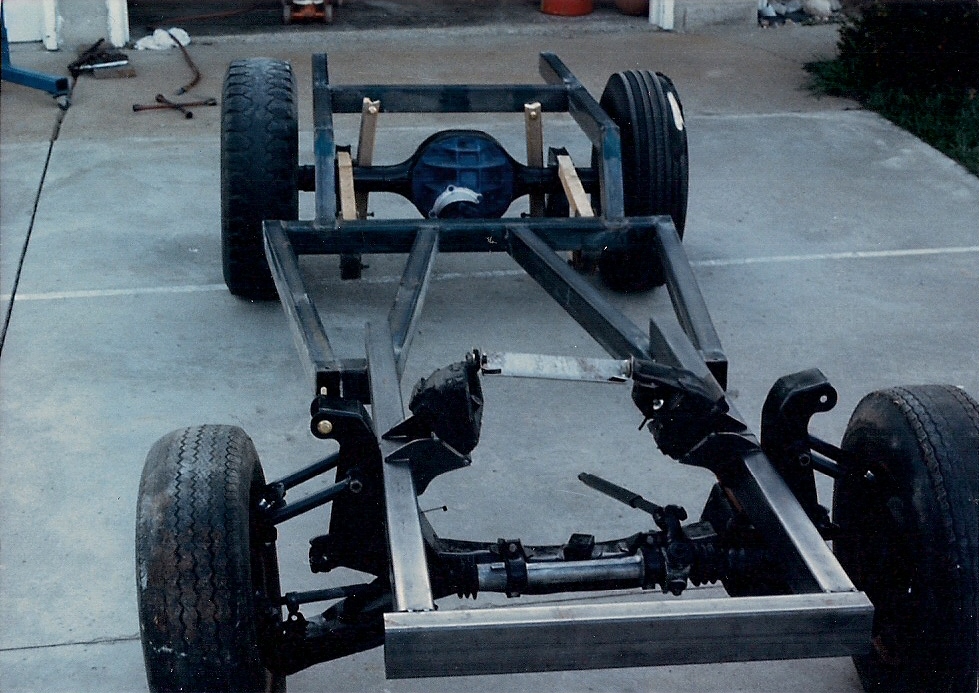

    Woo Hoo! Today I ordered a front suspension from Fatmans by way of Yogi's. It will have a manual rack, Granada 5 x 4 1/2 rotors, Chevelle calipers, Mopar ball joints, coil springs and tube shocks (Fatman Stage II). So I will continue fabrication of the frame under the p***enger compartment until t arrives.
    I also found a new home for the original Chev 4.11 rear end, being replaced by a narrowed Ford 9 incher.

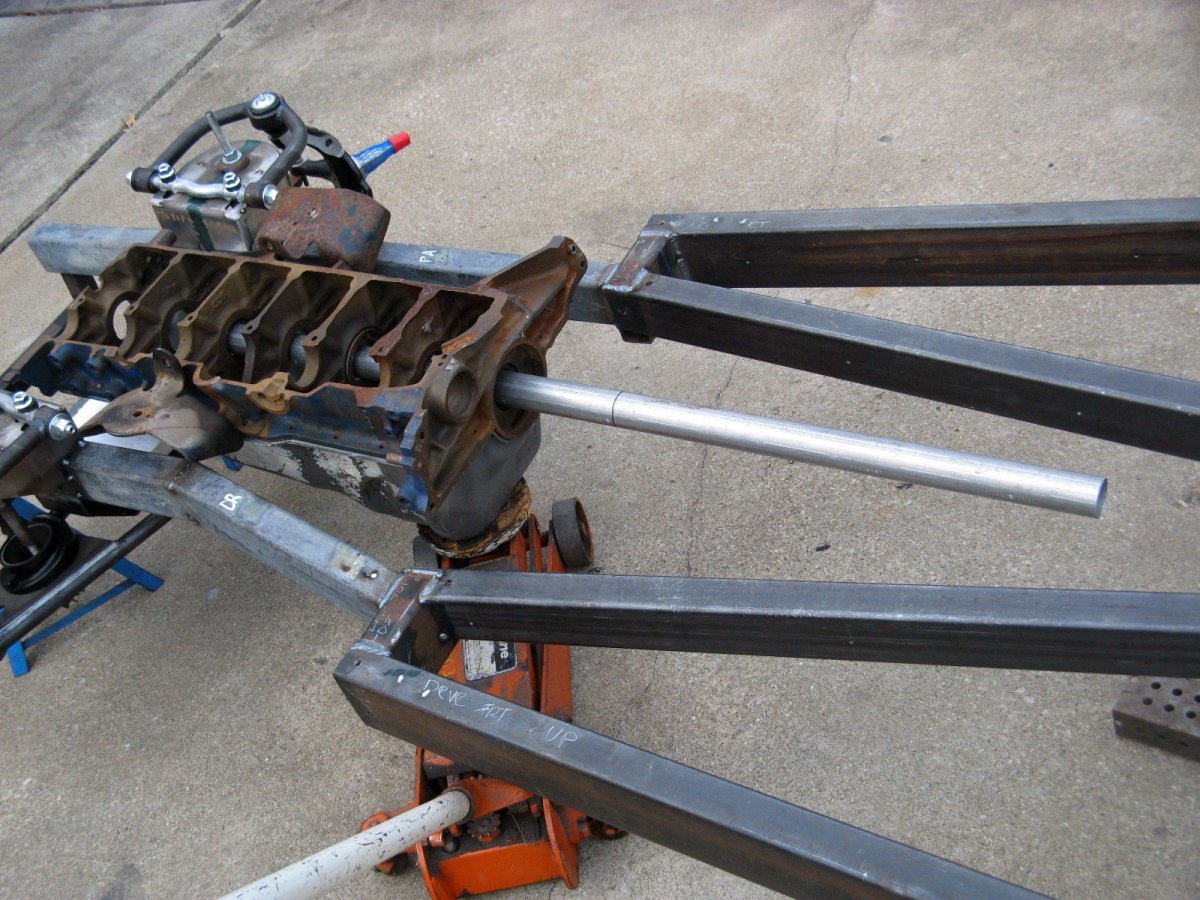

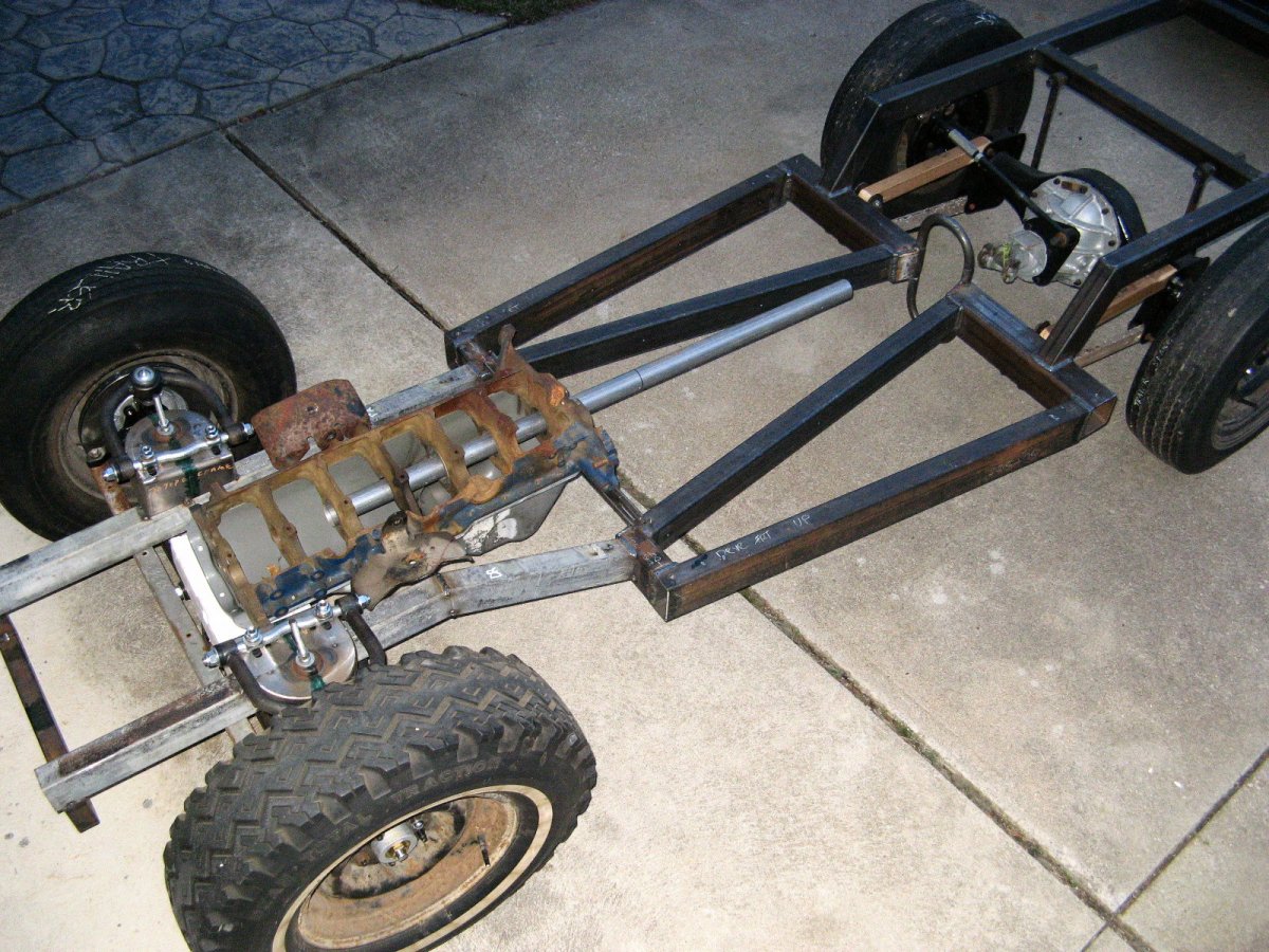

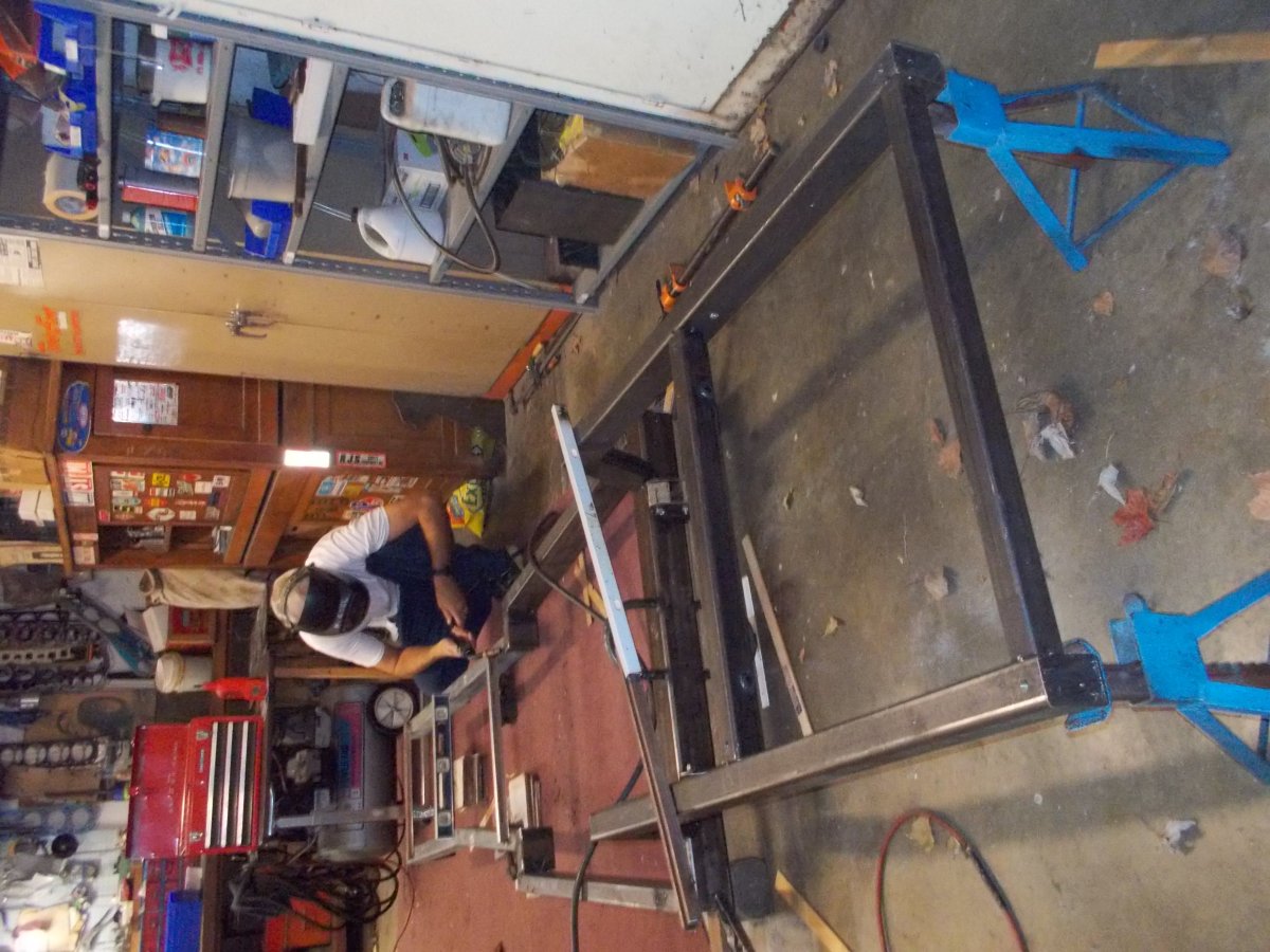

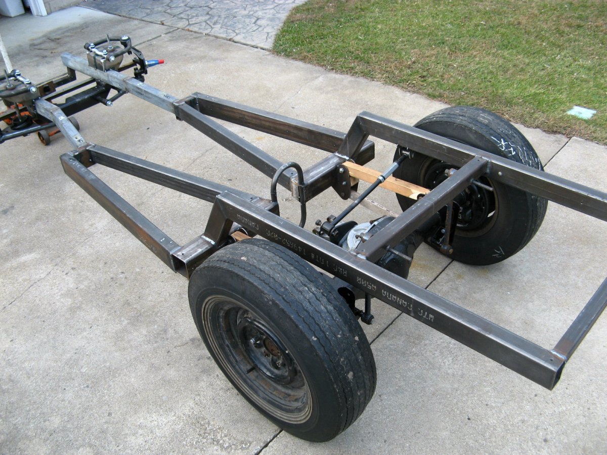

    Yesterday my mates and I set up the individual ch***is components on my garage floor and tack welded everything down. Today I did much of the finish welding and mounted the narrow 9"er under it.
    DSCN1669.JPG DSCN1670.JPG frame buildup 03.jpg frame buildup 04.jpg frame buildup 05.jpg

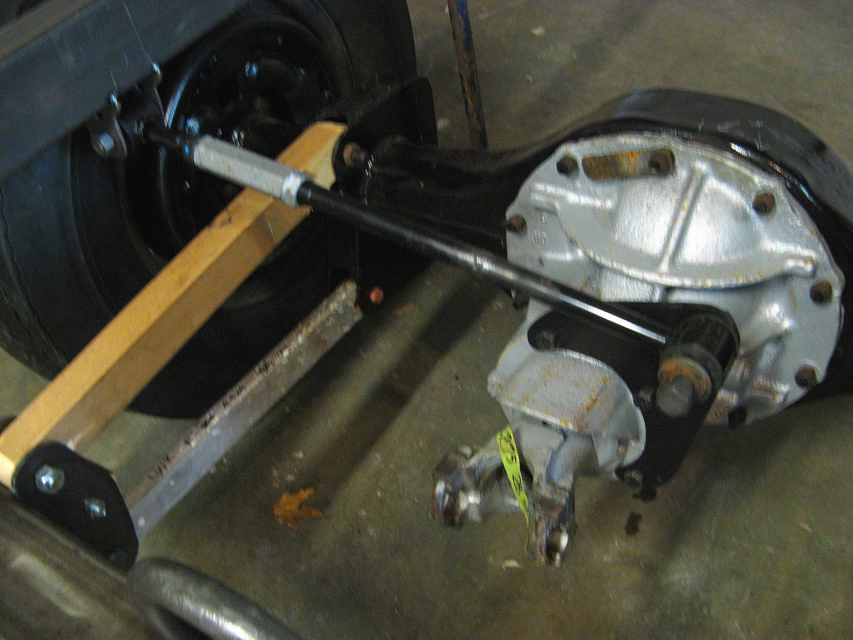

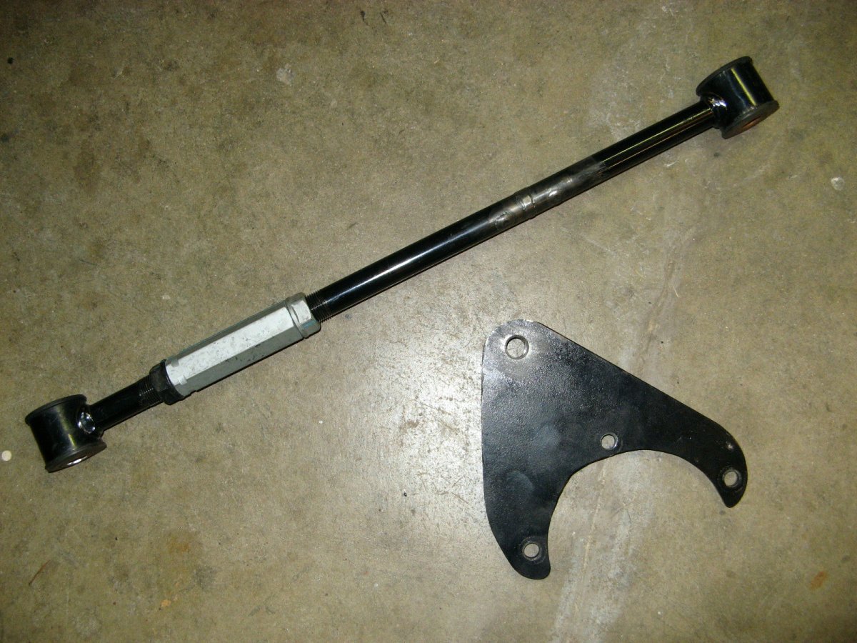

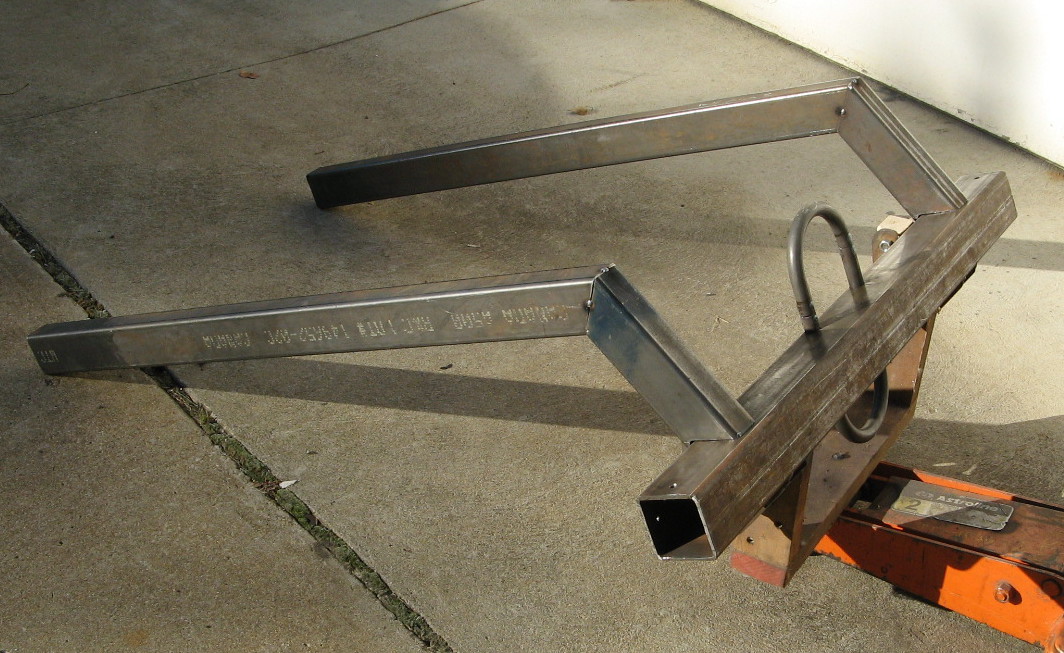

    To locate the rear axle I used a conventional Panhard bar design. This particular part is a swap meet find. It was originally about two feet long. I liked the built-in turnbuckle for lateral adjustment. To shorten it to the proper length I cut it and insert a 1/2 inch rod plug, then rosette welded and finish welded it. The pinion mount is offset to give the longest possible length to minimize unwanted lateral movement.
    The bar had a part number 22204689. Mopar maybe?

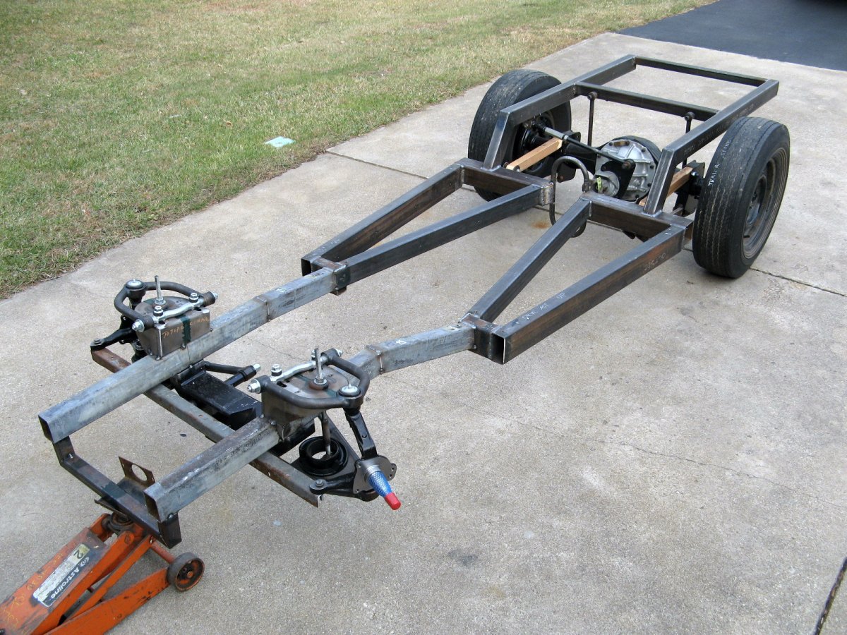

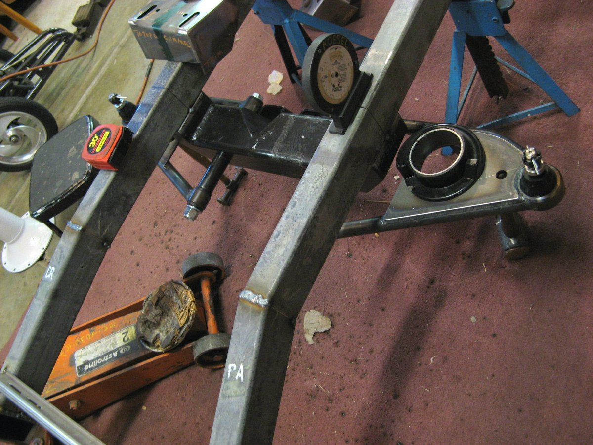

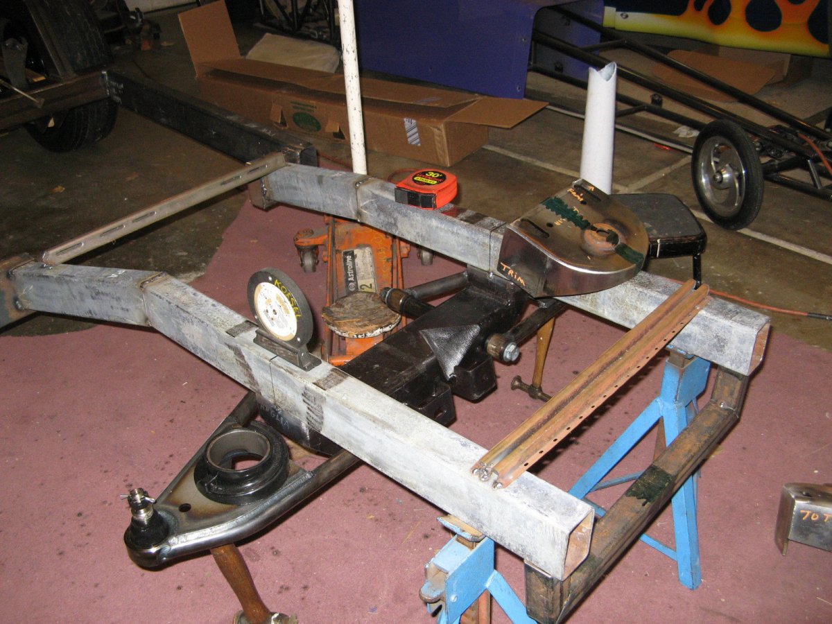

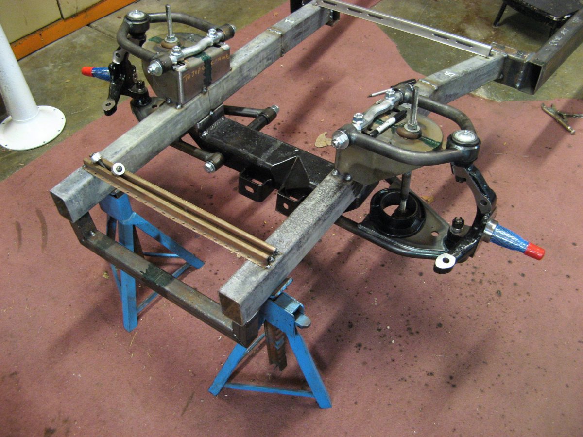

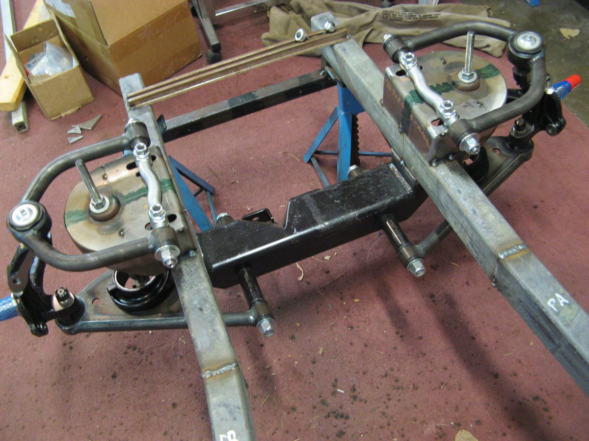

    frame buildup 08.jpg frame buildup 09.jpg I started the Fatmans IFS installation.

    Well on that we can agree to disagree. I must say they provide complete instructions that are easy to follow even for a first-timer car builder (which I'm not). I just got off the phone with their rep as I had a couple of questions on minor details and he seemed knowledgeable and not impatient to dispatch me. As far as canting their springs "sideways" their instructions say the lower control arm should be level +/- 1 inch, and their upper spring towers very nearly center the spring vertically. I think they would have canted it outward if they felt it was needed, as it wouldn't have cost them anything to make that change. I think they pretty much have correct geometry with Antidive, Ackerman, proper Camber Curve and no Bumpsteer. Time will tell.
    Here is a Google photo of the Phase II system I am using:
    Another thing that I liked: when I ordered the kit I told them to include a front sway (anti-roll) bar kit. They told me one would not be needed for my application - only one was needed at the rear of the car. Well, he could have sold me an unnecessary kit and increased his profit and I'd have been none the wiser.
    Another another thing I liked - the plans listed part numbers for all the consumable replacement parts, what model years they fit, and alternative part numbers if available.
    If I have one teensy-weensy complaint it is that some parts arrived painted, necessitating the need to remove the paint before welding. And you know the quality of most pre-painted parts is just barely adequate to keep things from rusting in the warehouse shelves, which I suspect is usually why these things get paint at all. It just means all their paint will need to be stripped before real paint can be applied.
    I don't plan to ever drive this thing over 130 or so, so it should be up to the task. The parts certainly seem beefy enough.

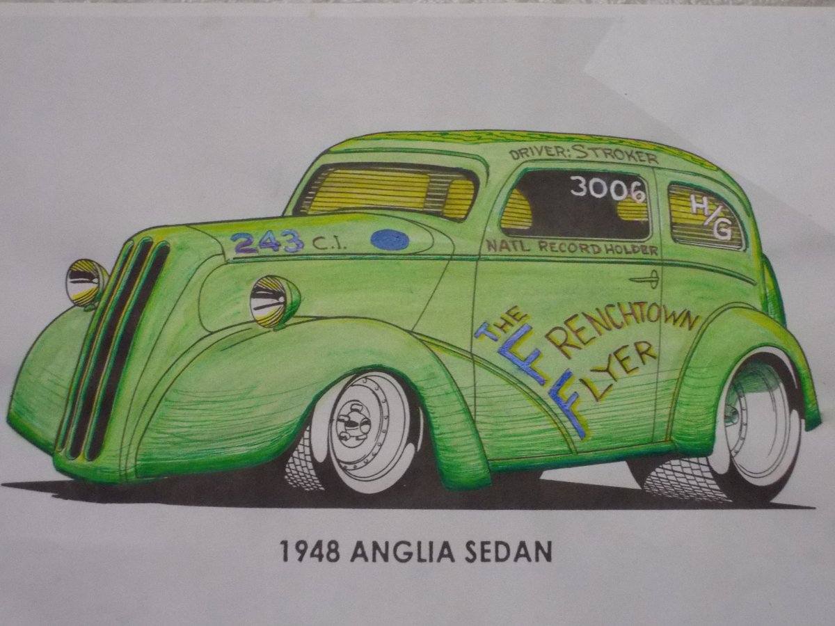

    I found this in my coloring book:
    I've never built a car and painted it green. Maybe its time.

    frame buildup 10.jpg frame buildup 11.jpg frame buildup 10.jpg I installed the upper spring / shock towers and upper A-arms. Essentially all of the hard work is done. Just need to tack in the tower gussets and then add a few more welds before removing the temporary frame braces. Then rough in the placement of the block / oil pan before putting this project to bed for a while.
