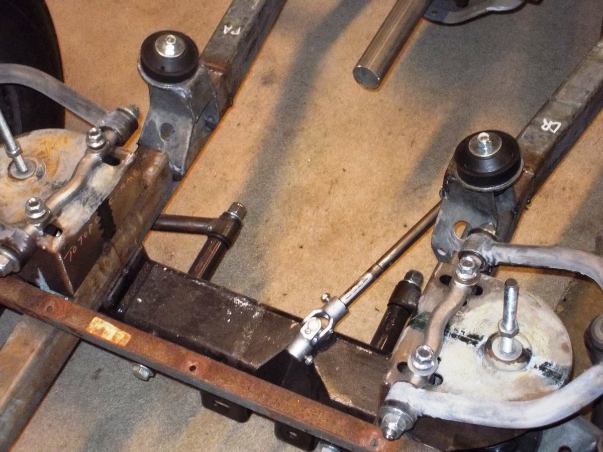

    frame buildup 19.jpg Added front hubs and tires. Now I can roll it around.

    This is a very nice build. Clean and well executed, but also good planned, I like the drawing.
    I'm not a
    big fan of M2 front ends or IFS at all, but I respect the craftmanship going in to one.

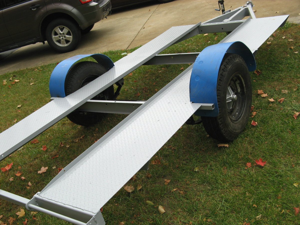

    build 6 to make it go and set it a part from the crowed.

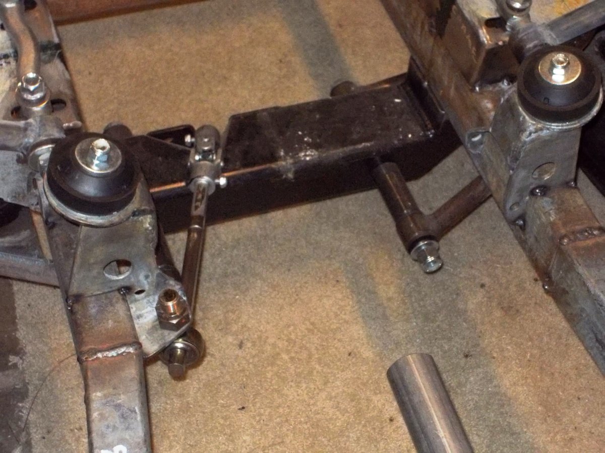

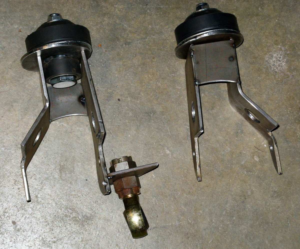

    motor mounts 01.jpg I made set of motor mounts. They use universal Speedway biscuits. The biscuit is angled by 15 degrees such that a line drawn through the mounting plate intersects the crankshaft centerline. I'll file that away for future builds. Also, I like to combine features into one component so I integrated the steering jackshaft carrier bearing mount into the motor mount. The small holes are for wires to p*** through if necessary. I used 3/16 plate - 1/8 would have been sufficient.
    BradinNC, catdad49 and els like this.

    That's interesting! I did very similar thing on my Austin, except used side motor mounts. Even added a mounting plate for a heim joint, to also support my steering shaft.
    els likes this.

    In addition to canting the biscuits 15 degrees inward I tilted the mounting pad 4 degrees rearward to get a proper engine installation angle.

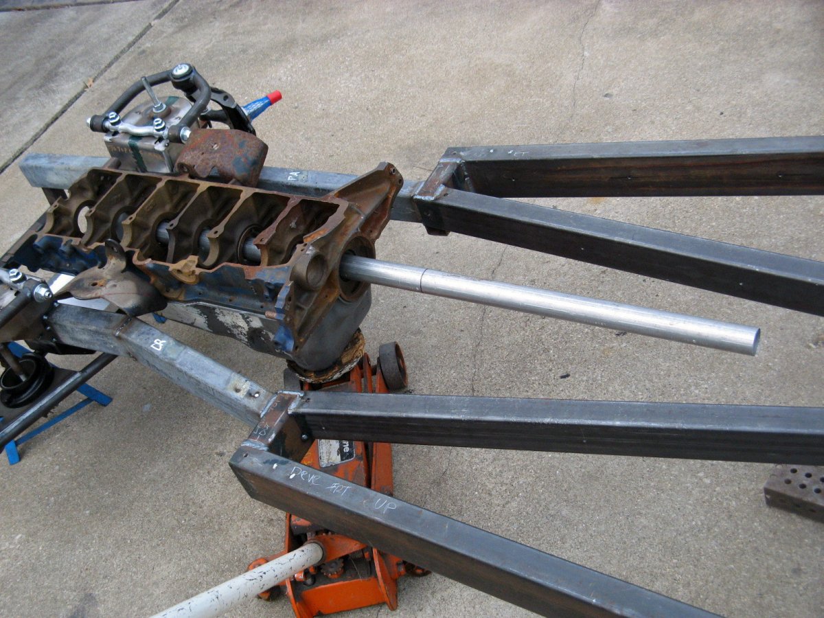

    motor mounts 03.jpg motor mounts 02.jpg The motor mounts are in the ch***is. Between the compound angles of the mounting surfaces and the ***ymetry of the block I wish I had paid more attention in Geometry Cl***.
    Just kidding - I could have taught it.
    The next step will be to make a trans crossmember using a bare block and the C4

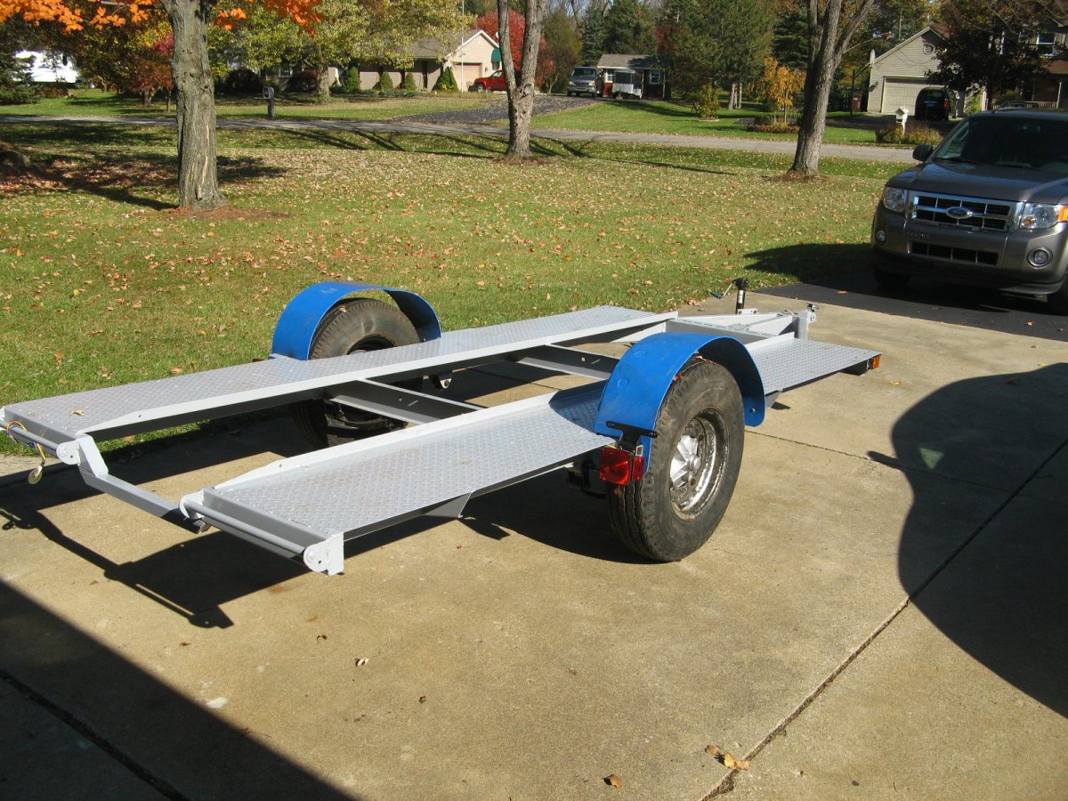

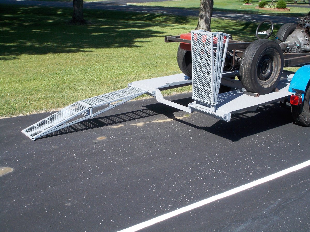

    trailer 01.jpg I took another slight detour - to build a trailer for the Attic Anglia. I had started to gather parts together to build a trailer to transport it from my storage site to my home. I have the same problem with my Speedracer project. I want to switch these cars around. Plus, the champ car will need a trailer to haul it to the track. Last week I found a house trailer frame for sale nearby and bought it. In the succeeding week I chopped three feet off the back, moved the axle forward, fixed a faulty hitch, mitered in a skid plate to the tongue, added a third draw bar member to the tongue, boxed the front crossmember, added fenders, added three tie-down sites, and narrowed it down so the Anglia and Speedracer will just fit.
    as purchased: trailer 01.jpg
    current mods:
    I added a jack and winch.
    The rear crossmember will get a drop-center to facilitate loading and unloading. Ramps are on order.

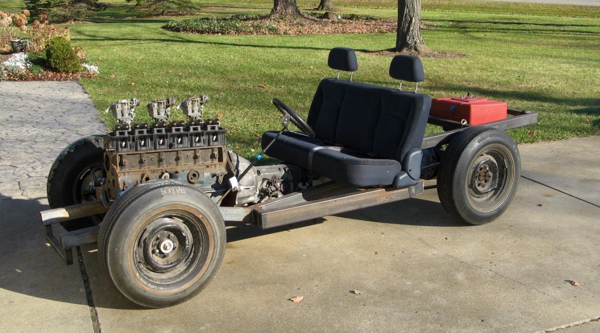

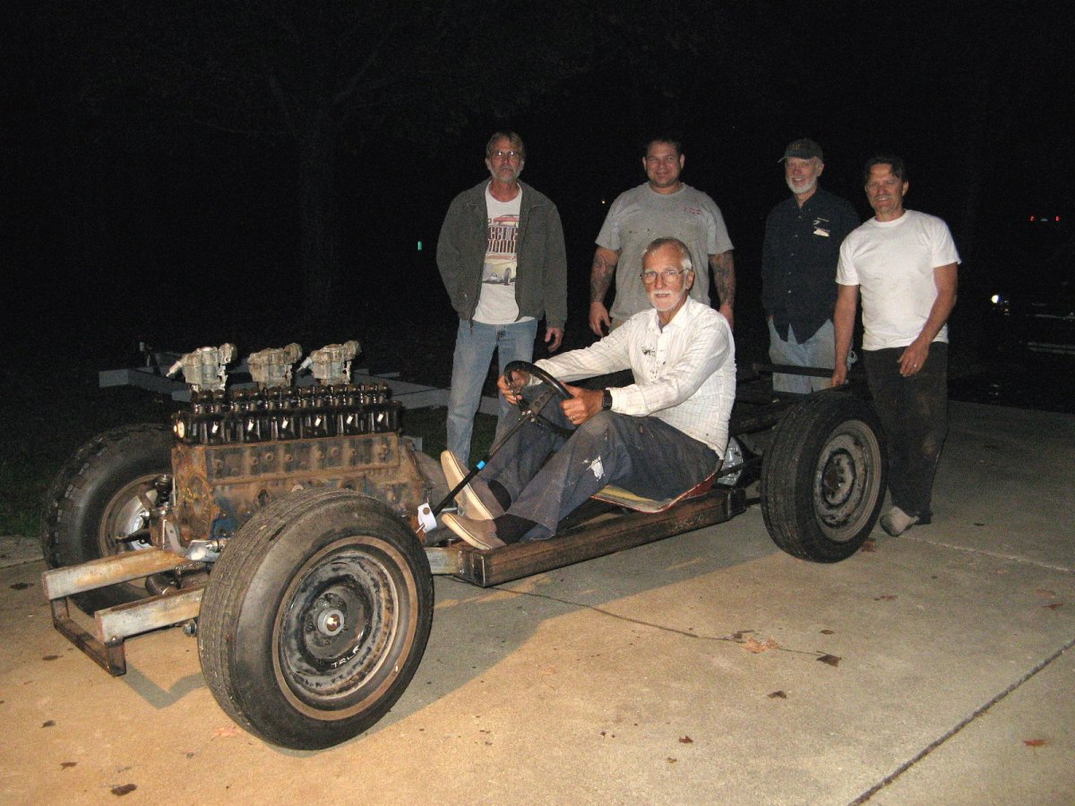

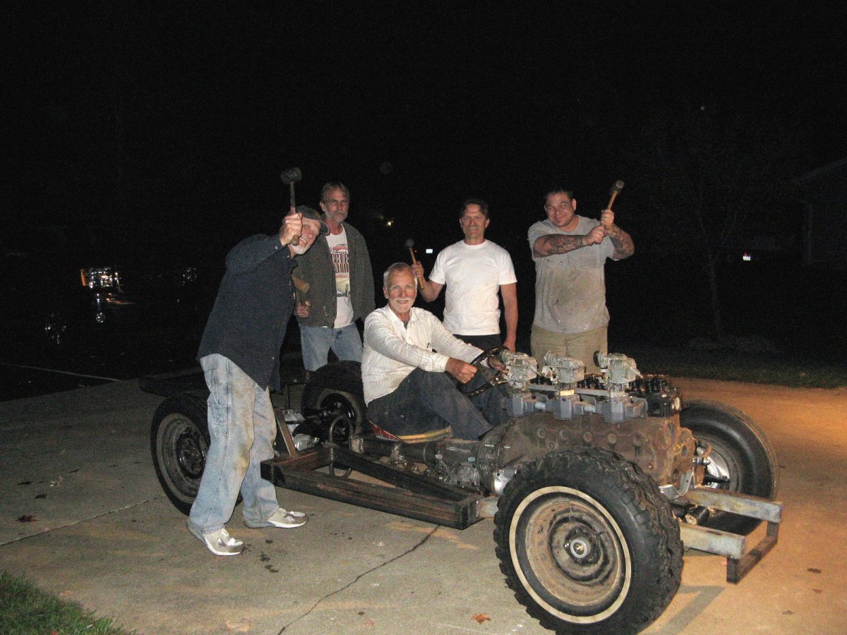

    Tonight some of my Loose Screws hoodlum buds decked the engine and installed the trans xmbr. Then I bolted up a head and a home made tripower for kicks pics.

    The Anglia hauler nearing completion:

  23. Baron
    Joined: Aug 13, 2004
    Posts: 3,677
    Baron
    Nice job. And nice to have a trailer small enough to transport the car without taking up a ton of space when not in use. How long are the ramps and distance between the fenders ?
    els likes this.
  24. THE FRENCHTOWN FLYER
    Joined: Jun 6, 2007
    Posts: 6,164
    from FRENCHTOWN
    Thanks.
    The ramps are 12 feet long.
    Inside-to-inside of the fenders is 59 ".
    Inside-to-inside of ramps is 29".
    Outside-to-outside of ramps is 69".
    I had to make the fenders easily removable because the Speedracer champ car does not clear them when loading.
    I still need to find some loading ramps that will pivot and slide at the rear of the trailer. Also. I mounted the electric winch after pics were taken.

    Somebody clued me in that the third seat from a Dodge minivan will work in an Anglia so I went to the local junk yard and found a clean one. Measuring off SD's car it will just clear the door inner panels. The back folds down to allow access to the "back seat".
    Also, a drag racing buddy donated an 8 gallon fuel cell. 150 miles per tankfull will be enough I'm thinking.

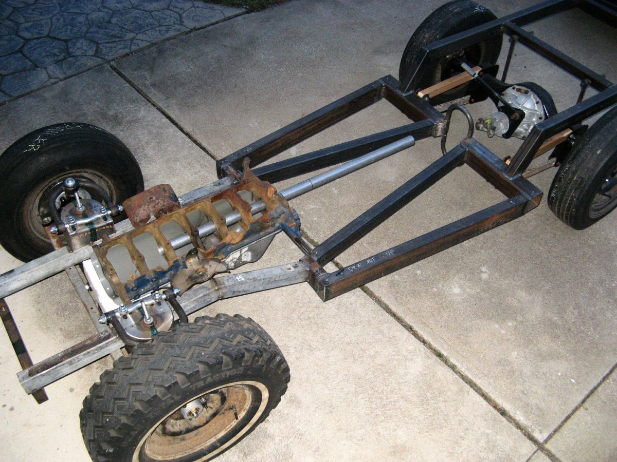

    Everyone I talked to before building my SDRA frame told me I absolutely HAD to have a full 24" inside the frame rails for starter clearance. Hope you don't get burned by your x-member!

    I did not know Pete / Jake built a project Anglia. You say it didn't end well - what were the problems? Maybe I can avoid repeating them.
    I almost got myself into trouble by having the frame rails zee'd and pinched. It is widest at the bellhousing area at 20.5" inside width and it tapers up to 16" on the side of the block. A Ford mini starter clears with 1/2 inch to spare. The frame had to be narrow to accommodate the A-arms and narrowed rack of the IFS.
    I would imagine that trying to package a large V8 in there might present a challenge and that may be why "everybody... absolutely... recommends... 24" inside the frame rails."
    I finished the champ car / Anglia trailer.
    The winch is housed in an electrical breaker box.
