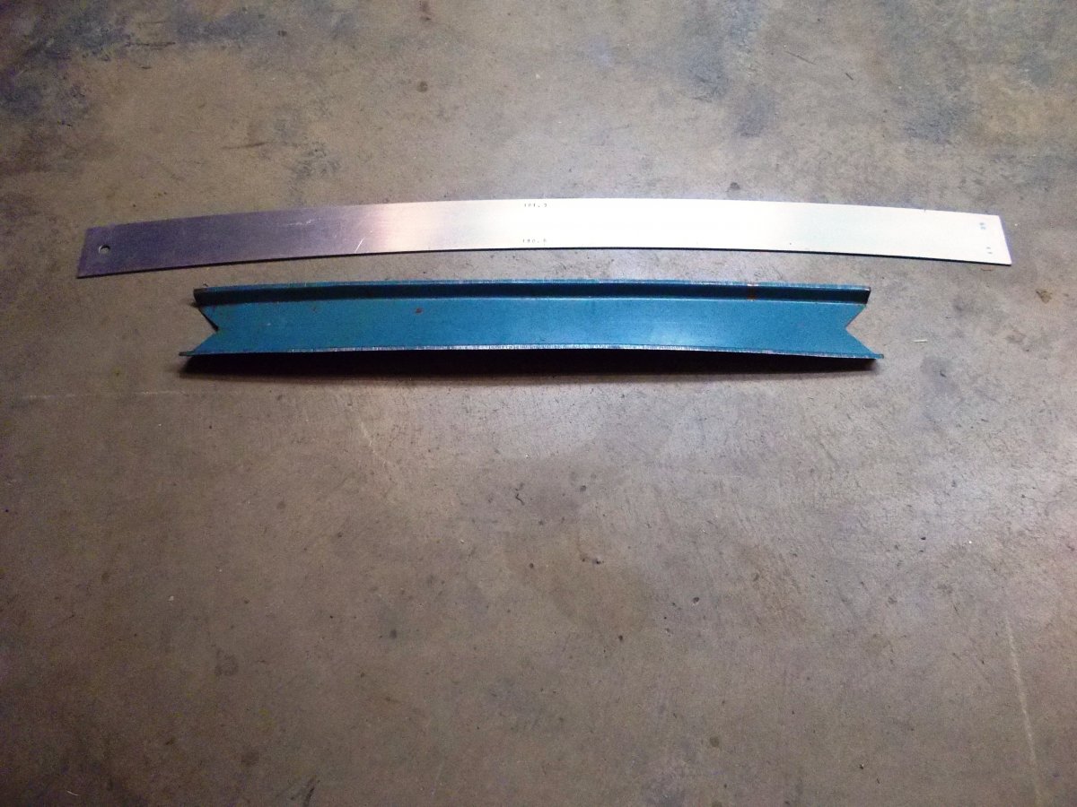

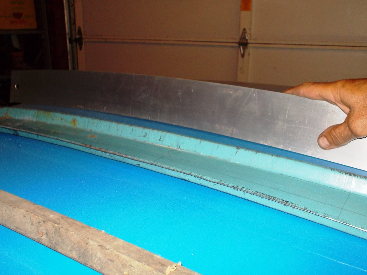

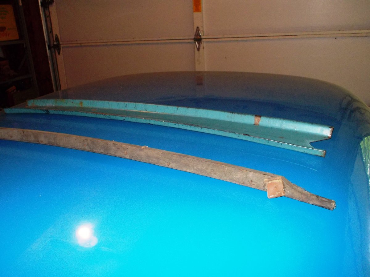

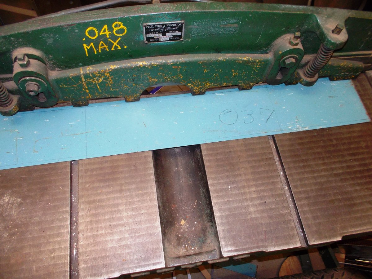

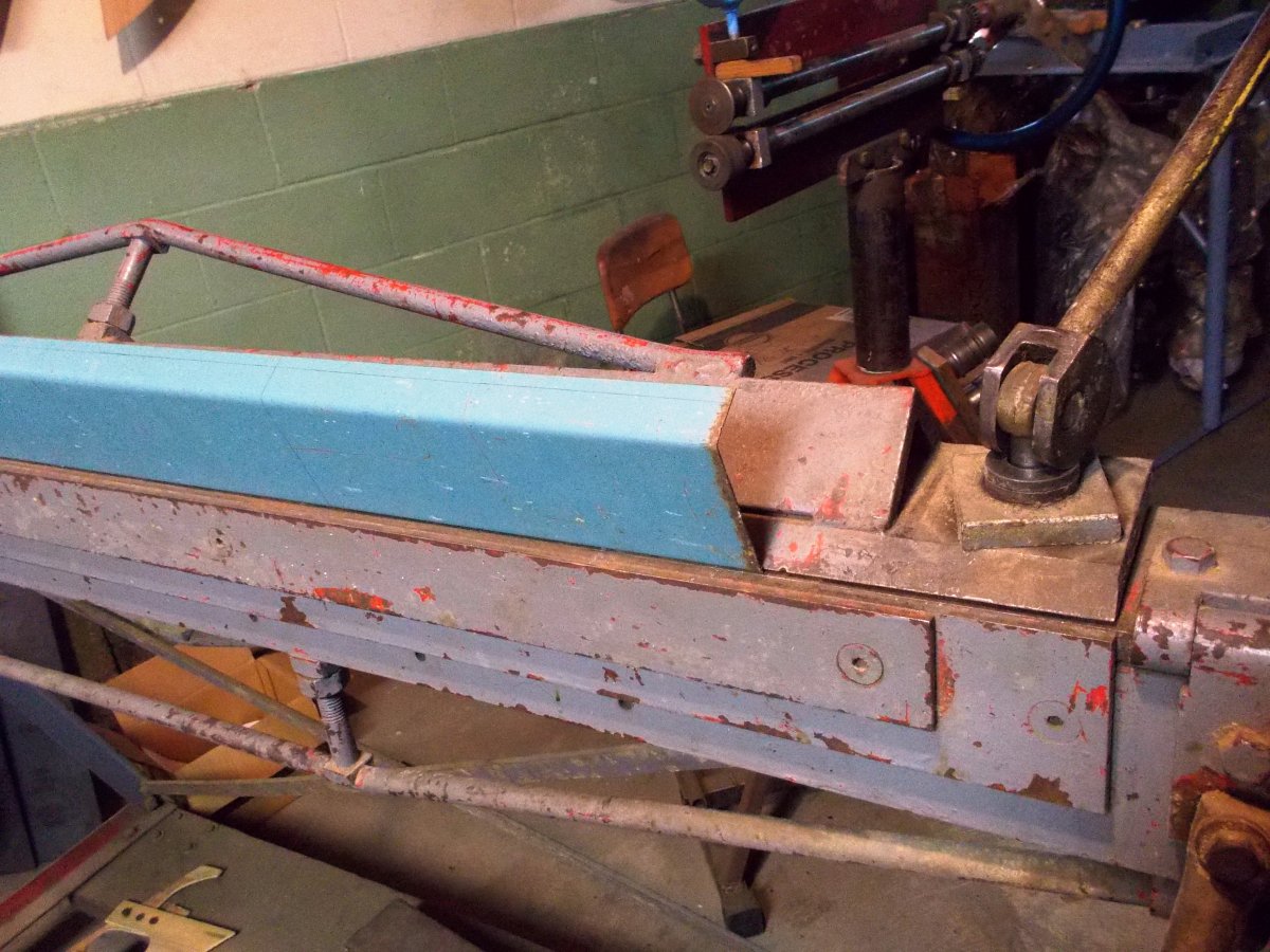

    sweeps 01.jpg I had a few hours to spend on this job so I decided to make a roof bow to replace the spindly wooden roof bow used to support the original fabric top insert. I used my son SuperDave's Anglia as a pattern to establish its shape. I will be using a set of sweeps that will help establish and maintain the desired roof arch. - one for the longitudinal arch and one for the transverse.
    I started by shearing a blank and rolling a curve in it to give it a little "memory" of the shape I want. Then bent two one inch flanges on it. roof bow 1.jpg roof bow 2.jpg roof bow 3.jpg
    TFoch and els like this.

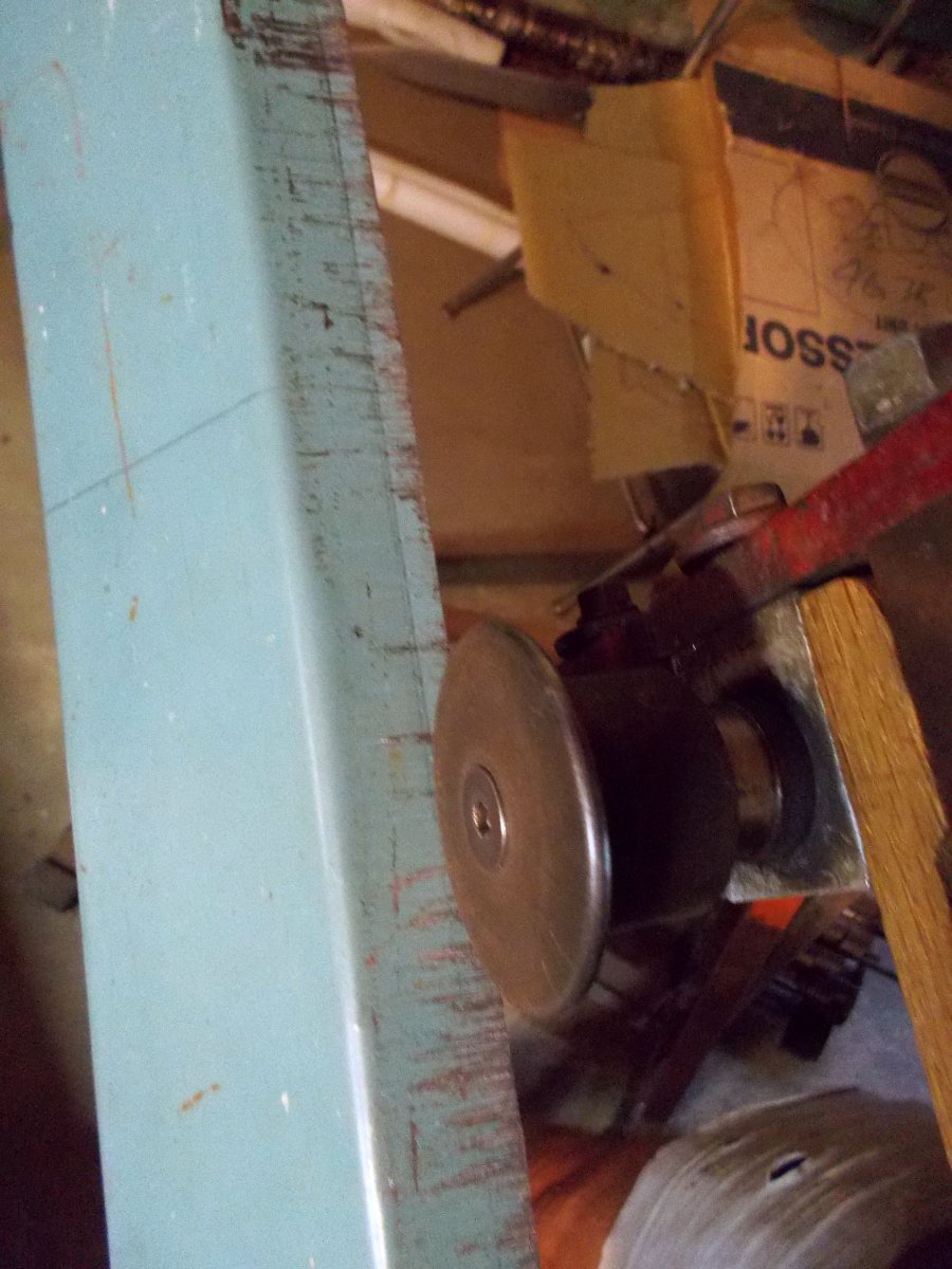

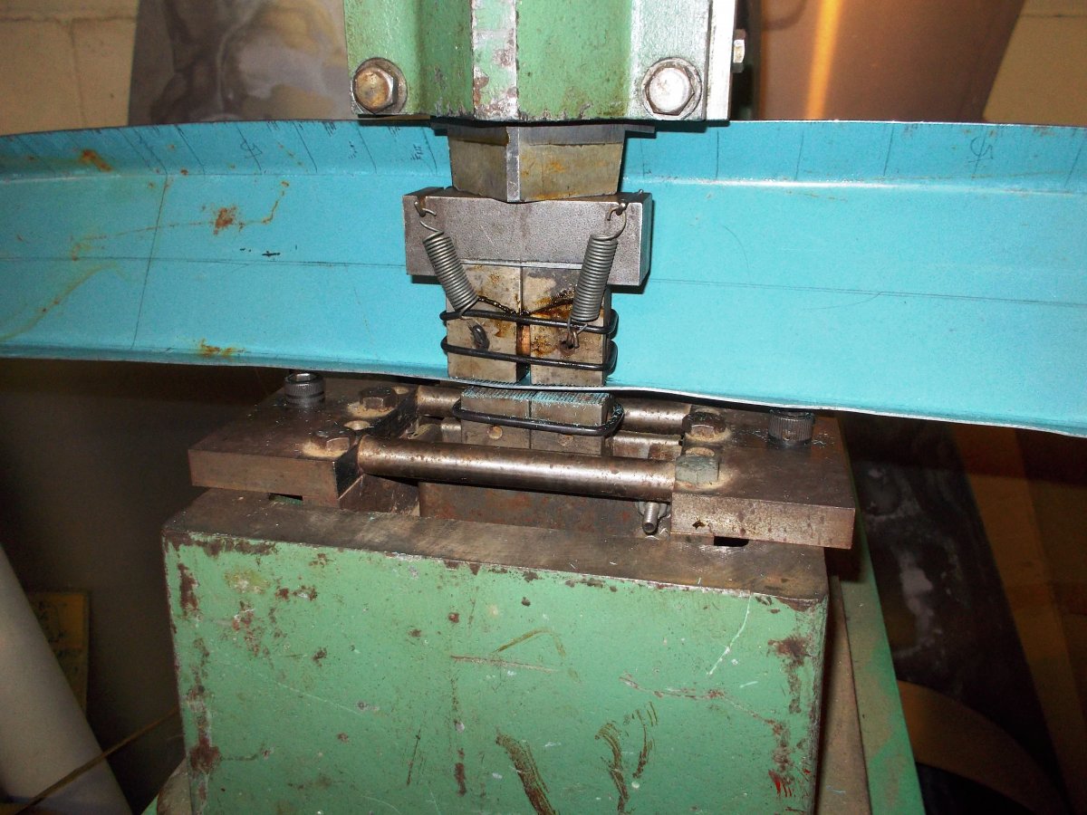

    I chose a #19 sweep, which has a radius of 190.6". Using my homemade stretcher dies in a DiAcro hand press I stretched the flanges to re-introduce the curve formed in the slip rolls. Whoops. I put in too much curvature, so using my homemade tuck tool and the homemade shrinker dies I brought the curve back to the more gradual arch needed. Then using a homemade tipping die in my homemade bead roller I re-directed the edge of the flange to create the hat section needed to give strength and a place to weld the roof insert panel.
    roof bow 4.jpg roof bow 5.jpg roof bow 6.jpg roof bow 7.jpg roof bow 8.jpg roof bow 9.jpg
