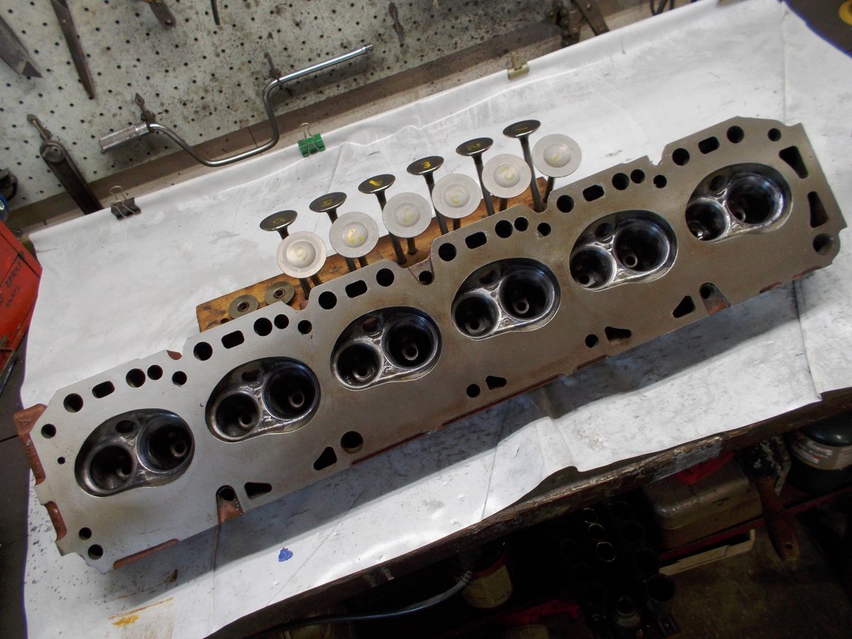

    I started on a cylinder head. I decided to use a head from a 240 ci engine.
    A little CYLINDER HEAD 101 here: I chose a 240 head from a '60s or '70s era motor. It has several advantages. It has 68 cc combustion chambers vs the 76 cc chamber that the 300 head has. The 240 head has kidney bean shaped chambers and the 300 head has open D-shaped chambers. A 240 head on a 300 engine will raise the compression about half a point. That is good when using a performance camshaft. The 240 head also has pushrod guide slots vs the round clearance holes found on later heads that use stamped fulcrum rocker arms. It also has rocker arm studs vs hold-down bolts on later heads. It also has no Thermactor holes in the exhaust that would need to be plugged.

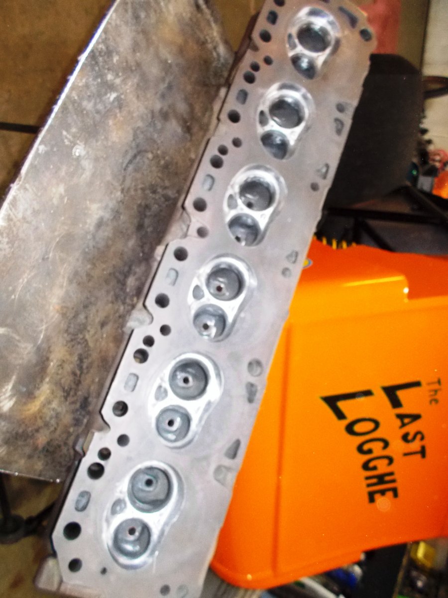

    The block is back from the machine shop w/ a new bore and hone. The pistons were installed on the rods. I took the head in to get de-greased and de-rusted. The guides were in bad shape so I installed Bronze Wall guides. Then I cleaned up the ports and the combustion chambers. I did the final clean-up with a #80 grit tootsie roll in the intakes and a #100 grit on the chambers and exhausts.

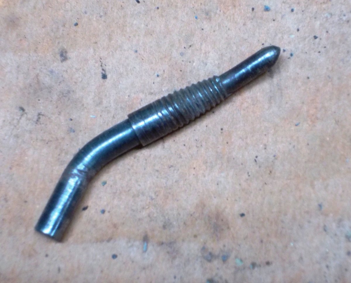

    I have a die grinder setup that works well. It consists of three items:
    A long snout die grinder
    Long carbide fluted cutters of various shapes
    and
    A variable speed reducer.
    The variable speed reducer makes it possible to achieve dentist-like accuracy by slowing down the cutter speed to suit. It gives the operator better cutter control with less likelyhood of having the cutter bounce across the workpiece and playing havoc on the deck surface or a valve seat. It also prolongs the life of the cutter. It also reduces metal build-up in the cutter flutes. It also reduces operator fatigue.
    HOWEVER, DO NOT USE CHEAP IMPORTED ARBORS! This one suddenly bent itself up in a pretzel while I was pressing on it at 20,000 RPM! Boy howdy, I could barely hold on as I jerked the grinder plug out of the outlet before it broke my wrist!

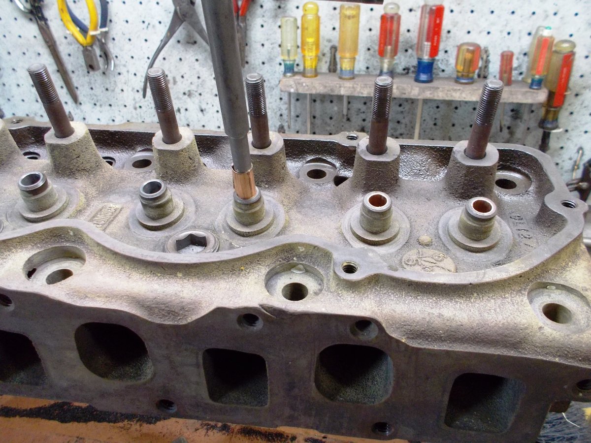

    Today the guides got prepped. First, ream with a piloted reamer. This will make the hole round and on center. Next, since I'm a little OCD I honed the guide, to establish the final size and to get the proper surface finish on the inside of the guide with an oil-holding cross hatch. Progress is slow and tedious. If I owned a speed shop I couldn't afford to hire me.
    brEad, LAROKE, loudbang and 2 others like this.

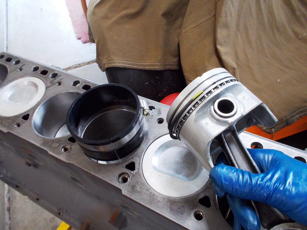

    I installed the pistons and rods in the engine. Hypereutectic pistons with stock compression on stock rods. Nuttin fancy here. I discovered the keyway in the crankshaft had been repaired necessitating that I make a custom key 3/16 x .280 tall. Next the cam and lifters go in. 303 motor 14.jpg
    '52 F-3 and loudbang like this.

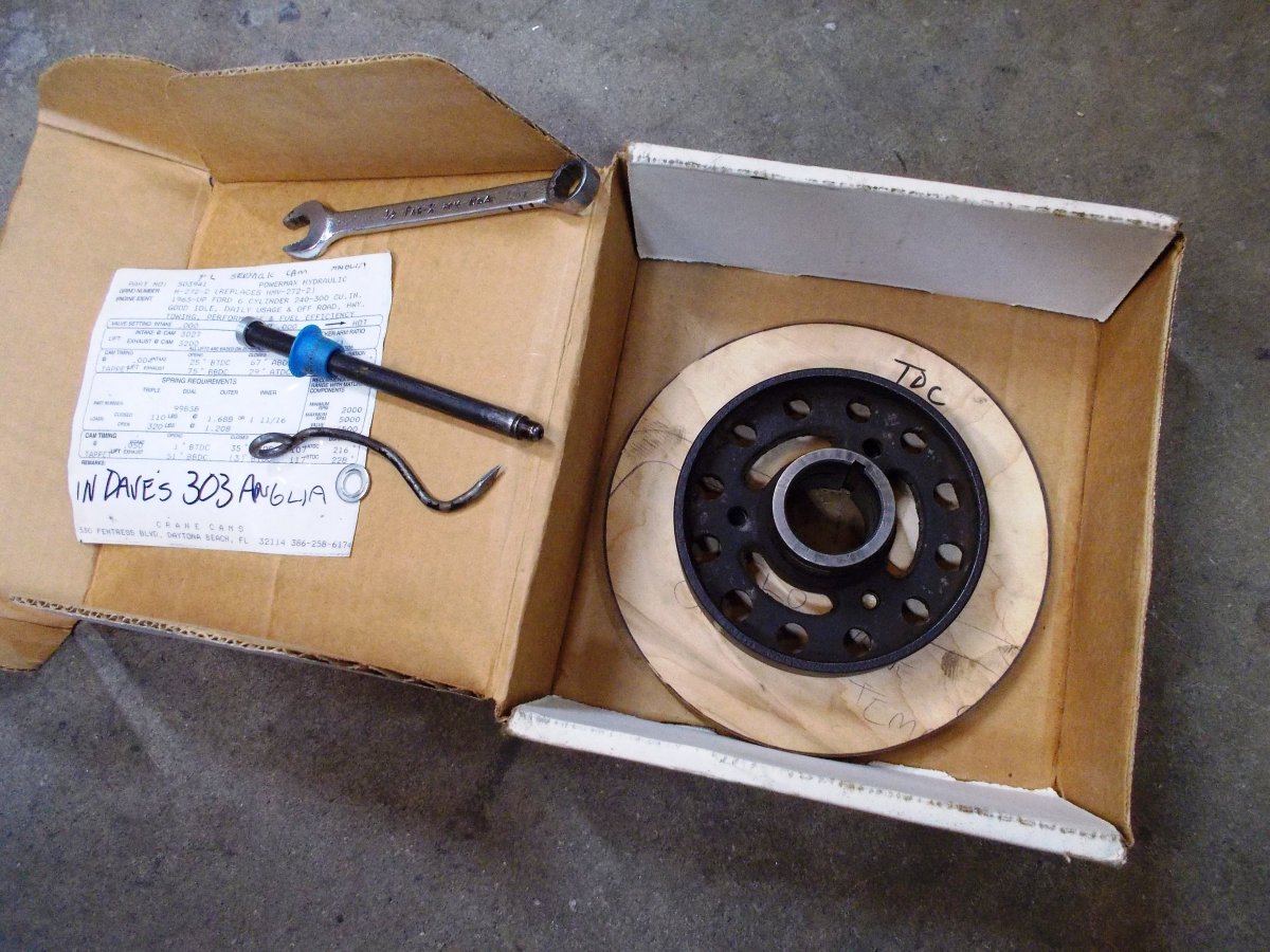

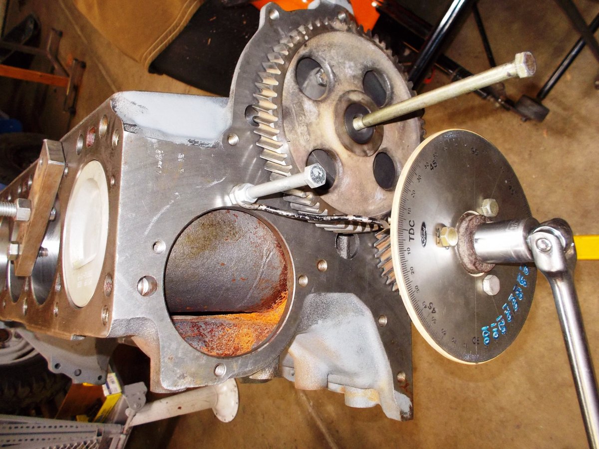

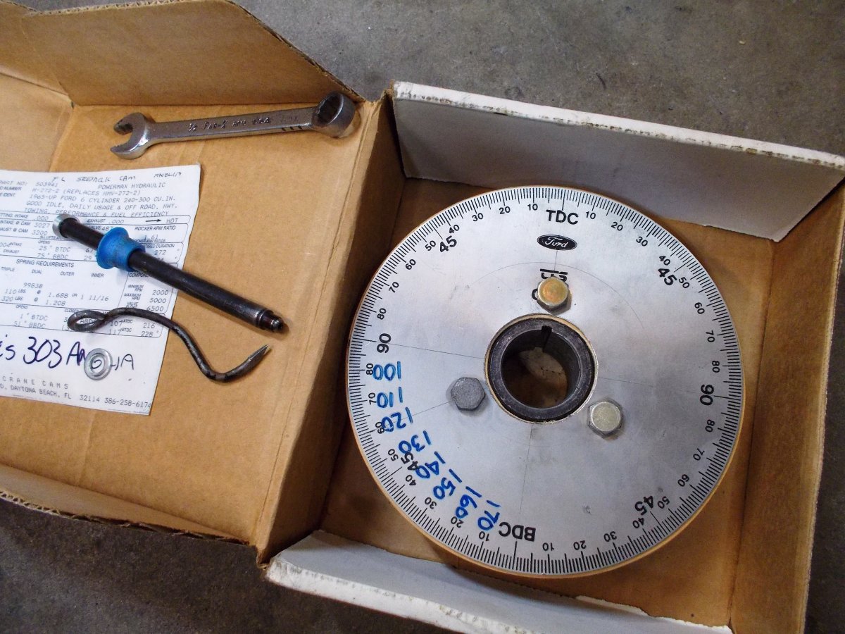

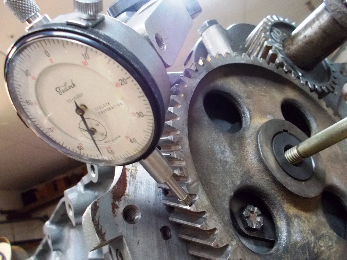

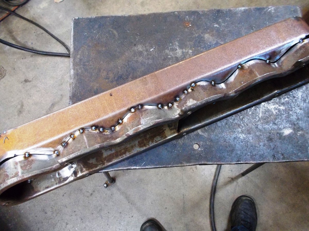

    Tonight I installed the cam. It is a Crane H-272-2 - the same cam I run in my Willys 303 motor 17.jpg . Everything came out pretty nominal - .005" axial end play (.002 - .006 is spec), .0025" - .0035" cam gear backlash (.001 - .007 is spec), 107 degrees LC on #1, 108 degrees LC on #6 - close enough (spec: 107). Next comes head install - I may still get a set of roller rockers and then the lube system and finally the ignition system.
    The intake (Offy w/ 390 Holley) and exhaust (dual EFI) will be transferred over from the 240 motor.
    brEad and loudbang like this.

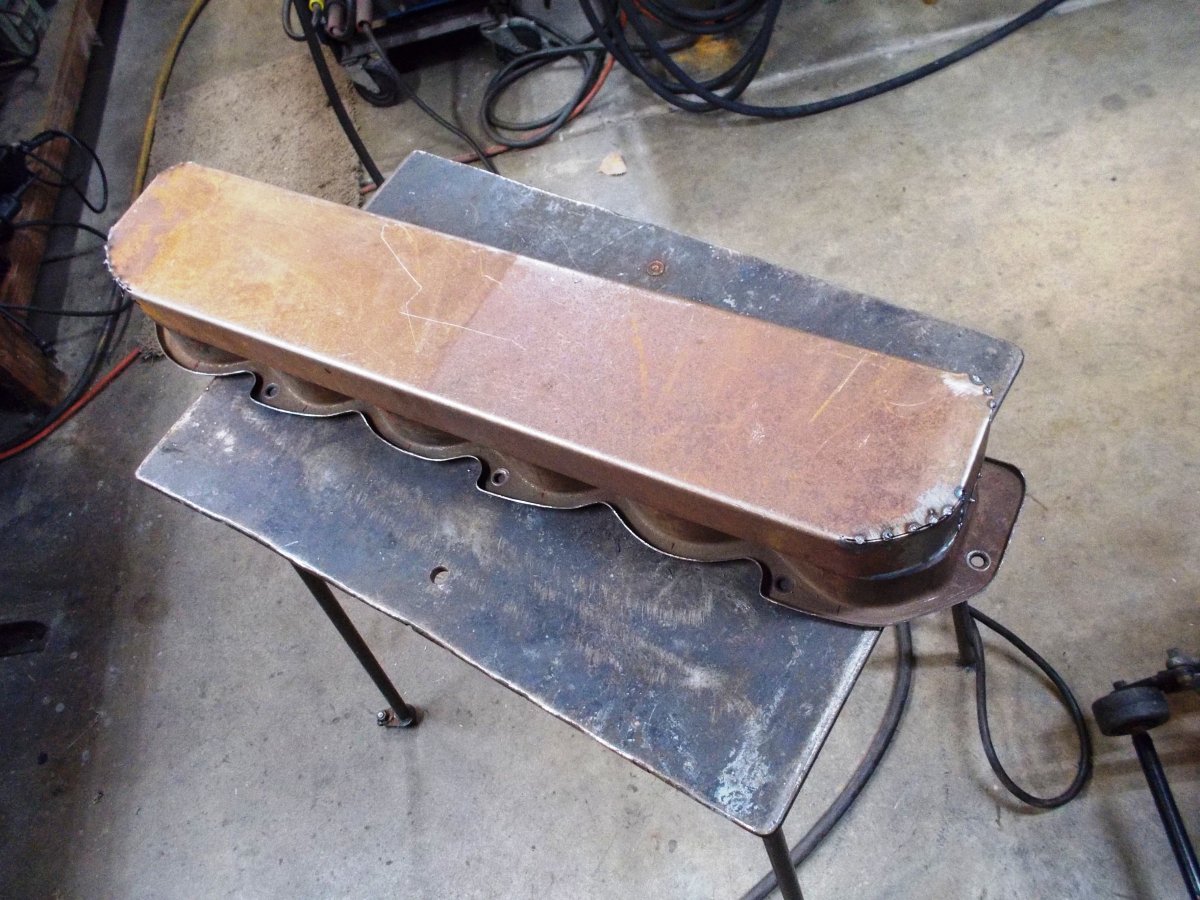

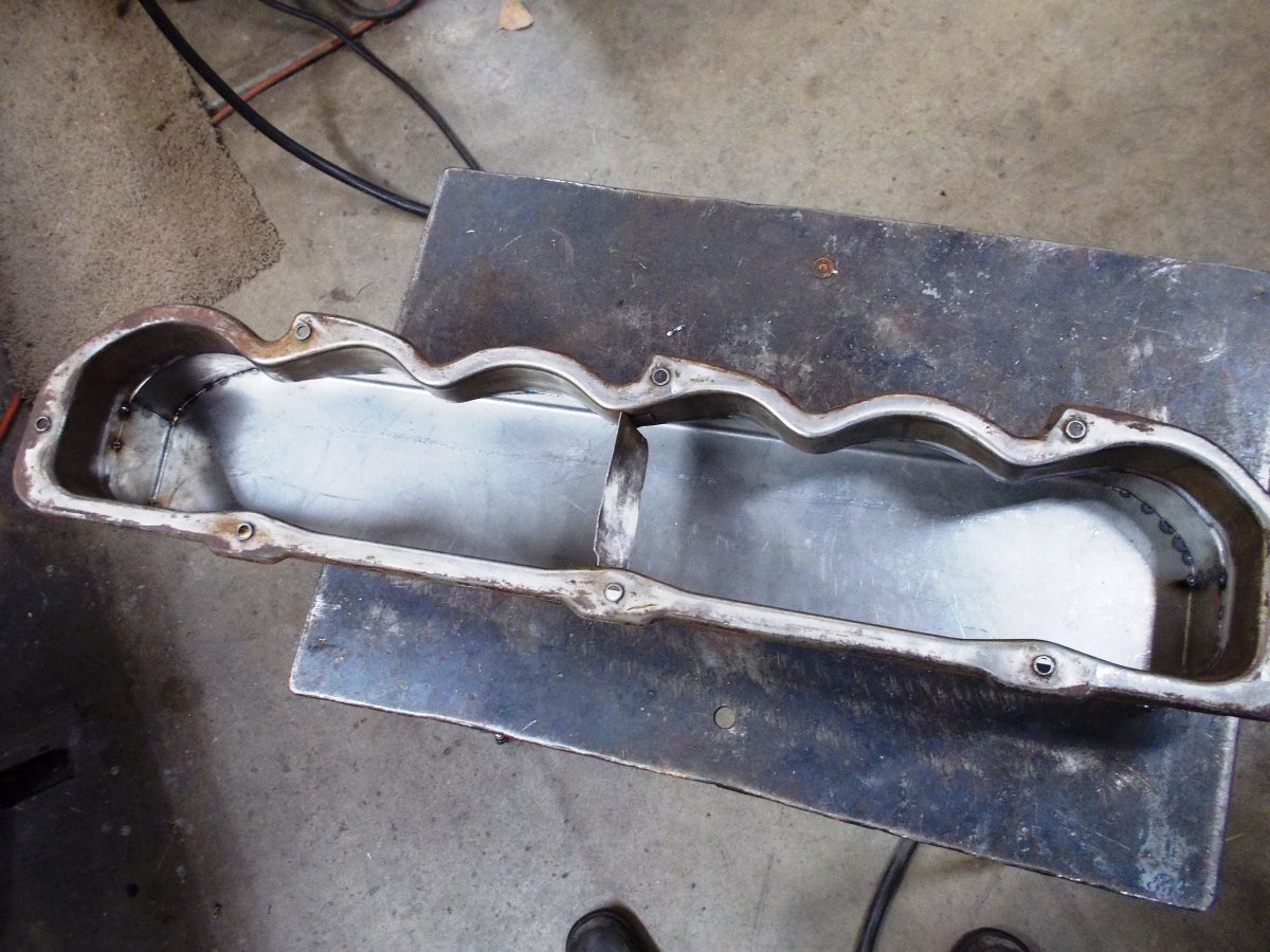

    I am nearing ****oning up this engine. I decided to use Harlan Sharp roller rocker arms (1.6:1 ratio). I figured they will not clear the stock valve cover so I cut apart an EFI cover to check for clearance. Then I decided to make my own design tall valve cover. Can you guess what I used to make it?

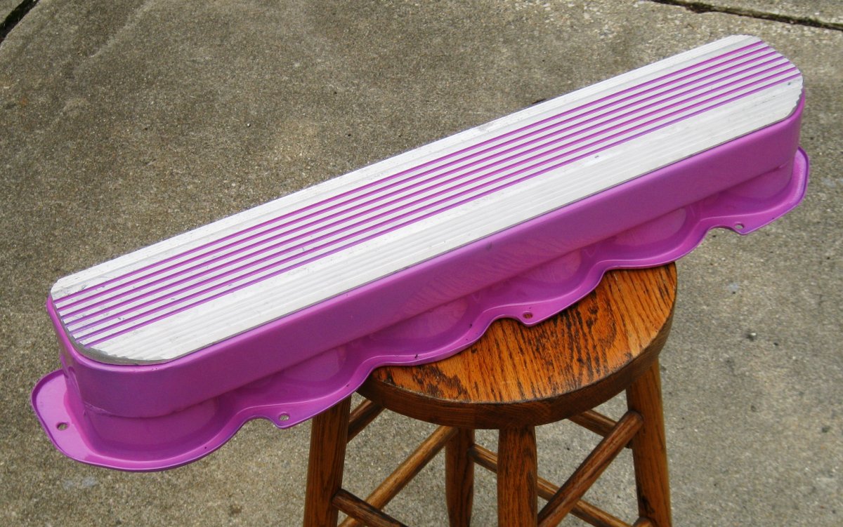

    Looks like you capped it with a piece of aluminum doorway threshold plate.o_O
  24. THE FRENCHTOWN FLYER
    Joined: Jun 6, 2007
    Posts: 6,164
    from FRENCHTOWN
    BINGO!
    64 DODGE 440 gets a gold star for today. I'm going to paint it all and polish the top of the fins.

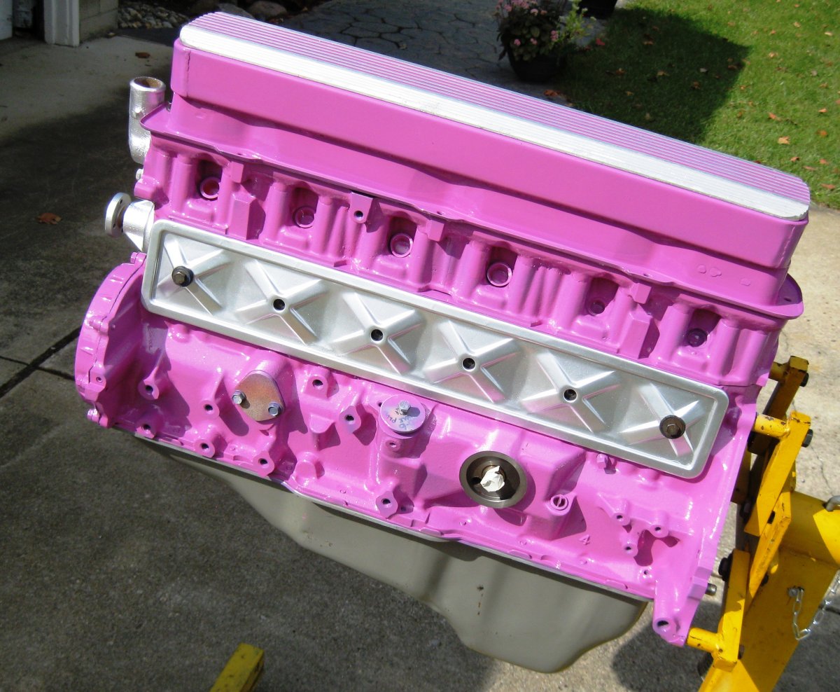

    Nearing completion of a pump gas bullet. To sum up it is
    .020 over - 303 ci
    hi comp head (240) [EDIT: Now with a 300 head for lower compression]
    big valves
    port work
    Crane 272 hydraulic cam and springs
    dual EFI exhausts
    aluminum 4V intake
    390 Holley carb
    4K stall converter
    I stuck a 2 x 4 intake on for the pics. MY Attic Anglia will have one of my home made 3 x 1 intakes. 303 motor 32.jpg 303 motor 33.jpg 303 motor 34.jpg 303 motor 35.jpg 303 motor 36.jpg 303 motor 29.jpg 303 motor 31.jpg
    I painted it a raspberry creamsicle. Enjoy
    brEad, loudbang and 64 DODGE 440 like this.
