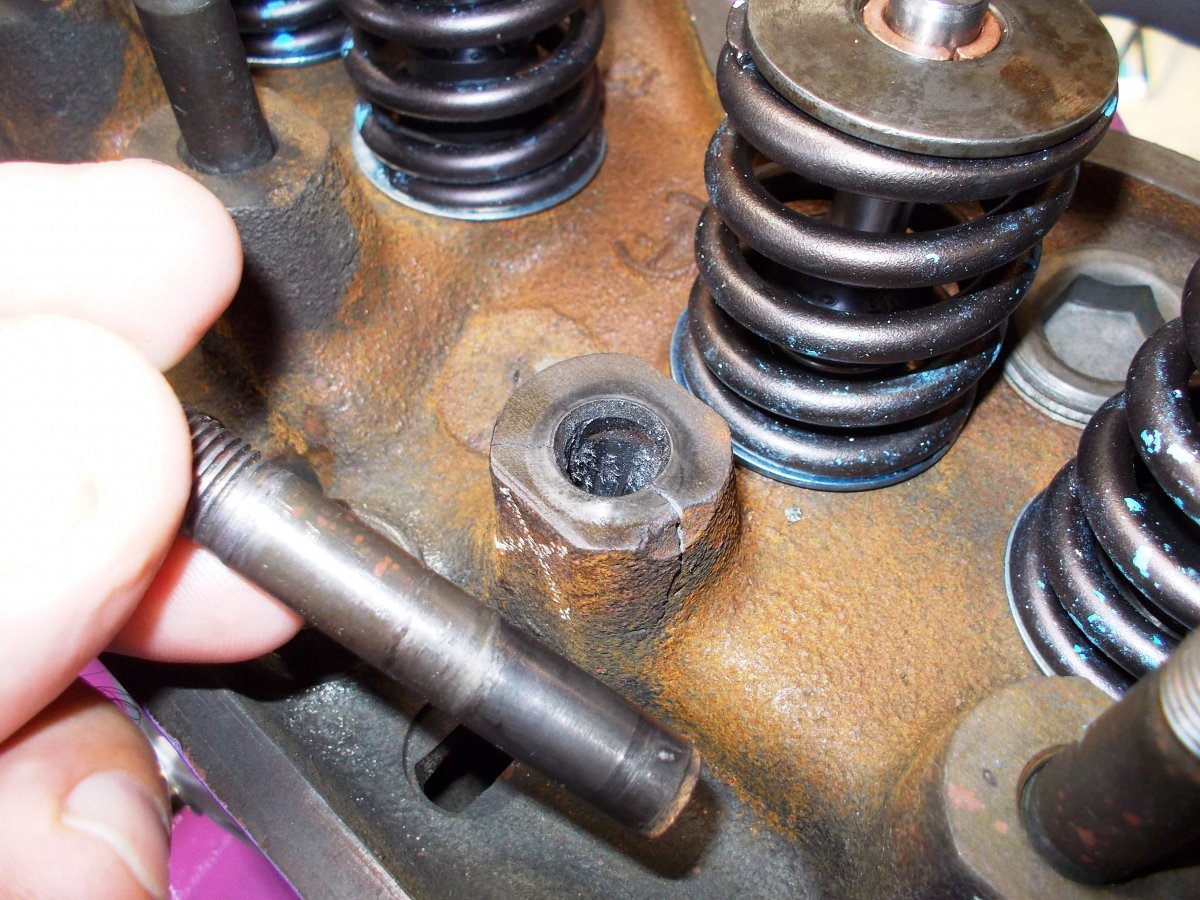

    Last night my hoodlum Loose Screw buddies came over to help me prep this engine to go on the engine test stand. All I wanted to do was install the roller rocker arms, fill it with oil and prime the system with oil pressure. I noticed one of the roller arms looked ****-eyed when we screwed it on. Upon close examination I noticed one of the studs was bent about 1/16". You may be asking yourself why I was using pressed in studs in the first place. This was an intentional experiment to see if the use of roller rocker arms would eliminate the sideways rocking motion on the rocker arms and thus keep them tight in the head, in spite of the increased lift and ramp rate of this performance cam.
    [THOUGHT EXPERIMENT: Pound a tent stake in the ground. Now try to remove it without inducing a rocking motion on the stake. Much harder than rocking it back and forth while pulling on it. Now try pounding a nail partway in a piece of wood. Again, if you don't rock the nail back and forth it is very difficult to remove the nail.]
    Roller rockers eliminate the rocking action applied to the stud. Anyhow, I tried to remove the stud and ended up breaking the head casting. THE HEAD IS RUINED. I have to build another. All that time and money wasted - there went a couple of weeks of my life I'll not get back.
    So now that I've had 12 hours to mourn the loss of my head I realize its just stuff. It is not like a real heartbreak - like a terminal illness or the loss of a loved one. So I'm off to search out another head. I think this was my last usable small chamber early 240 head. I may have to go with a less desirable 300 head. Live and learn. 303 motor 39.jpg

    Greg,
    That's a shame! Just curious, did you jack it out with a stack of washers or rocker balls? If so, it was probably cracked before. Can you cut all the bosses down and use screw in studs, maybe with hardened washers underneath. I'd hate to give up on it having all that time and money invested.

    Yup, I put a sleeve over it and put a nut on it and pulled it, adding washers under the nut as necessary to maintain threads under the nut. I'm afraid the fact that the stud was bent must have introduced side loading on the cast boss and cracked it. Maybe it cracked when somebody bent it in its' previous life. Bummer
    Well I got another head - this time a 300, not a 240 - with 76 cc's vs the 68 cc's of the old one. At least it should run on regular pump gas with the bigger combustion chambers. I will check all the studs for straightness and looseness prior to the long rebuild process. Since I have do***ented the other head build with pics I'll skip that unless there is something particularly salient about this head build, but I doubt it.

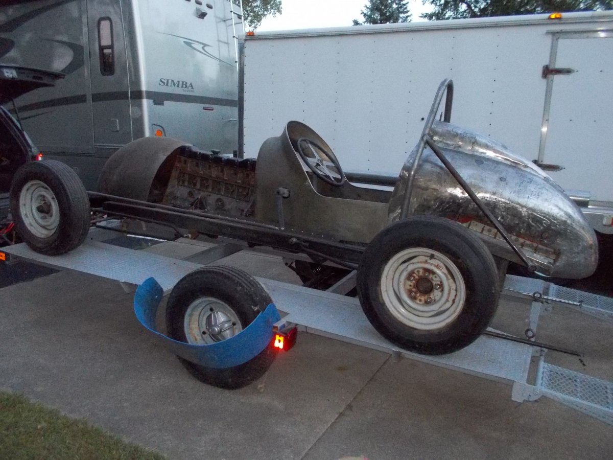

    Loaded up and ready for the trip home. I had one incident on the way. The rear "axle ***embly" was made from 1x2s and curtain rods. Parts of it broke on the journey home, necessitating I build a stronger temporary "axle" out of black pipe and conduit. Now I must make body improvements like a floor pan and rust repairs and marry it to the new ch***is. trailer 04.JPG

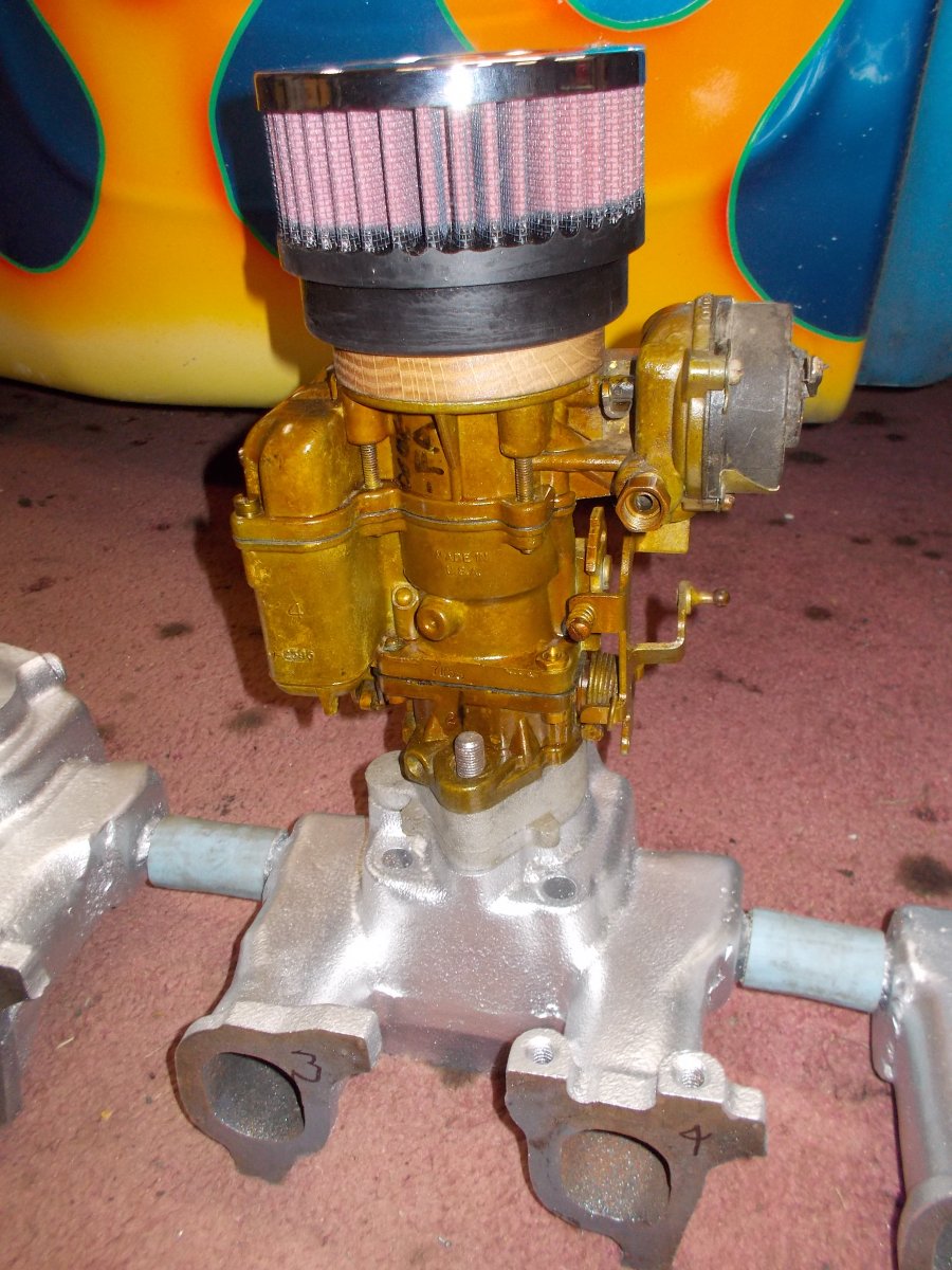

    I added some more details to the AA 3 x 1 intake manifold - throttle linkages and fuel lines. I will paint the intake and install it on SuperDave's 303 engine on the test stand and post a video of it running. The carbs are rebuilt.
    BTW, I simulated the gold finish on the carbs with VHT Metal Tint #288 in an aerosol can. int3x109.JPG int3x110.JPG int3x111.JPG

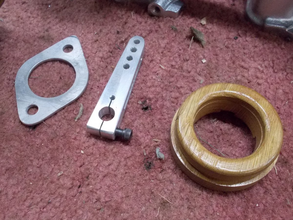

    I made some more pieces to the 3 x 1 - Air filter adapter for the K&N element; Carb spacer; and a throttle bell crank lever for the gas pedal. I put several holes in so I can adjust the gas pedal / throttle plate ratio.
    I made the K&N adapter from a piece of hardwood. I need three. Not sure if I should make them from aluminum or two more of wood.
    I wish I had a 3-D printer. int3x112.JPG int3x113.JPG int3x114.JPG int3x115.JPG
