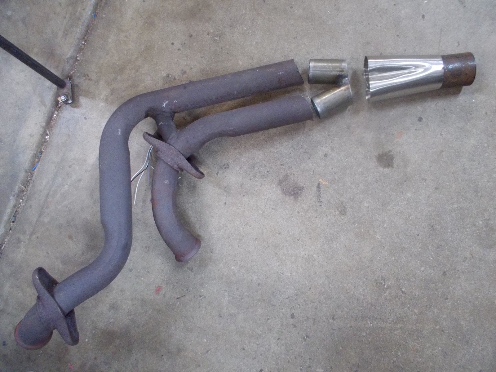

    Since the 2 x 2 muffler will not package easily I am going to hedge my bets and go a different direction, by making a 2-into-1 merge collector which will allow me to use a smaller muffler. Dual exhausts coming from the engine will merge into a single in / single out muffler. To that end I made up a merge collector pattern and a couple of wood plugs to roll a collector from .060" stainless steel.

    I formed the cone and welded it. The next step will be mounting it in a fixture in the hydraulic press to press two increasingly acute creases into the cone 180 degrees apart which will roughly form the big end into the shape of a figure 8. From there two 2" stub pipes will get welded into it which will enable the two head pipes to merge into one 2.25"outlet pipe.
    brEad and loudbang like this.

    I had to neck down the outlet end slightly to get it to fit snuggly into the 2.25" plug. Instead of using a 2.25" system, I may decide to go with a 2.5" exhaust system, in which case I'll reshape the collector outlet by flareing it outward slightly, instead of inward. It just depends on what kinds of deals I can find on exhaust tubing.
    When I did my '46 pickup w/ a V8 I bought a pile of thick-wall polished SS Mustang GT stinger pipes at a swap meet, chopped them up and fashioned them into a complete stainless exhaust system for pennies on the dollar. Maybe look for a similar deal to move this project along.

    I made a couple of stub pipes. They will join the original six dual exhausts (with some mods to fit the tube ch***is) to the collector. I made a simple template jig to hold the stub pipes at 3" on center, same as the head pipes. [​IMG] [​IMG]
