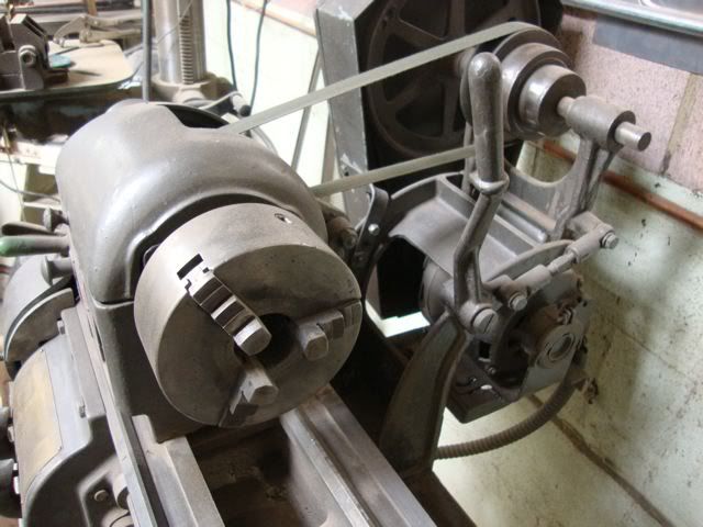

    Yep! The machine was taken apart to move it into the shop. It has to be leveled and all dialed back in.

    Hey Scott is it a belt drive or gear drive machine?

    scootermcrad
    Flat belt. Has quick change box as well. Never set one up before. Should do everything I need to do in the shop. Been a LOOONG time since I've used a lathe, though...
    POWR-KRAFT series lathe. Made by Logan for Montgomery Ward. The quick change box was added at the factory, as far as I can tell after running the numbers and what's listed as the model number.
    (set up in Chris' shop)

    Just saw the new pic. There is no lead screw for screw cutting only a feed shaft so those gears will be related to the spindle. Nice bit of kit! An ***et to any garage!

    Yeah, this one is dated 1949.
    I have no clue how to use this machine but have ordered manuals and books to hopefully learn a thing or two. It will definitely help with a few parts I need to make. Looking forward to learning...

    This one has a 10" swing, 50" bed, 31" center to center. Oh... and it's REALLY HEAVY!!!
    The good thing is, parts for yours and mine are available. In fact, I ordered a parts book from Logan for mine and they sent me a PRICE LIST for all the replacement parts! pretty wild! I'm sure if Atlas replacement parts aren't still being made you could find them on the web or Egay.

    I only see one lever on the apron? the full feature lathes have a lever for the half nuts (threading) and another lever to select power feed for the carriage or cross feed, plus a clutch. But it does have the quick change box, so you don't need to mess with change gears.
    South bend made three different flavors of them....depending on how much money you had.
