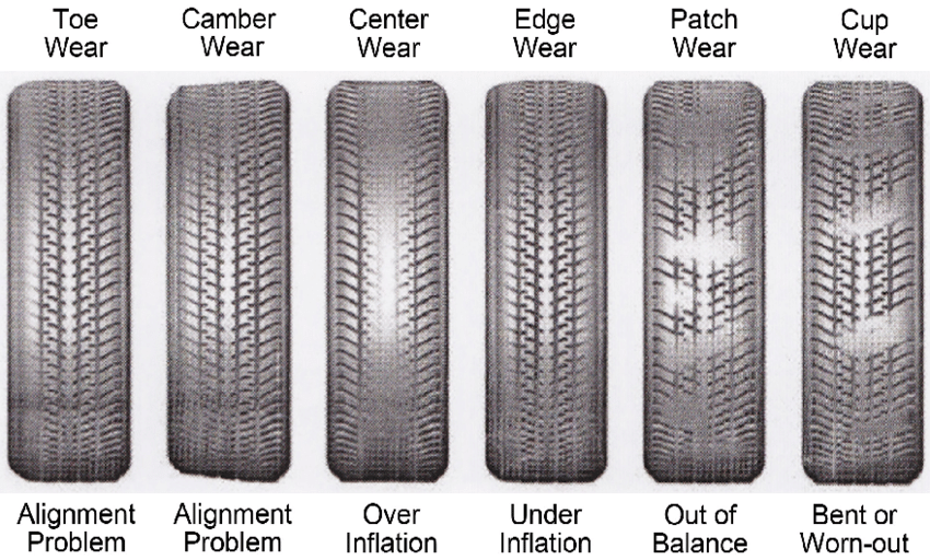

    Let your tires talk to you. Get a tread depth gauge and keep track of it. You'll be able to find right setting within a few hundred miles. When long wearing Michelin radials tires became a big thing in the 60s I knew a guy who measured his tread depth every month and adjusted air pressure accordingly. He got over 50,000 miles out of those tires The-passenger-car-tires-with-the-various-uneven-wear-patterns-24.png tires.jpg

    You could "chalk" the tires and that will tell you a lot about your tire size vs car weight. Sports car guys do this to optimize tire pressure for a given track.
    Set the tire at the max pressure that is shown on the sidewall. Draw a stripe of chalk an inch or two wide across the tread and extending a bit onto the sidewalls. Drive the car for a few blocks and around a few corners. If the chalk is mainly worn off the center, the pressure is too high. Drop the pressure a bit and repeat the process until you show even wear across the tread face and that ought to put you close to the sweet spot. Once you find that, I would add a couple pounds of air for insurance.
