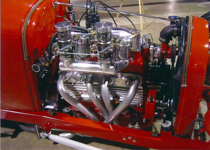

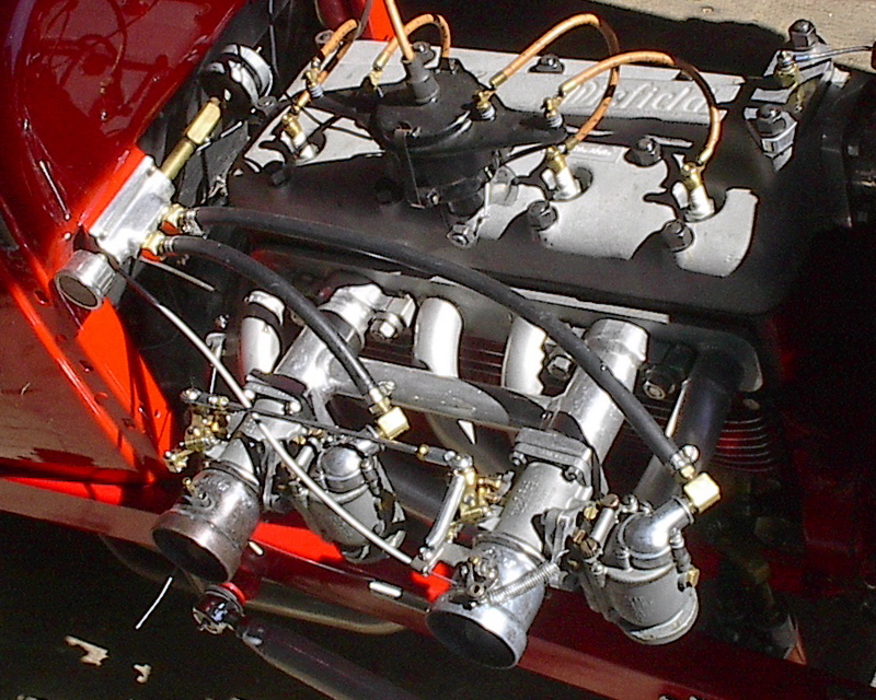

  28. You will get some leakage with new gaskets if the mating areas on the fuel filler housing are not flat, sometimes you can use a small bead of Pern #2 applied with a tooth pick. The float level needs to be correct as stated in literature, right to bottom of threads. Not sure about early blunt needles. All of the needles I have checked were/are 13 degrees on a side. Many needles are bent when replacing float chamber cover. I have set them by printed instructions, air fuel meter, and color tune. But not on an engine like yours. I usually don't have to open the intermediate that far. The idle needle, contrary to what C Yapp Quotes, controls the air. The fuel available to the idle circuit is from the intermediate well so basic fuel/float level inters into correct settings. I'm sure you have noticed that there are slots cut into the float chamber and fuel will splash there. The air bleeds should be checked with pins or drill shanks as quite a few have been opened up.
    I do run Winfield's All of the carburetors shown are BB's and all have #28 air bleeds Notice that the side drafts have been "tweaked" slightly on the flanges so they are level for tuning. The clock speed is for the flathead. 2 pounds pressure is okay if the float needle seats good, I lap mine in, made a tool to hold needle parallel, have held higher pressure but not necessary, 1.5 will do.

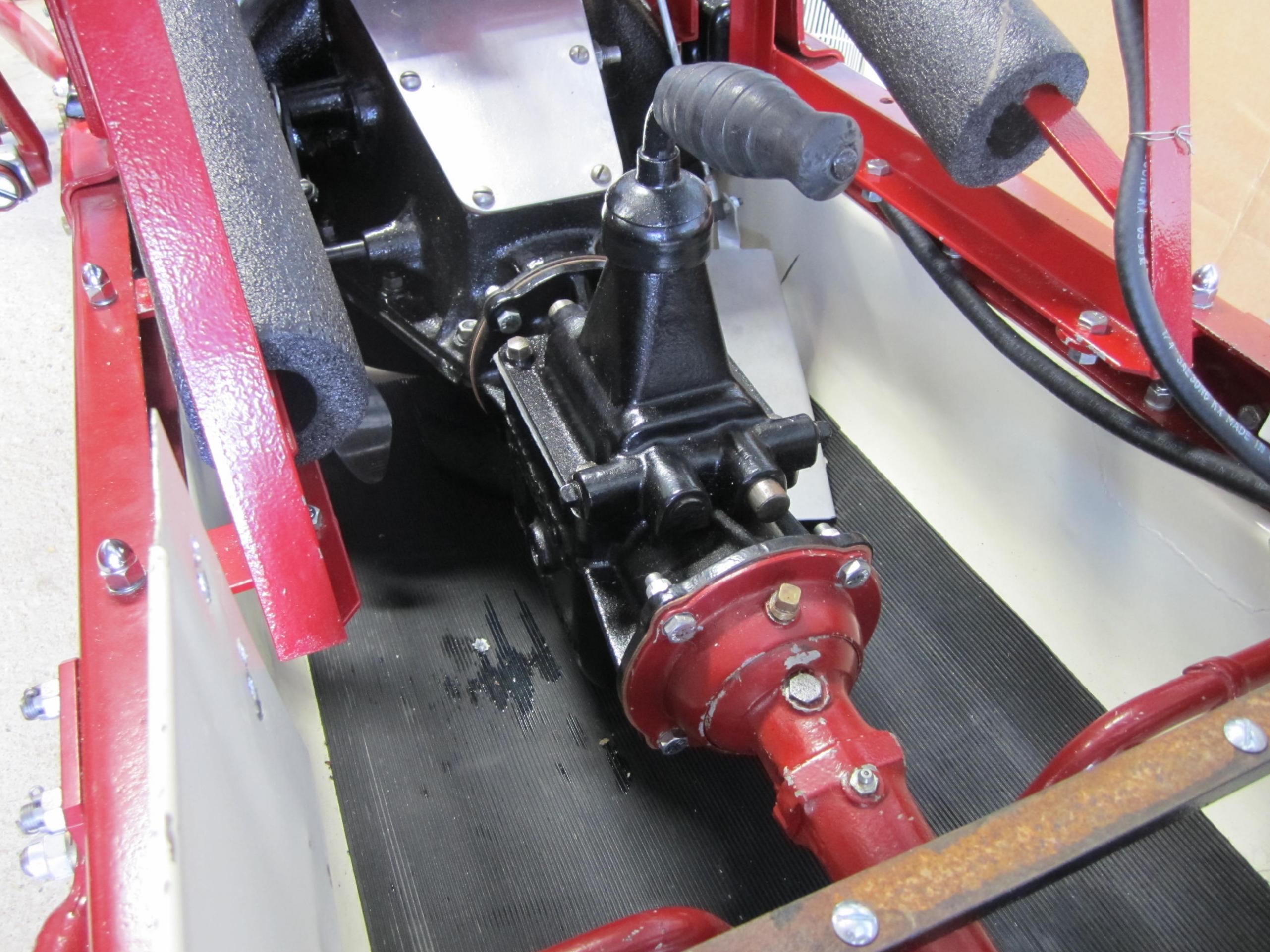

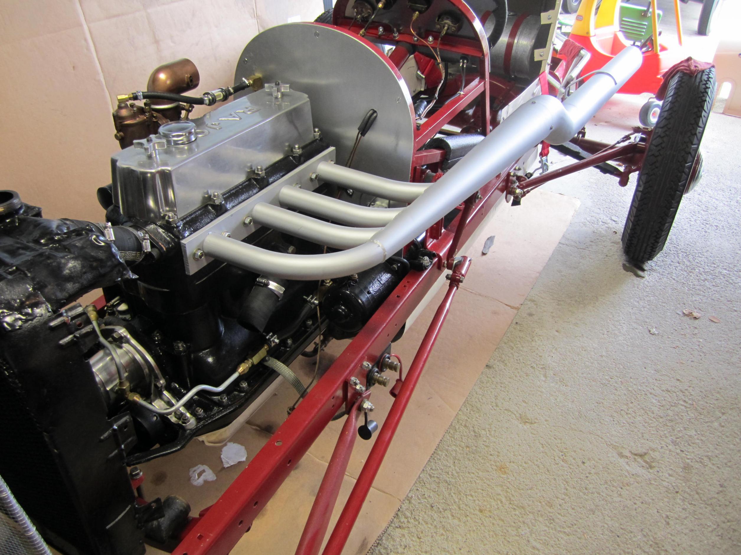

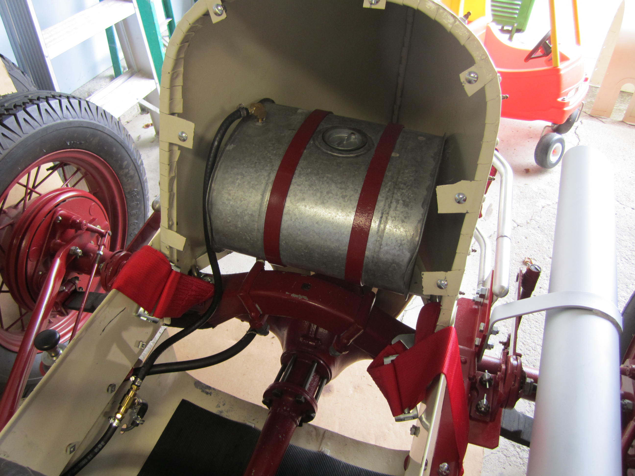

    Thanks, I'm convinced I'm causing some of the problems myself. I've got a Quick Fuel pressure regulator ordered to keep the fuel pressure below 2 lbs. and I'm going to raise the fuel level to just below the inspection hole and we'll see what happens. Some pics of the final assembly:
