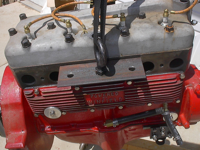

  5. Well Reddy let me tell you what. This engine ordinarily only travels 1/4 of a mile and some times 1/10 of a mile. It is 228.1 cubic inch's and is fed, at this time, by 2 Winfield BB side drafts through 1.750 valves. It had a 16.5 Al V8 flywheel and was constantly blowing the oil fill tube out on acceleration when first built. As I had a couple of different breathers in the pile I installed this one, which is the smaller of the 2, to help relieve the pressure in the crankcase. It has J and E slipper skirt pistons with 1/16 compression rings which seal rather well. I installed this breather several years ago and haven't blown the tube out since. Of course, maybe I'm hammering the tube in tighter now but that is the reason I installed the breather.
    At the last 66 hill climb we raced the only engines to go faster than our Winfield flat head A engine were the B engined 4 ports and then only by .5 second or so.

  7. It would seem that the stock model B or maybe its a BB (fat) oil filler tube would/should work for street as long as it is clean. Is the oil return pipe on the rear main cap clear, of course this is if you have babbit.
  8. Does it leak from the pan, outside of the flywheel housing, or from the cotter key in the hole in the bottom flywheel housing?

    I Got to thinking about questions asked and most times answered. Seems like everyone wants to go real fast. Most of those have model A's or B' Ford engines (watch out for the Mopars, and Stovebolts) and you/they see alla this speed stuff that ya just gotta have. Now I'm trying to speak to the street racers, dragsters, and hillclimbers. Just want you to know that when we run the hill climb we are turning 3900 RPM's, at the end of the 1/4 mile we are turning 3750. What I'm saying is you don't need all of that stuff. I was running a repop Al Winfield head not some exotic rare piece. There is a guy in the midwest or some where's that makes pistons that don't cost an arm and a leg. I'm running "Skokie" rods, I think you can buy oversize valves from the same place AER. I'm using 1 3/4" intakes, got a good cam from Jim B, sure its a regrind but it works. I think most of the pistons available from the reputable suppliers will stand all the compression you are going to need. Remember, I was running a basically stock b distributor.
