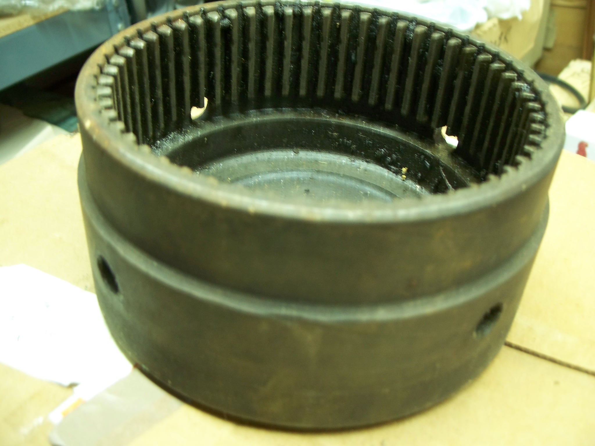

    Here are some pics. The first is an AR ****** with cutdown clutch pedal, then one of the multi-disc clutch pack, and finally two of cutdown flywheels, one with timing marks (ala Offy) and the other plain with less material removed.
    Sorry for the poor pics: ****py camera and poor light:eek:
